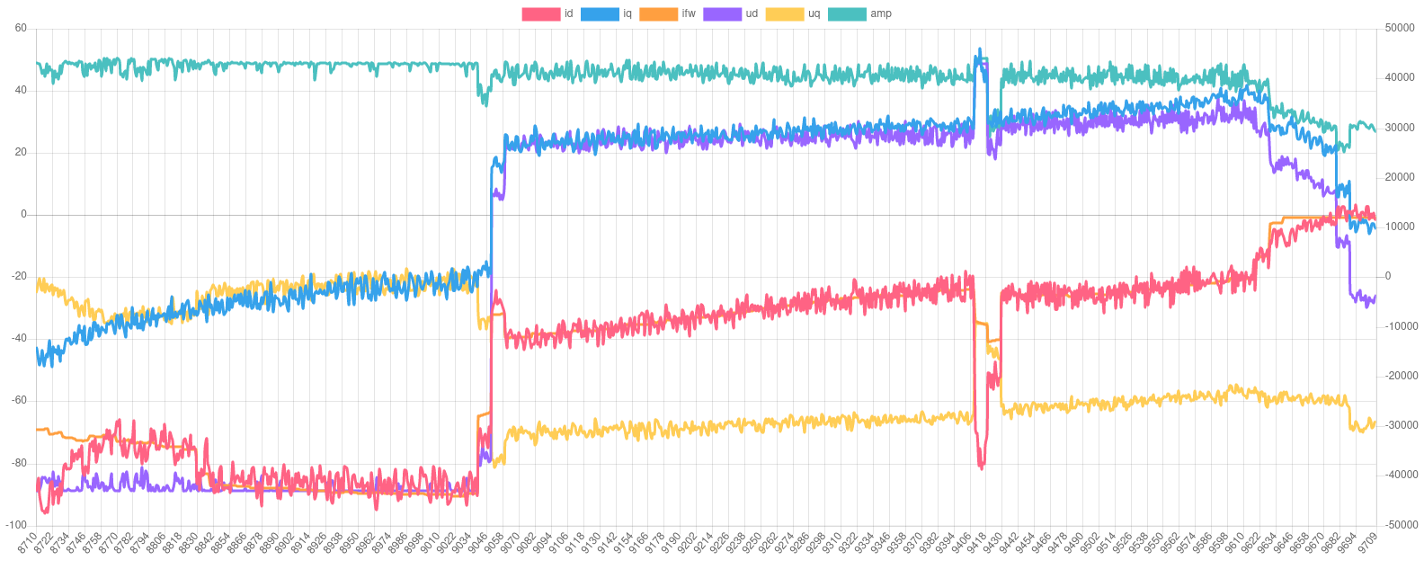

Prius likes over modulation very much! Cranked up modmax to 44000 and went for a drive
So when we do (iq * uq + id * ud) / FOC::GetMaximumModulationIndex() we arrive at 43000*90/44000=88A DC (because uq=0) and that is pretty much what I saw on my power meter. So now I can maintain 30 kW across the constant power region.
I think on the next release I will made modmax a parameter that defaults to 2/sqrt(3)*32768 and can be increased up to... 45000 or so. Then by default over modulation is off and maybe brought in

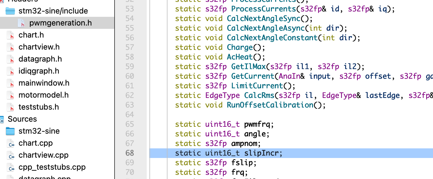

Trying to build with the 5.24R but struggling:
/Users/jamiejones/open-inverter/IPMMotorSim/build-IPMMotorSim-Qt_6_3_2_for_macOS-Debug/pwmgeneration.o:-1: error: Undefined symbols for architecture x86_64:
  "PwmGeneration::slipIncr", referenced from:
   PwmGeneration::SetFslip(int) in pwmgeneration.o
   PwmGeneration::CalcNextAngleAsync(int) in pwmgeneration.o
   PwmGeneration::CalcNextAngleConstant(int) in pwmgeneration.o
any ideas? Tried different QtKits but I'm not vary familiar with Qt. pwmgeneration.cpp does contain them definitions.

Bigpie wrote: Thu Nov 24, 2022 1:59 pm Trying to build with the 5.24R but struggling:
Almost seems like a CONTROL=FOC directive missing somewhere.
EDIT: no, it's probably because it's a debug build it doesn't dismiss unused functions. May nee to copy the definition of uint16_t PwmGeneration::slipIncr; from pwmgeneration-sine.cpp to pwmgeneration.cpp

Posts: 1845
Has thanked: 89 times
Been thanked: 481 times
Looks to be already there.
Posts: 6969
Has thanked: 455 times
Been thanked: 1771 times
That's just the declaration, doesn't allocate memory
Posts: 1845
In pwmgeneration-foc.cpp, as you said :D

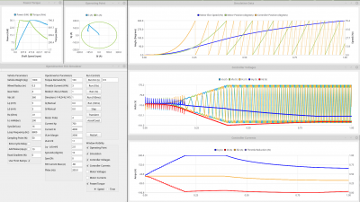

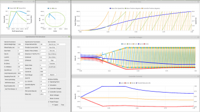

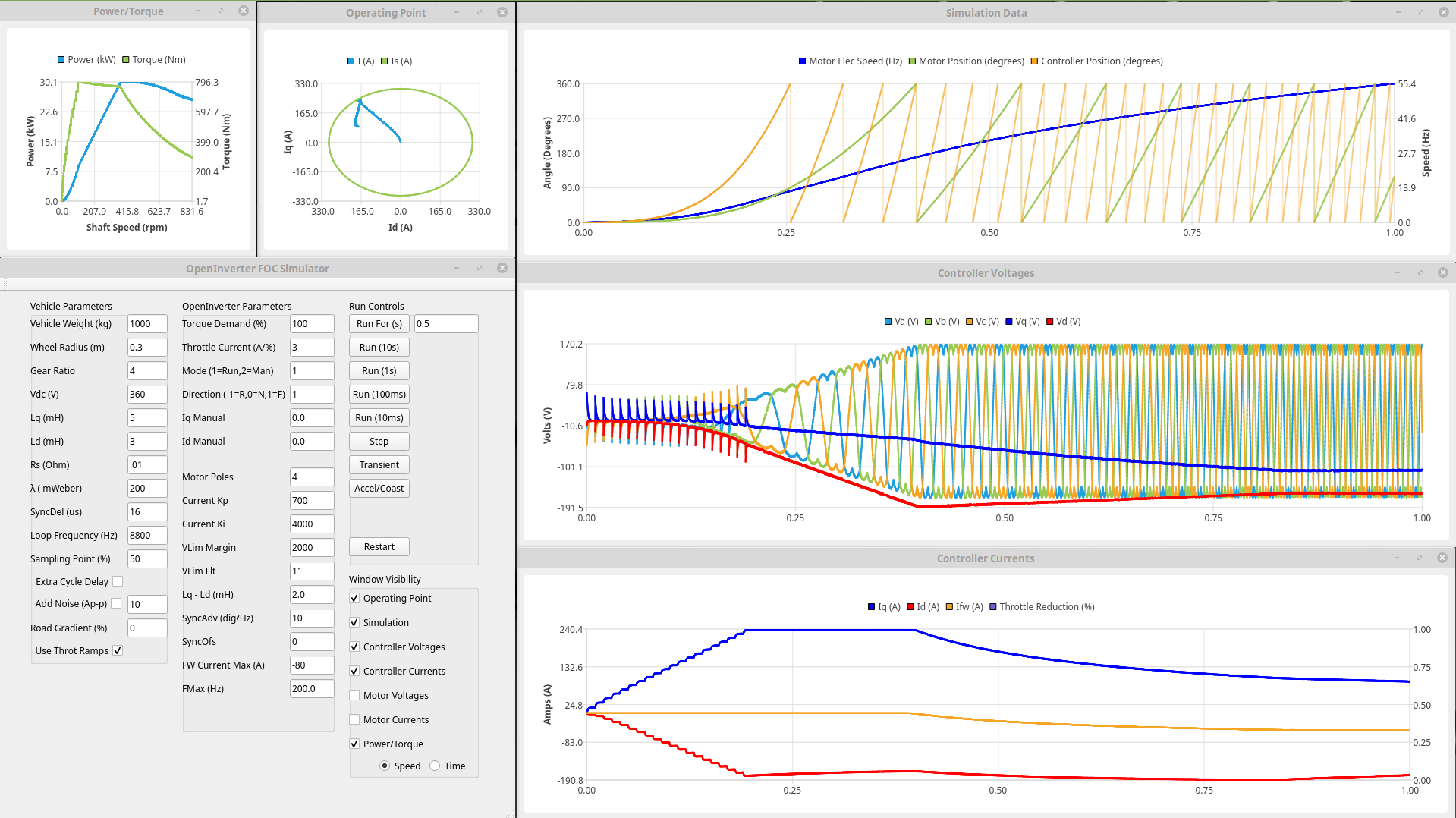

Not too keen on commenting out that block without understanding why the simulator doesn't like it (in case it indicates a bug with the simulator) so have had a look at it.
This is the standard code:
And this is with the block commented out:
What you can see from this is that Vq does actually need to go negative during the acceleration to keep full control of Iq. You mostly get away with it but do partially loose control until the frequency reaches 30Hz and Vq is allowed to go negative. Can't see any reason why this would be any better in the real world in the car (unless the currents are lower, it doesn't show up at all on lower throttle current values?, or it might be hard to feel as it only lasts a fraction of a second). I'm sure that if you go looking for it you will find traces of it so I think it would be better to fix it rather than commenting out the code for the simulator.
This is the best fix I have come up with:
      if (frqFiltered < FP_FROMINT(5))
         qController.SetMinMaxY(dir <= 0 ? -qlimit : 0, dir >= 0 ? qlimit : 0);
      else
         qController.SetMinMaxY(-qlimit, qlimit);
which gives this:
I can't quite remember why this block is here but would reducing the frq threshold from 30 to 5Hz be acceptable as it virtually eliminates the problem?
