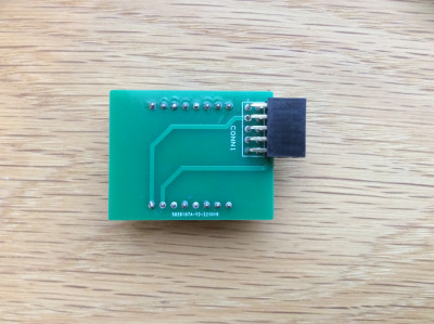

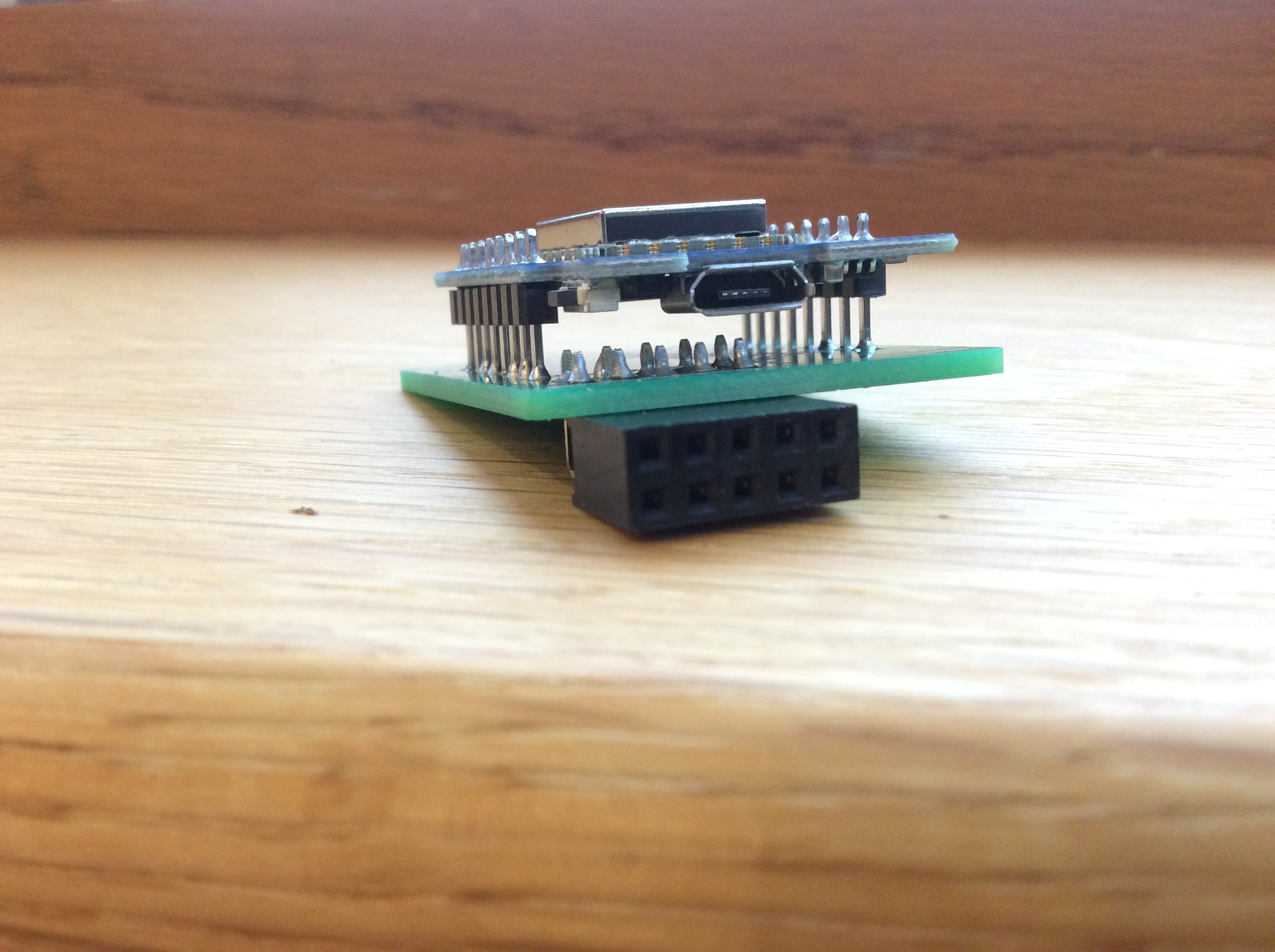

Re: ZombieVerter VCU Support
I’ve built up my Wemos WiFi adapter board. As Damien says it’s quite straightforward. The only thing to watch is that the back of the mini USB port doesn’t short the connector pins. For the 10 pin connector I used item 613010243121 from Mouser.

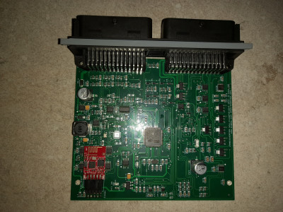

Hi guys, new to the forum. Have recently purchased the zombieverter vcu from Damien and had it assembled as per video but still have to fit IC 10 as not supplied in the kit. After connecting the resolver cables and doing a basic power check using 12v volt battery the micro controller IC 8 started giving off smoke signals so I quickly disconnected. Where have I gone wrong.
