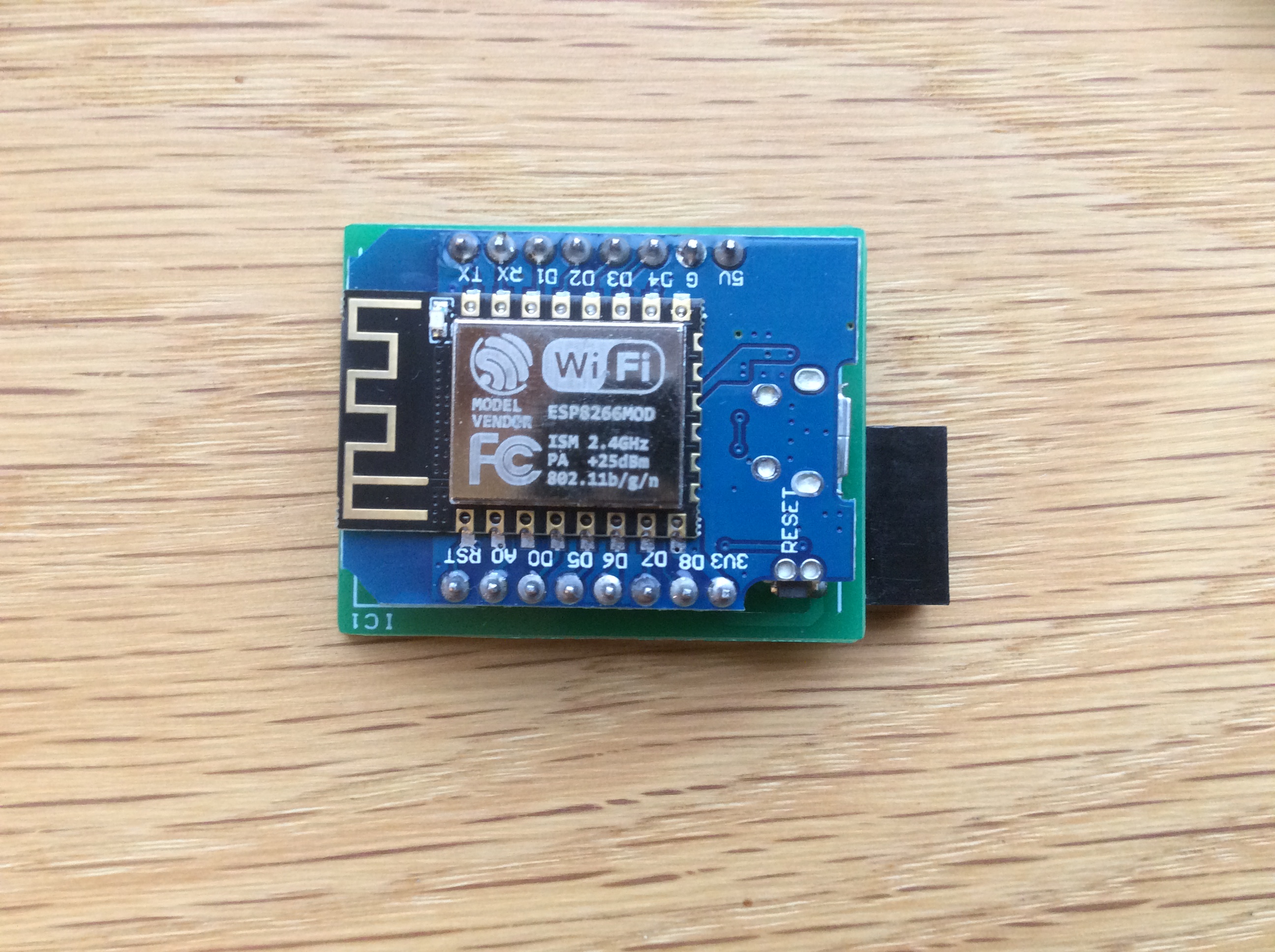

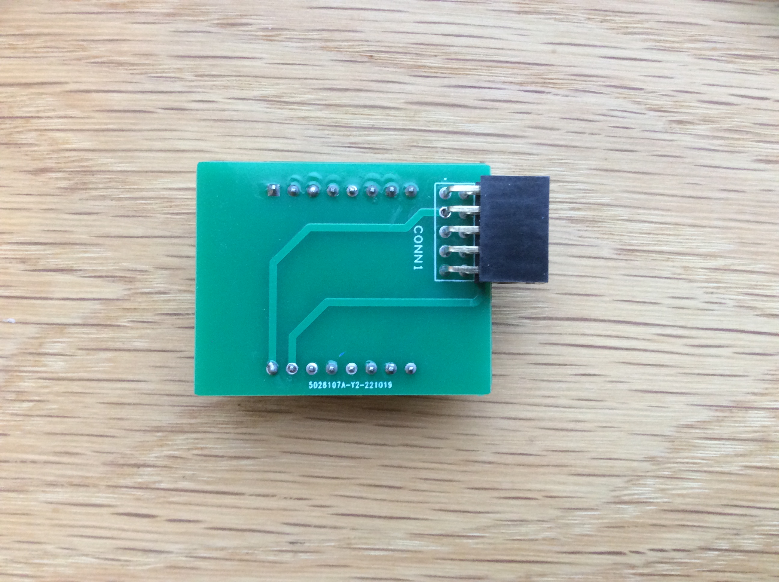

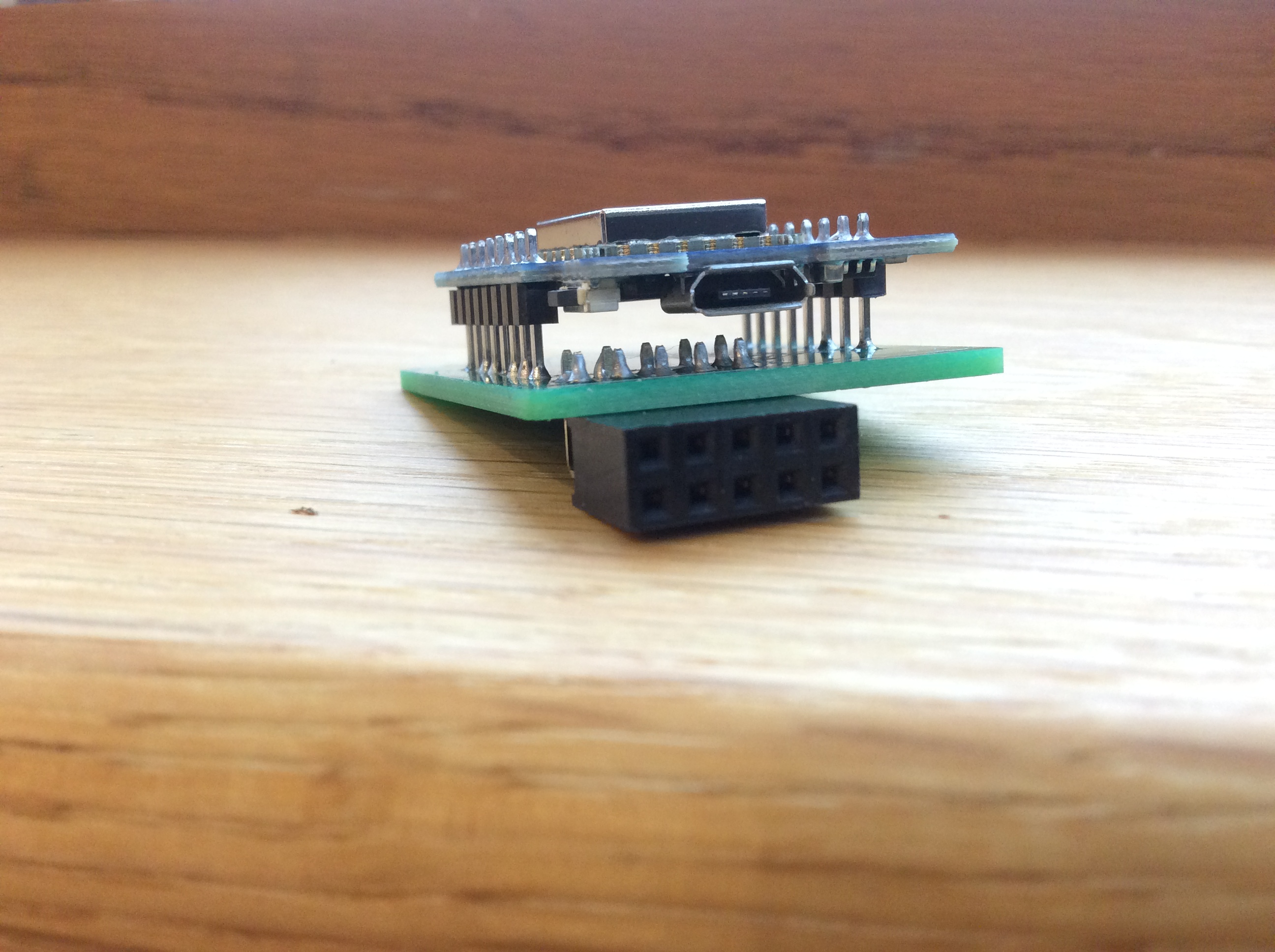

I’ve built up my Wemos WiFi adapter board. As Damien says it’s quite straightforward. The only thing to watch is that the back of the mini USB port doesn’t short the connector pins. For the 10 pin connector I used item 613010243121 from Mouser.
Can anyone confirm if the instructions for installing the software at https://openinverter.org/wiki/Olimex_MOD-WIFI-ESP8266 work for the Wemos module and the Zombieverter? Also should we be using Johannes web interface code https://github.com/jsphuebner/esp8266-web-interface or the GS450H VCU code https://github.com/damienmaguire/Lexus- ... aster/WiFi ? I can’t see any code specifically for the Zombieverter VCU.

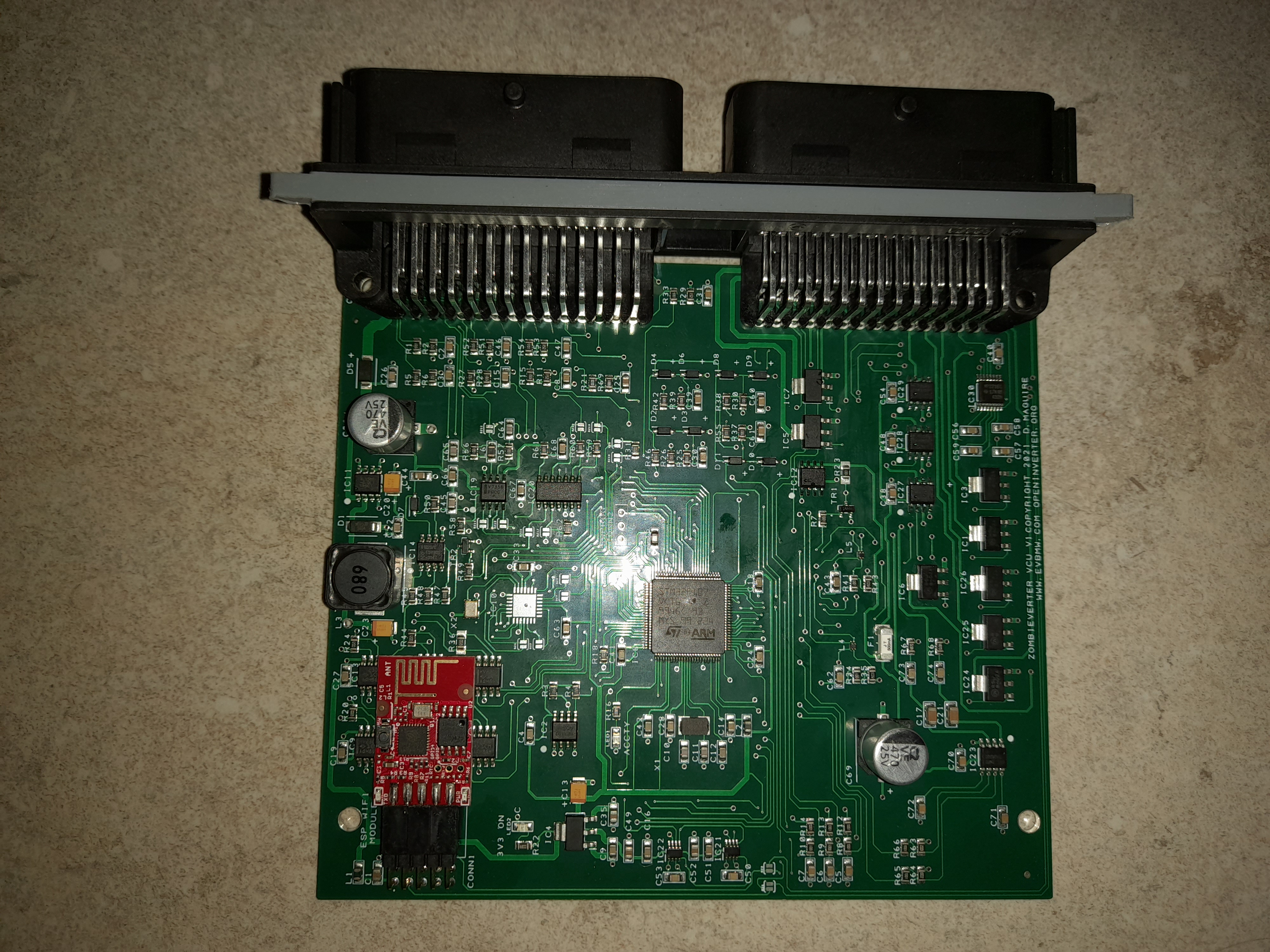

Looks like I need a break.... The GD chip doesn't want to cooperate, and now I'm suddenly getting USB communication error in stlink utility
A quick rundown of my problem trying to program this thing:
First started by uploading precompiled GD chip with Stm32-vcu.hex with stlink... Utility showed successful, but no blinking ACCTY LED
Eventually programmed bootloader with stlink and successful blinkenlight ACCTY LED
Eventually got esp wifi interface programmed and able to view web interface on my laptop browser
Attempting to upload precompiled GD chip Stm32-vcu.bin with wifi interface showed "Upload Successful" instantly, with no progress bar
Uploading Stm32-vcu.bin with stlink gave similar results as wifi interface method... both show as successful, but no firmware seems to have actually loaded.
I've cloned the git and installed ARM toolchain (but get the error of arm-none-eabi-gcc command not found) when building so I messed that up probably due to my shitty terminal skills
If anyone has successfully programmed a GD chip... I'm all ears

I don’t think your .bin file has uploaded. When I upload it I also see the “upload successful” message instantly, then after a few seconds the progress bar appears and progresses very slowly. Often it freezes before it gets to 100%. I have to repeat the process several times before it it gets to 100%.
