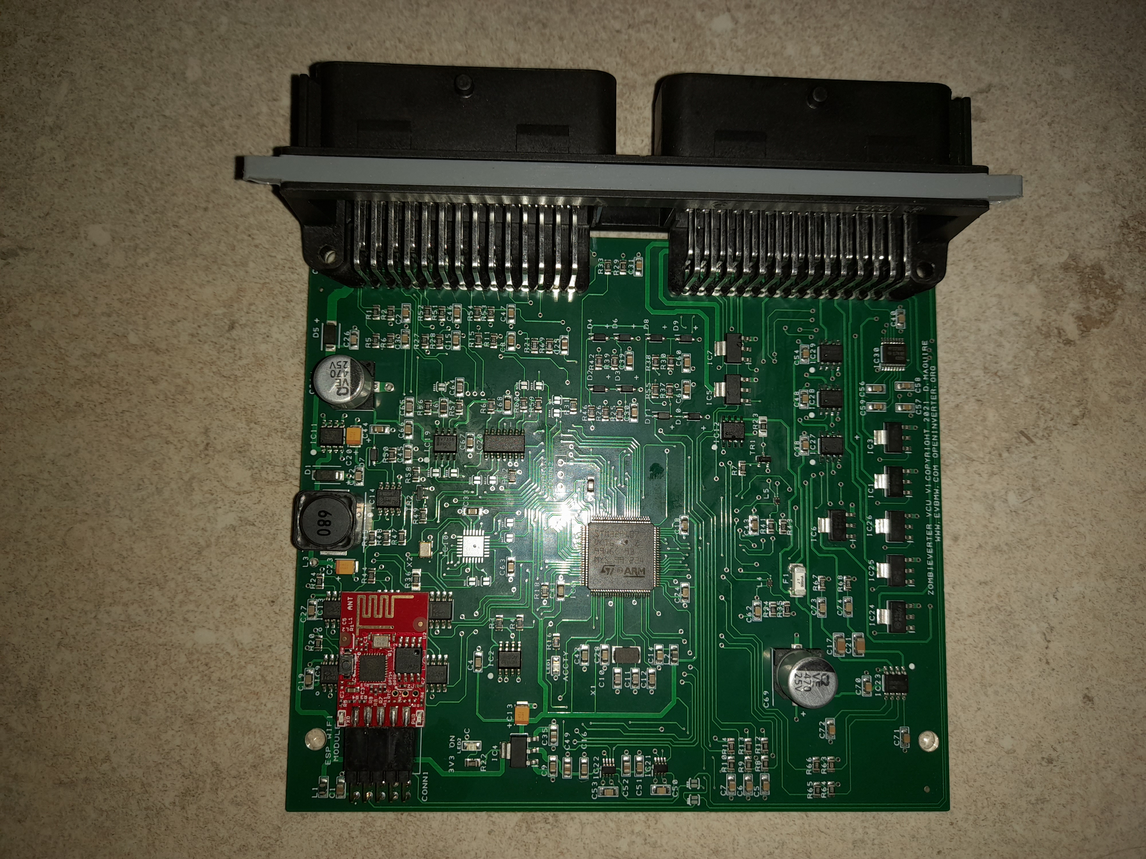

I’ve built up my Wemos WiFi adapter board. As Damien says it’s quite straightforward. The only thing to watch is that the back of the mini USB port doesn’t short the connector pins. For the 10 pin connector I used item 613010243121 from Mouser.
Can anyone confirm if the instructions for installing the software at https://openinverter.org/wiki/Olimex_MOD-WIFI-ESP8266 work for the Wemos module and the Zombieverter? Also should we be using Johannes web interface code https://github.com/jsphuebner/esp8266-web-interface or the GS450H VCU code https://github.com/damienmaguire/Lexus- ... aster/WiFi ? I can’t see any code specifically for the Zombieverter VCU.

dadiowe wrote: Thu Oct 27, 2022 8:42 pm Hi,
This .bin file is a blank file. I recall Damien giving me the link for it.
If you flash this file then power down and repower the Zombieverter then use the latest recommended .bin file on the github page it might cure your problem. I have tried thid method myself and it has worked for me.
This did not help for me, but thanks.
Also, I checked the tutorial video again from the part that covers the wifi issues, but it does not seem to provide a cure for this.
According to this thread viewtopic.php?t=1756, the problem might be a filled up flash.
All the symptoms seem to point to this direction.
Here is what I get with "http://192.168.1.26/list":
[{"type":"file","name":"chart.min.js.gz"},{"type":"file","name":"refresh.png"},{"type":"file","name":"remote.html"},{"type":"file","name":"gauges.js"},{"type":"file","name":"inverter.js"},{"type":"file","name":"gauges.html"},{"type":"file","name":"jquery.knob.min.js.gz"},{"type":"file","name":"gauge.min.js.gz"},{"type":"file","name":"log.html"},{"type":"file","name":"ajax-loader.gif"},{"type":"file","name":"README.md"},{"type":"file","name":"log.js"},{"type":"file","name":"style.css"},{"type":"file","name":"jquery.core.min.js.gz"},{"type":"file","name":"syncofs.html"},{"type":"file","name":"wifi-updated.html"},{"type":"file","name":"wifi.html"},{"type":"file","name":"stm32_vcu"},{"type":"file","name":"stm32_vcu.bin"},{"type":"file","name":"chartjs-annotation.min.js.gz"},{"type":"file","name":"index.html"},{"type":"file","name":"index.js"}]
I have not used different names for the bin file, so there is actually only one of those. Is there perhaps something else that could be clogging up the flash?
I do not have any clue as to which of these files can be deleted and which ones are needed.
Can somebody check the list above and tell me which ones I can toss.

EV_Builder wrote: Mon Oct 31, 2022 9:51 am You need recursive enabled to download sub repo's.
I use this code from the wiki:
git clone --recurse-submodules git@github.com:damienmaguire/Stm32-vcu.git
I get the error about the key, and the command fails... the.zip file downloaded from the repo has the empty folders when unzipped
But further, I haven’t had success uploading the .bin or .hex file for the GD chip with stlink or over the web interface.
I uploaded the bootloader and got the accty led blinking, but it goes dead after “uploading” the firmware and I have no serial communication. I really don’t want to have to unsolder the chip and replace it, because I don’t have a hot air station

Why have you got the 'git@github' thing in there? You're trying to authenticate as the user 'git' on the github servers, which is unlikely to work...

Try
https://github.com/damienmaguire/Stm32-vcu.git
. The one on the wiki assumes you've got your own github account set up with ssh public key auth

Looks like I need a break.... The GD chip doesn't want to cooperate, and now I'm suddenly getting USB communication error in stlink utility
A quick rundown of my problem trying to program this thing:
First started by uploading precompiled GD chip with Stm32-vcu.hex with stlink... Utility showed successful, but no blinking ACCTY LED
Eventually programmed bootloader with stlink and successful blinkenlight ACCTY LED
Eventually got esp wifi interface programmed and able to view web interface on my laptop browser
Attempting to upload precompiled GD chip Stm32-vcu.bin with wifi interface showed "Upload Successful" instantly, with no progress bar
Uploading Stm32-vcu.bin with stlink gave similar results as wifi interface method... both show as successful, but no firmware seems to have actually loaded.
I've cloned the git and installed ARM toolchain (but get the error of arm-none-eabi-gcc command not found) when building so I messed that up probably due to my shitty terminal skills
If anyone has successfully programmed a GD chip... I'm all ears

sigdigits wrote: Tue Nov 01, 2022 7:53 pm Attempting to upload precompiled GD chip Stm32-vcu.bin with wifi interface showed "Upload Successful" instantly, with no progress bar.
I don’t think your .bin file has uploaded. When I upload it I also see the “upload successful” message instantly, then after a few seconds the progress bar appears and progresses very slowly. Often it freezes before it gets to 100%. I have to repeat the process several times before it it gets to 100%.

AdrianB wrote: Wed Nov 02, 2022 8:54 am I don’t think your .bin file has uploaded. When I upload it I also see the “upload successful” message instantly, then after a few seconds the progress bar appears and progresses very slowly. Often it freezes before it gets to 100%. I have to repeat the process several times before it it gets to 100%.
The .bin file definitely didn't load, I'm well aware... Pretty sure I caused it to get stuck, because the bootloader was uploaded successfully and I had a blinking ACCTY led, but no longer. I honestly don't remember if I tried uploading the GD Stm32-vcu.hex with stlink, or the .bin with wifi interface first. In any case, the uploads were not successful, and I don't have the blinking LED indicating the bootloader is running so I'm pretty sure that means uploading via wifi is out.
Unfortunately, I can no longer connect to the target in stlink utility because it fails target detection. I've tried powering on the chip with reset tied to ground, 3.3V, boot0 tied to ground, 3.3v and none allow the stlink to recognize or connect to the chip.
Stlink utility will go in circles saying change settings to "connect under reset", then when you do to set to "normal or hotplug". Changing SWD frequency has no effect
Messages from stlink utility console:
"Can not connect to target!
If you're trying to connect to an STM32W1xx device, please select Normal or HotPlug mode from Target->Settings menu.
If you're trying to connect to a low frequency application , please select a lower SWD Frequency mode from Target->Settings menu.
13:12:15 : No target connected
13:12:32 : Can not connect to target!
Please select "Connect Under Reset" mode from Target->Settings menu and try again.
13:12:34 : No target connected"

Hi guys, new to the forum. Have recently purchased the zombieverter vcu from Damien and had it assembled as per video but still have to fit IC 10 as not supplied in the kit. After connecting the resolver cables and doing a basic power check using 12v volt battery the micro controller IC 8 started giving off smoke signals so I quickly disconnected. Where have I gone wrong.
IC 8 Giving off smoke signals
I am using the lexus 300h and inverter.
