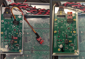

Common Issues
If experiencing connection issues, try different cables to rule out bad connectors ( apparently common with recent Olimex)
  • The settings & partition size in Arduino Studio are easy to get wrong. [1]
  • If you get any of: 1) incomplete responses via HTTP 2) patchy WiFi on a logic board 3) parameters from logic board not loading in web interface; you can try powering the ESP8266 from a different source, or connect it via DuPont leads to rule out connector & plug issues (see photographs).
  • If you are all out of luck, there are alternative boards discussed here [2]
