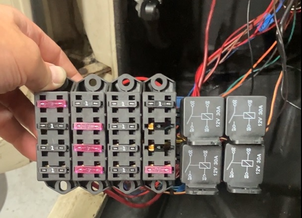

Ghia66 wrote: Tue Jul 02, 2024 8:45 am Your fuse and relay setup is so neat! Well jell!
thank you, I really feel more comfortable now knowing what each and every fuse does (now if I could only remember what they do six months from now)
DIY EV Fuse & Relay Block Overview

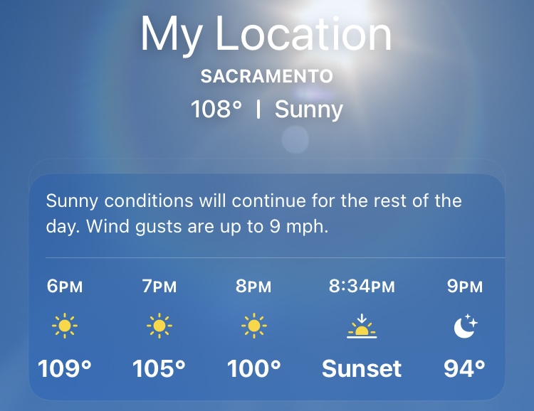

Post by Gregski »
Everyone: So Greg when are you gonna drive this thing?
Me: well when the floor of my garage drops below napalm so I can crawl under it and secure the high voltage lines with some quality Cardboard Freight zip ties
I don't think I ever saw 100 effs until sunset before

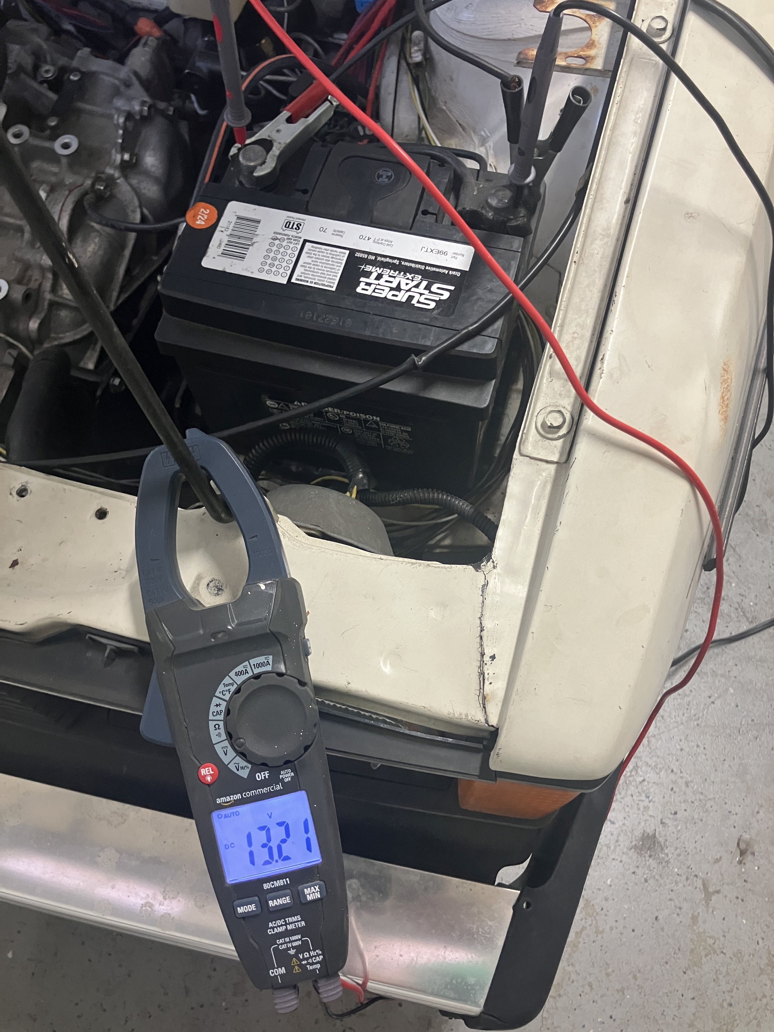

ha ha, you must have missed the wide open charger port door latch thingie causing drag and slowing her down
she's already registered and insured, all we need to do is persuade her to charge, the Zombie thinks we're charging but there's no amps going into the pack, I suspect the Control Pilot signal

Re: [FIRST DRIVE] 1984 Voltswagen Rabbit Prius Gen 3 ZOMBIE
can log G man, can logs.
Posts: 1156
Has thanked: 246 times
Been thanked: 469 times
Post your prams!

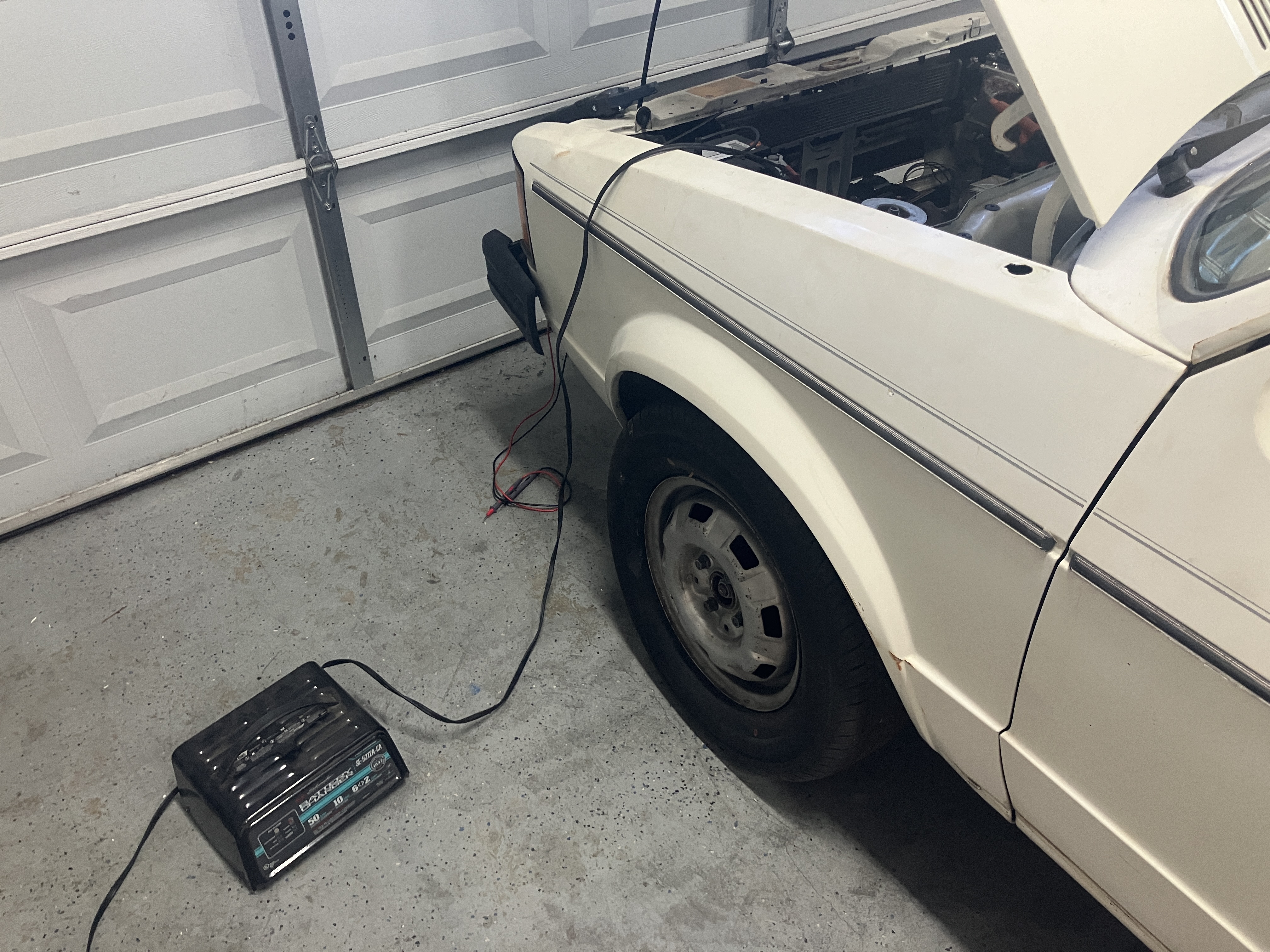

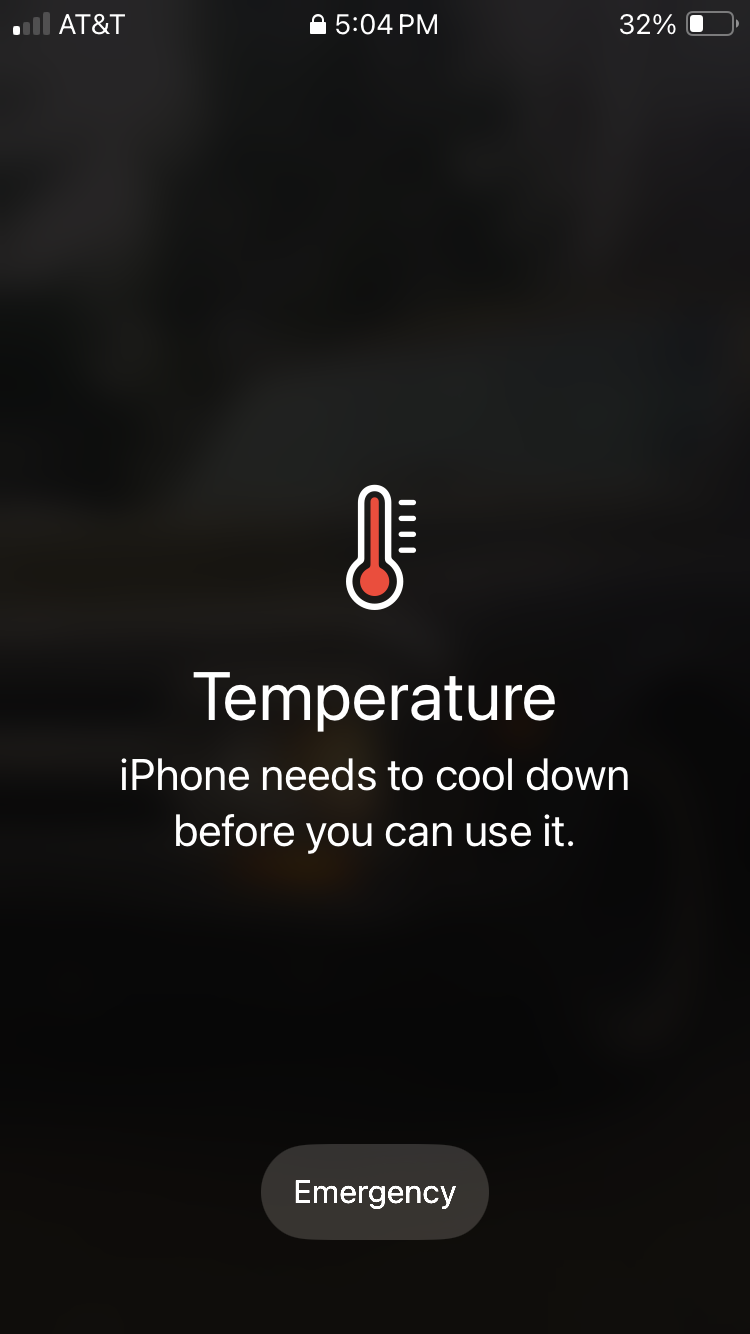

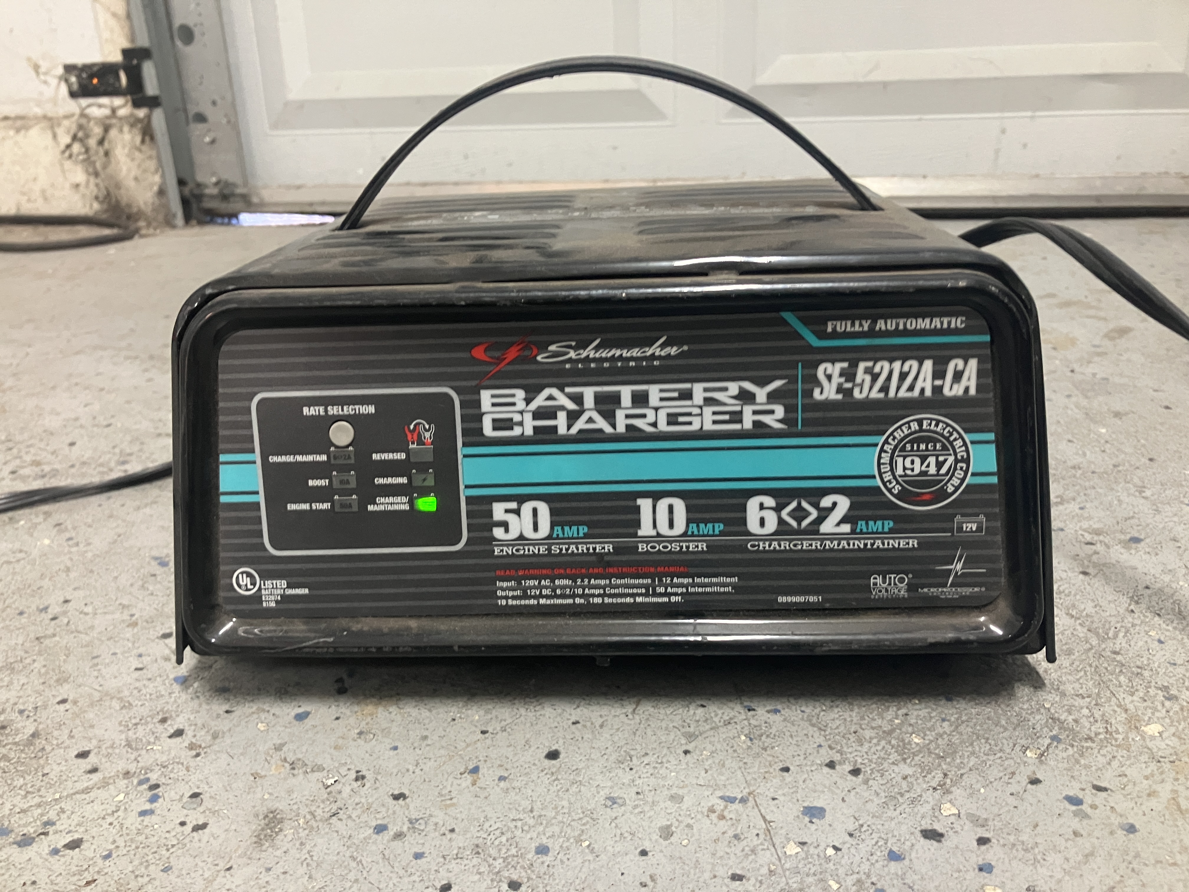

Post by Gregski »
thank you all for trying to help, please know I am not being defiant, I am going to the garage as often as the heat will allow it
last night I realized that despite of what Nigel says, some things are not better at 11, so chargerized the brand new expensive regular "12 volt" car battery to 13
