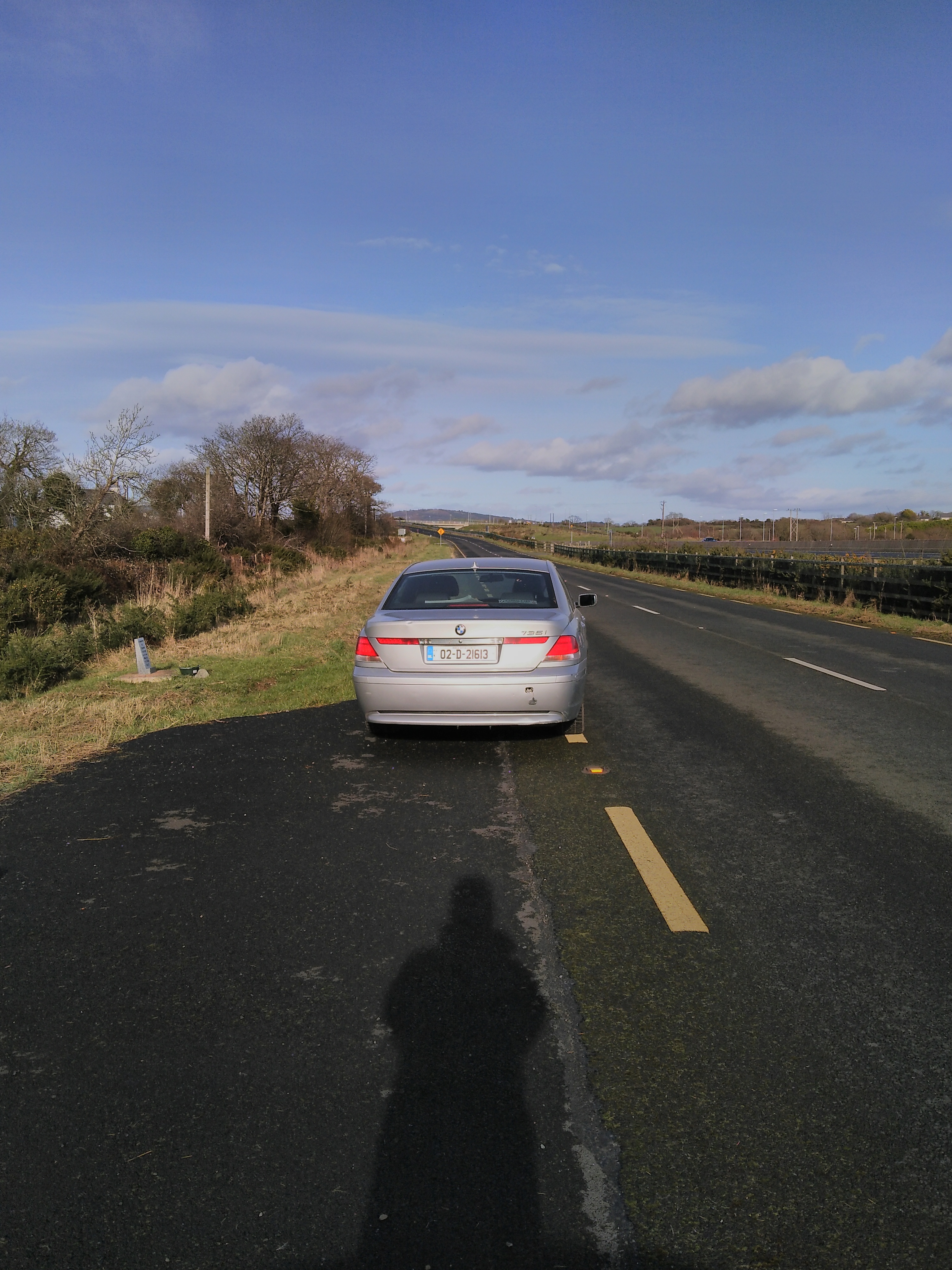

mfox wrote: Sat Dec 21, 2019 1:10 am How much power is expected ?
Estimates are 220kW/300HP... we won't know for sure until we stick it on the dyno in the spring.
Over the next three months we will measure acceleration, top speed, test the dual speed gearbox, and validate cooling strategies. We will also get the car inspected by an automotive engineer, change taxation to electric drive, and get it through a national vehicle test.
Once all that's complete we'll put some miles on it as a daily driver and undertake some towing tests at the 2100kg car limit. Then it's long range battery, CCS rapid charging, etc., etc. :D

The Super Yacht (aka BEXUS) was inspected and passed by an automotive engineer today... next steps include changing the taxation class to electric drive, NCT, and testing on track and road 8-)

So with today's testing of the Bexus (current weight 2050kg) and a crappy 450v battery that sags like a ton of bricks under load the car was pulling like a train up through 70mph up a hill. So imho we don't need 650v.
