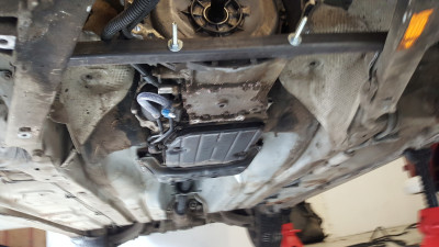

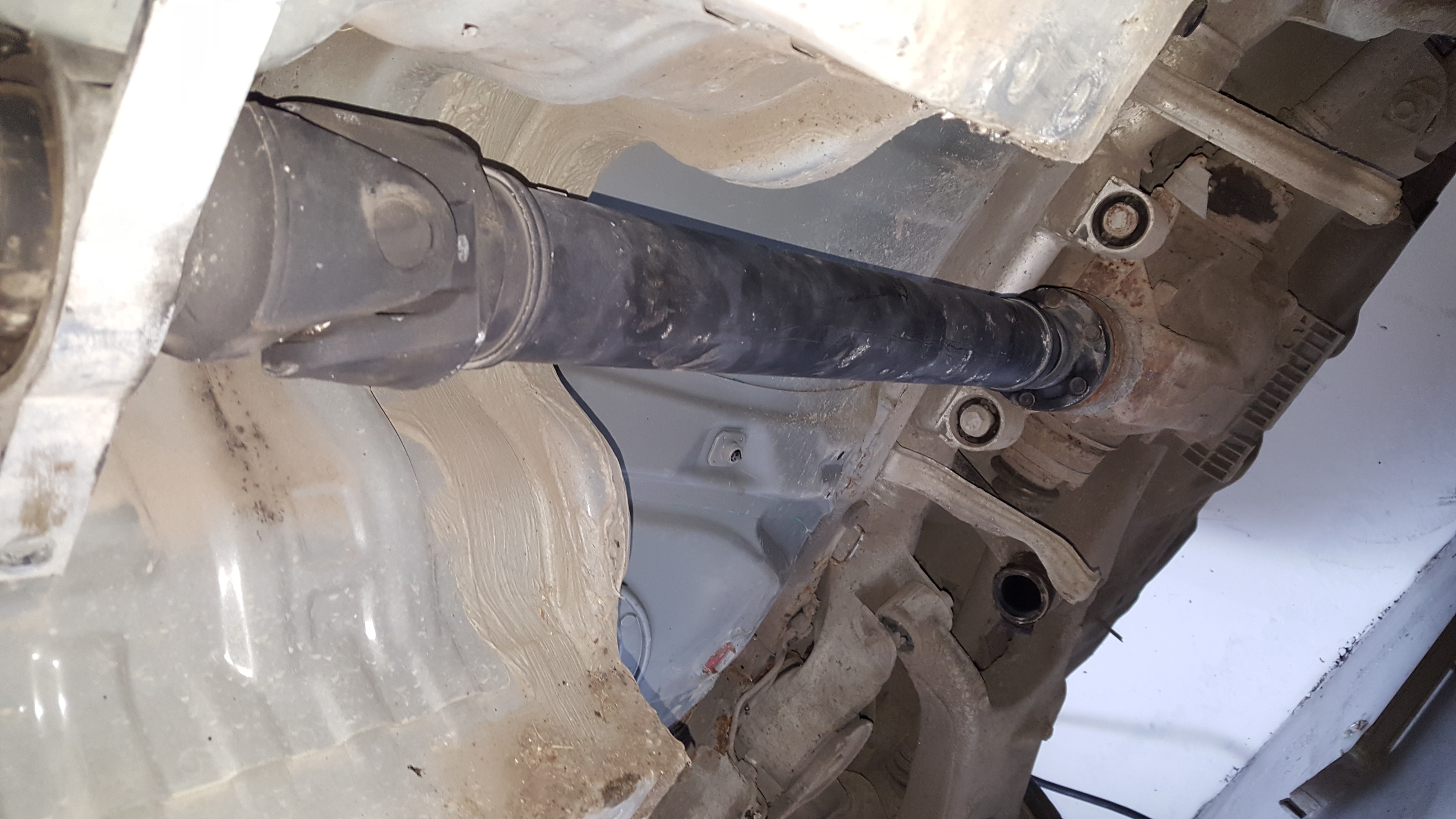

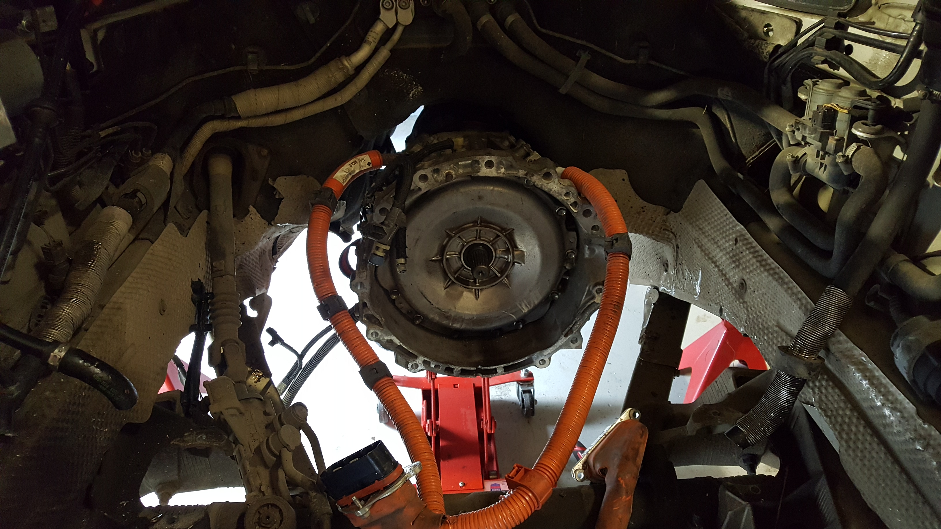

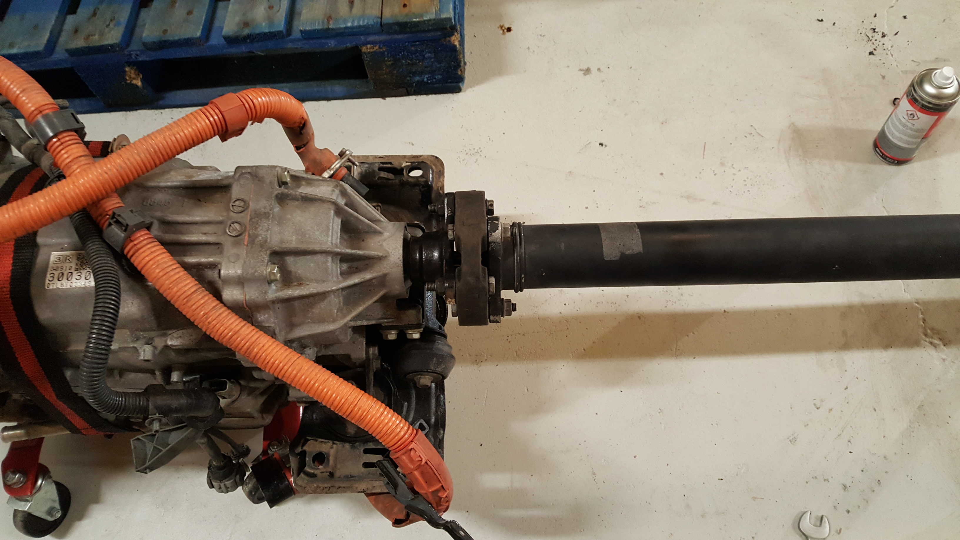

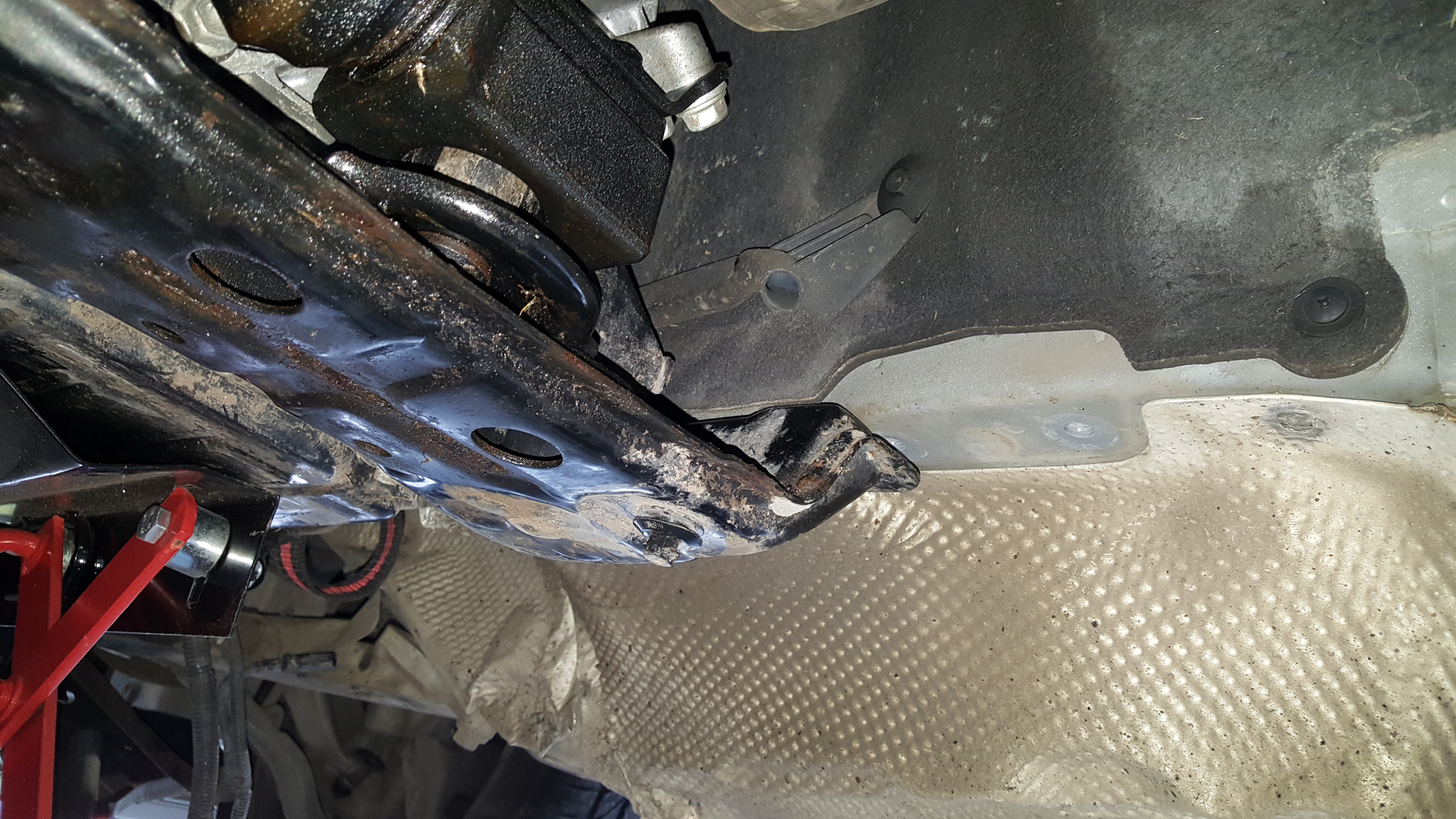

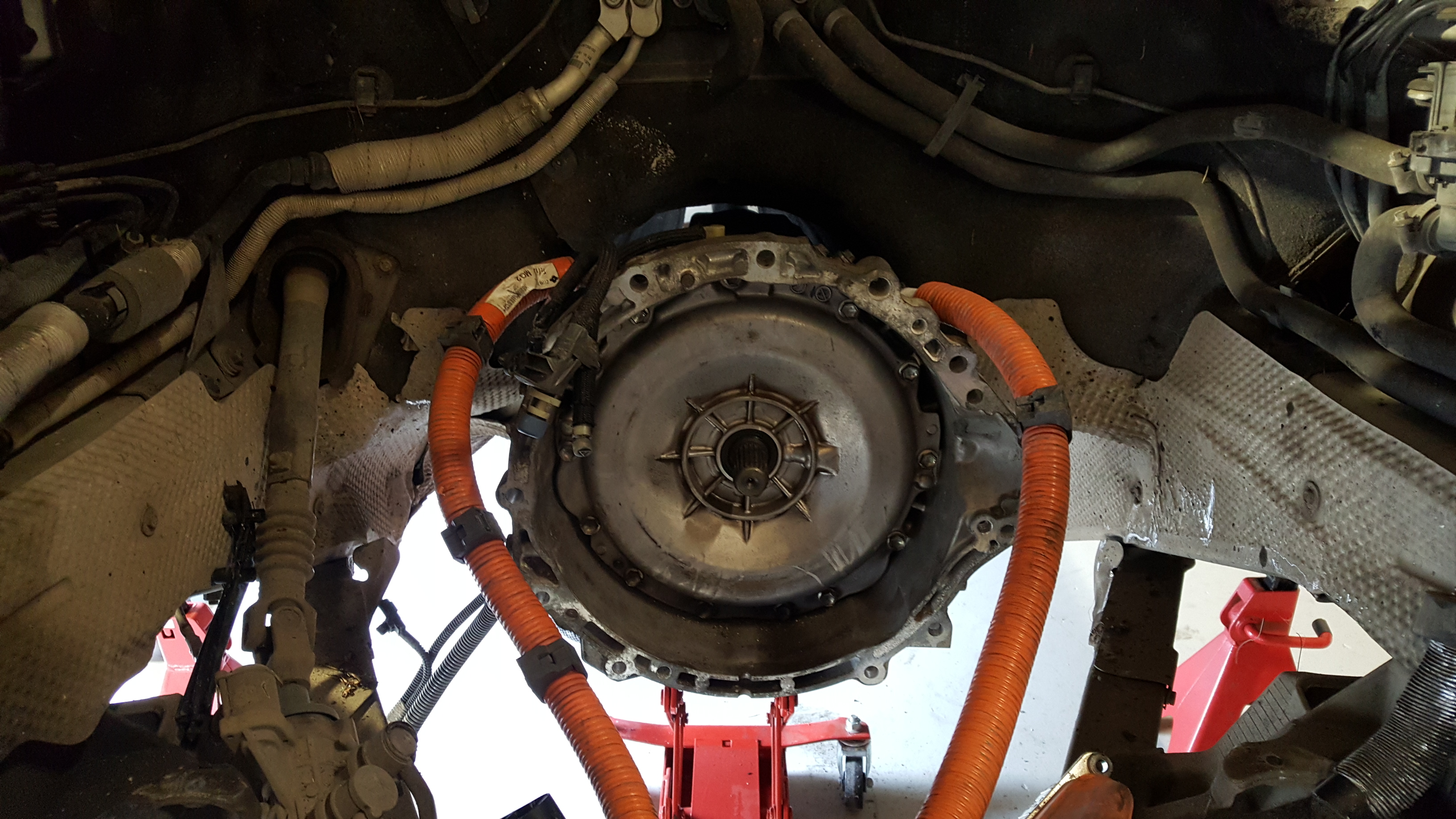

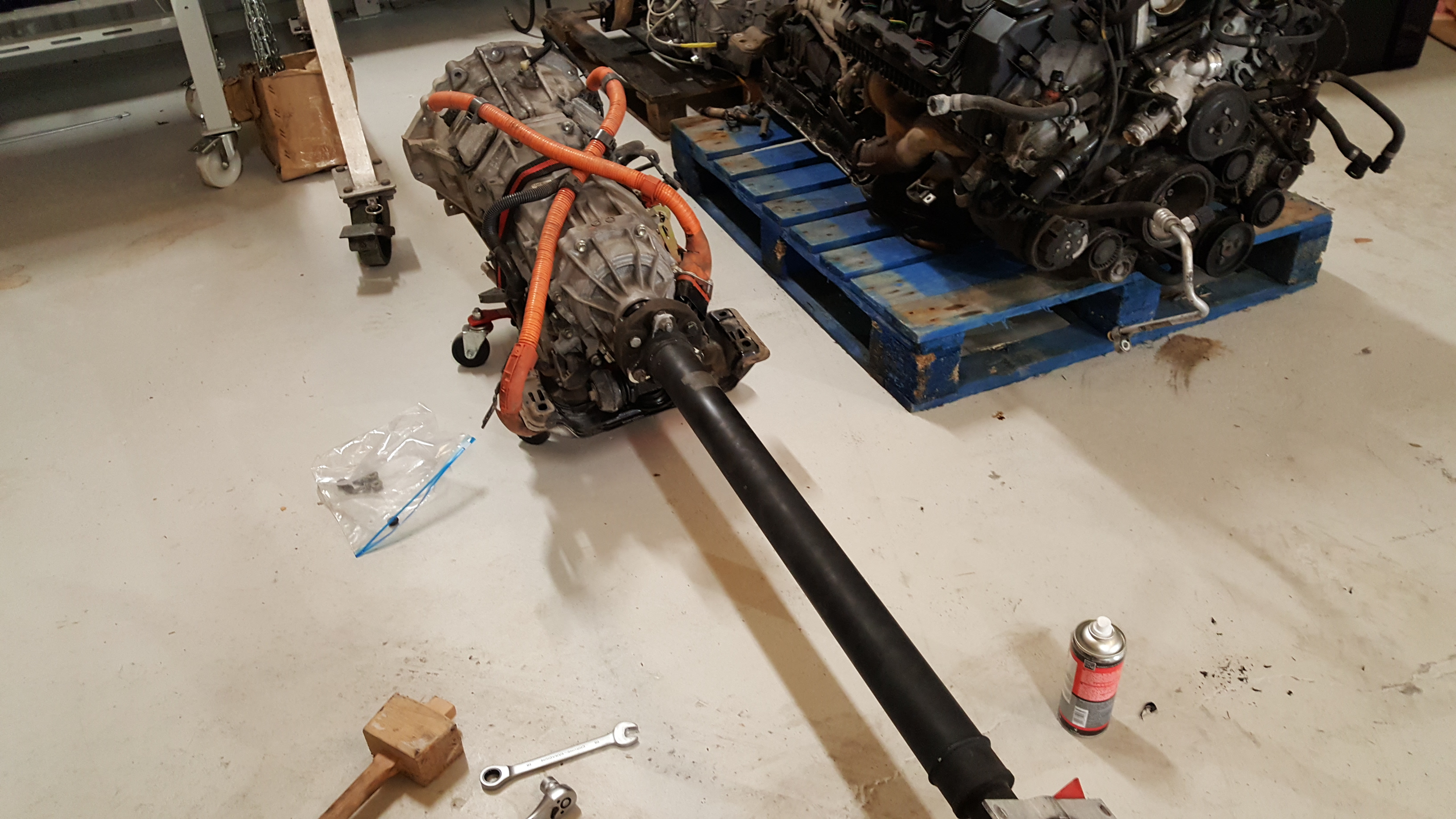

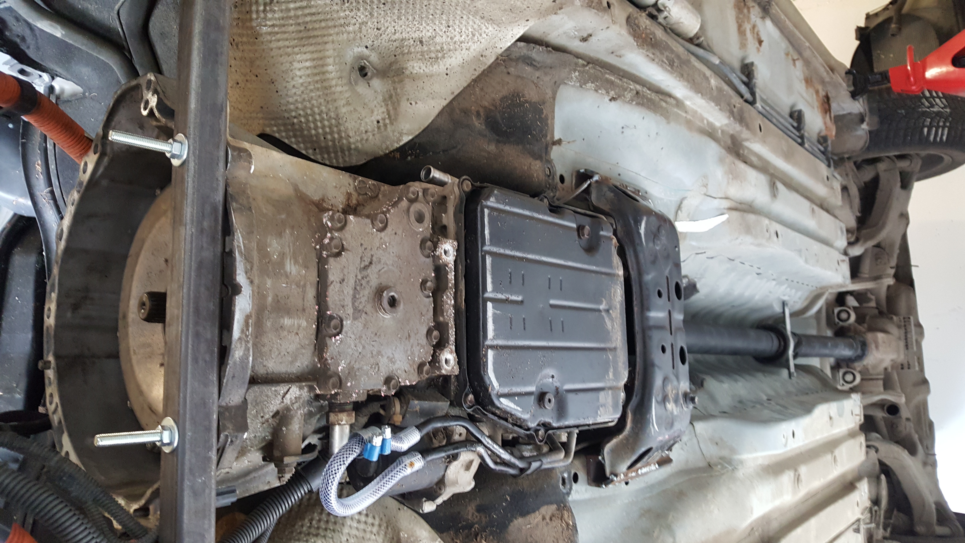

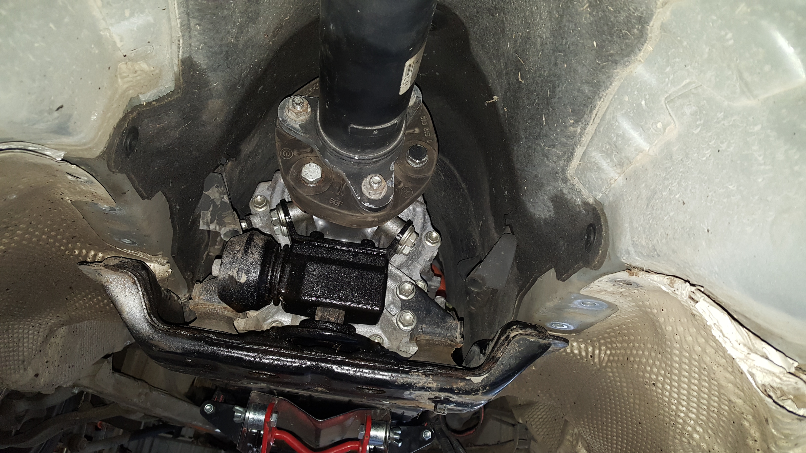

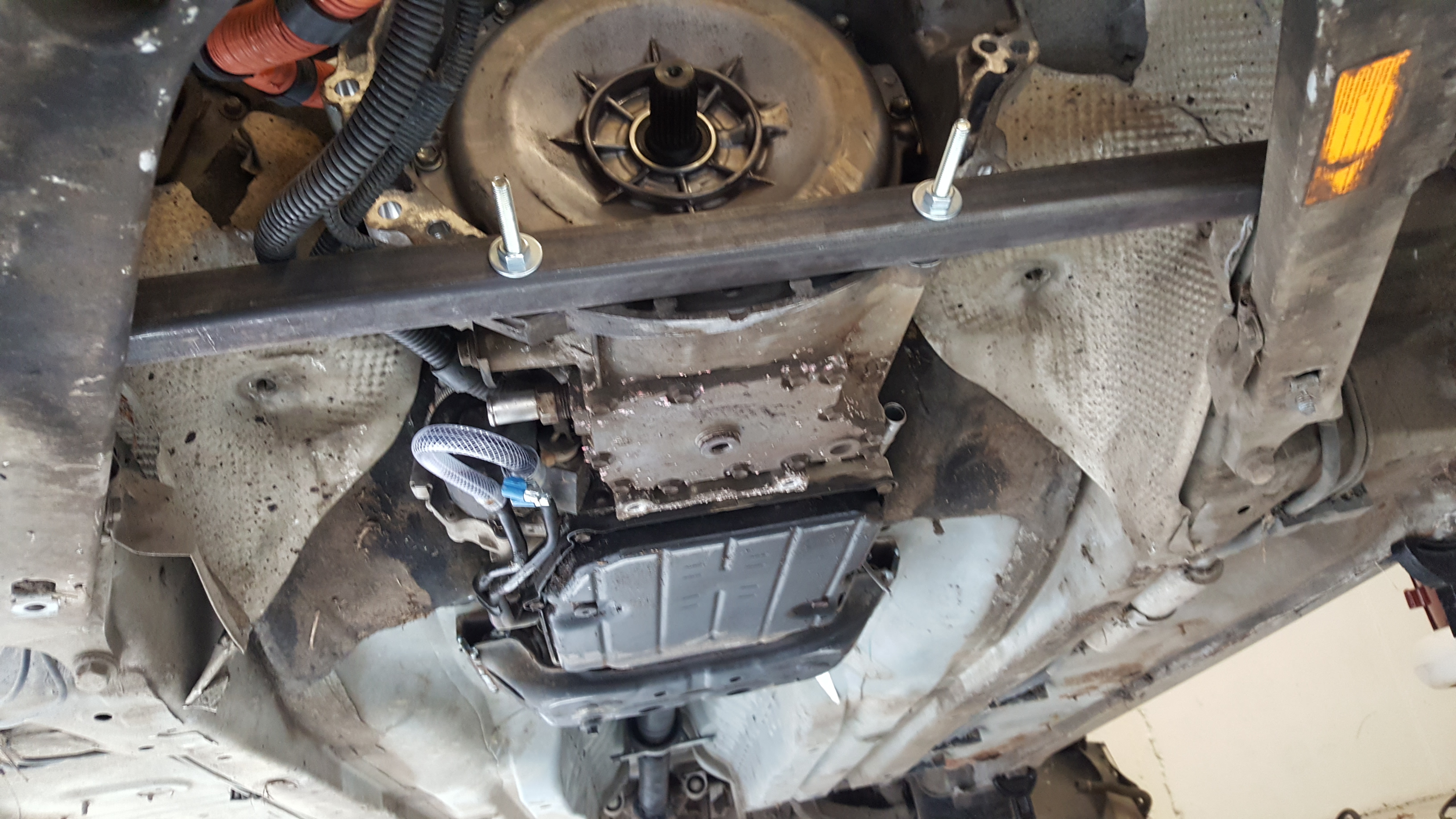

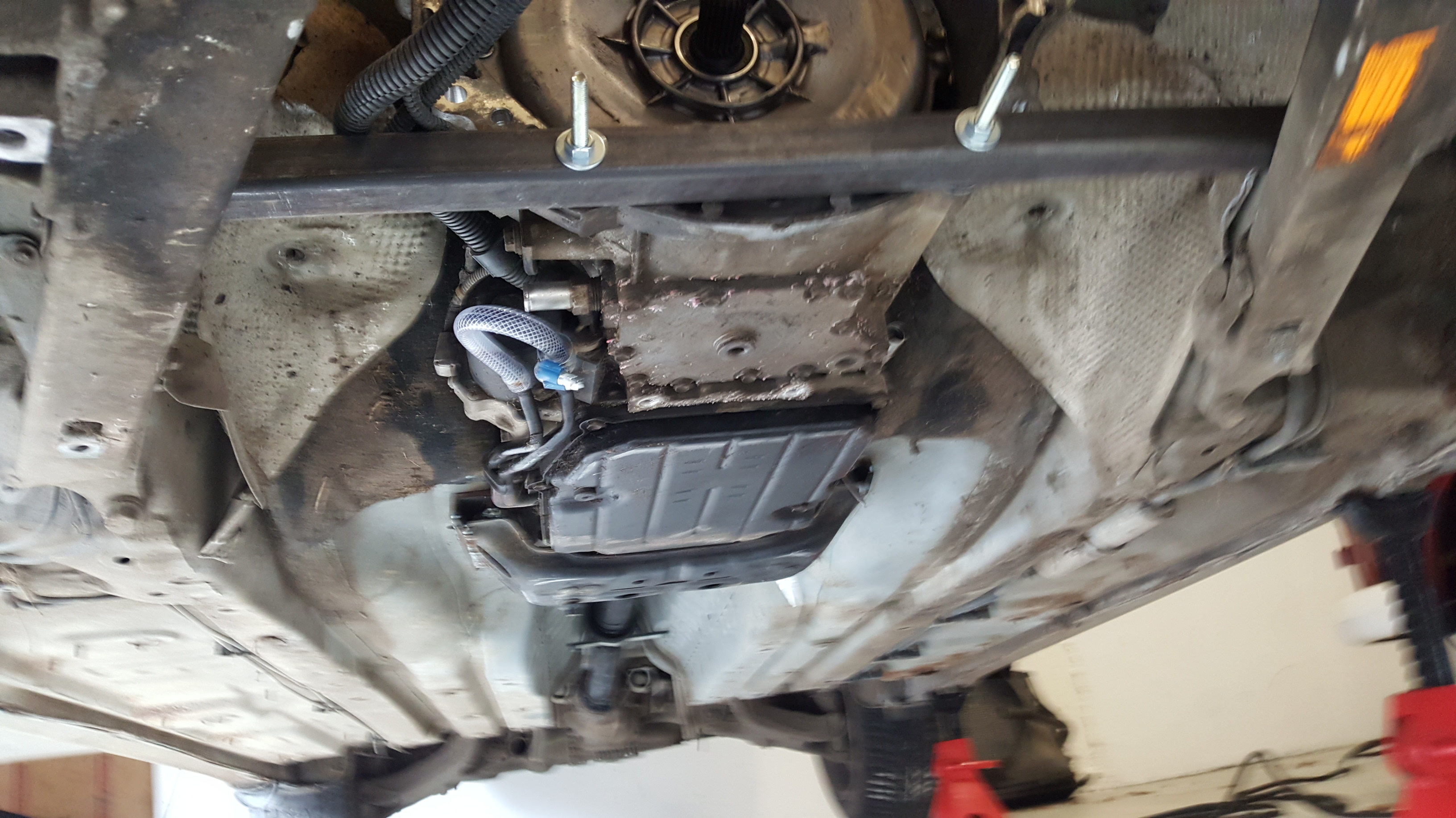

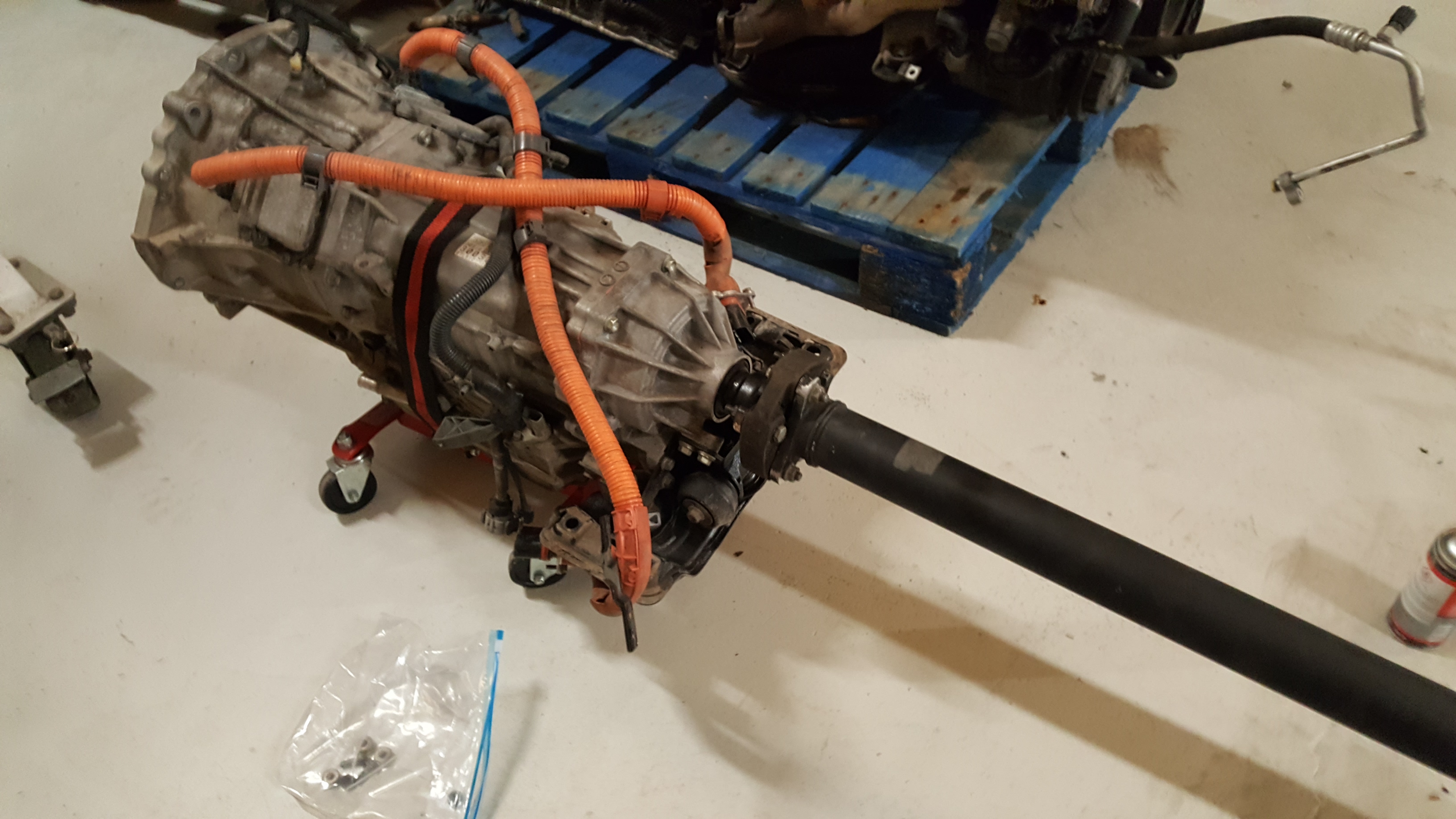

Got the Lexus crossmember modified to fir the bmw mounts. Propshaft re installed and made a temporary front mount. All installed and looks great. Next up is a wheel spin with a Prius inverter.

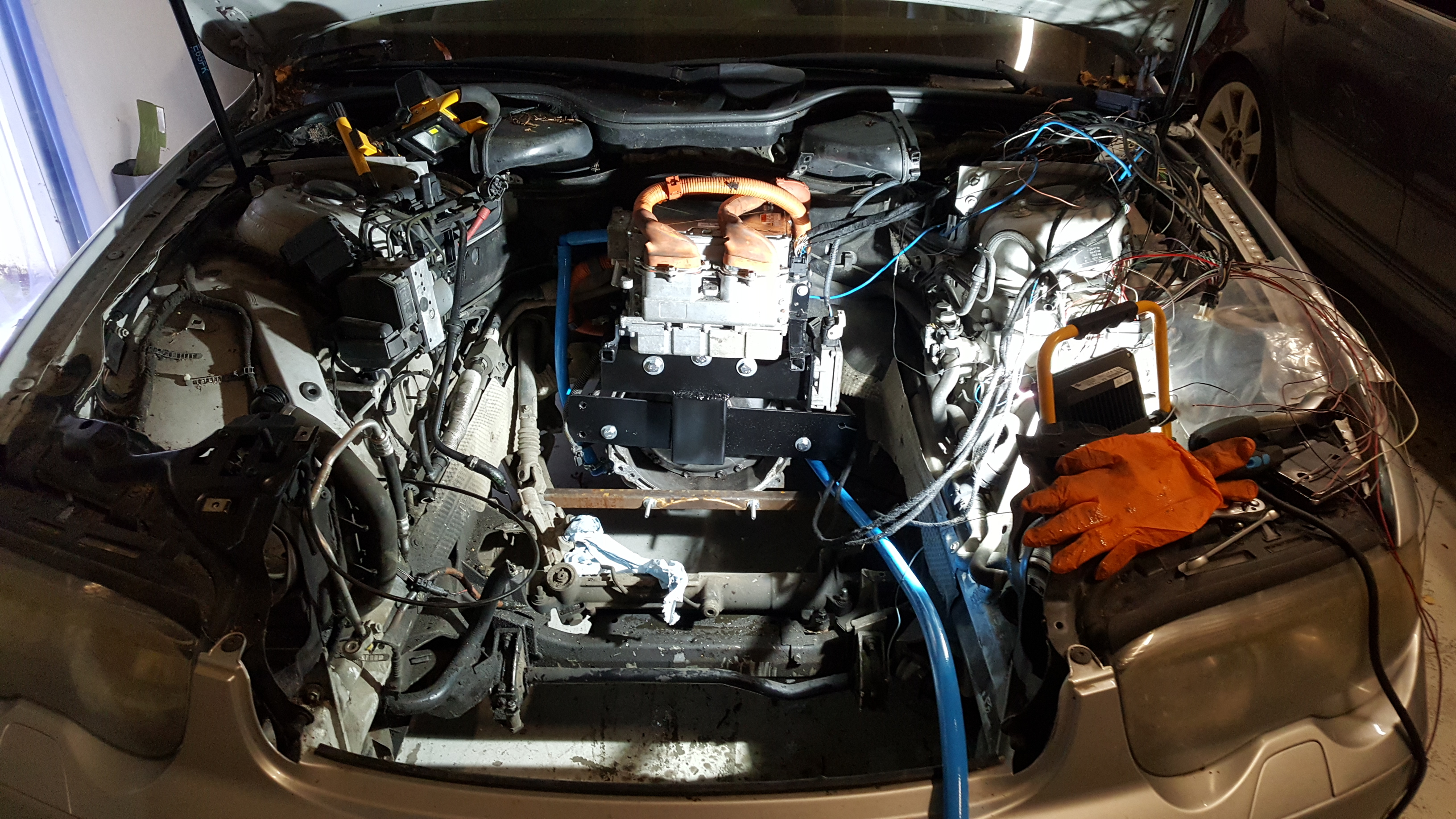

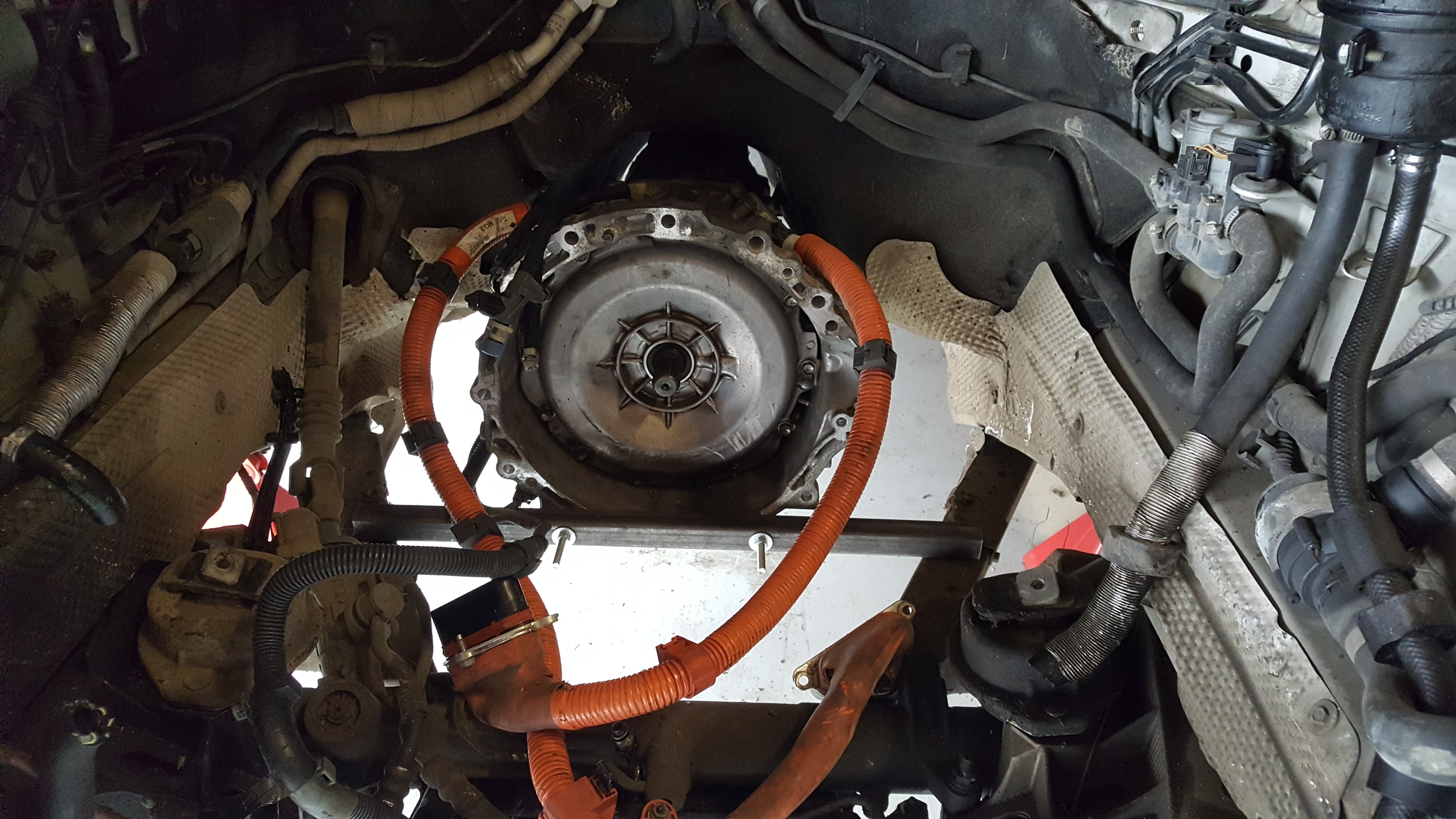

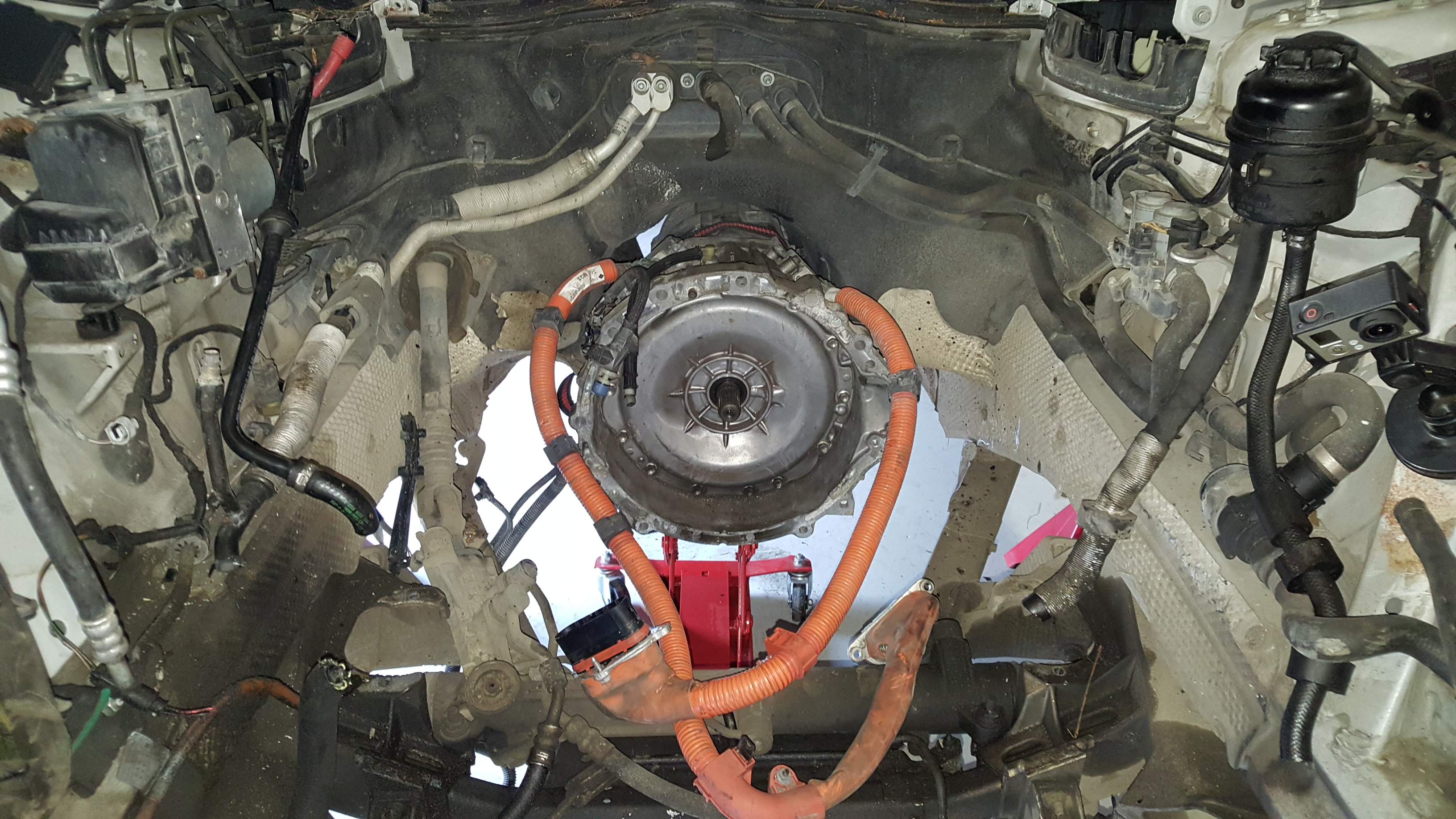

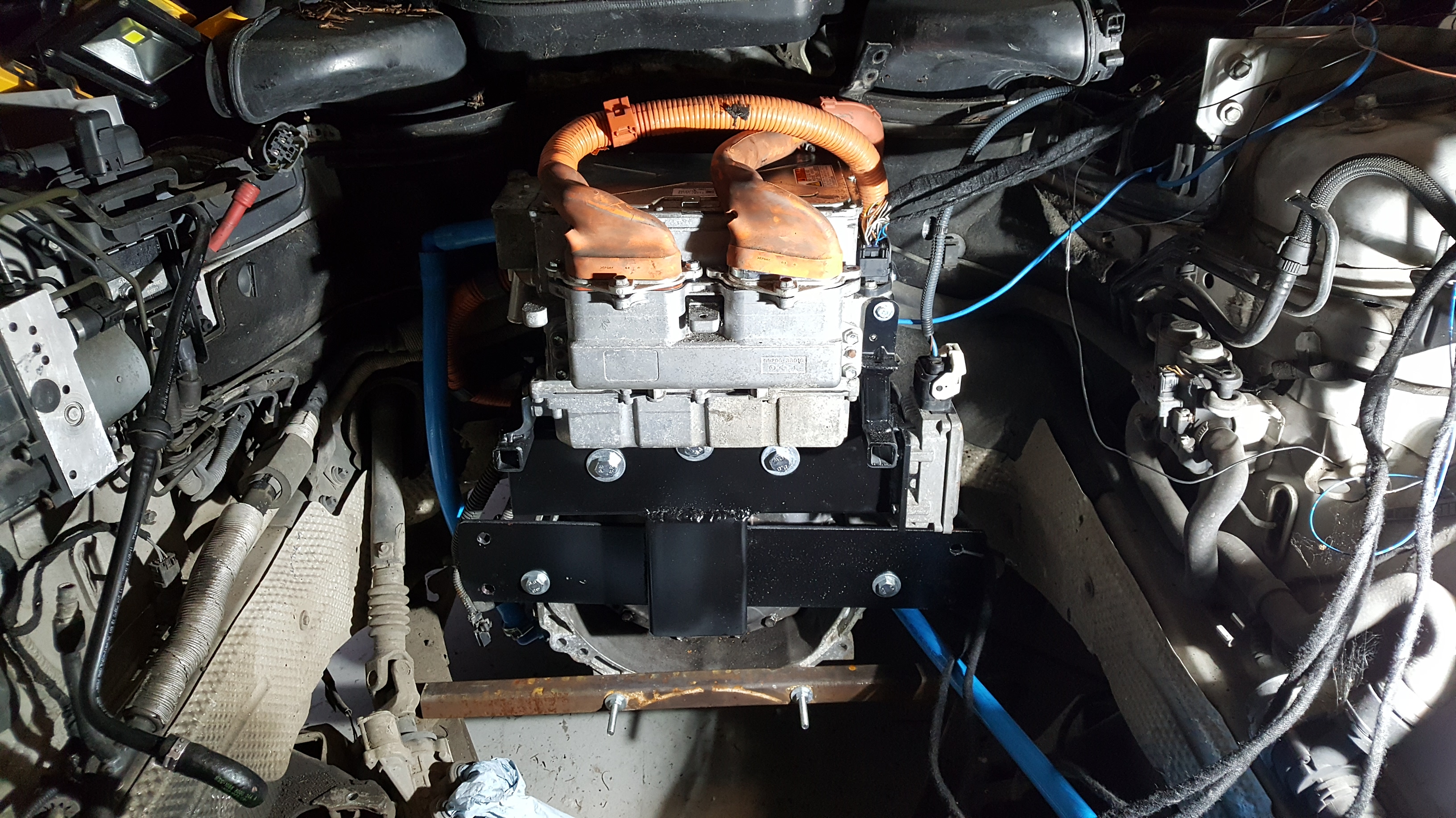

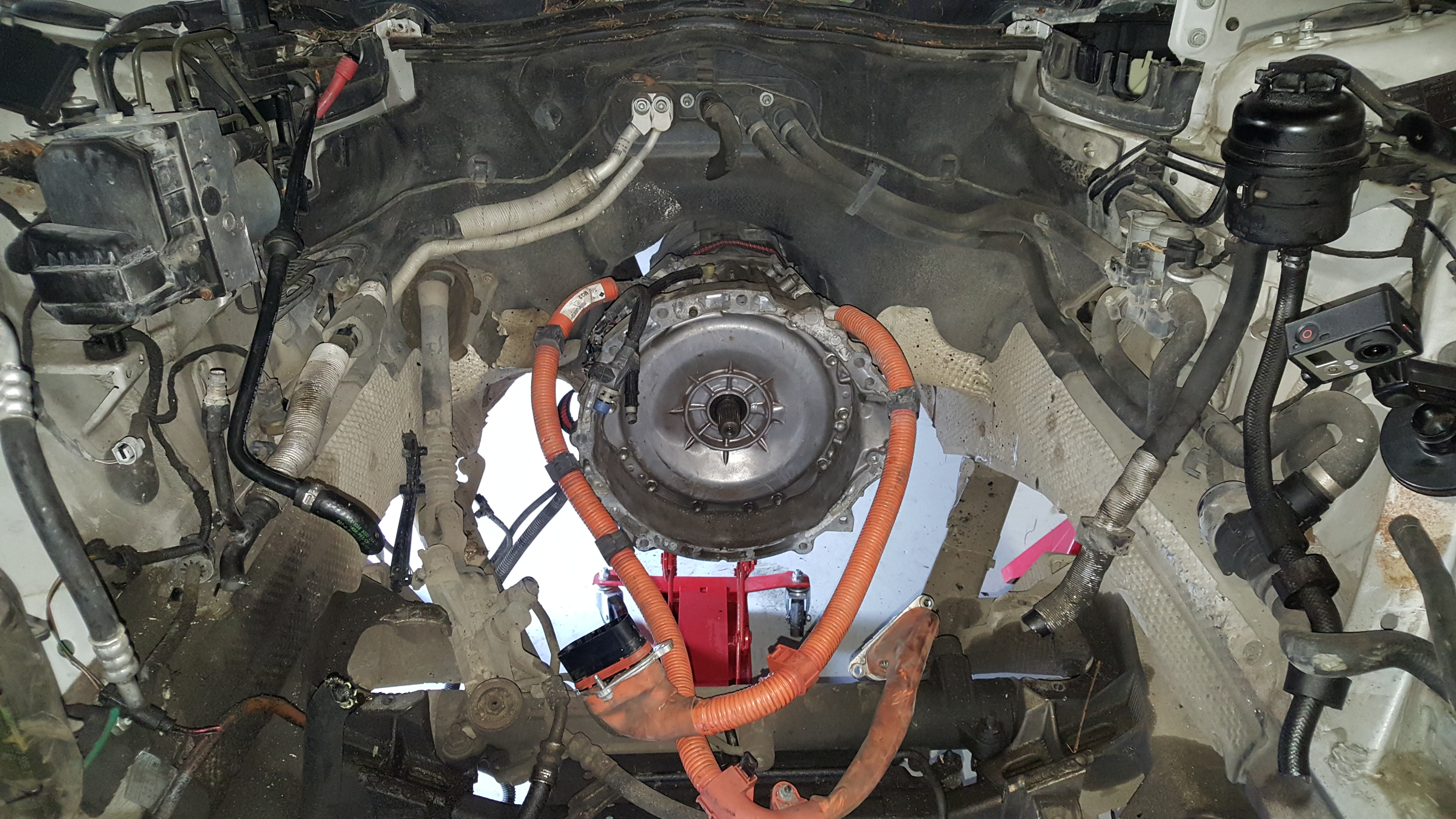

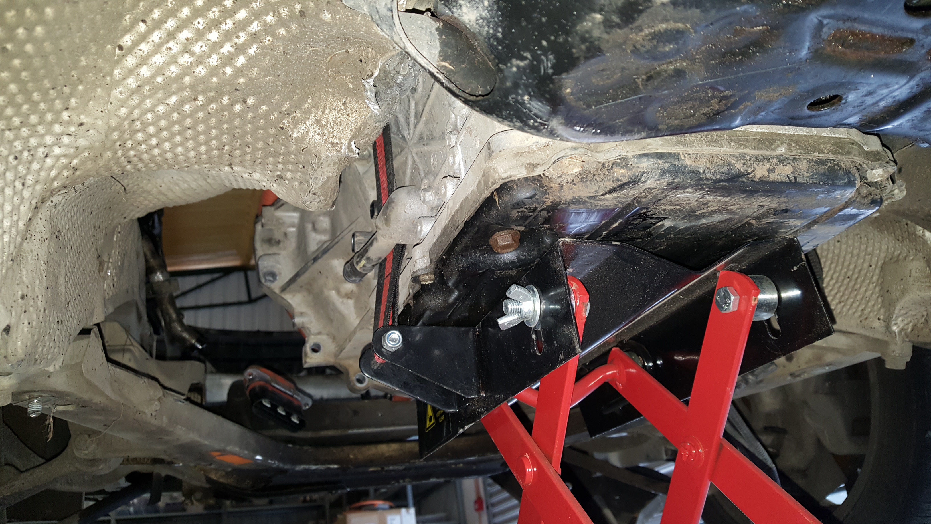

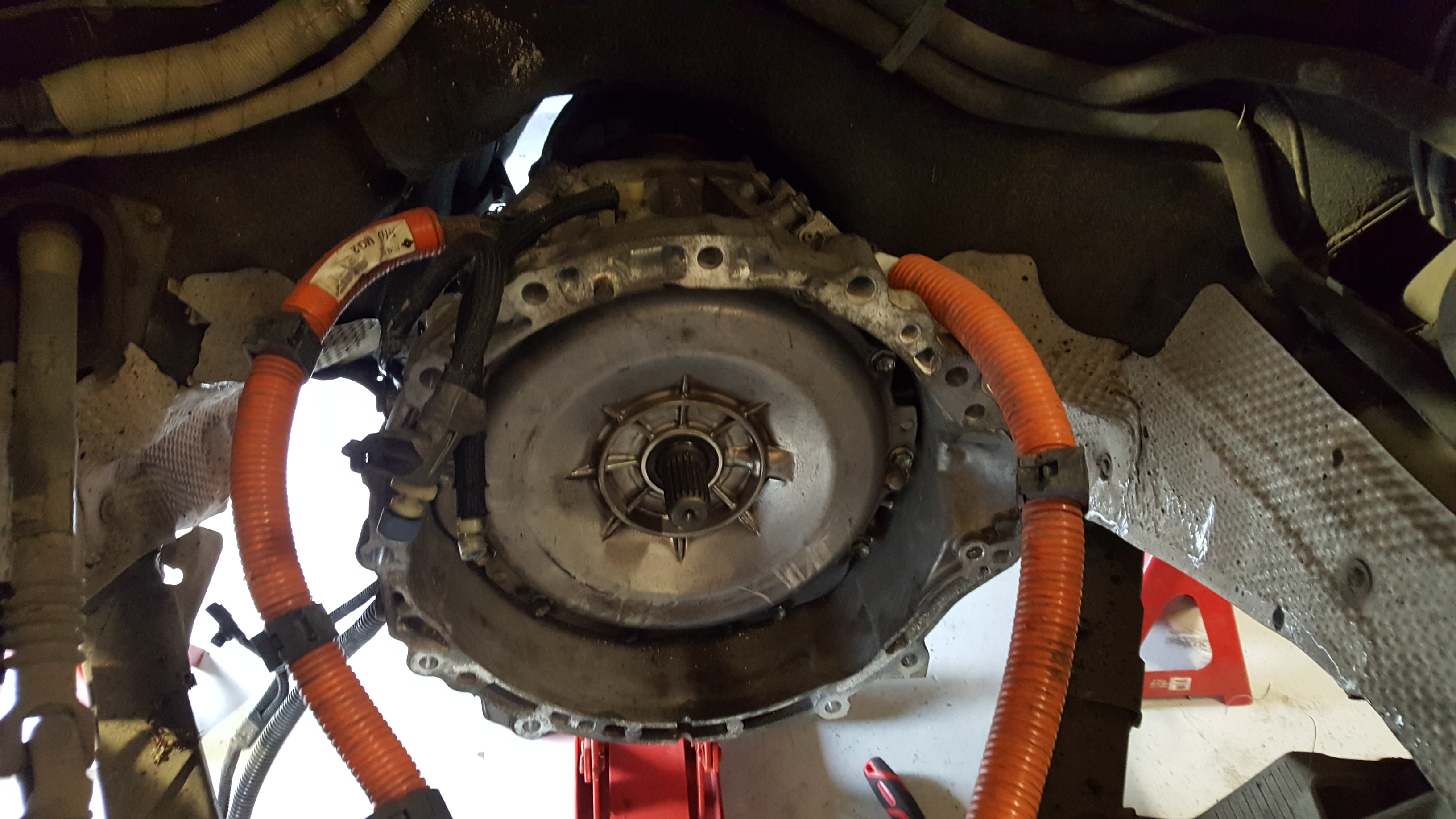

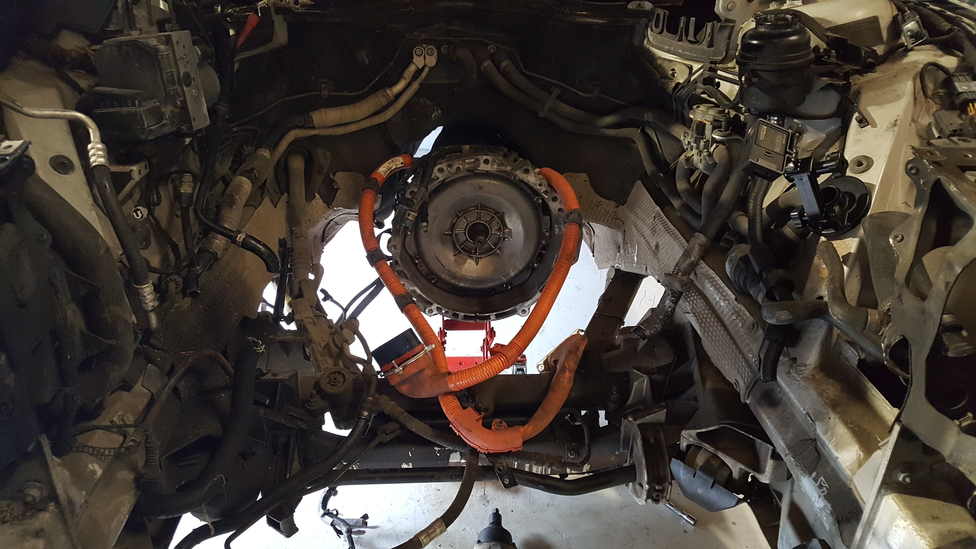

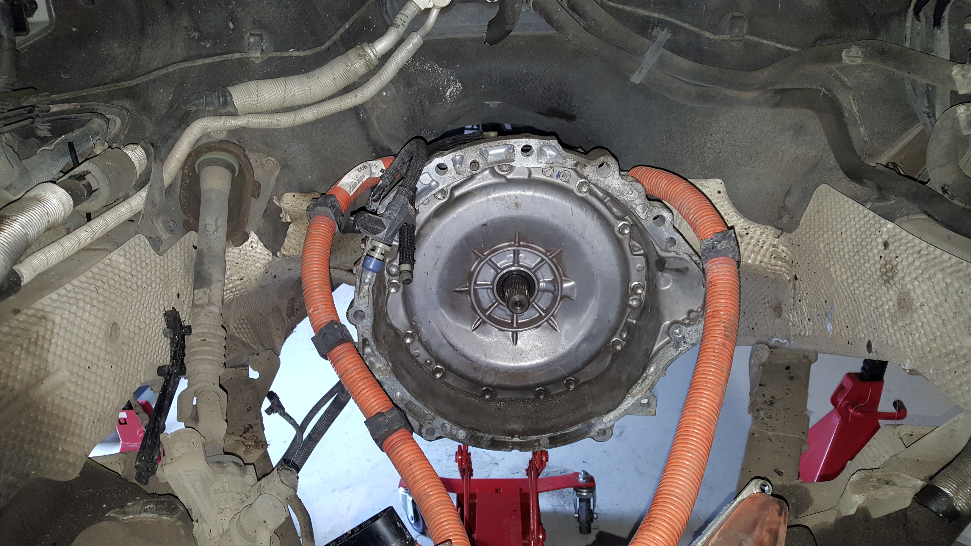

Inverter and front mount for the GS450H gearbox fitted.

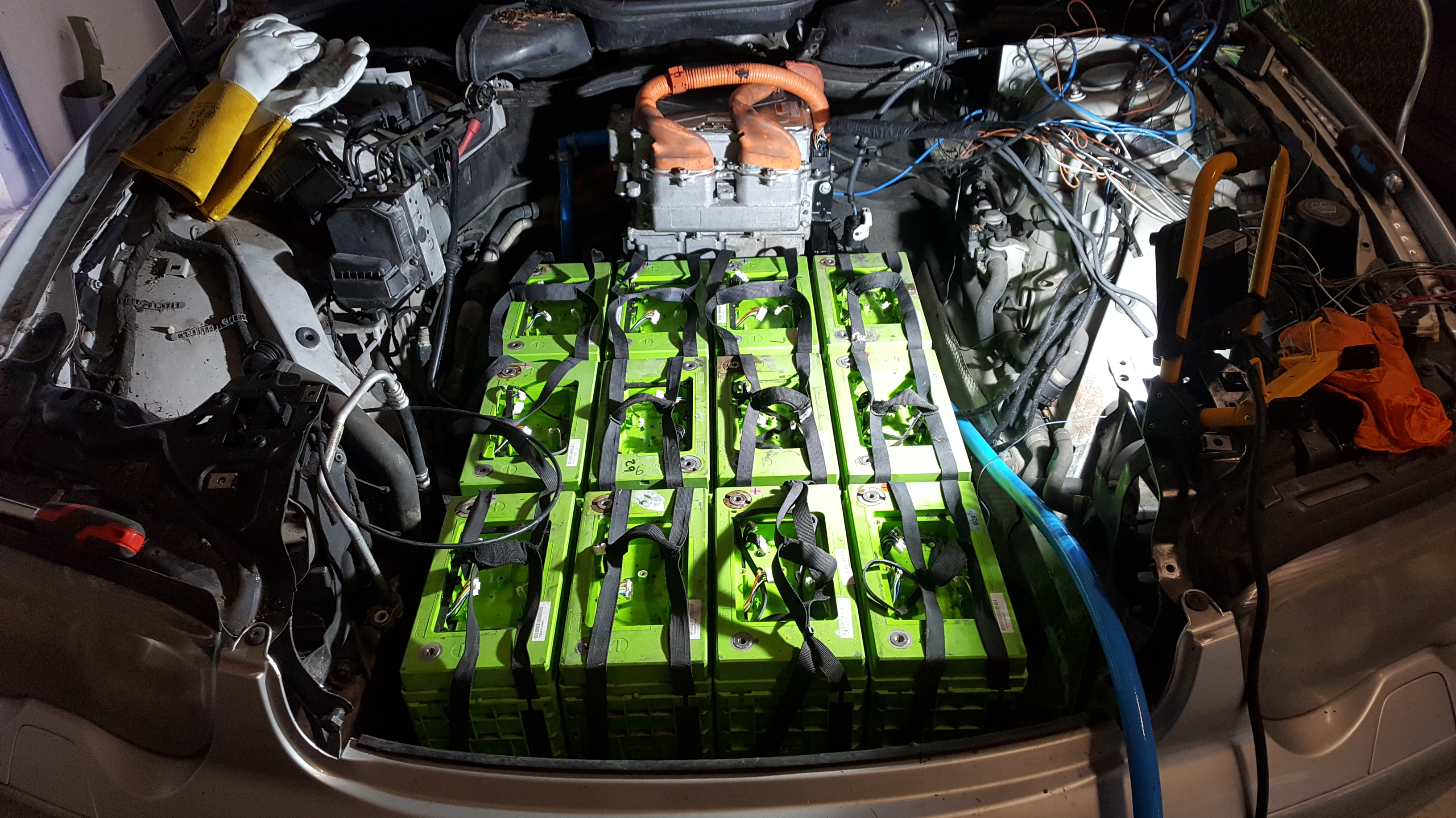

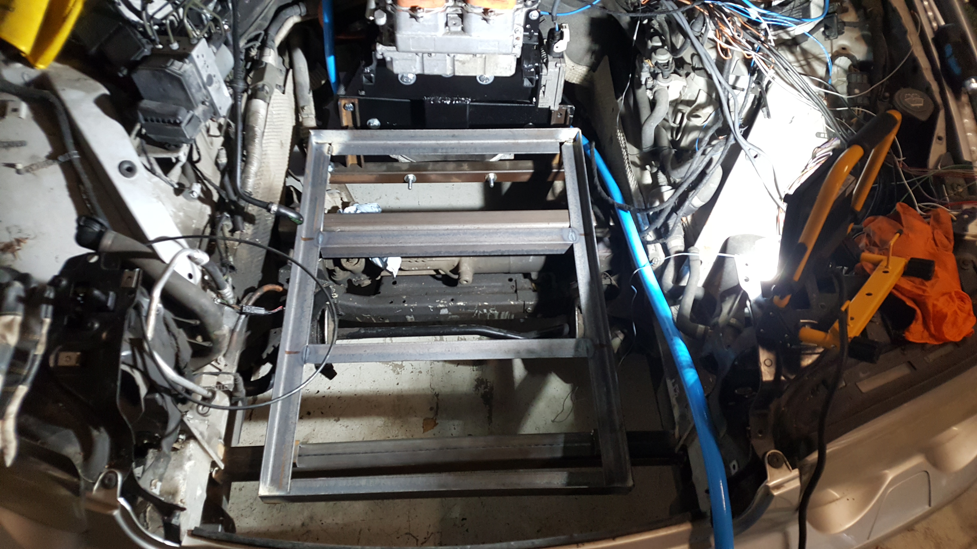

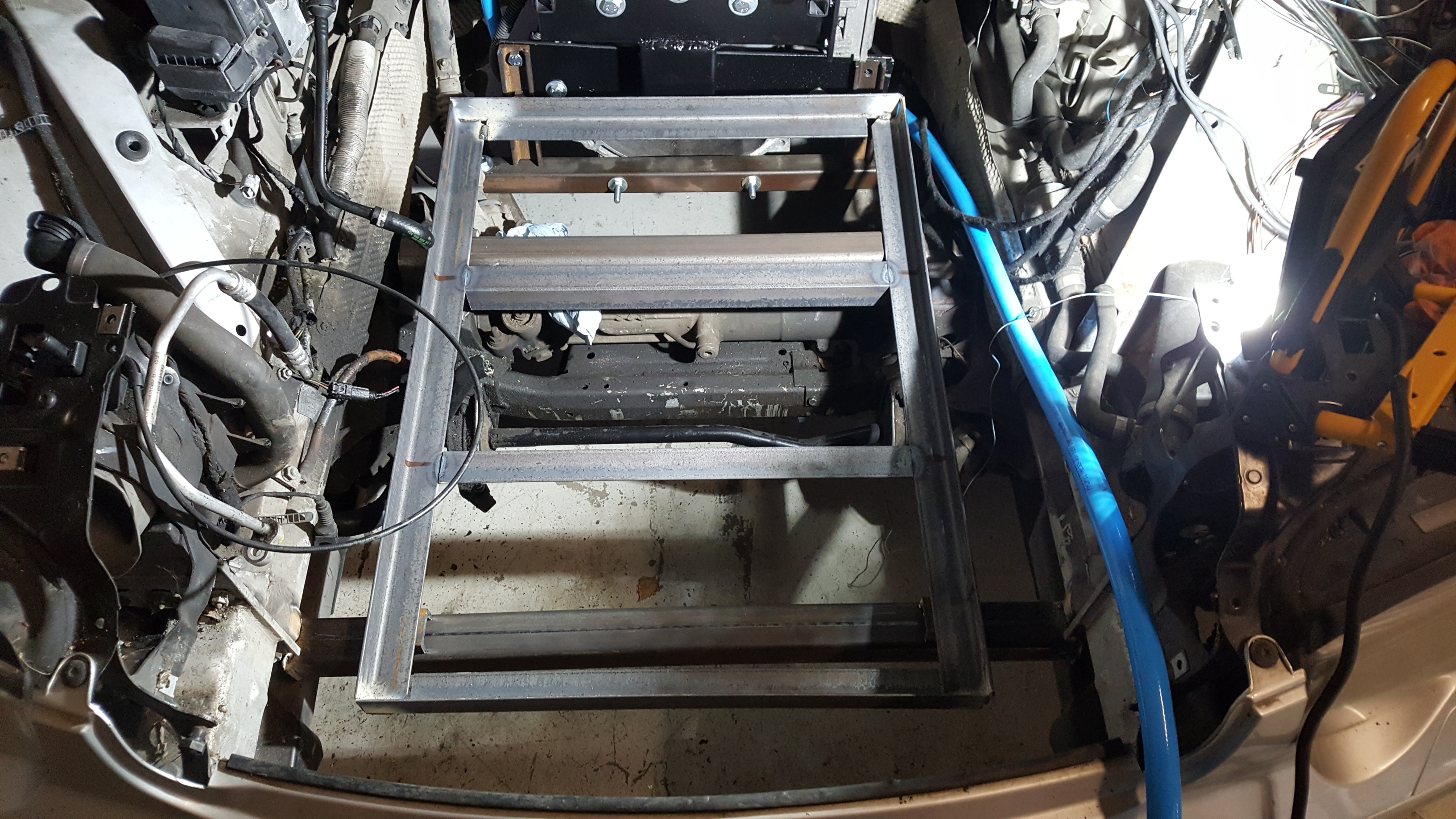

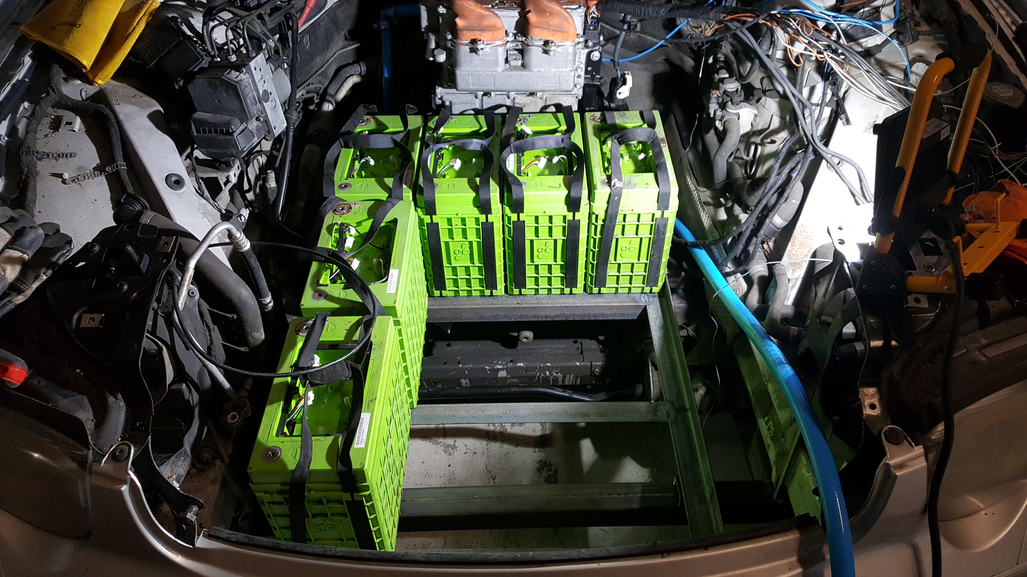

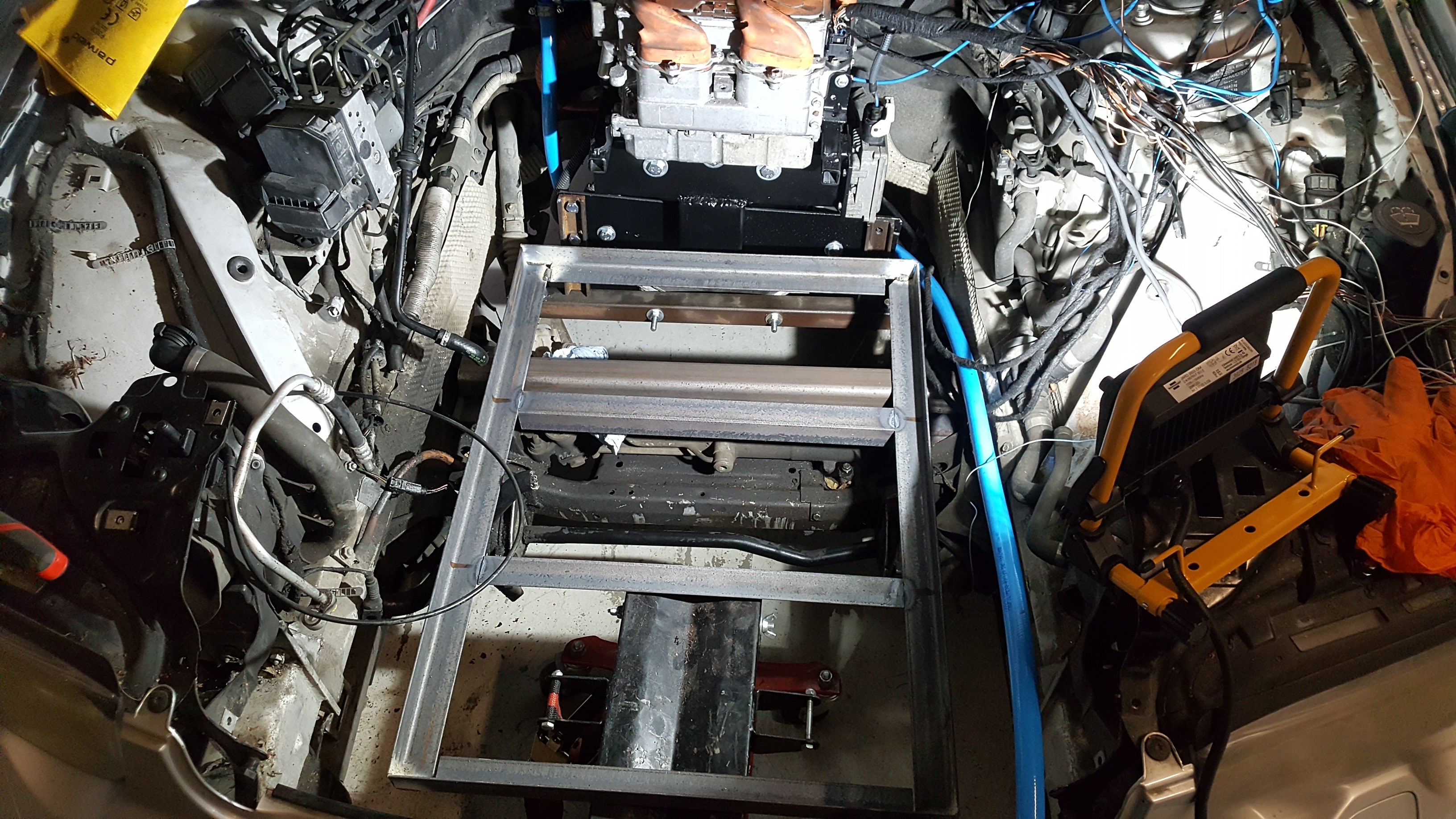

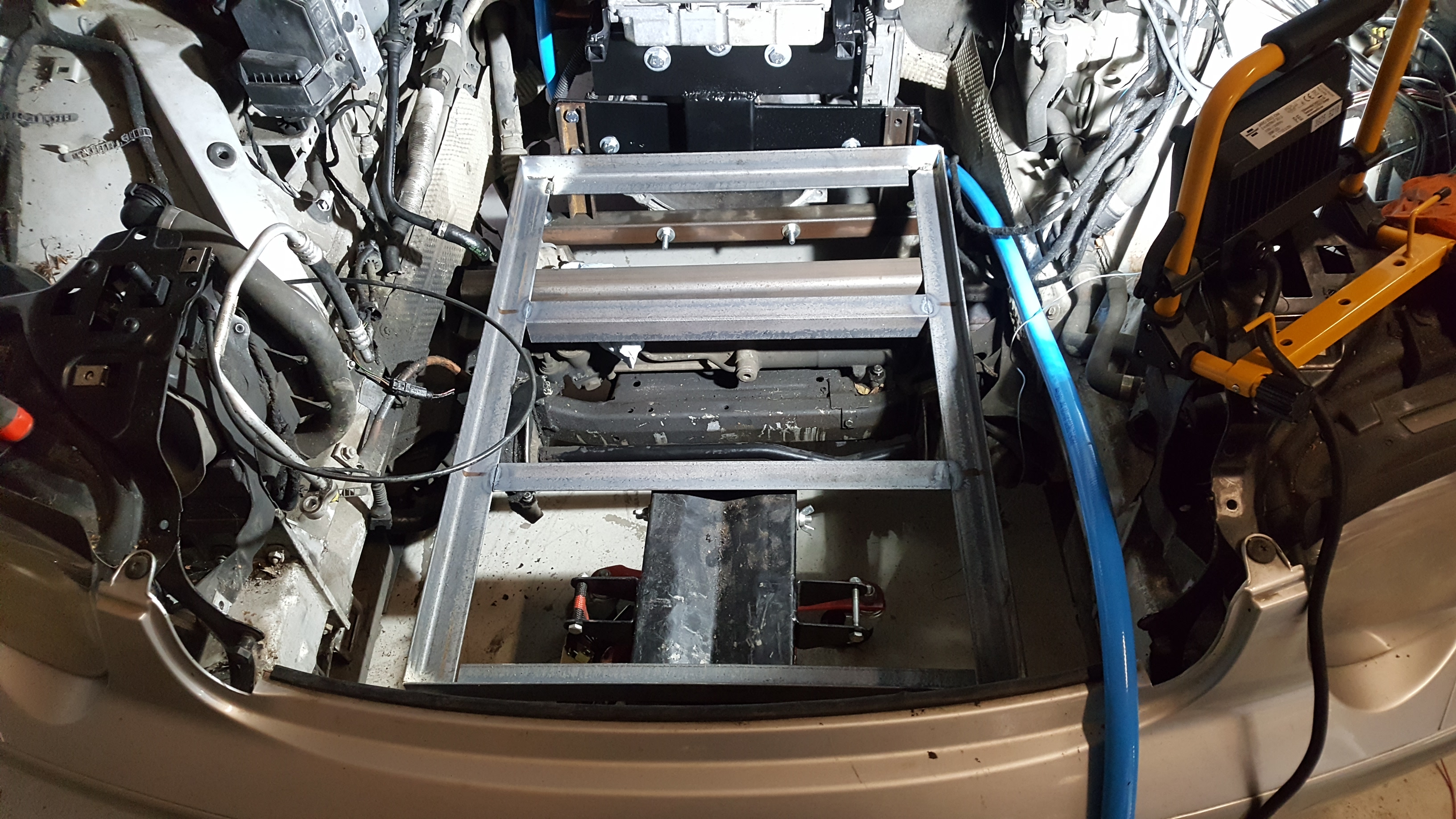

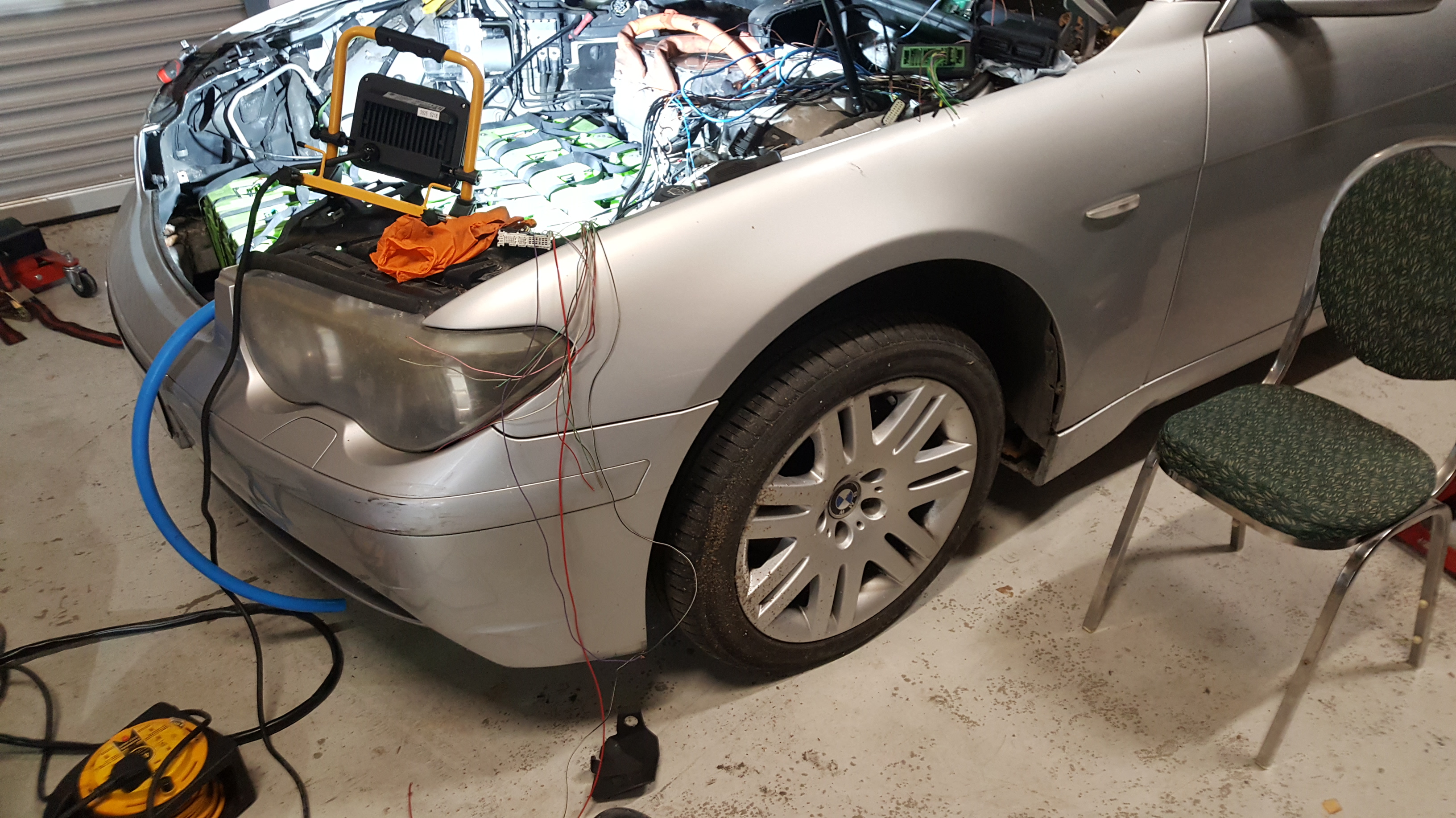

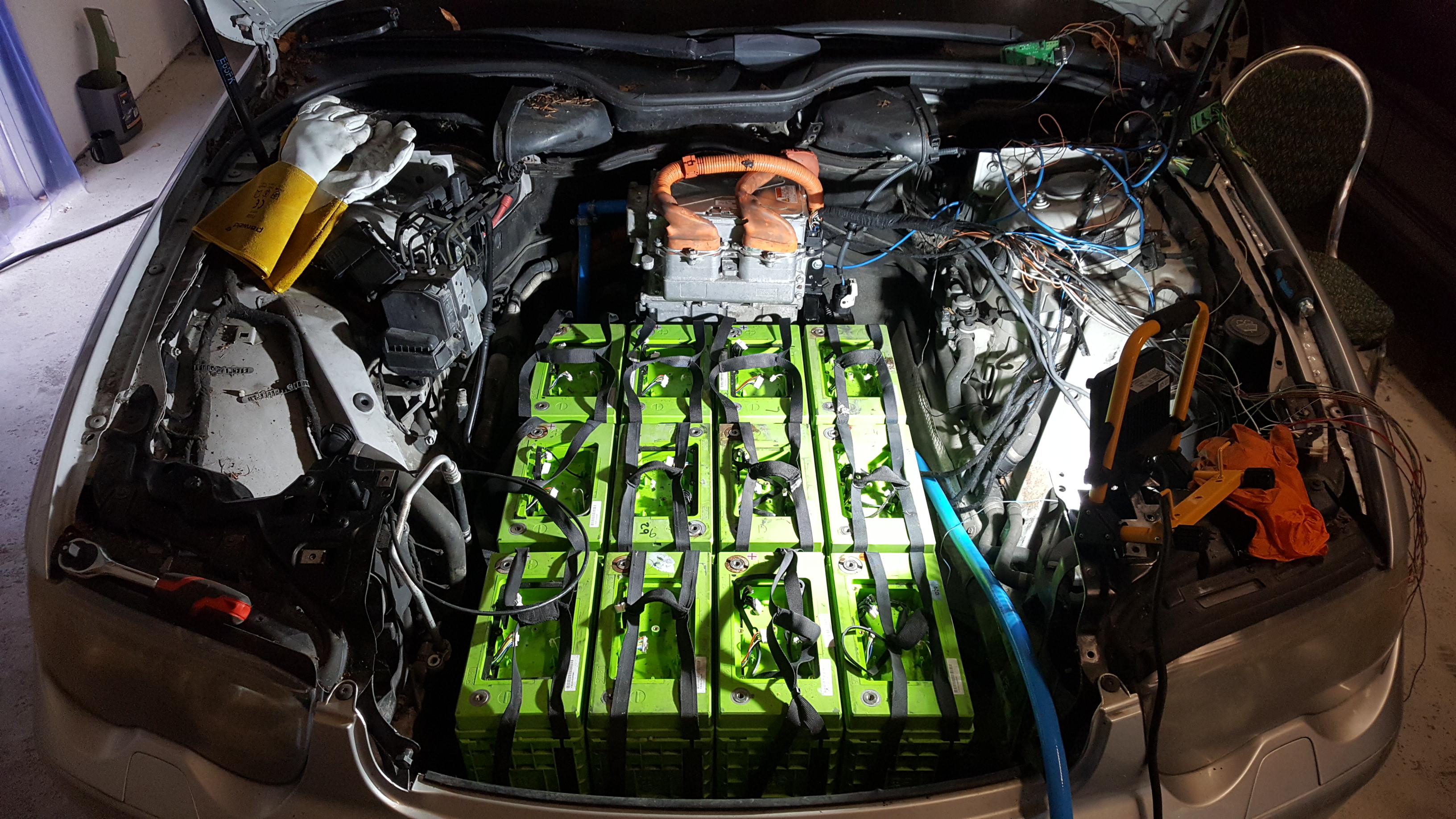

Front battery tray is in. still 160kg lighter on the front than with the V8.

Wow, great progress Damien!
I will be doing the same thing on my XJR in few weeks.
Are you going to put more batteries?
Front and rear to distribute the weight?
How many kWh total?

arturk wrote: Thu Nov 28, 2019 7:05 pm Are you going to put more batteries?
How many kWh total?
Another similar sized pack will be installed in the rear. After testing at ~500V a long range pack will be installed in the front/rear possibly at ~600V. The hope is that we can use this vehicle for Lexus hybrid component testing in real world scenarios such as high speed motor way cruising 8-)
~600V would also allow us to test the Tesla CCS charging at ~200kW :D

arturk wrote: Fri Nov 29, 2019 5:12 pm Are you planning to give it a try before 600V battery is fitted?
We have set ourselves two goals for the next six months, proving the Lexus platform is viable for use in long range heavy vehicles, and exhibiting the Super Yacht at the Fully Charged Live Show.
Time and resources are limited so unless the boost converter development is critical it seem unlikely it will happen before FCL.

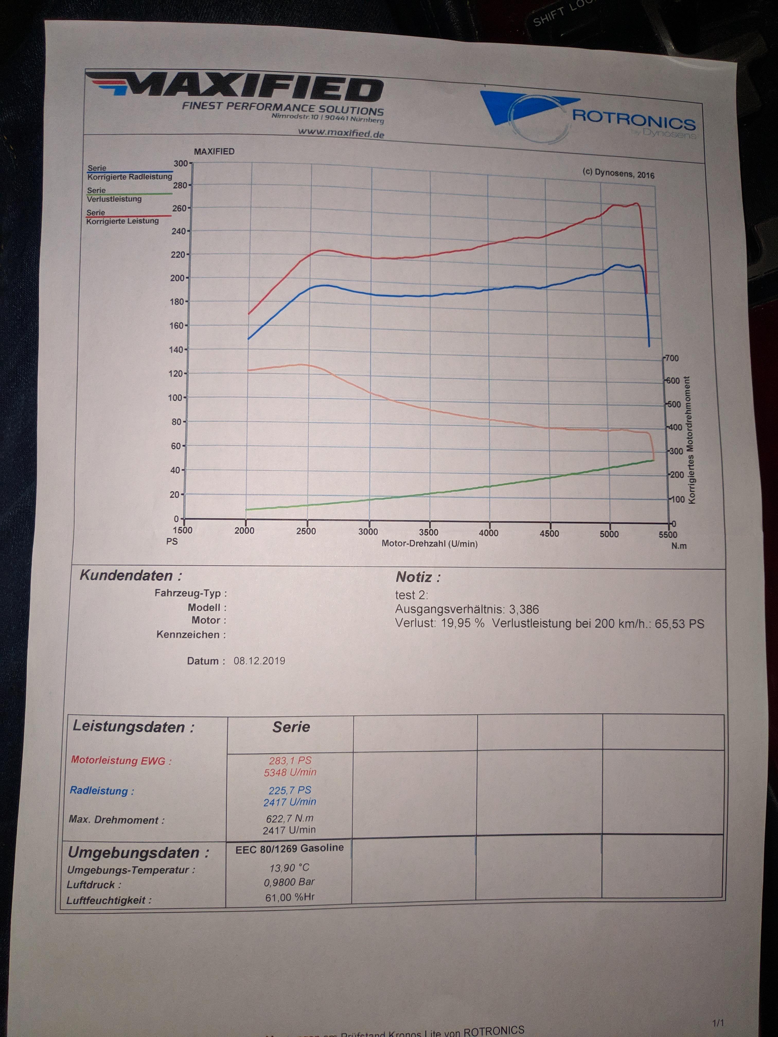

I just dynoed my gs450h and thought to share the results here since no one has shared it before. it kinda pushes everything it got around 2500rpm and then dies out. can one shift the transmission to the overdrive gear from launch?

stilkus wrote: Sun Dec 08, 2019 9:31 am can one shift the transmission to the overdrive gear from launch?
I doubt we'll need it.. the car was very lively even with the software torque limit set to 33.3% and a 230V battery.
One thing we did notice was the difference in performance between driving in reverse (one motor) and forward (two motors). It was night and day :)
