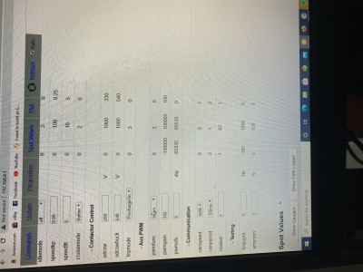

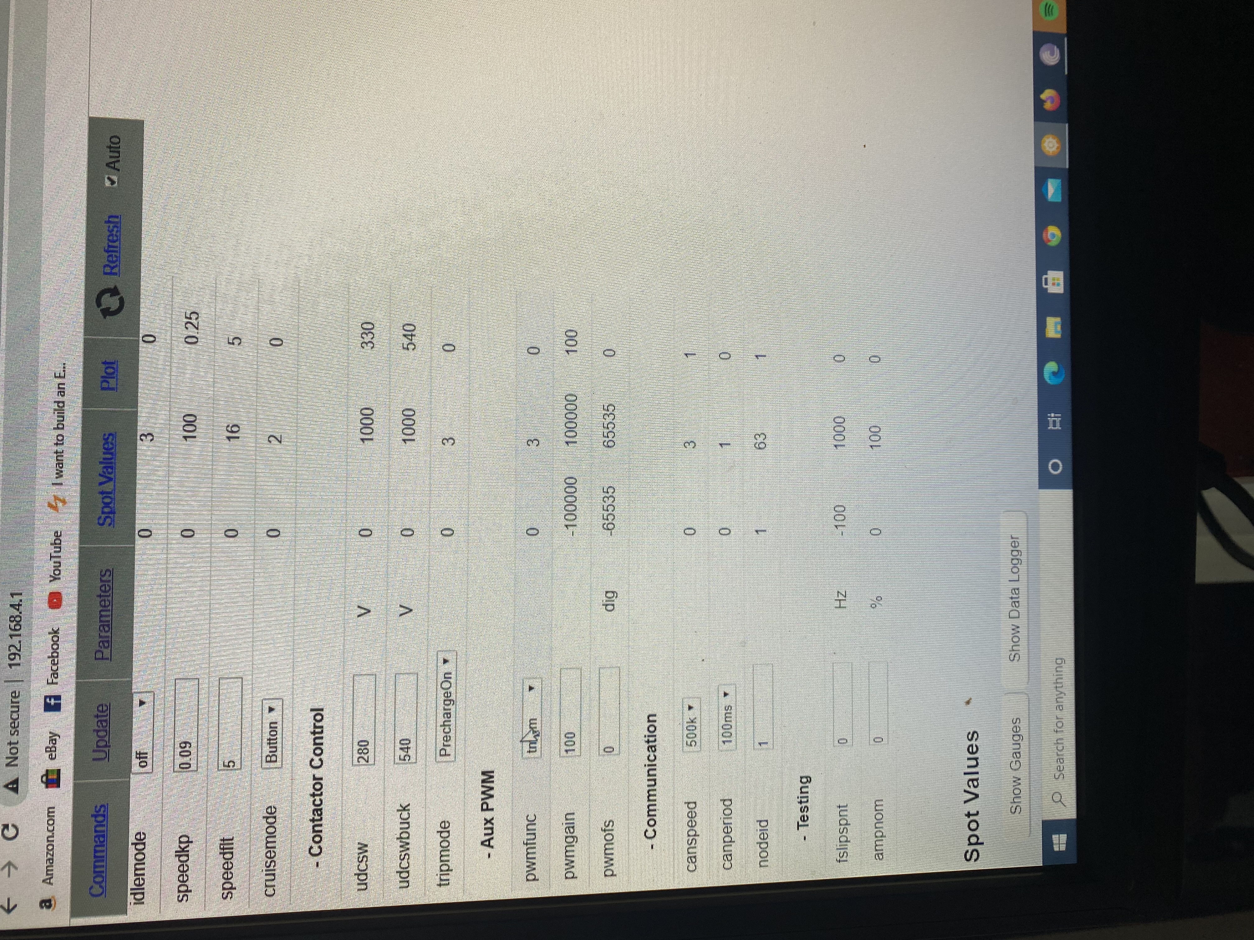

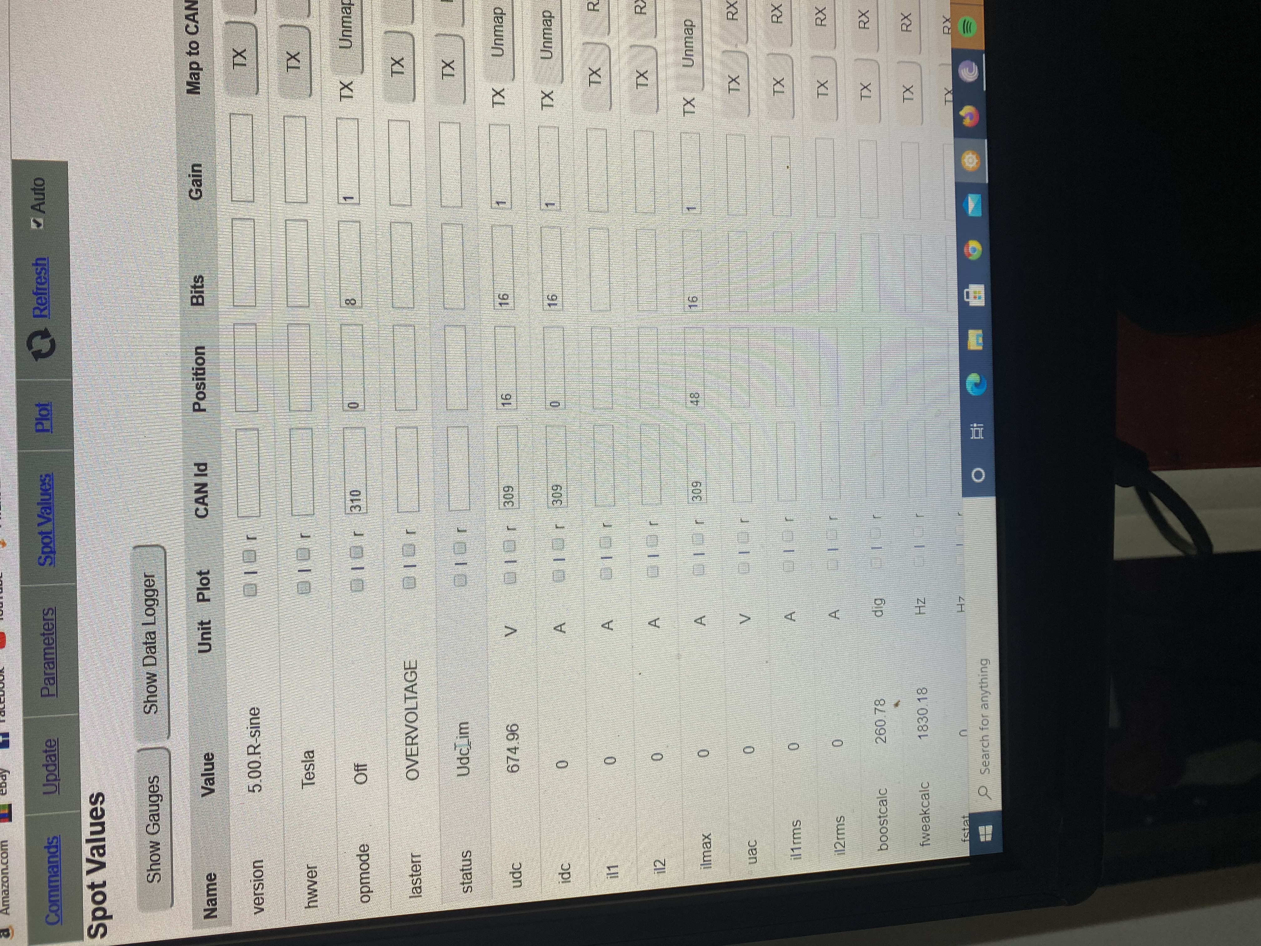

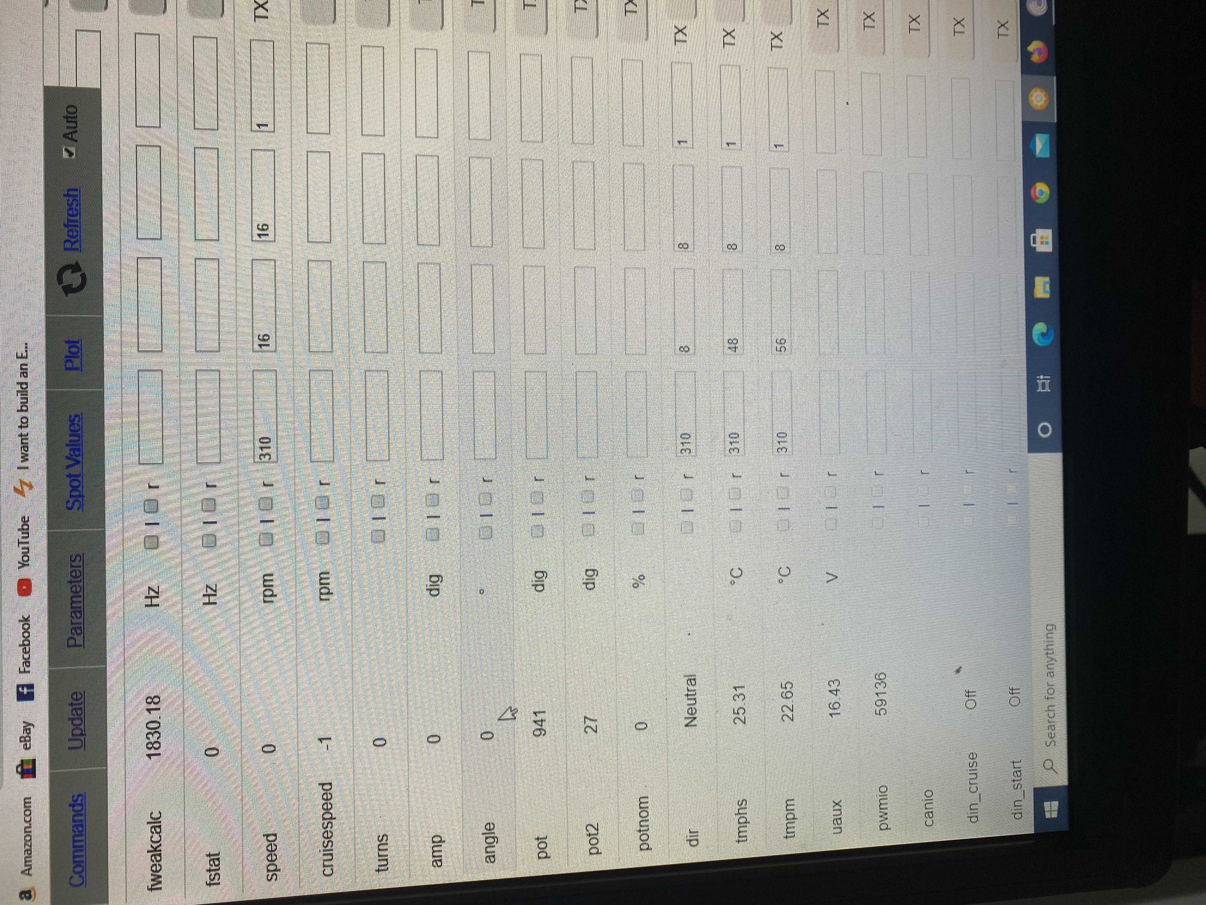

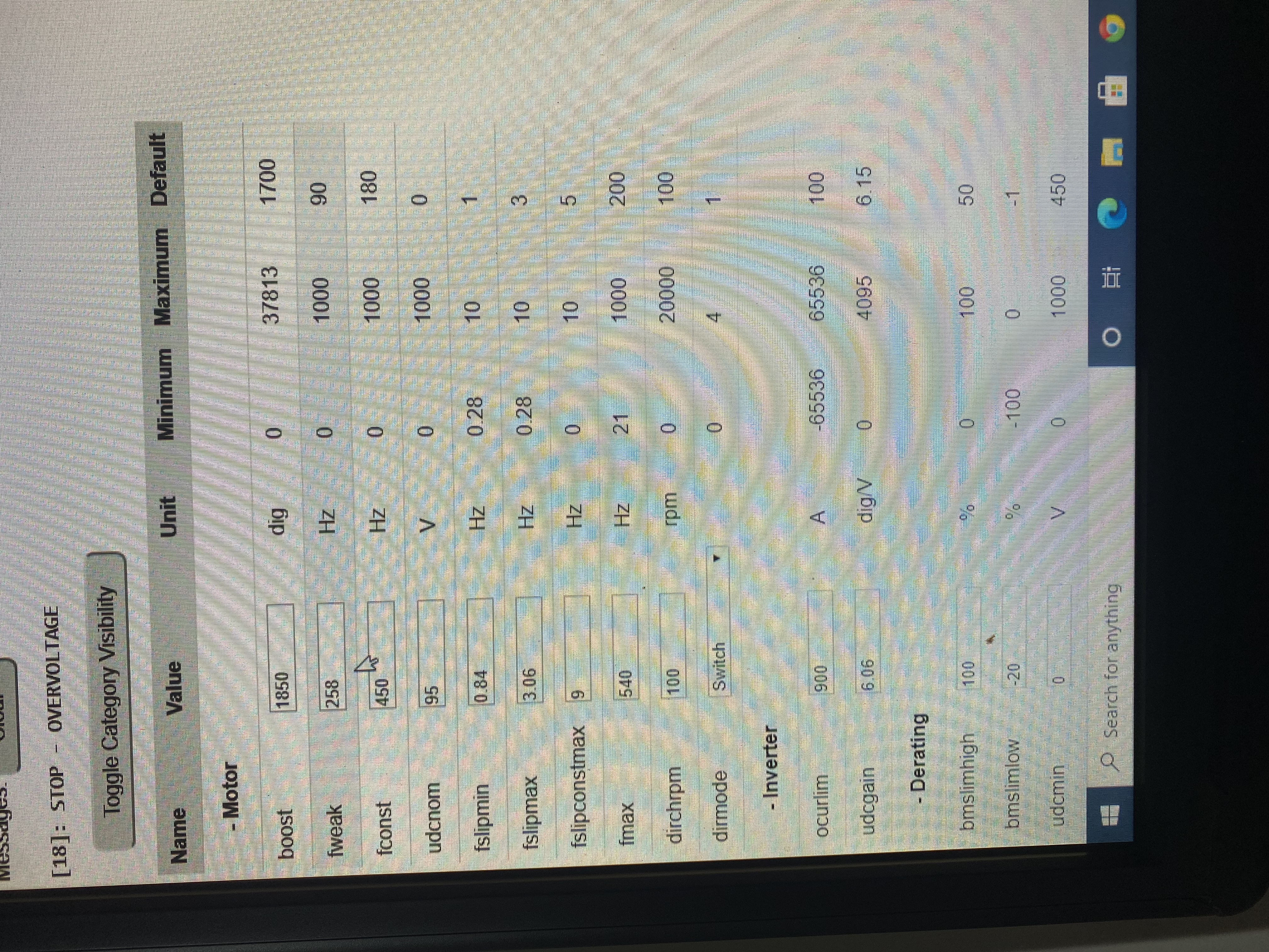

Hello all. Regrettably I have a question. Test fire stalled at getting positive contactor to engage. I’ve read everything many times. Sorry for this but I’m stumped.
I have 4 tesla modules in series for 95 v. Test settings as follows from reading all posts.
Udc nom 95
Occurlim toggled from neg to pos and back
Udc min 0
Udc max 100
Throttle pot : dual channel
Idle mode off
Udc sw 85
Contractor trip : precharge on changed from default
These are listed in order they fall on page. All others are defaults.
Error message reads
[18] stop- over voltage
If nothing is obvious I probably need to pull the motor and check solder contacts as this was my first attempt at fine soldering
Thanks in advance. Apologies for my ignorance

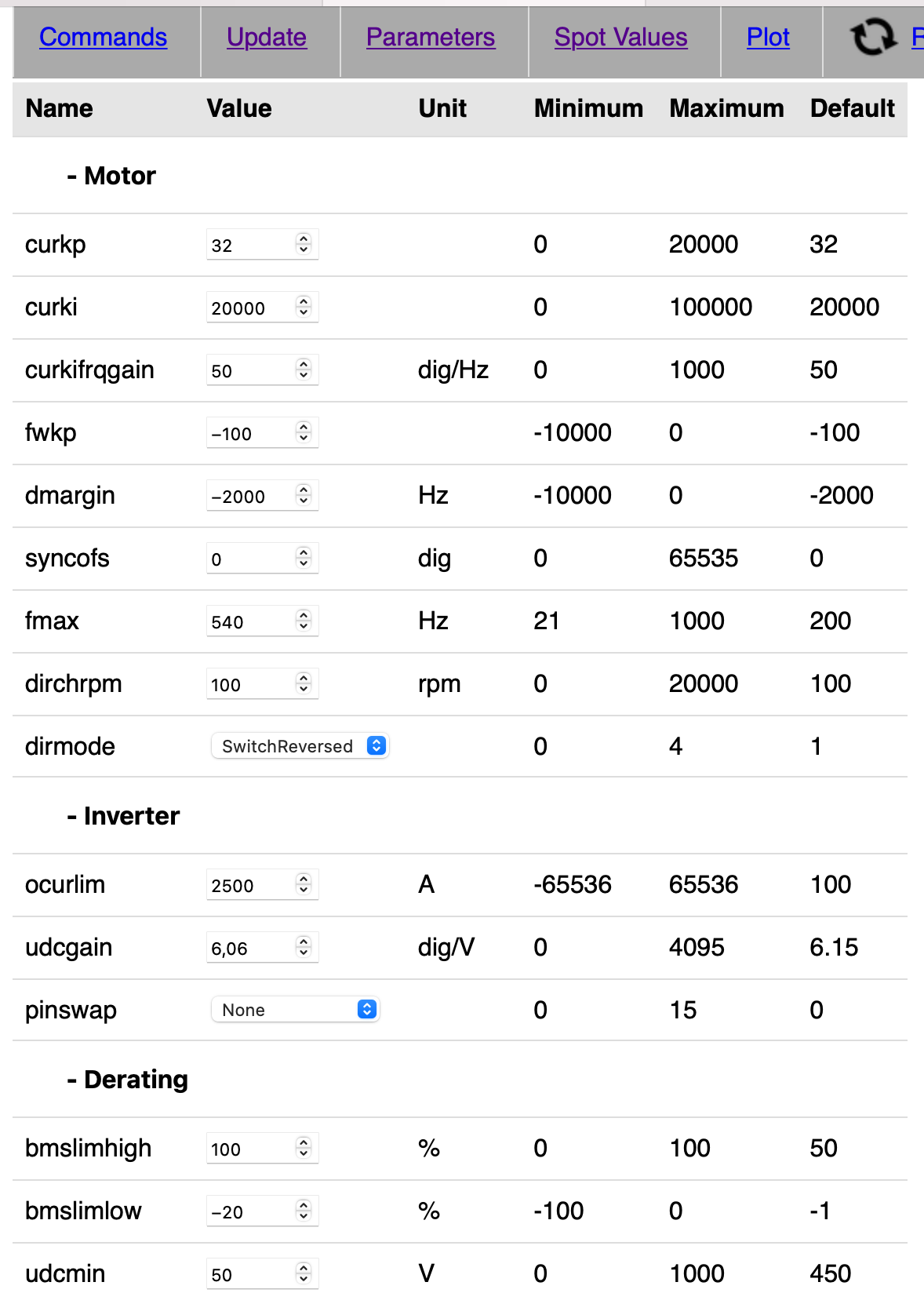

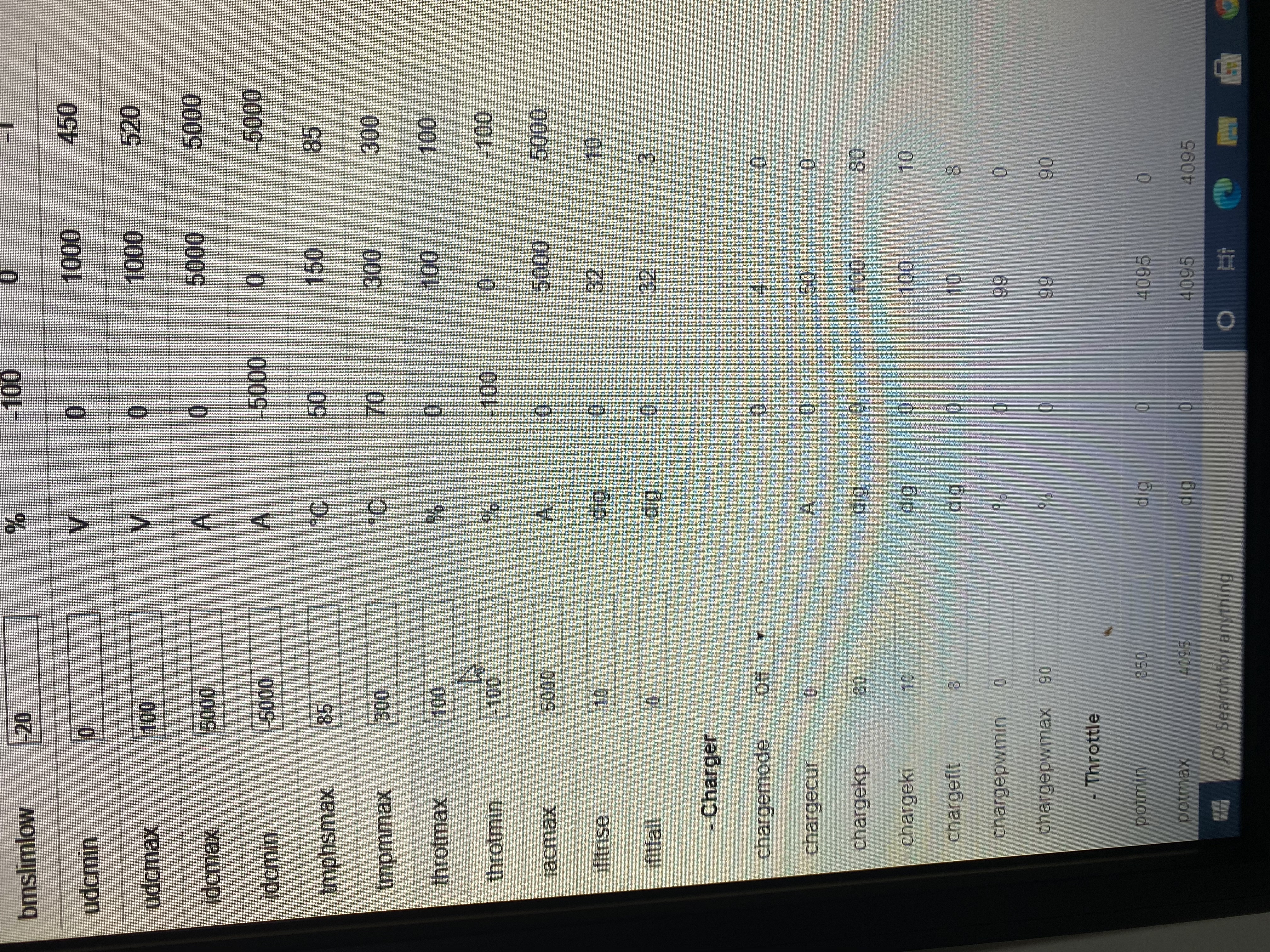

Please post a full list of your parameters.Lowcoe wrote: ↑Sat Jul 24, 2021 8:08 pm Hello all. Regrettably I have a question. Test fire stalled at getting positive contactor to engage. I’ve read everything many times. Sorry for this but I’m stumped.

What firmware are you using? Have you tried a known good LDU version like this (.bin):
viewtopic.php?p=26478#p26478

Look at UDCSW. It’s not been lowered so main contactor won’t close. Try that first and make sure you save. After testing, put the settings back.
I think most people are still running the LDU firmware I mentioned in my last post. I’d suggest you try it as it’s known good. Click on the .bin file, save as to your PC. Then go to the inverter firmware field and upload it.
