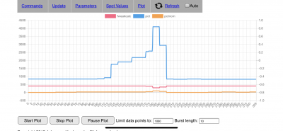

Alrightly folks....
Uploaded my latest changes and it seems to be working as intended. Nice smooth low throttle operation straight out of the firmware.

Plot showing the reduction in fweakcalc with throttle application attached. Scaling is shit since I have raw pot on there. I have attached the compiled .bin if anyone wants to give it a try. Its based off the 4.97 release. The core of what this does is reduces throttle ramp to a very slow rate for lower throttle inputs. These eliminates any on/off throttle jerkiness. It also sets the default fweak value to 400 under 35% throttle. Over 35%, it will linearly ramp fweak down to the value you have in the parameter file at WOT. This gets rid of the low speed low throttle surging.
You should not have to change any of your standard parameters with these changes.
