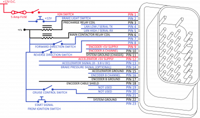

Wiring diagrams :
https://github.com/damienmaguire/Tesla- ... g_Diagrams

Wiring diagrams attached to this post.

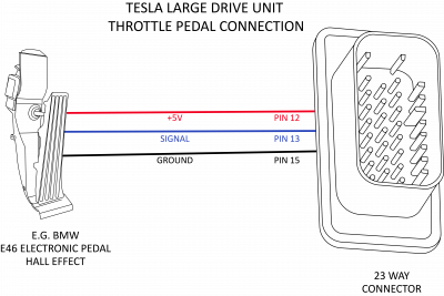

The number one most common question I get asked is why is the motor only turning slowly when I press the throttle.
The symptom of the motor turning slowly is almost certainly caused by a missing or inverted encoder signal. The encoder output consists of two channels : A and B. The signal from these is used by the microcontroller to determine the speed and direction of rotation of the motor. If for example the A and B signals are swapped then the inverter will be trying to drive the motor in one direction and the encoder signal will tell it the motor is running backwards hence this behaviour. If either or both signals are missing then the microcontroller has no speed or direction information and the same symptoms result.

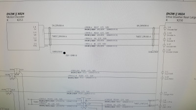

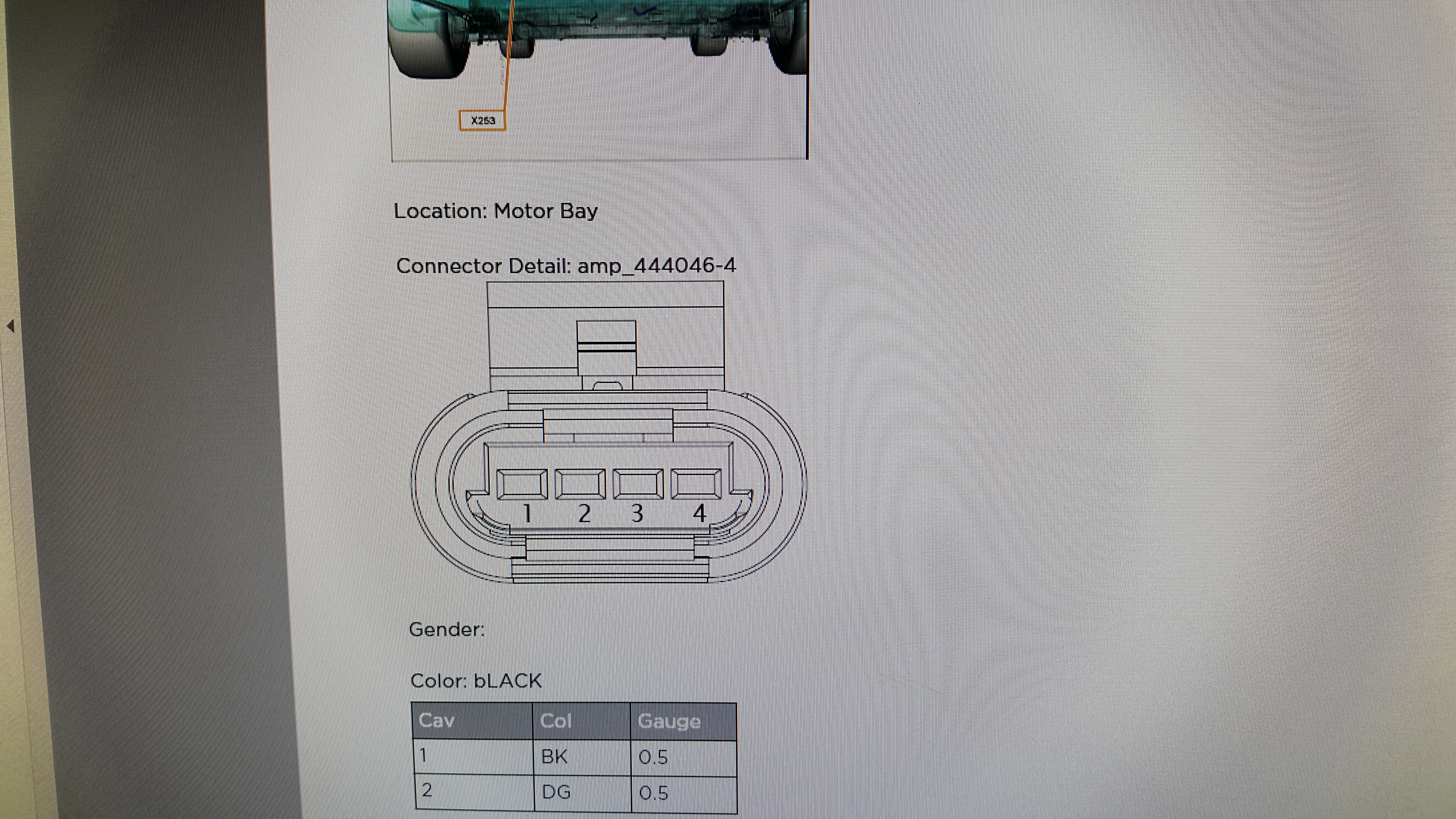

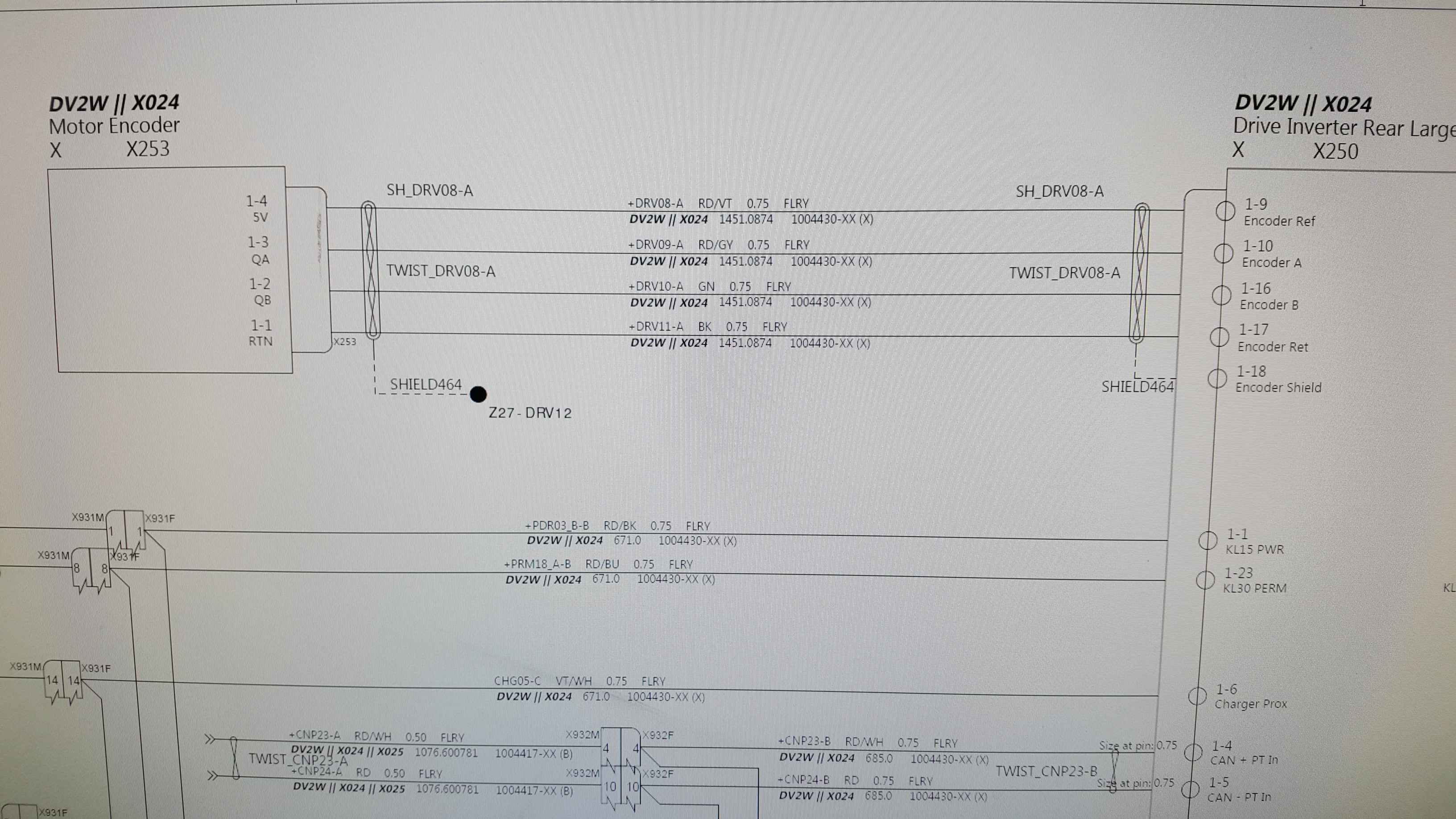

Another one for the FAQ list regards the encoder on the large drive unit. Unlike the small drive units the encoder must be wired externally from it's 4 pin connector to the 23 pin main input connector via a screened cable. If you are unlucky and don't have the Tesla harness then stranded CAT5e or CAT6 network cable is a good substitute. I have attached some pictures from the Tesla wiring diagrams detailing pin connection from the 4 pin encoder connector (located on the end of the motor housing) to the 23 pin ampseal connector.
Here we have the pinout of the 23 way ampseal connector :
https://github.com/damienmaguire/Tesla- ... NEW_V2.pdf
Pin 1 of the Encoder connector to Pin 17 of the 23way ampseal main connector
Pin 2 of the Encoder connector to Pin 16 of the 23way ampseal main connector
Pin 3 of the Encoder connector to Pin 10 of the 23way ampseal main connector
Pin 4 of the Encoder connector to Pin 9 of the 23way ampseal main connector
The screen on the cable should be connected to pin 18 on the 23 way ampseal connector. It is not connected at the encoder plug.
The Encoder plug is very hard to find. ZeroEV have them for sale on their webshop :
https://zero-ev.co.uk/product/tesla-lar ... model-s-x/
Posts: 2962
Has thanked: 328 times
Been thanked: 847 times
Adding onto the encoder cable, if you ever have issues getting a stable spinning motor, Always plot your rpm/Fstat as if that is really jumpy it means the encoder signal is dirty.
Shielded cable is a must, without it the encoder pulses are not clean enough.

Post by Permag »
Encoder wiring. I think it is important to let everyone know that when installing the 2013 p85D LDU in the porsche, that the encA and B signals had to be inverted (I swapped the pins at the motor connector) before this it would only turn very slowly when set to single encoder mode. Damien and I have discussed this and it seems there may be minor schematic differences between years.

Post by jon volk »
I too had to swap signal wires at the encoder. I strongly suggest powering up at low voltage and verify smooth running. My symptom was a slow jogging. I swapped the middle two wires and immediately had smooth running. It does seem that there were some variations through the years. Perhaps its just a Connecticut thing :lol:

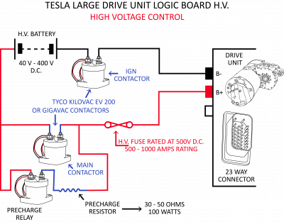

Posts: 3999
Been thanked: 1114 times
FAQ : Precharge system.
The precharge system behaves as follows :
Upon application of 12v power, energise precharge contactor.
If after 5 seconds the measured voltage at the drive unit (UDC) does not exceed the UDCSW parameter we shutoff the precharge contactor as it is assumed the precharge has failed in some way.
If during those 5 seconds UDC exceeds UDCSW we leave the precharge contactor energised and wait for a start signal. Once start signal is received we close the main and open the precharge contactor.

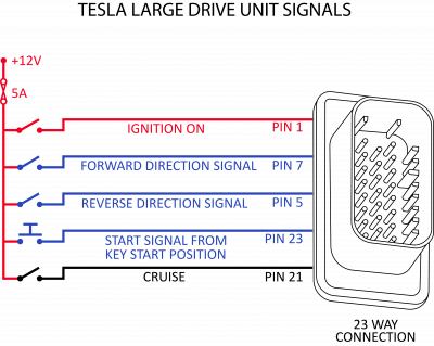

Posts: 3999
Are you selecting a direction? If you do not pull either forward or reverse lines to +12v the drive unit will sit there looking at you. don't ask me how I know:)
