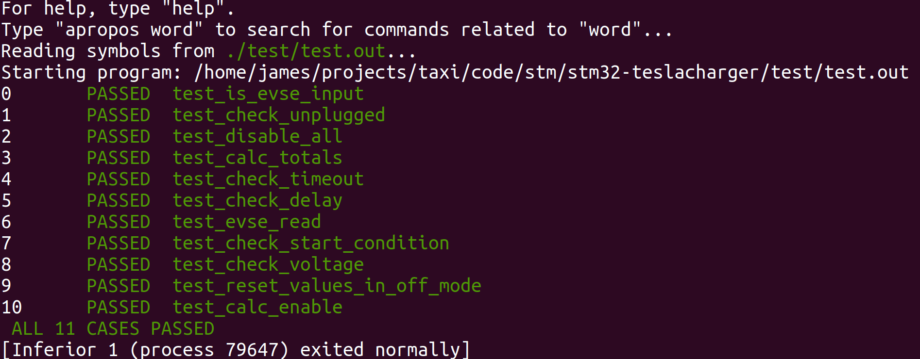

- janosch
- Posts: 329
- Location: London, UK
- Has thanked: 98 times
- Been thanked: 106 times
Re: Tesla Charger alternative firmware
Gonna get stage fright here!
I just sent you an update, with my changes, let me know if you want more cleanup done as I just quickly whacked my test-"framework" in and tested ~200 LOC of primitives and left some stubs in case someone else has time to flesh it out more.
Hope it meets the standard!
