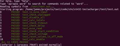

Re: Tesla Charger alternative firmware
Gonna get stage fright here!
I just sent you an update, with my changes, let me know if you want more cleanup done as I just quickly whacked my test-"framework" in and tested ~200 LOC of primitives and left some stubs in case someone else has time to flesh it out more.
Hope it meets the standard!
great
Audi and foc keeps me from getting back to this, will publish the code on github soon including Janoshes test suite.
