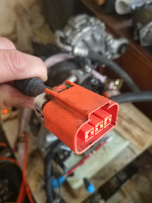

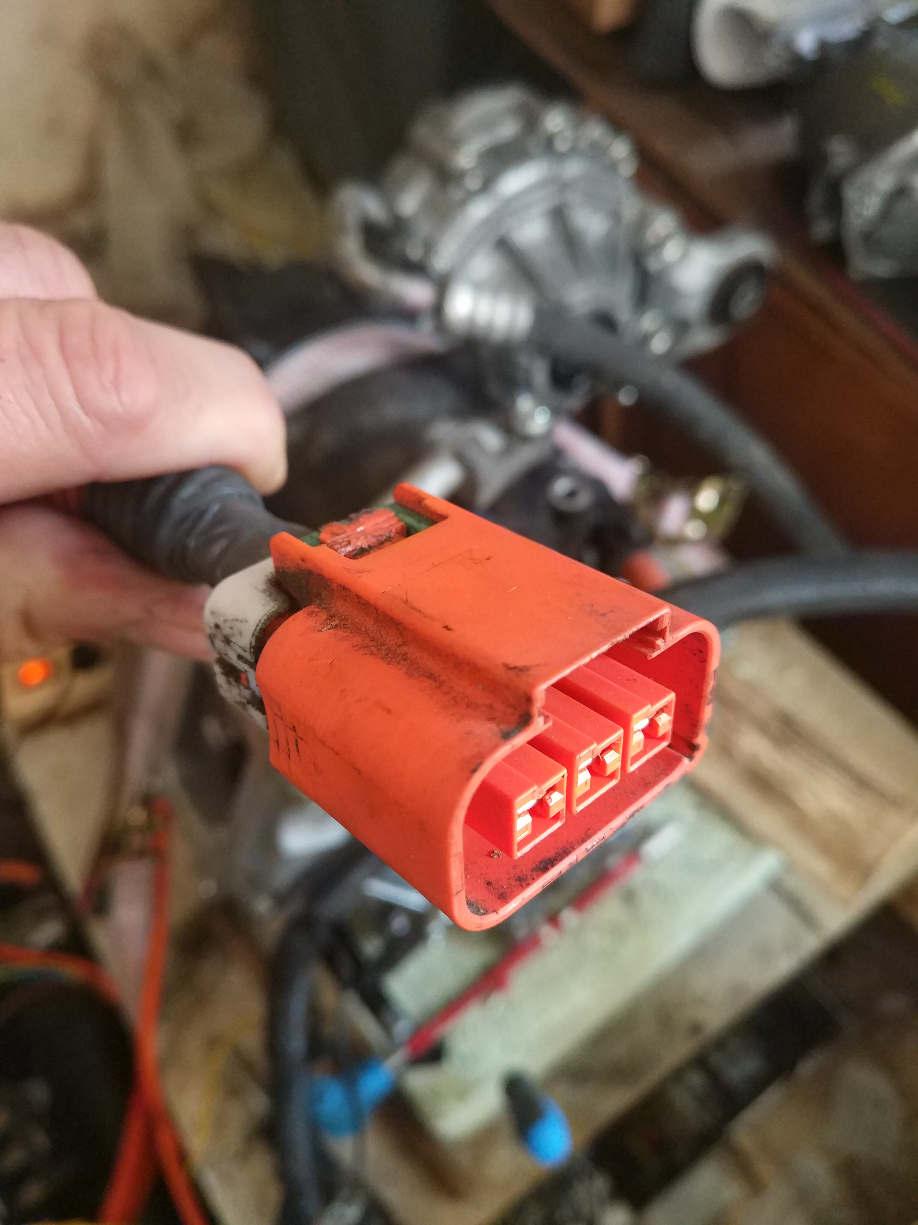

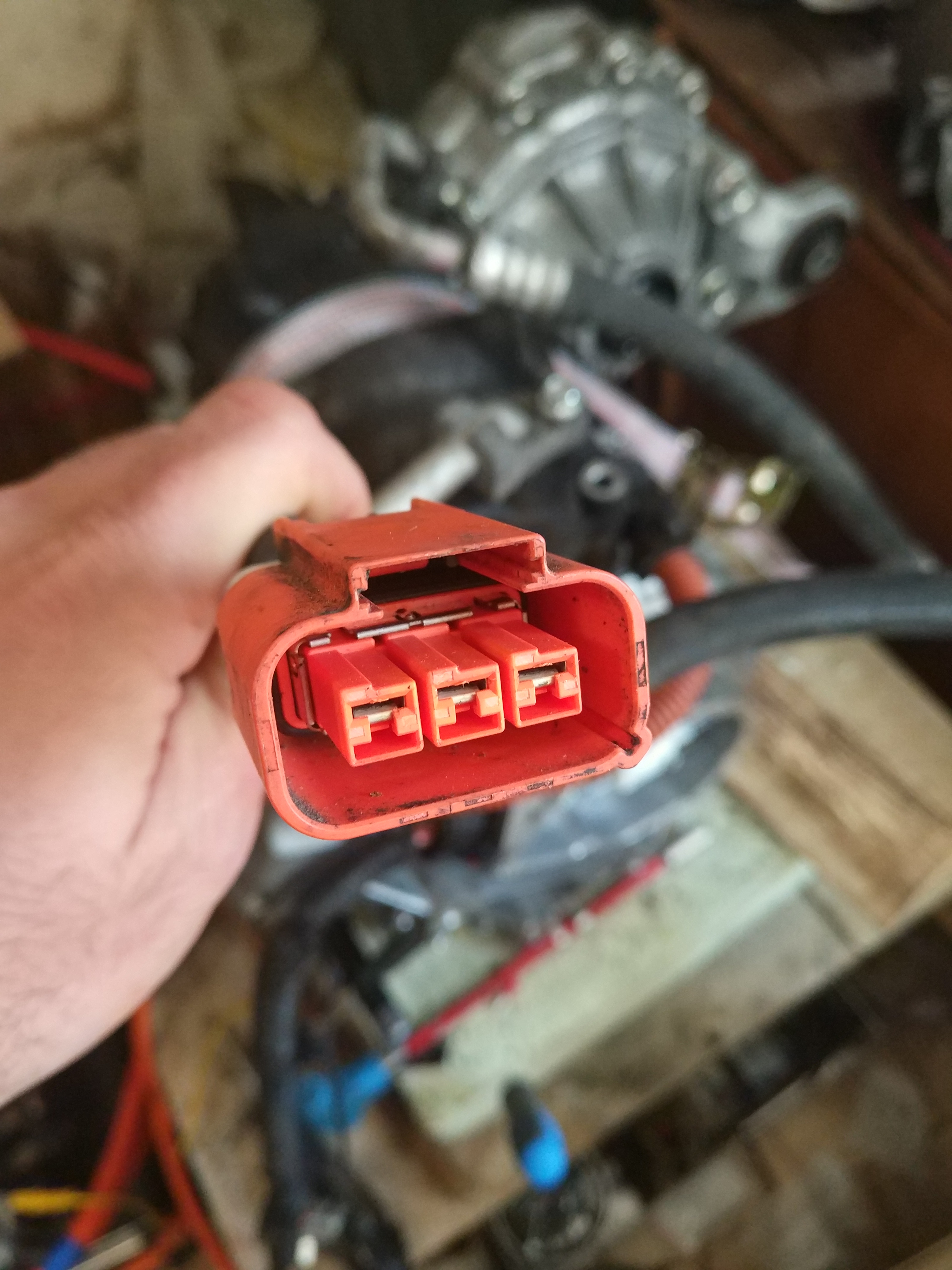

Hi
Forgive me for steering off topic for a bit.
I am looking to get a mating connector for my Prius Gen 2 compressor. Does anyone know what is the P/N for that connectopr and its opposite (male) part? TNX
