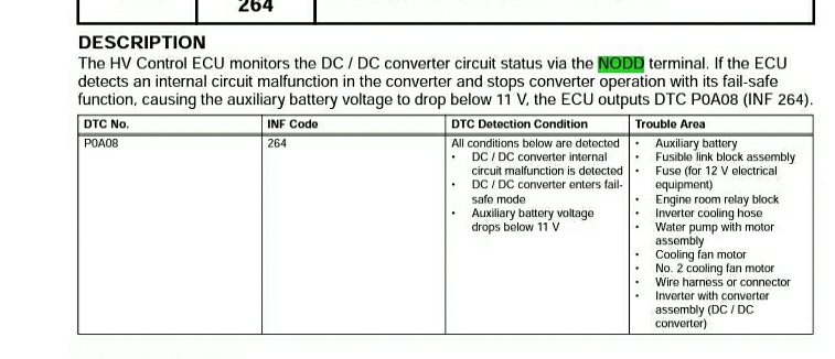

According to this:
NODD is an output signal from DC-DC to HV ECU, and HV ECU switches converter on/off via VLO pin 5.
ZooKeeper
Posts: 507
Location: USA
Re: Toyota Prius Gen 2 Inverter Controller
Post by ZooKeeper »
Yea, I see no reason based on my updated testing and documentation others have found, to connect anything to C5 other than 12v on pin #1. I will use a switched ignition source fused for 5A for C5-1 and I9-1 to power up the inverter/converter & DC-DC all in one circuit by jumping I9-1 to C5-1.
