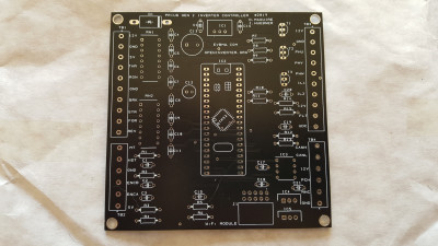

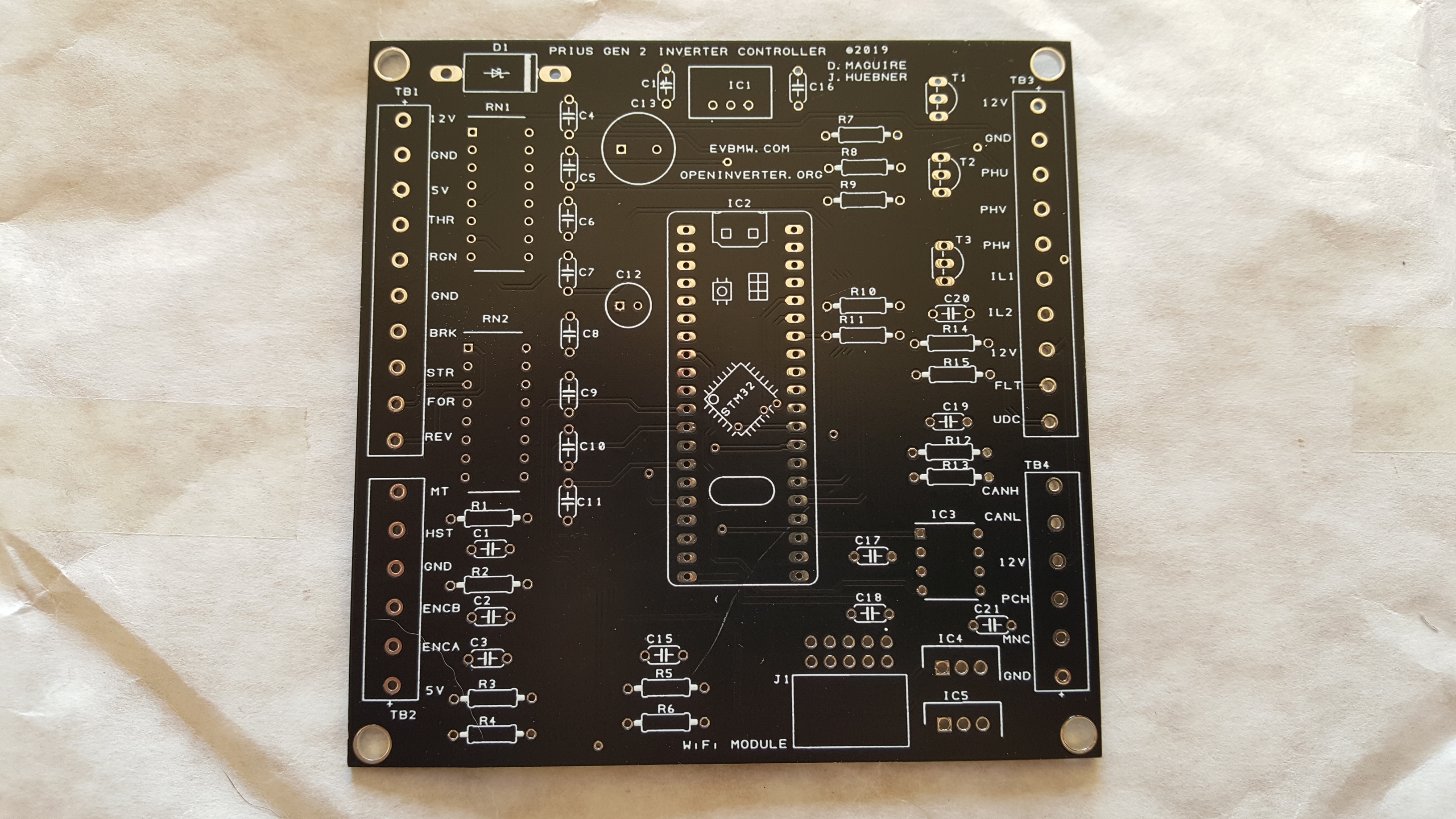

Bare pcbs have arrived. Available on the webshop for anyone interested.

Almost looks like one of those Lebowski cards now :) Nice work.
Just one thing, what about the resolver exciter?
Posts: 3999
Been thanked: 1114 times
Re: Toyota Prius Gen 2 Inverter Controller
I didn't bother with resolver on this revision. I actually want to run an induction motor with encoder. Next rev might have it.

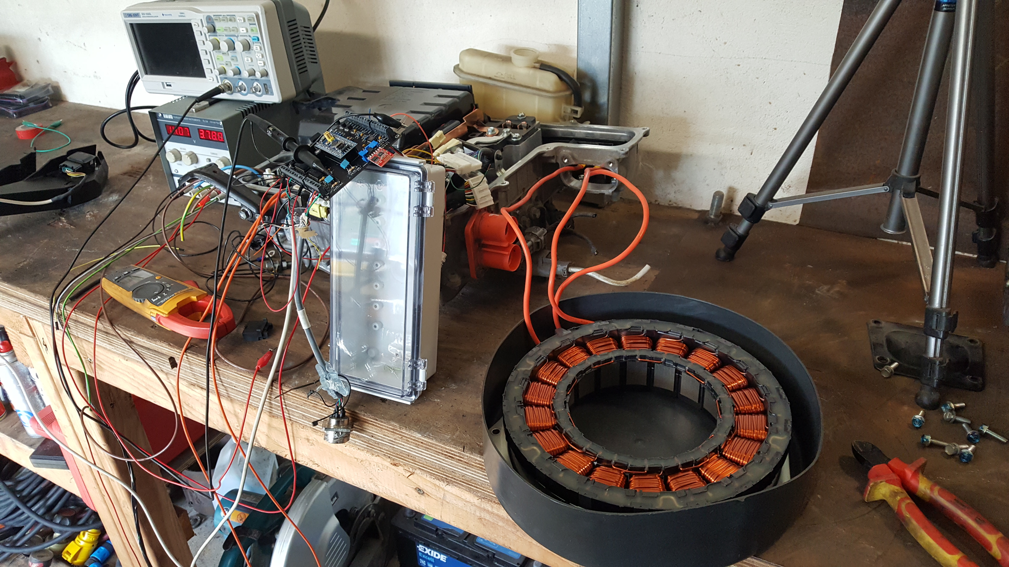

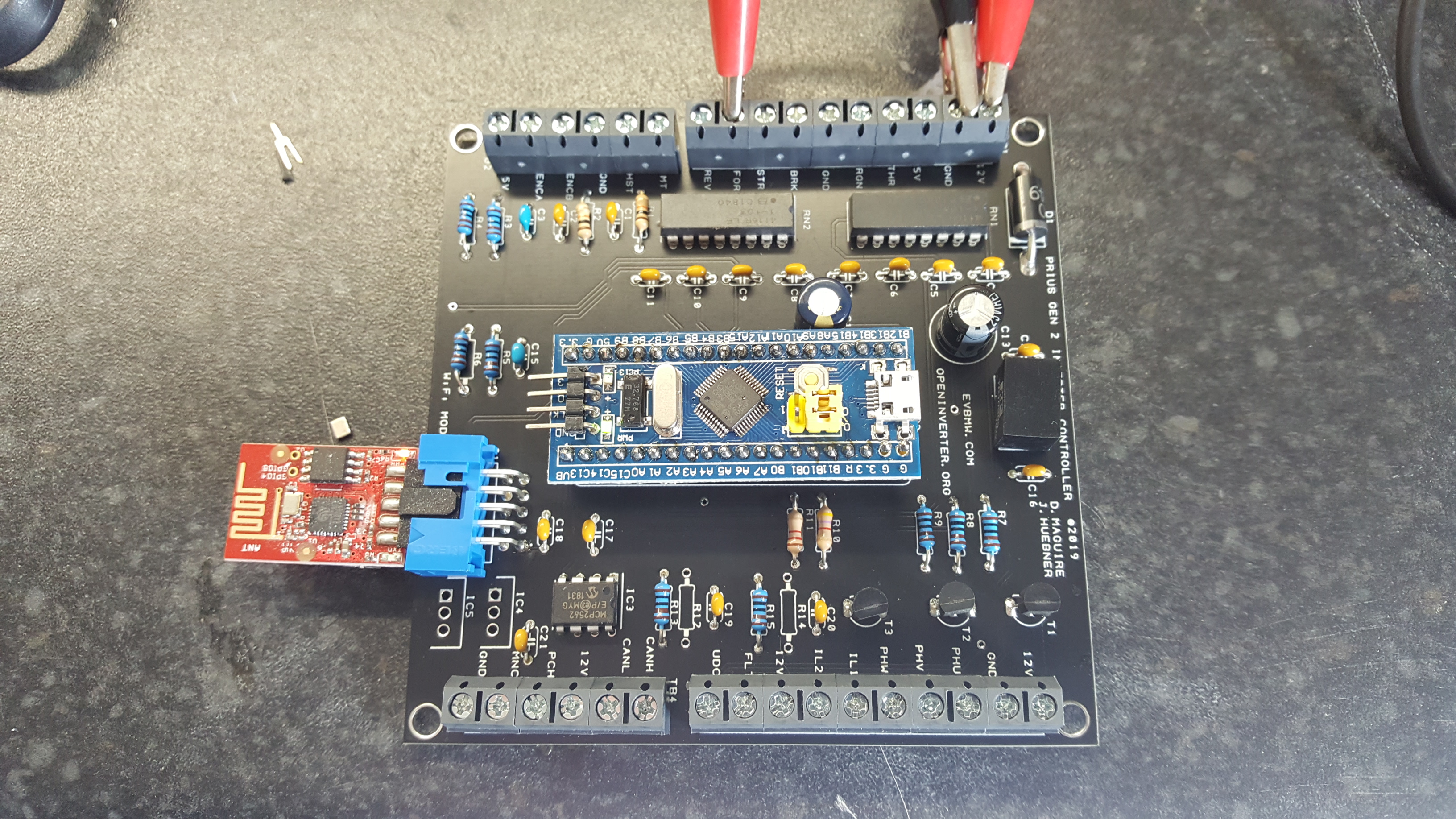

To my surprise it works:)
Worth noting the drive transistor silkscreen is flipped.

GEN 2 MG2 current sensors seem to be 0v centered and react at 25mV/A.

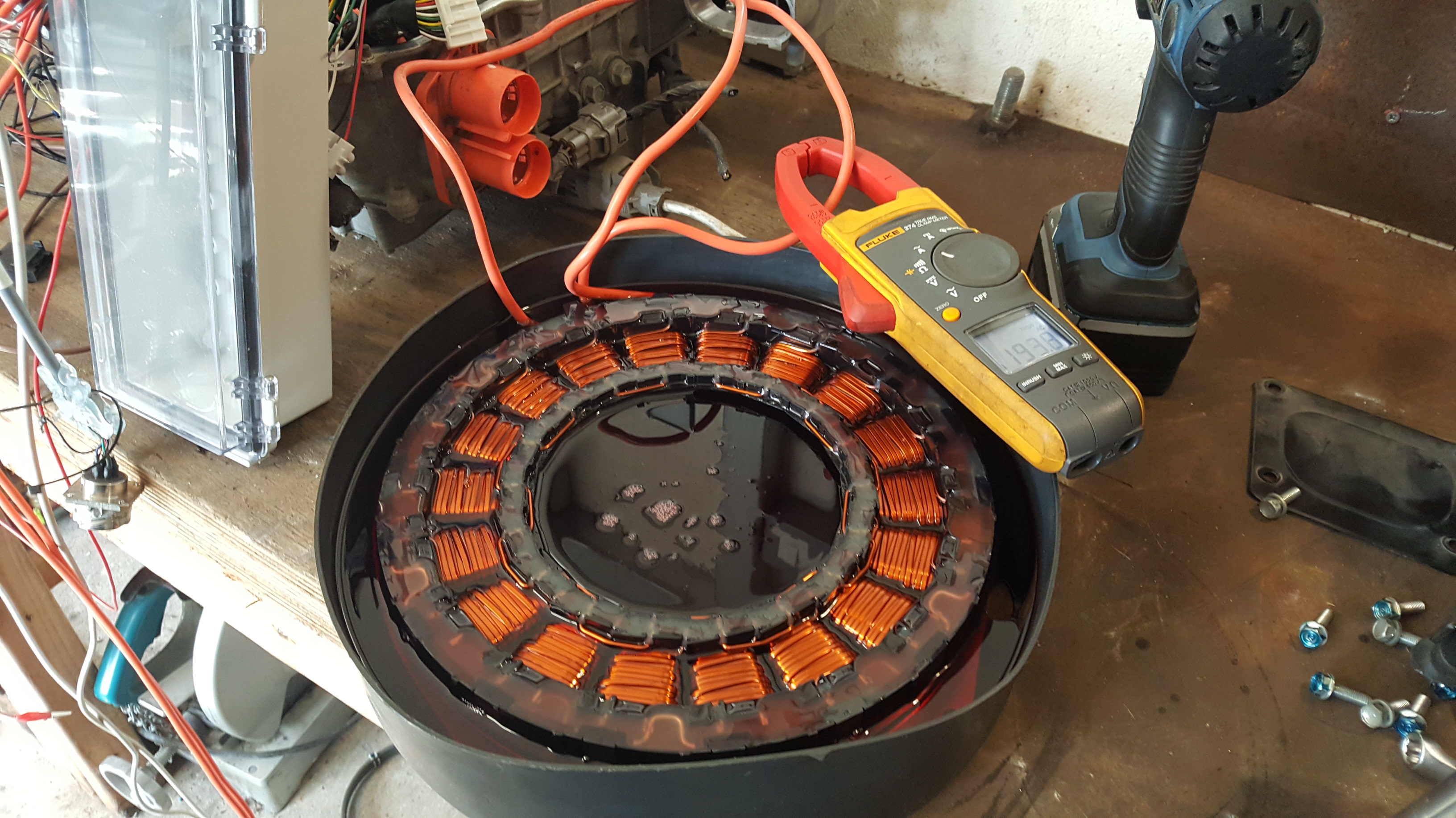

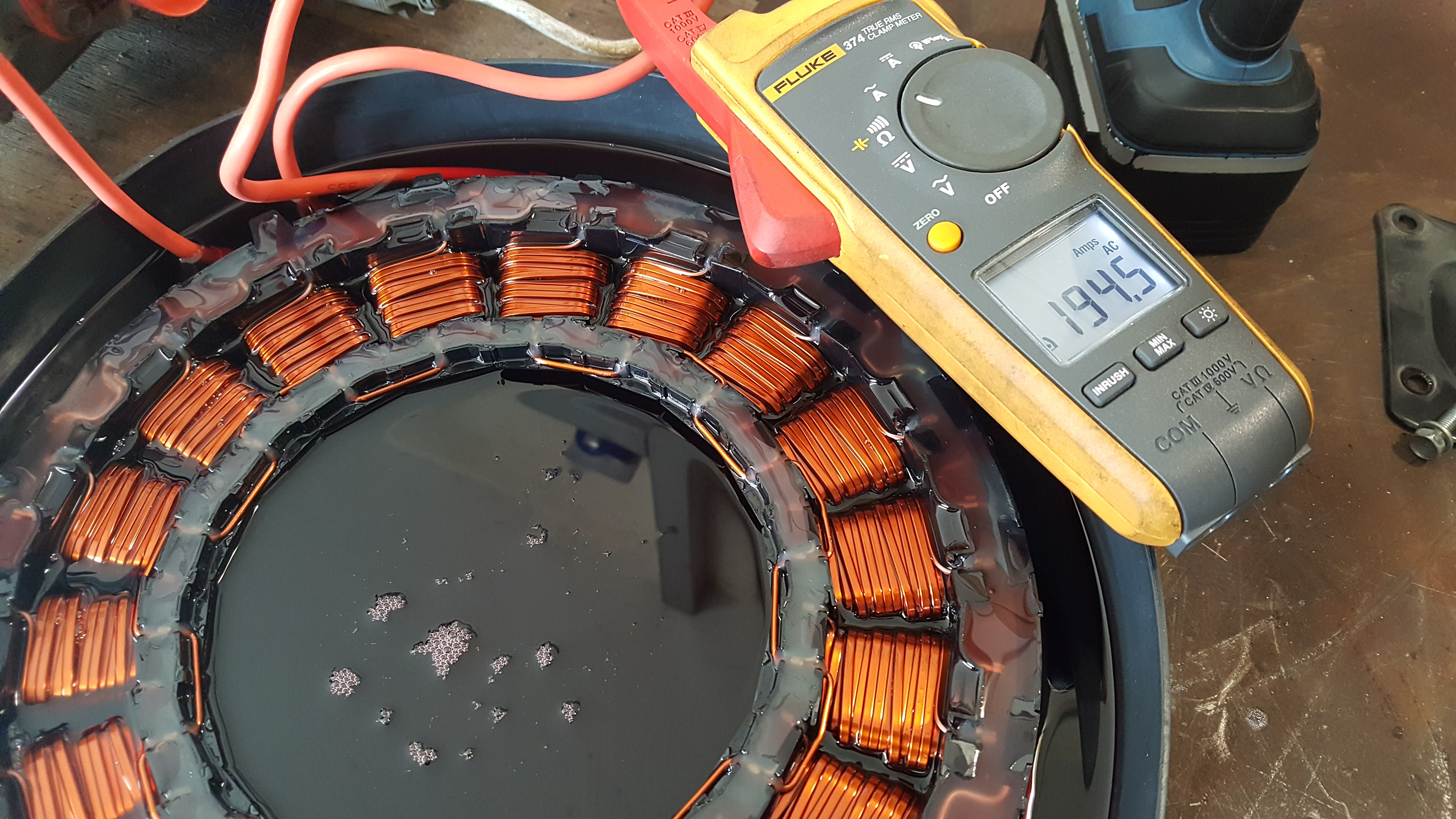

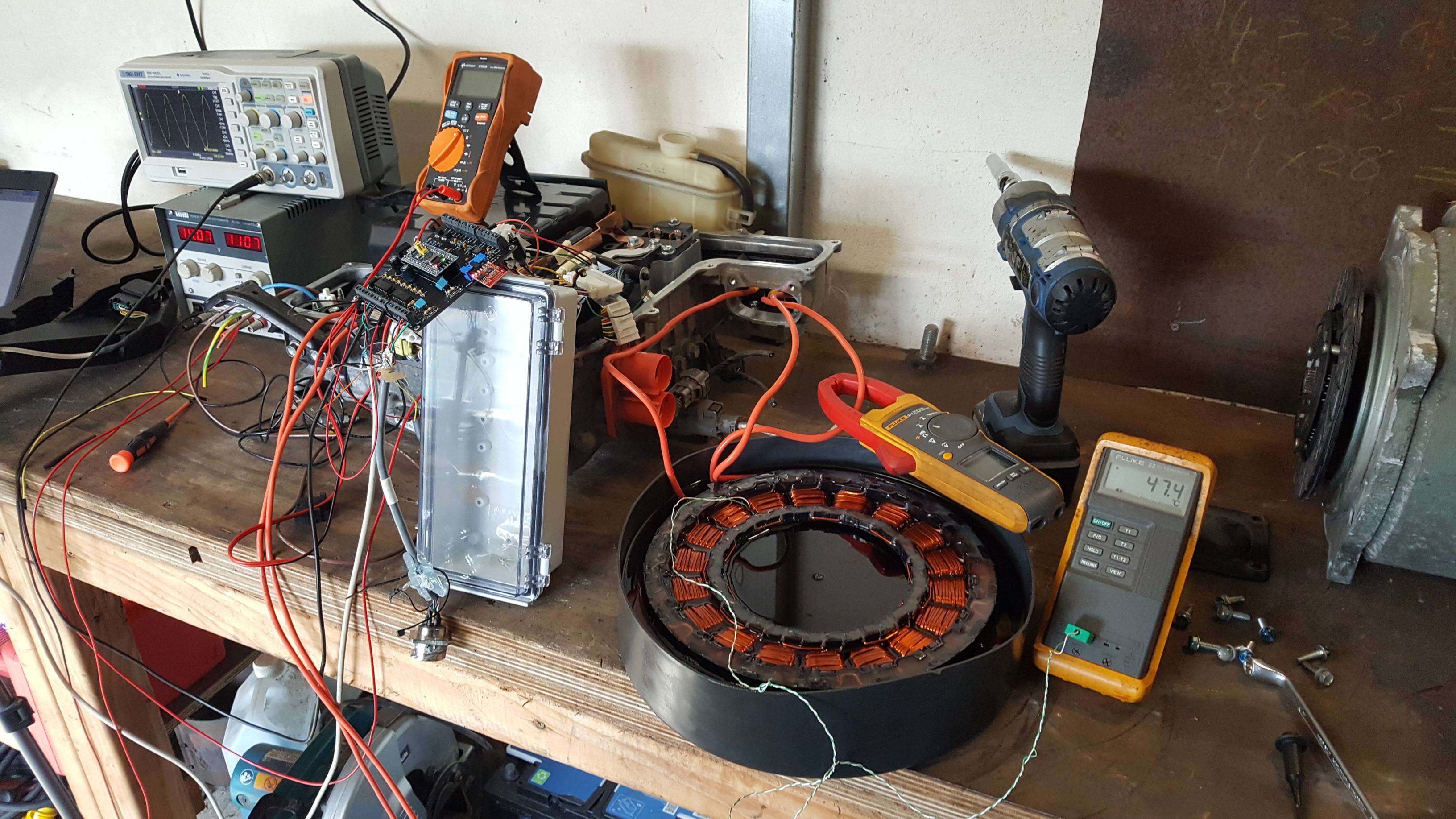

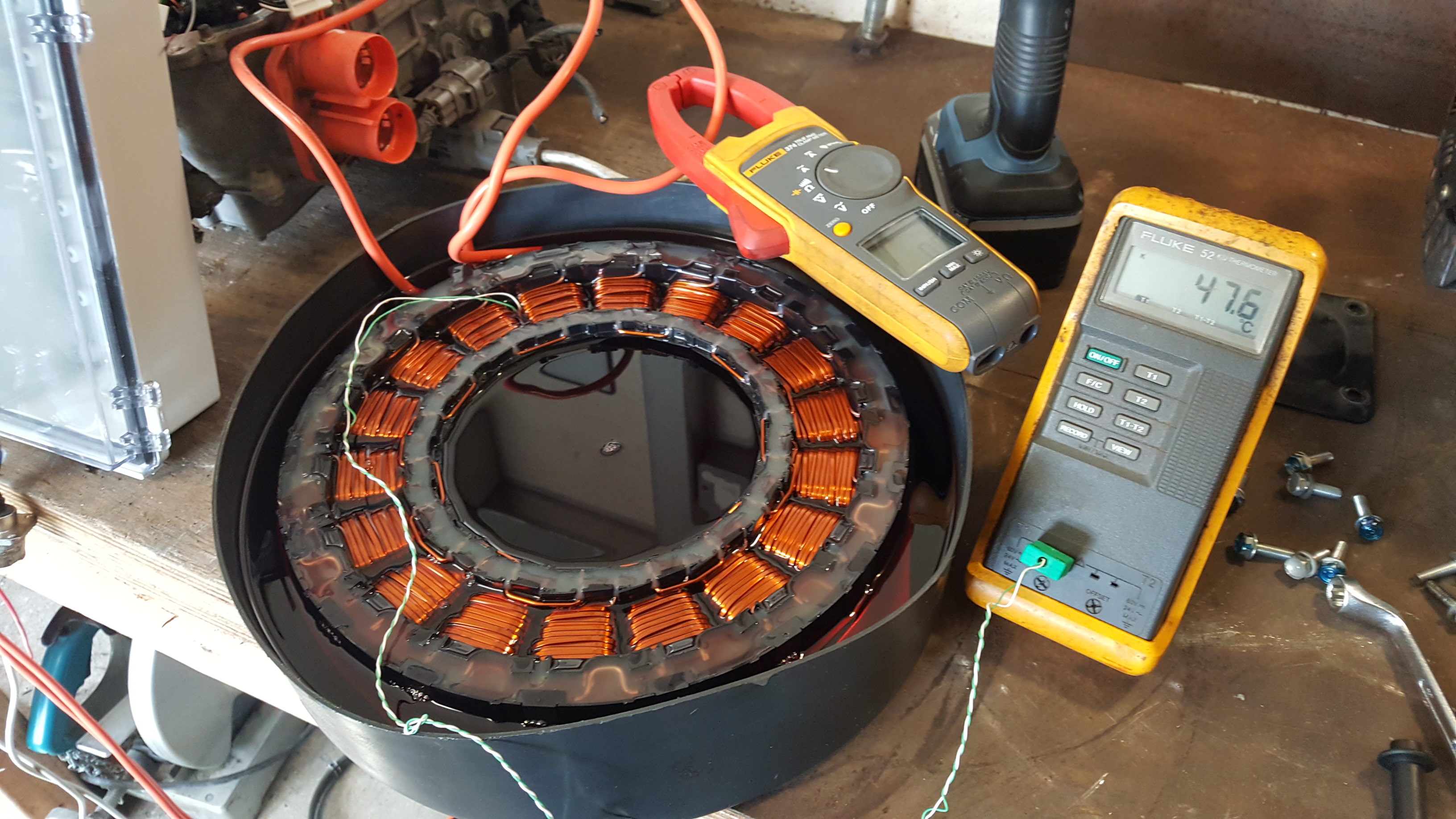

For anyone out there who doesnt think the Gen 2 Prius inverter can handle much current ....
Posts: 3999

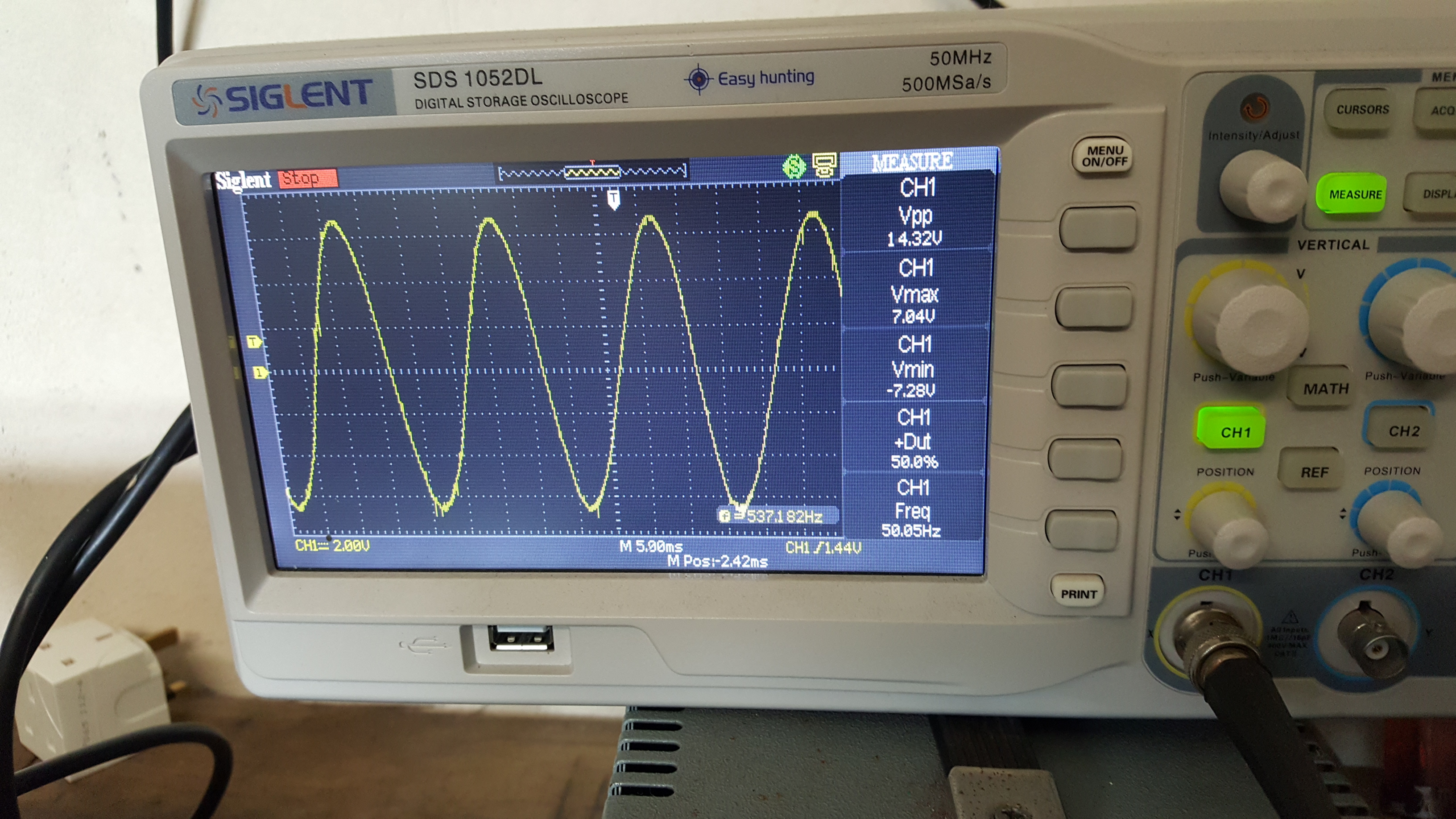

210A RMS at 50Hz max current I could push through MG2 with the voltage available and risk of melting the Insight IMA motor stator I was using as a dummy load oil cooled in ATF. No cooling on the inverter. No shutdown or overcurrent trips. At 200A rms MG2 current sensors were swinging +/-7.5V perfect sine wave.

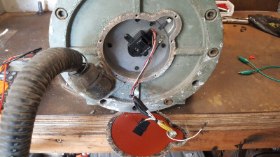

Was also able to run an induction motor in full closed loop mode once I realised the stupid morons at Enova had wired the encoder cable screen to the motor casing :x
