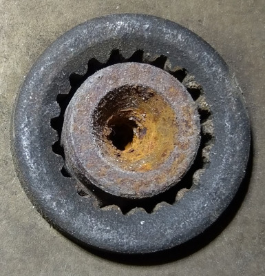

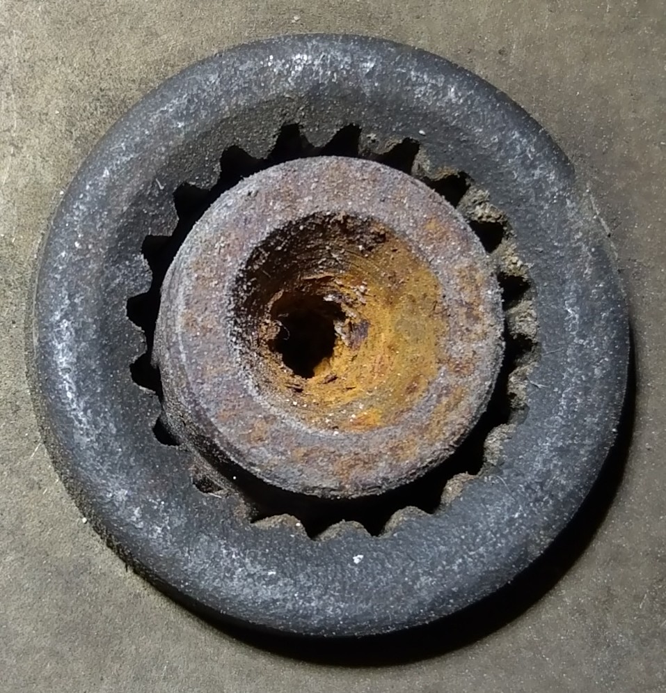

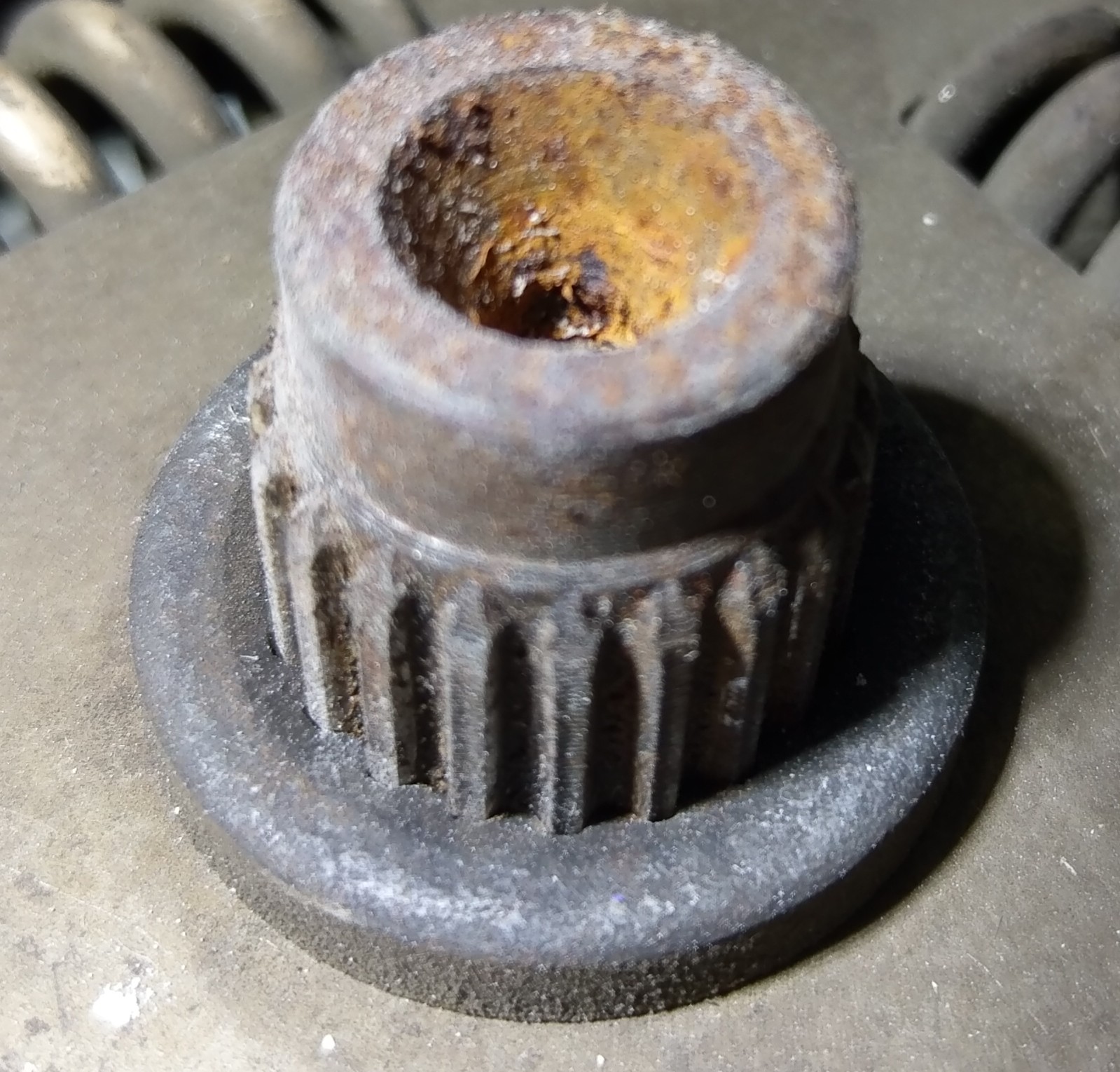

celeron55 wrote: Fri May 08, 2020 4:46 pm The ghetto Leaf coupler is a Blue Print ADC43101 clutch disc or similar. It fits a bunch of japanese and korean vehicles and is cheap.
Damien is using a Fiat Van clutch disc (watch from 2:35) :)
Is this the clutch plate?
Clutch Plate Fiat Ducato 2500 Turbo Diesel MK1 85-93 Clutch Disk?
He mentions it being a Fiat Multipla.

Think the Suzuki one fits too,
Think thats what this guy did

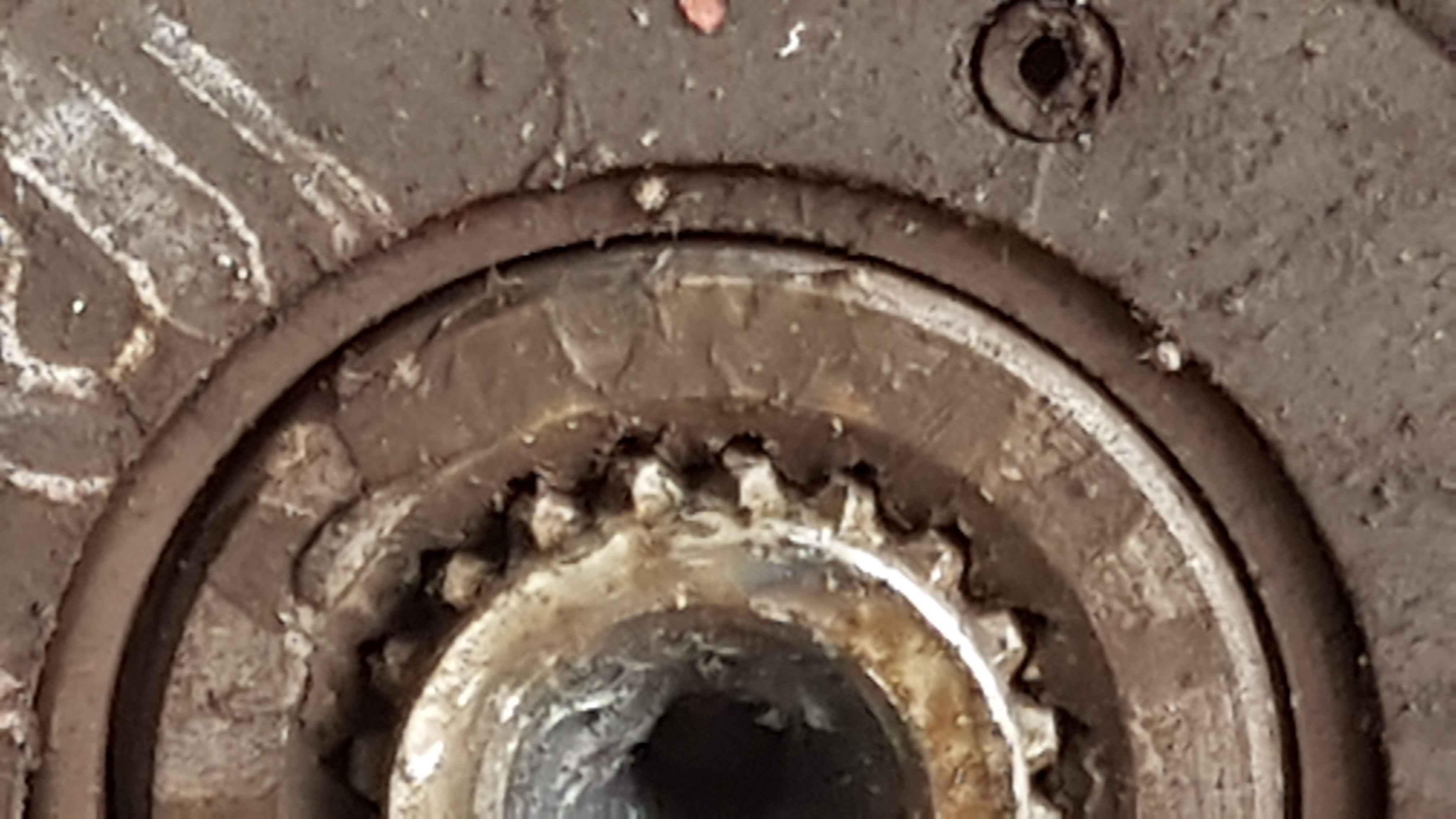

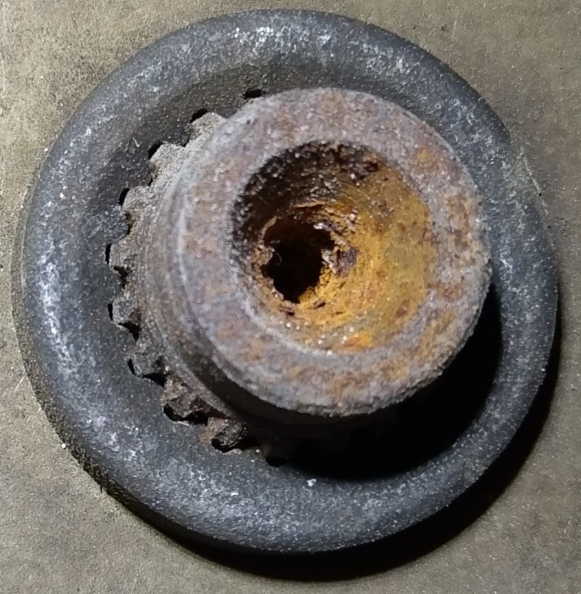

Here is how the 1.6l Fiat Multipla centre spline fits the Leaf output shaft

I think the same. On my Mazda original clutch is rattling like old kettle. So finally i put two clutch center pieces in my coupler. Now i have peace of mind... It still rattles though.

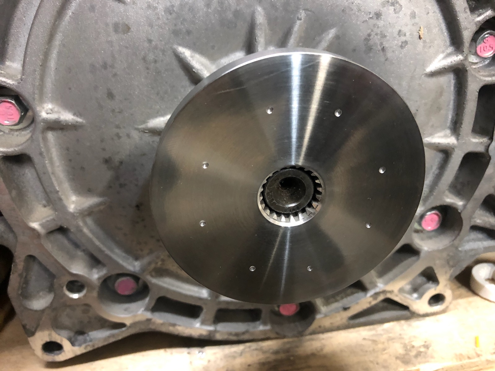

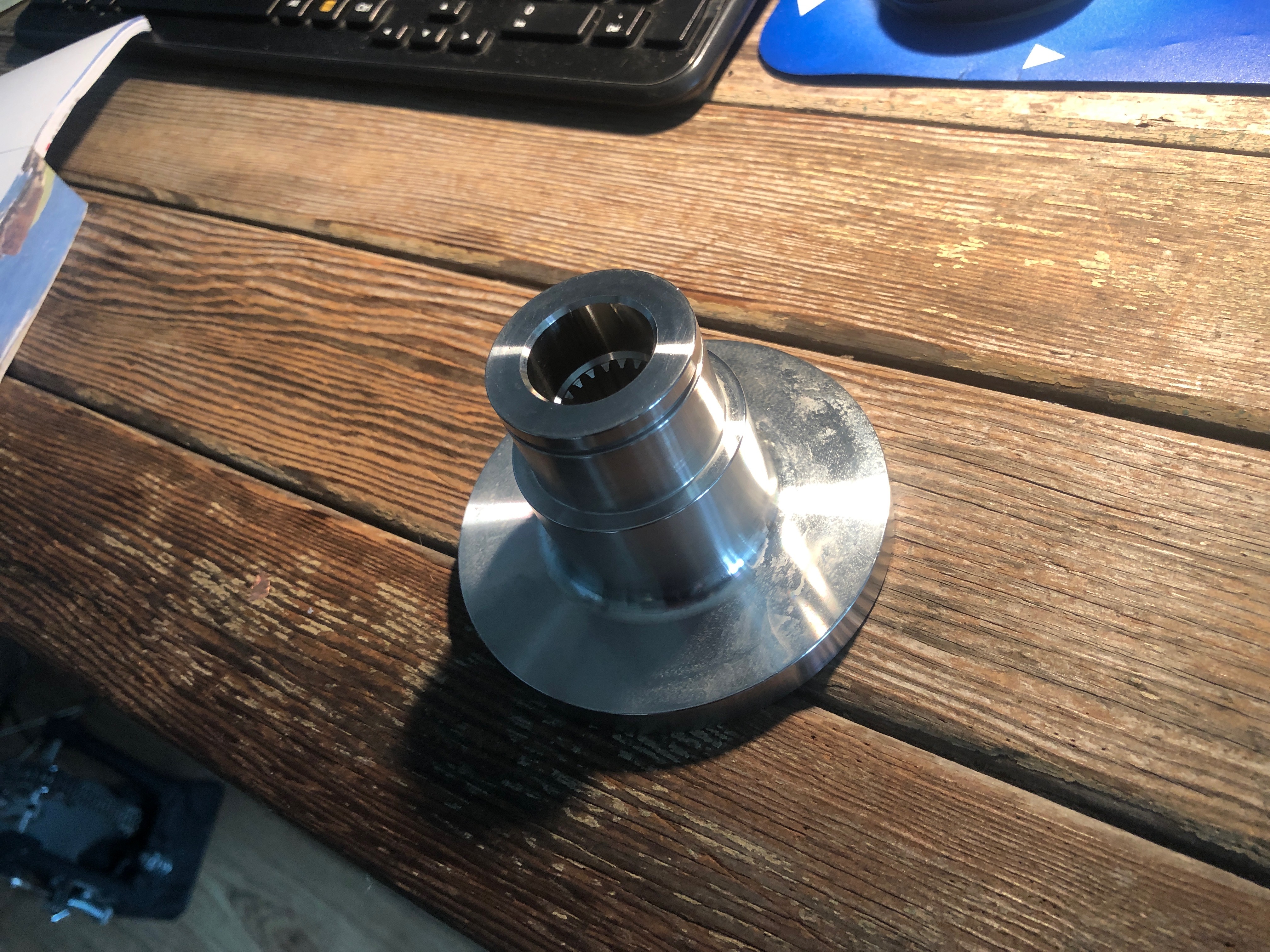

Some time later :)
fits like clockwork

Bratitude wrote: Sat Jun 06, 2020 5:10 pm Some time later :)
fits like clockwork
Wait. Are you putting a flywheel and clutch on this? If so...hmmmmmmm...How can I get one of these in the US?

Looks great!
I'd love to purchase one of these from you. I have a CNC machine so I'm planning on making my own adapter plate and would integrate the same spec'd angular bearing.
Are you in a position to start selling the coupler?

mdrobnak wrote: Sat Jun 06, 2020 5:52 pm
fits like clockwork
designed the coupler to be as universal as possible, so yes with the angular contact bearing you should be able to mount a flywheel.

Hi everyone. This is my first post. I accidentally came across a clutch from suzuki samurai. What do you think about this? 20x20,1x23,1
Multipla has 20x20,2x23,2

That and the fiat clutch plate are your only choice unless you can get a custom one make.
Checkout Damien's video on making the coupler

Just curious, why did you go with stainless steel?
Posts: 1156
Has thanked: 246 times
Been thanked: 469 times
Re: Leaf spline coupler
Phil3D wrote: Wed Aug 12, 2020 5:22 am Just curious, why did you go with stainless steel?
Cost, machineablity, corrosion resistance, strength, welds well too. What 3D hubs had to offer, 304l seamed like a good choice

The marked bolt pattern (should) match a rotex gs38. but it’s really up to you.
I’m not using a rotex in my application. I’ve milled the transmission coupler with a tapperd angled extrusion(which matches the tapper on the leaf coupler) to centre / provide a friction connection. all clamped together with a 6 m8x1.25 bolts.
