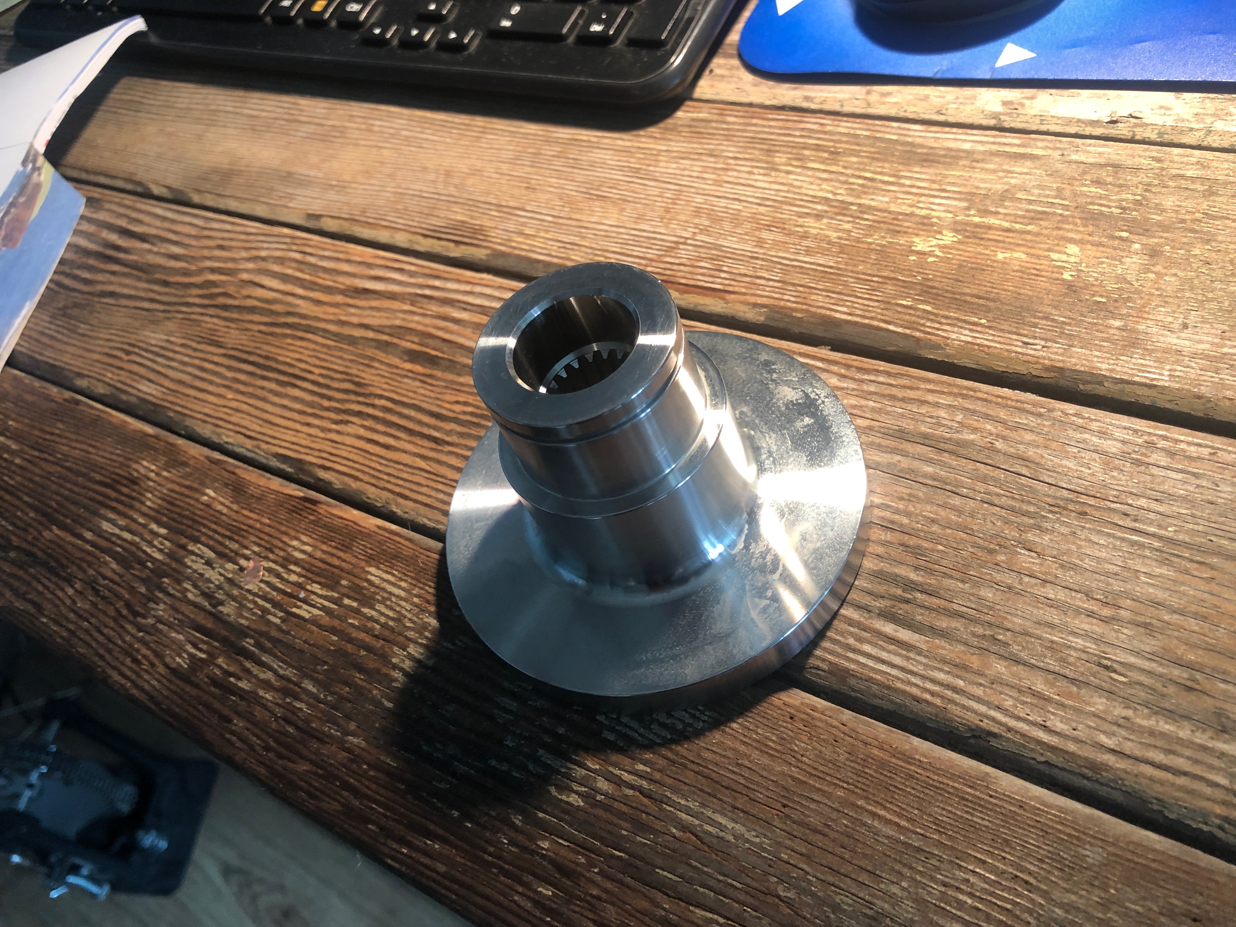

Some time later :)
fits like clockwork

Bratitude wrote: Sat Jun 06, 2020 5:10 pm Some time later :)
fits like clockwork
Wait. Are you putting a flywheel and clutch on this? If so...hmmmmmmm...How can I get one of these in the US?

mdrobnak wrote: Sat Jun 06, 2020 5:52 pm
fits like clockwork
designed the coupler to be as universal as possible, so yes with the angular contact bearing you should be able to mount a flywheel.

Sorry, my mechanical knowledge is trash. Does that mean it has a contact bearing in it, or a shop should be able to easily put one in? This solves the concern everyone had about putting too much load on the shaft, correct? Because the bearing is supporting it now?

It looks awesome! However, you can free my spot as I've gone another direction.
-Matt
Phil3D
Re: Leaf spline coupler
Post by Phil3D »
Just curious, why did you go with stainless steel?
Posts: 992
Has thanked: 168 times
Been thanked: 351 times
Phil3D wrote: Wed Aug 12, 2020 5:22 am Just curious, why did you go with stainless steel?
Cost, machineablity, corrosion resistance, strength, welds well too. What 3D hubs had to offer, 304l seamed like a good choice

The marked bolt pattern (should) match a rotex gs38. but it’s really up to you.
I’m not using a rotex in my application. I’ve milled the transmission coupler with a tapperd angled extrusion(which matches the tapper on the leaf coupler) to centre / provide a friction connection. all clamped together with a 6 m8x1.25 bolts.
