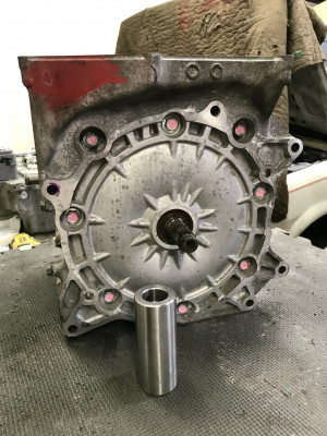

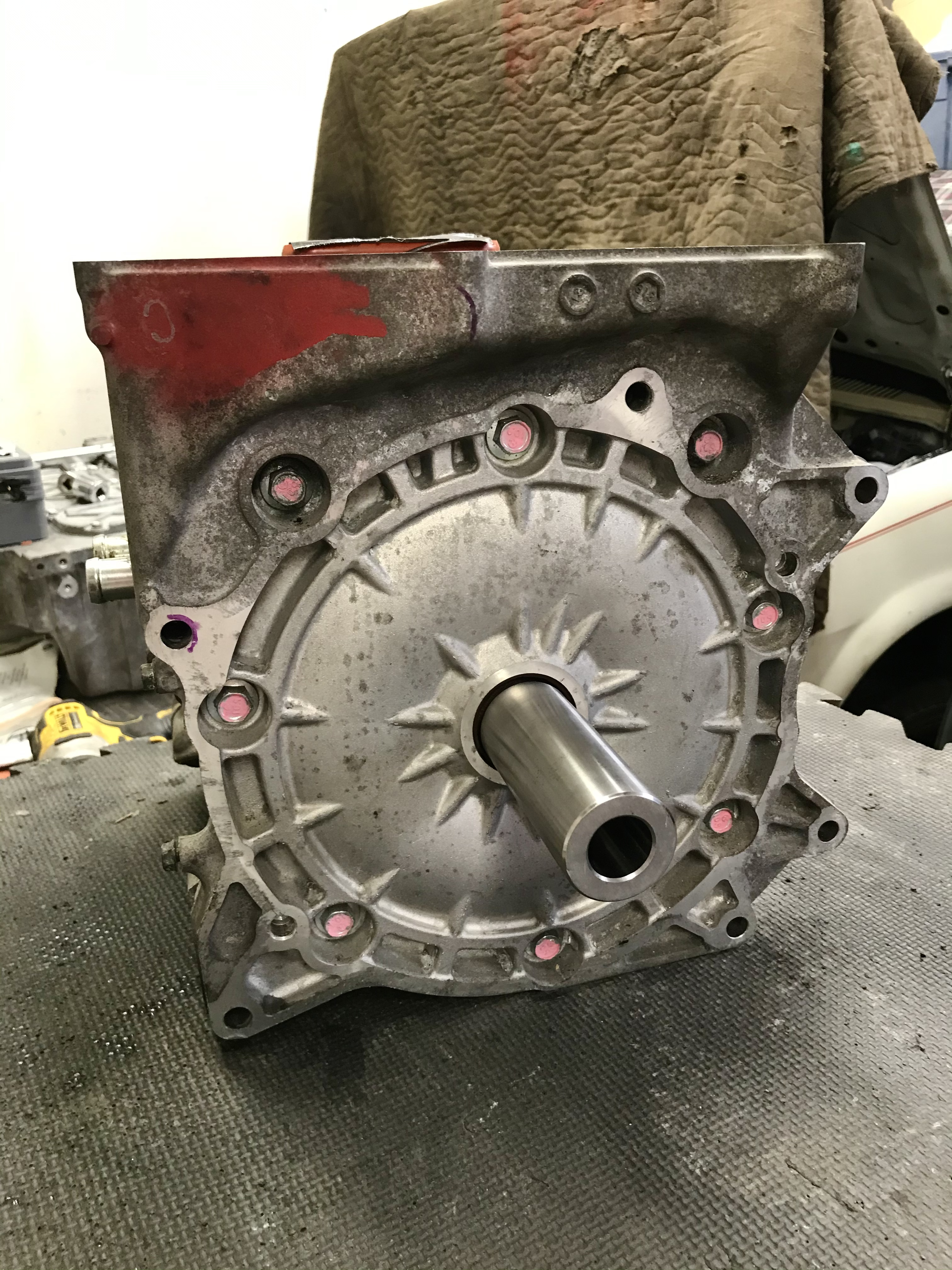

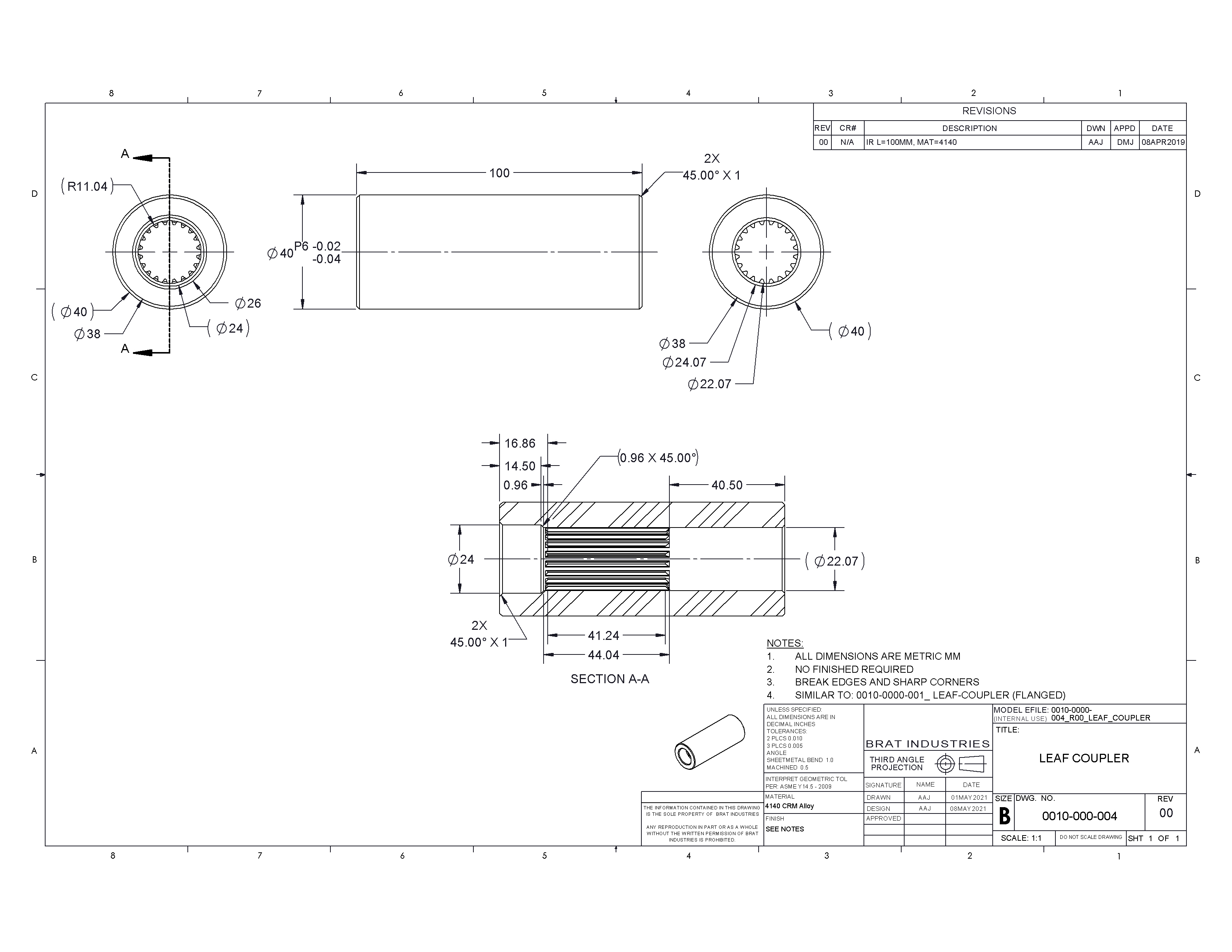

gen1 (em67) and gen 2 leaf motor (EM57) shaft coupler
4149 chromoly steel
-designed to optionally mate with a 7208b angular contact bearing (removes any loads on the leaf motor shaft)
additional machining required
Adapter plate CAD :https://github.com/angusjo/leaf-splines ... ate.SLDPRT
When the bearing is utilized, mounting flywheels or drives shafts is possible.
260$ CAD + shipping

Whats the plan on cutting the splines? EDM or broached?

slow67 wrote: Mon Feb 24, 2020 8:06 pm Whats the plan on cutting the splines? EDM or broached?
Broached currently, still looking at edm services.
Cnc service is the most streamlined/best cost from what I’ve seen

Broached will likely be the cheapest in the long run (after the cost of the broach is overcome).

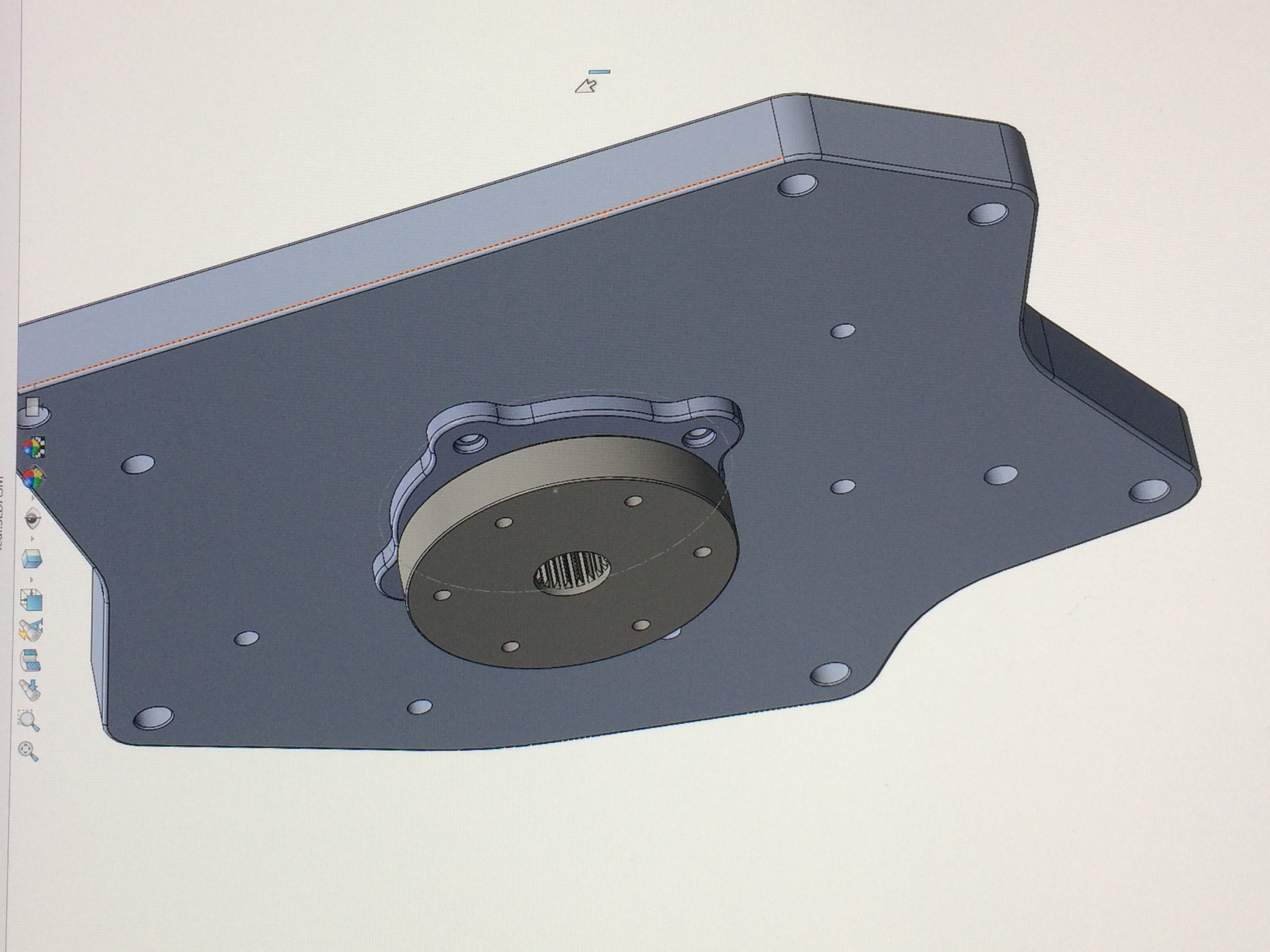

I’m thinking of leaving out the bolt pattern, so it’ll be blank. So what ever pattern anyone wants they can mill it after the fact.
Also making it compatible with a variety of 1 1/2 bearings so you can connect a flywheel or drive shaft.

How did you determine the profile of the splines?
I've got a Outlander rear motor here with a splined output and can't find anything that might fit the splined shaft.

Yup. Almost done the design. Putting together a universal system, adapter plate, with a angler thruster bearing. Besides just direct coupling to a transmission, you could set up a fly wheel or drive shaft as well.
Working to keep costs low and increase use case.
I’ll have updates very soon and do a bulk order of the coupler.

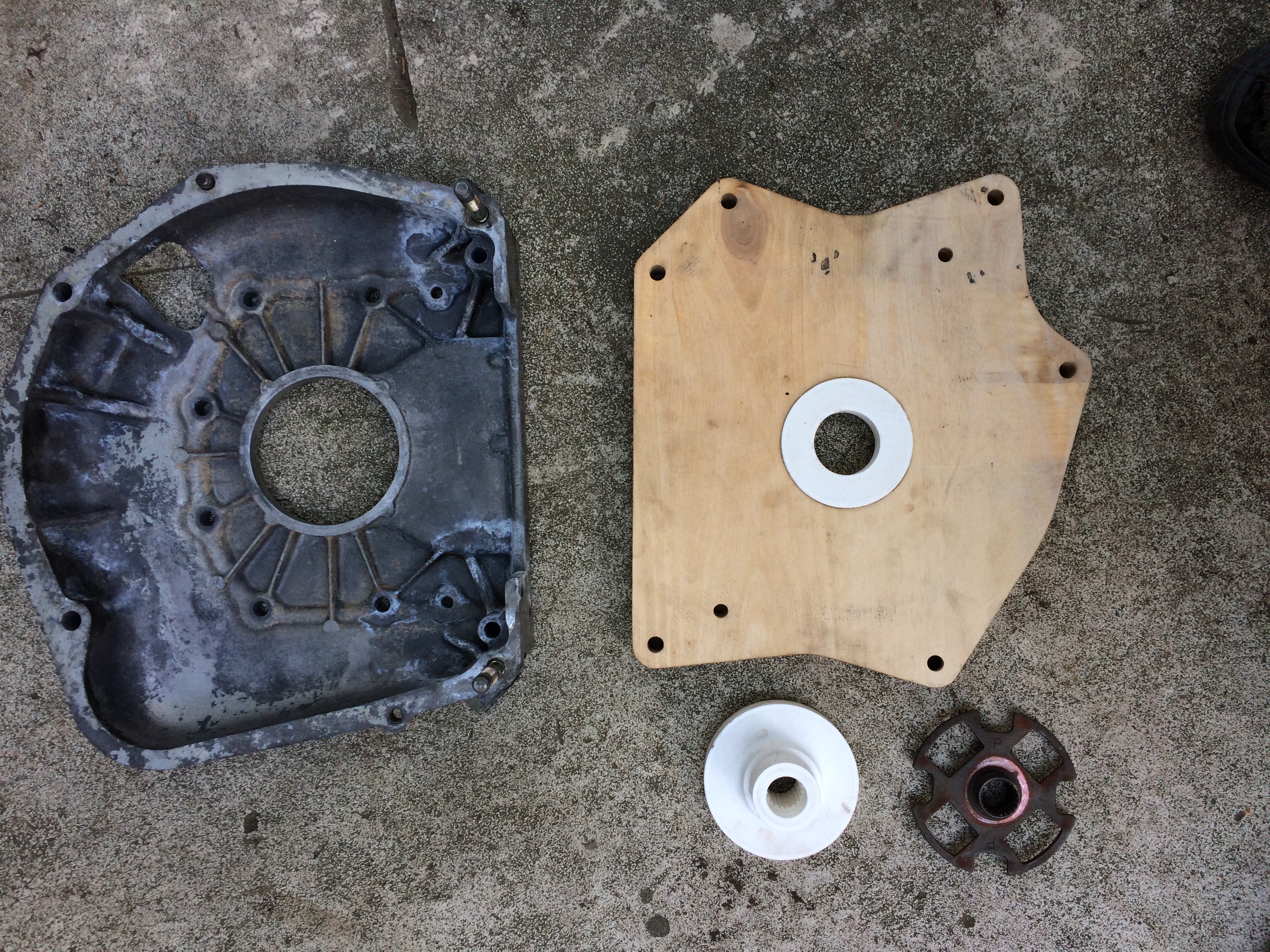

I am also running a Leaf motor and have gone the usual route trying out different clutch plates (Daihatsu, Volvo etc..) to no avail. I am interested in trying out your solution when it becomes available

The ghetto Leaf coupler is a Blue Print ADC43101 clutch disc or similar. It fits a bunch of japanese and korean vehicles and is cheap.
It's a loose match and probably different spline profile, but I've been running it for almost 30 000 km in my minivan so far just fine. There is enough meat in the splines. I assume the quite soft motor shaft will adjust to the very hard clutch profile over time.
If anything, at least it's taking a whole lot of time for anyone to be able to tell me "I told you so". 8)

Ill try to dig out the specs. Spent a good amount of time setting the coupler up to be fairly universal for most people’s needs
What I currently access to.
was ether a 3in or 2.75 di plate with centring marks that match the rotex gs38 bolt pattern.
couple will nest in an angler bearing, with renting clip. For those wishing to run a clutch or drive shaft.

celeron55 wrote: Fri May 08, 2020 4:46 pm The ghetto Leaf coupler is a Blue Print ADC43101 clutch disc or similar. It fits a bunch of japanese and korean vehicles and is cheap.
I smashed two blueprint Mazda center pieces couple of years back. It is not very hard too.
If I may suggest you put two center pieces in line and weld them in your coupler. That way it will definitely hold.
Torque is transfered along the shaft length...
