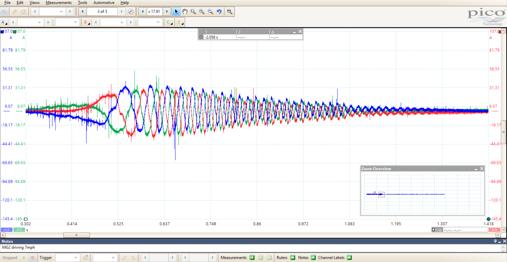

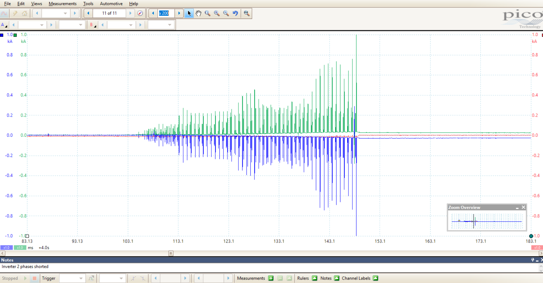

Been following this with interest.
I have been playing with scoping current using Pico scope and 3 phase current clamps.
This is a Gen 3 inverter with 2 MG2 phases shorted together, the peak current before it shuts down is very interesting.
davidwagstaff
Posts: 11
Joined: Sat Sep 28, 2019 8:00 am
Location: Devon, United Kingdom
Re: Toyota Prius Gen 2 Inverter Controller
Post by davidwagstaff »
This is normal operation without the short in place.
Posts: 3999
Been thanked: 1114 times
@davidwagstaff very interesting. I am really begining to suspect the toyota inverters are capable of a lot more than the internet leads us to believe.
