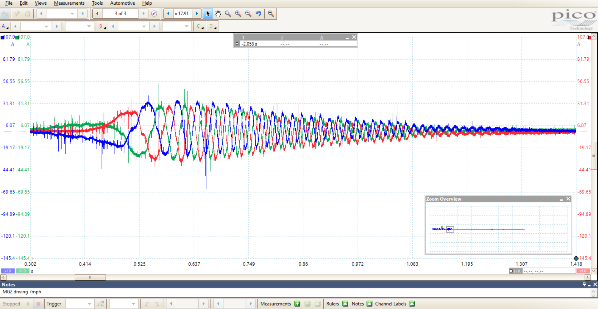

Been following this with interest.
I have been playing with scoping current using Pico scope and 3 phase current clamps.
This is a Gen 3 inverter with 2 MG2 phases shorted together, the peak current before it shuts down is very interesting.

@davidwagstaff very interesting. I am really begining to suspect the toyota inverters are capable of a lot more than the internet leads us to believe.
