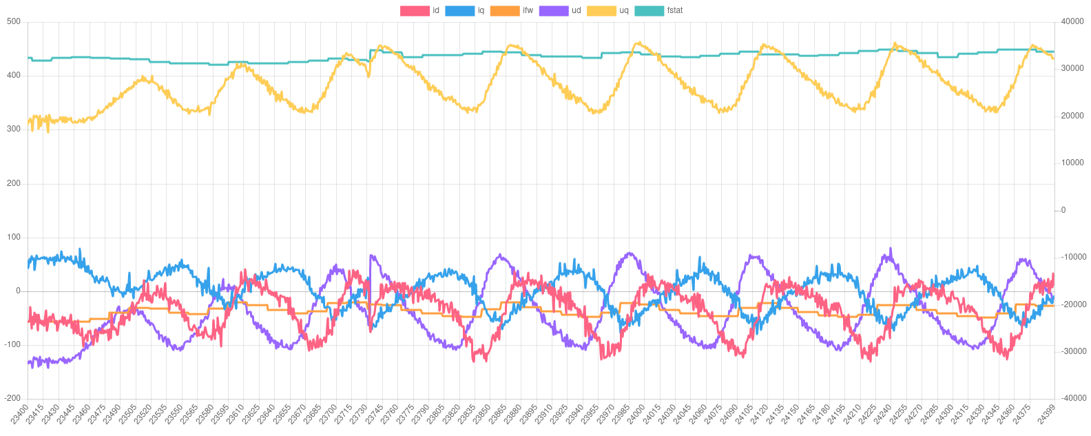

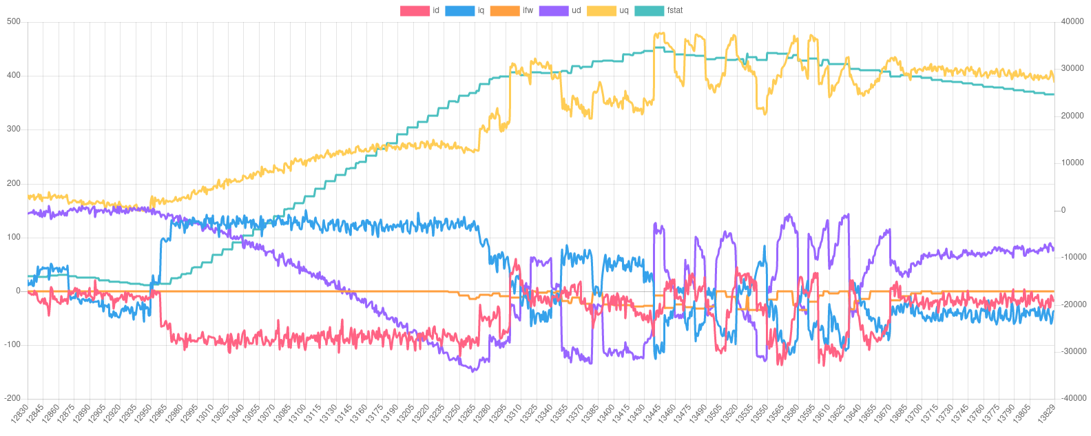

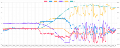

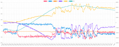

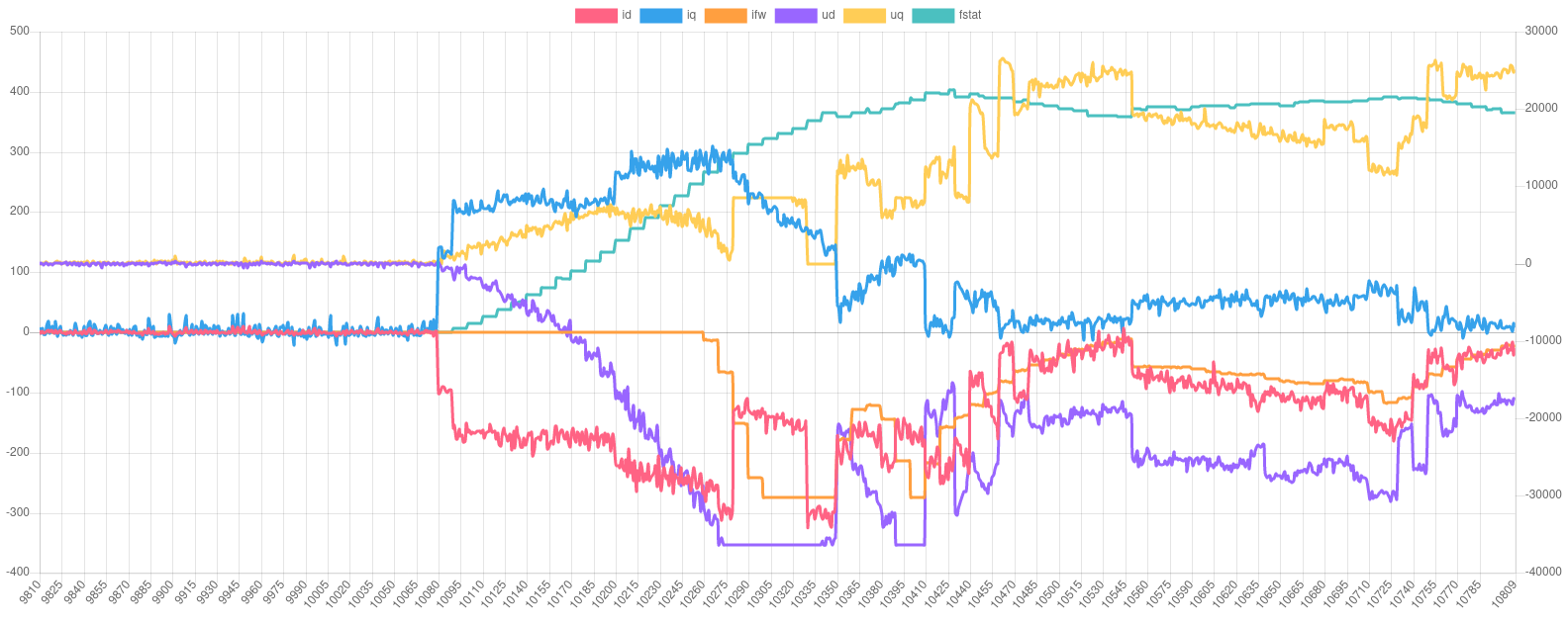

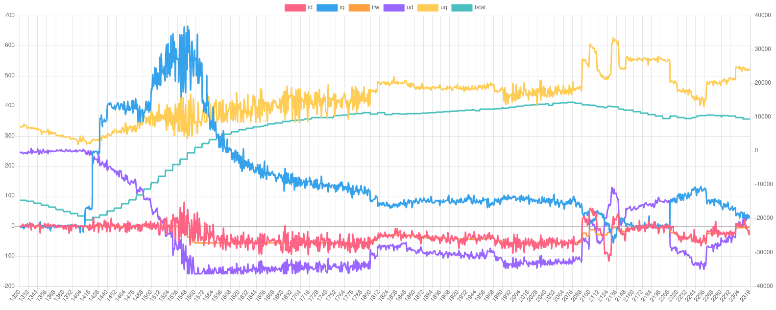

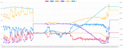

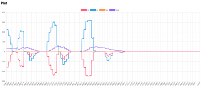

More test driving, 9 and B uphill, A and C downhill
First uphill, fwkp=5, fwki=40, fwmargin=3000. Field weakening kicks in early enough but causes oscillation in both id and iq Now downhill, fwkp=5, fwki=10, fwmargin=3000. Field weakening kicks in but as soon as I enter regen the inverter faults out with DESAT! I haven't seen that for ages. Maybe the overflow in the inverse transform? And uphill again, fwkp=5, fwki=1, fwmargin=3000. Pretty good, feels stable while on throttle but when getting near the coasting point oscillation comes back in. We still see some voltage saturation but it is resolved. And the last run, downhill, fwkp=5, fwki=1, fwmargin=4000. Regen comes in even at regen but the whole thing still looks far from stable. Another method could be removing fwki and instead filter the amplitude. Of course it slows down response but it seems like the FW controller doesn't have to be very fast. With the filter fwkp could be raised again.
EDIT: might also be worthwhile to run the torque throttling in a separate controller as you did.

Getting there though.
Did you try winding fwkp right down? I found anything above 1 started to cause oscillation. I think it is because the controller is run much less often now it needs to rely a lot more on the i than the p.

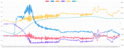

I did a build of latest code and give it a little test. Feels perkier. 0.6 ldminuslq, 90 fluxlinkage, 0 syncadv
Will have more time to mess with params at the weekend. The more interesting bit of the graph had gone off screen by the time I'd stopped

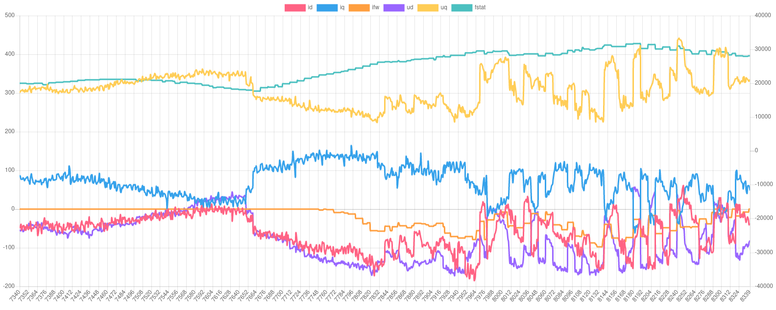

Good to see, that was Outlander+Prius, right?
Speaking of which... The FW-controller seems to output something meaningful but then the d-controller has trouble implementing it at higher speeds. To I took a closeup and we see the two controllers awfully oscillate. I'm thinking the PI gains aren't right yet. So starting to think this through. In the pesky "new tricks" video ki=R/L. So bexander measured 75mOhm and Ld=2.15 mH, Lq=6.33 mH. So then ki_d=75/2.15=35 and ki_q=75/6.33=12. But I have set it to 20000. Or have I?
Above factor expects SI units, not weird digits. So lets say full amplitude 37500 yields 255V AC (360V DC input). A factor of 148. That leaves us with 20000/148=135. So from the supposed 20000 loop gain we are left with 135. Going back from that we'd end up with curki=35*148=5180 and 12*148=1776.
kp should be L*bandwidth in rad/s. Does that mean maximum desired electrical frequency? So curkp=2.18*600Hz*2*3.1415=8 and 24 for q-controller.
So that would be MGR parameters. Do we need to introduce a second set of curkp/ki parameters?
EDIT: above plots were done without MTPA and with filtered amplitude. Filtered in PWM ISR with filter constant of 8.
EDIT2: I've never seen felt or seen these oscillations with the d-current commanded by MTPA. So it's probably the quick variation in d-current that throws the controller off...

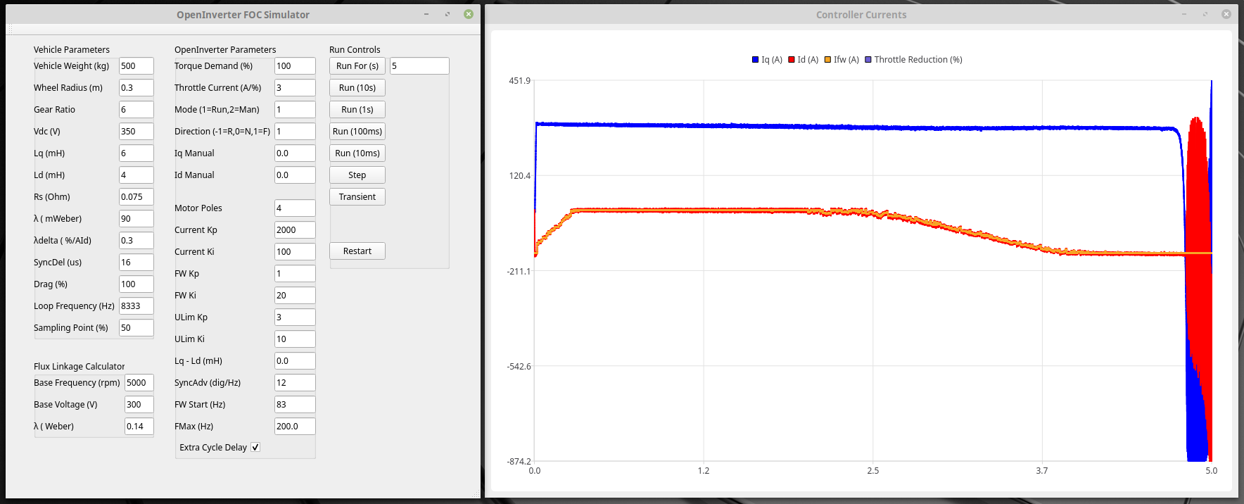

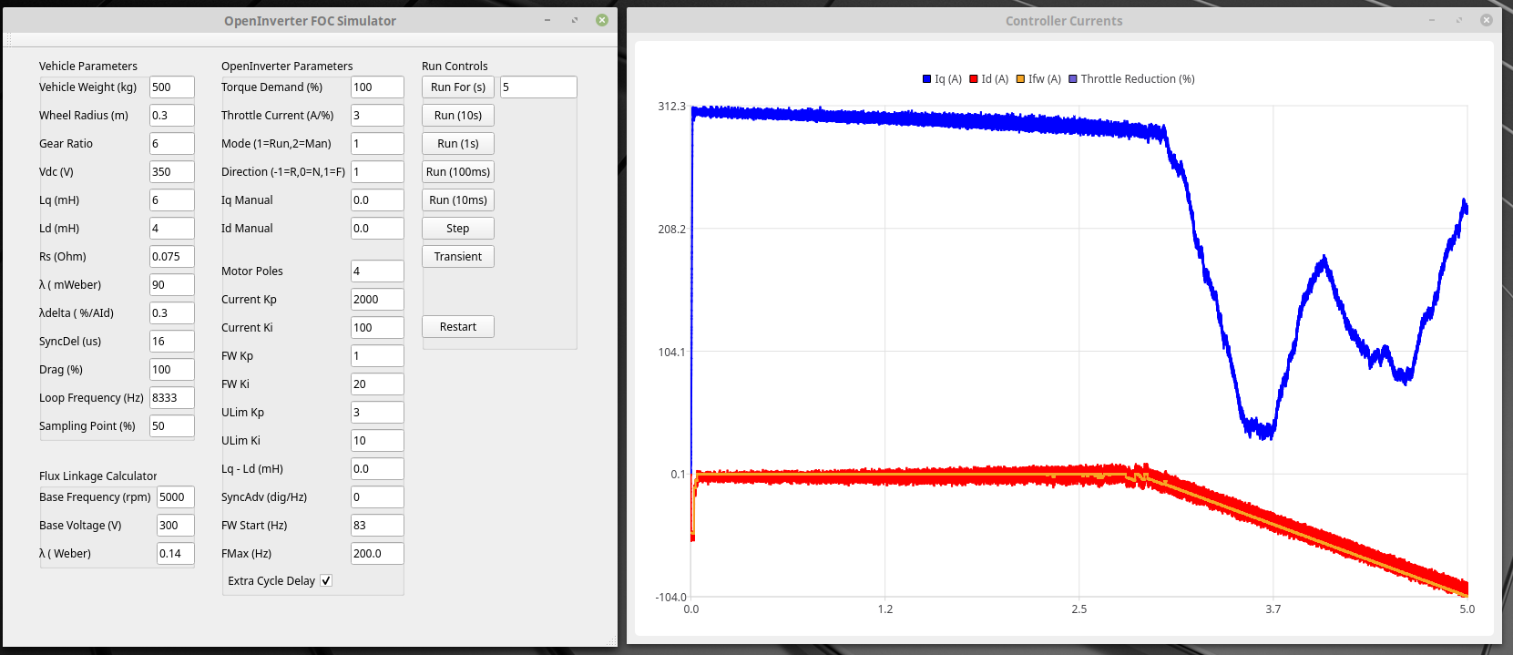

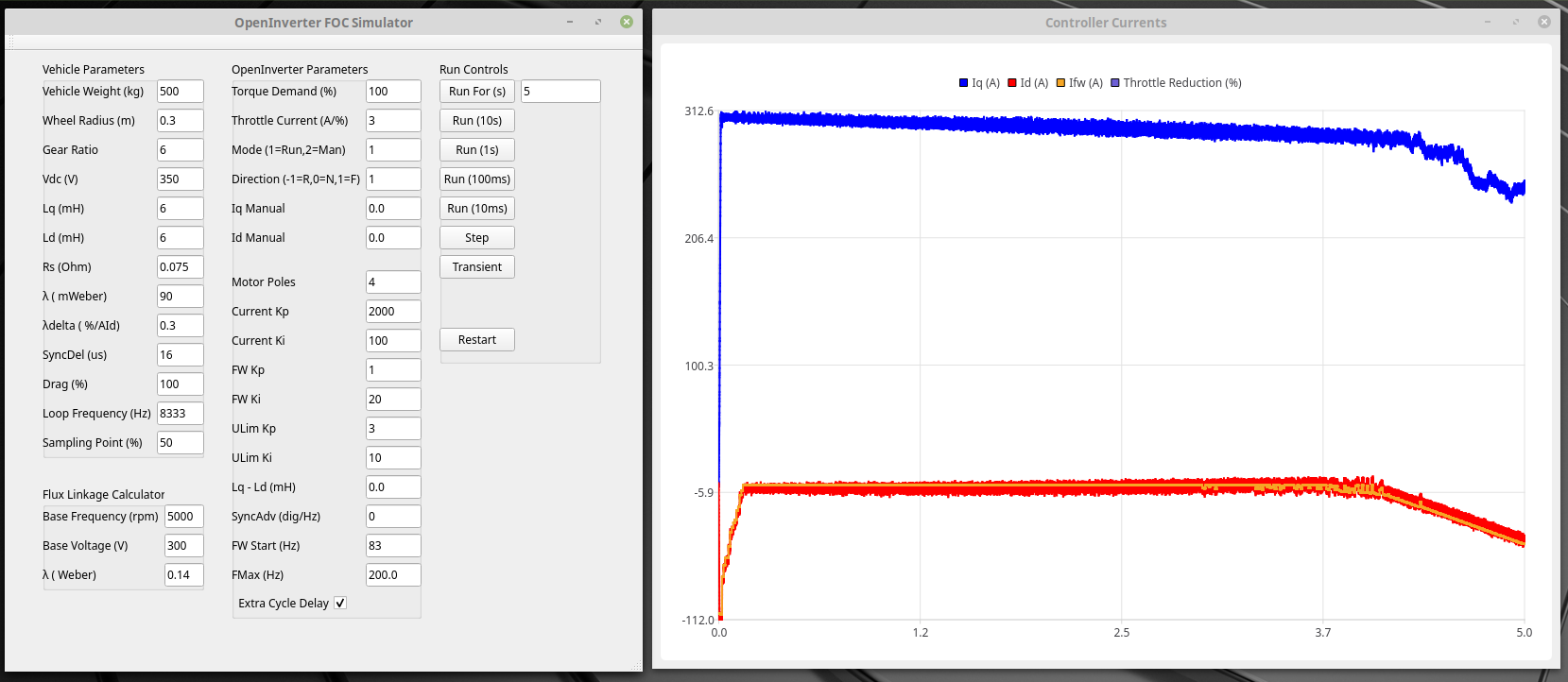

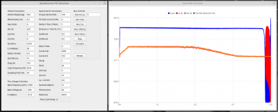

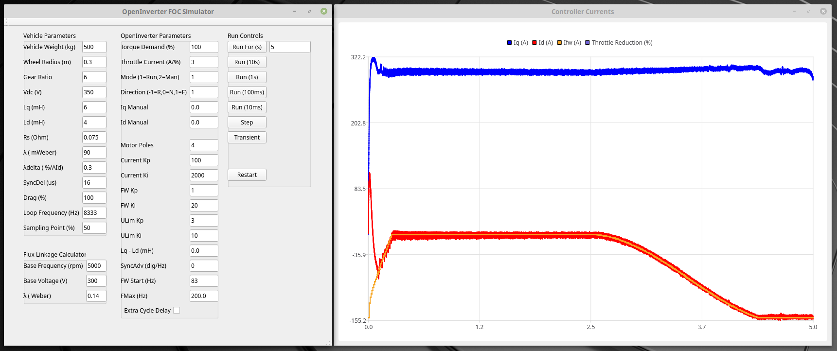

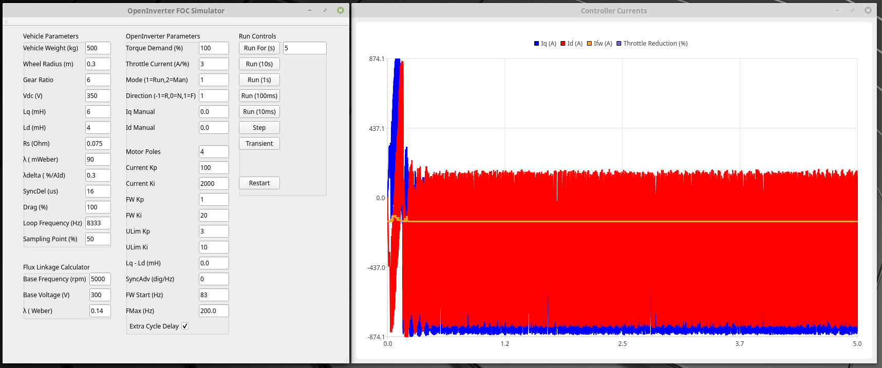

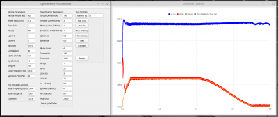

When I simulate different FW controller gains this is what I get with very low fkkp:
As soon as the fwkp is increased it turns to this:
The second looks much closer to the results you are getting which makes me wonder whether this is the issue? Of course it could be the lack of noise in the simulation that allows low kp to work so well. I'll add a bit of noise and try it again.
The other issue I had with the fw controller was that the input range to the control meant that it was very one sided. To increase FW current the max error term could only be a few thousand (fwmargin), for decreasing it could be much bigger (GetMaximumModulationIndex() - fwmargin). This means that the controller output can move in one direction much faster than the other leading to an imbalance in the response. I found limiting the error term to prevent this helped with stability.

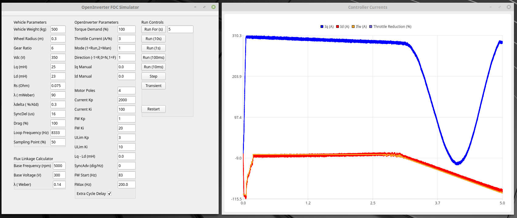

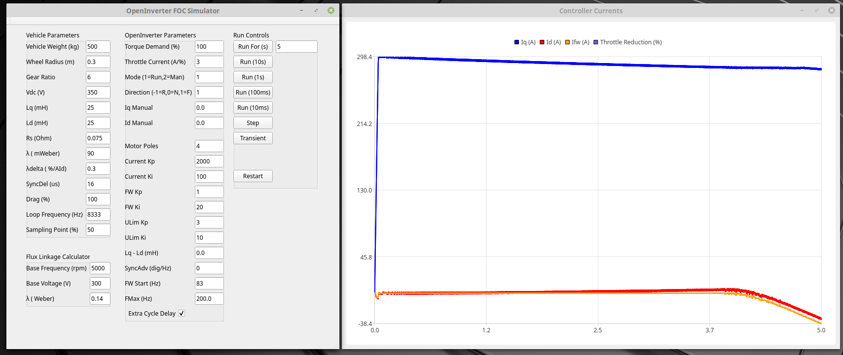

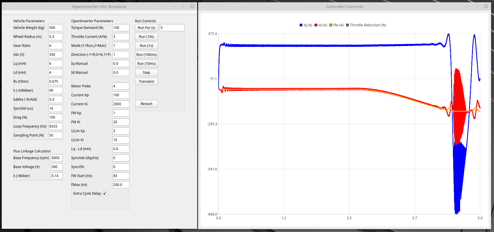

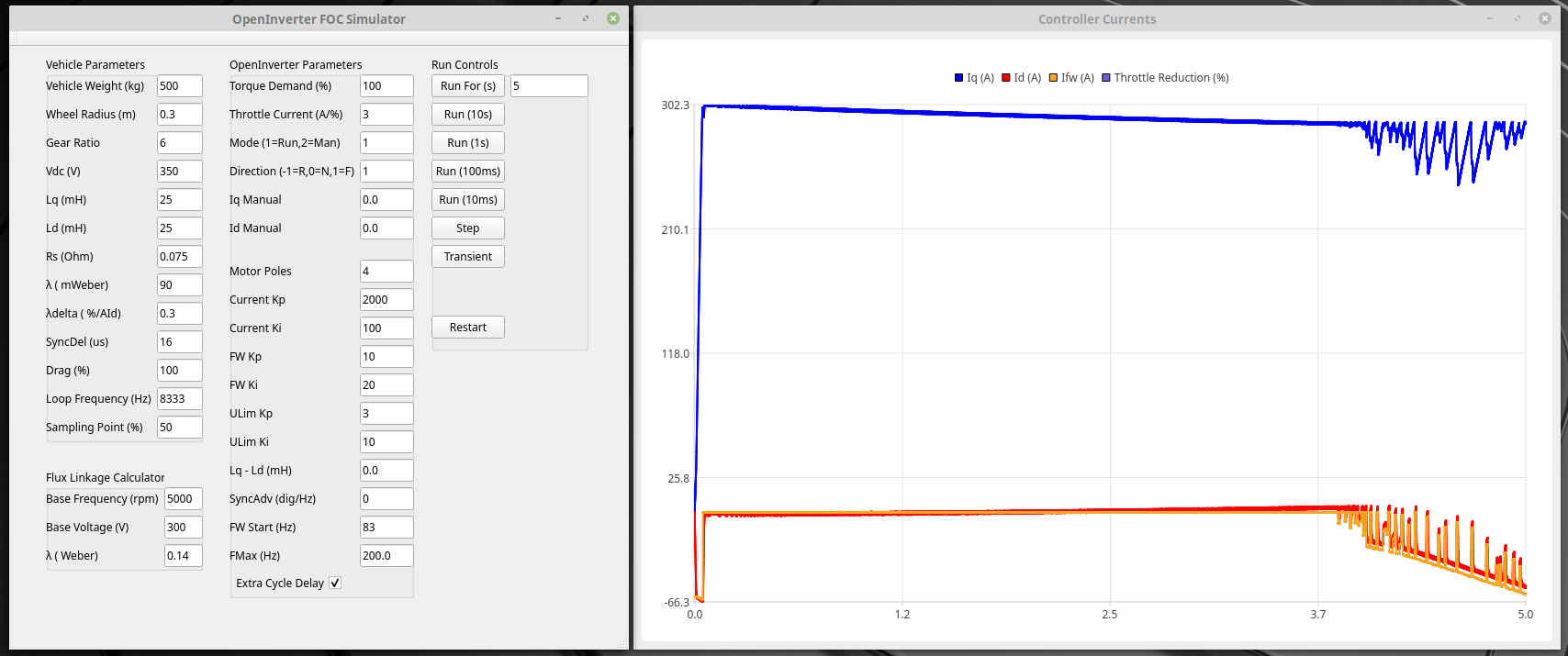

Now that's interesting, noise didn't make a difference but Lq and Ld do. First tried with a lower matched values of Lq and Ld:
Bit worse but not too bad. Then with non matching Lq and Ld:
Not good! Finally went back to larger Lq and Ld but still non-matching:
Also not good.
Looks like your idea of different kp and ki for Iq and Id may be on the money
Edit - Not so sure now, it seems that it's the fwmargin value, increasing this to 8000 (I think that's the value you use) fixed it: Note : the loss of control at the right hand side (where it runs out of FW) is at around 1000rpm.
It could be that individual kp and ki could allow a reduced fwmargin though?
Rather than having separately tuned values could try scaling them according to the Lq/Ld ratio?
Edit - Just tried scaling ki and kp for d to be 2/3 the value for q - made no significant difference to the plot.

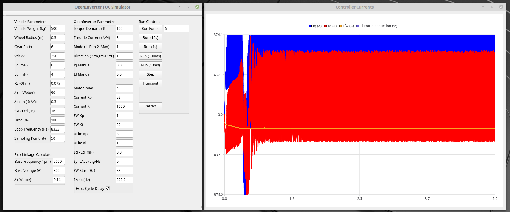

Just uploaded bigpies build, set ki=100 kp=200 fwki=1 fw kp=20
Felt very smooth but experienced uncontrollable full throttle at revs over 3000, had to key off to stop, wasn’t great fun, went back a build to drive to work any ideas?

curki=100 and curkp=200 is totally out of scope. Seems to work in simulation but not in the real world. Should be more like curki=10000 and curkp=50. Also don't forget to set syncadv=0.5

Probably a noob question but what does it trip out on?Bigpie wrote: ↑Fri Sep 09, 2022 8:11 am Did some more testing, low rpm feels to have more torque, higher rpm seems better too, it used to sound a bit like an engine hitting the rev limiter as the rpm increased but now the rpm is more stable. Inverter trips out more easily though.
Didn't graph as was taking the kids to school.
Those values do sound a bit off, could you check? Not seen any problems like that until well into the field weakening region!
If the consensus is that the simulator is not representing reality then I need to figure out why and fix it. If everyone could post their settings I'll give them a try.
I'm wondering if my approach to tuning the constants is leading to a different solution. I always tend to tune for kp first (with ki set to 0) and then once that is ok start working on ki. That tends to lead to higher kp and lower ki. I do it that way because I've found less stability problems that way round but maybe its the wrong approach for motors?
Edit - is there a tuning guide anywhere for setting these?

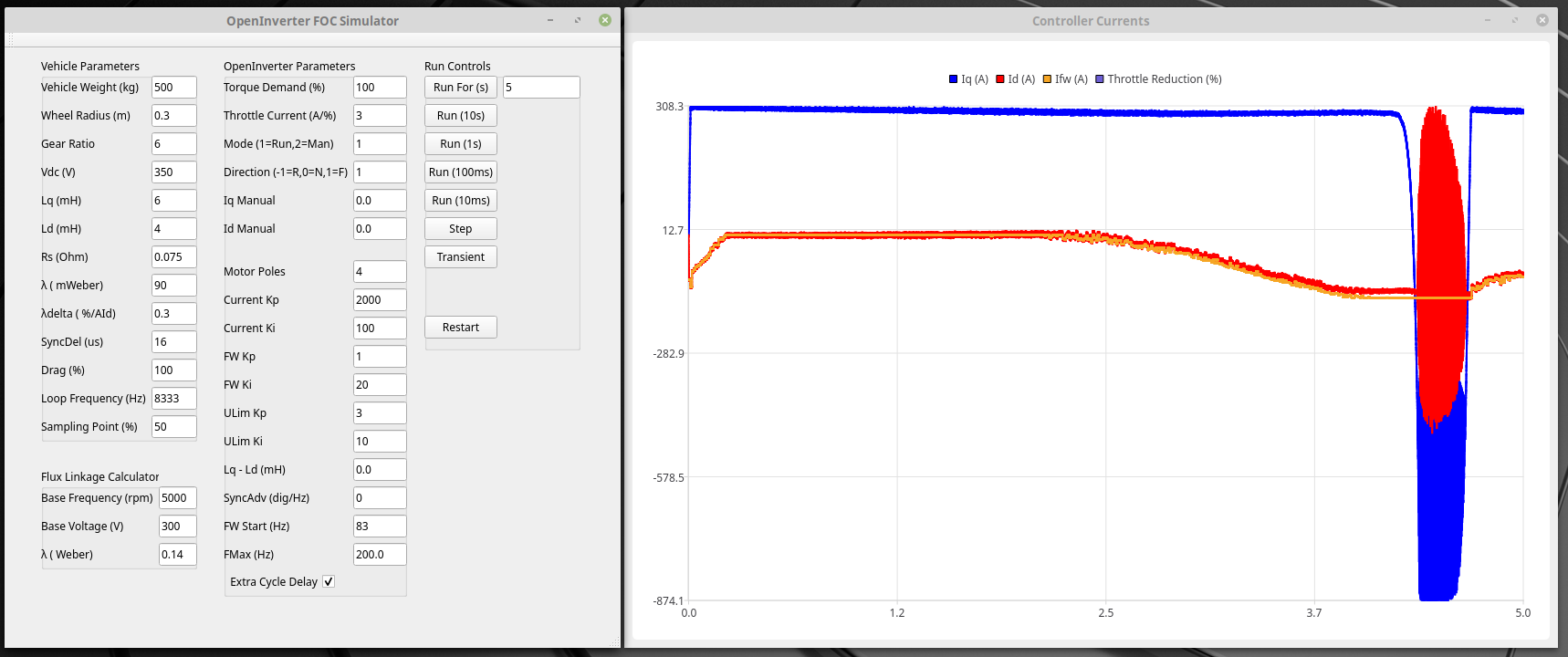

There is definitely something different here, this is what I get with my settings in the simulator:
Ignore the bit on the right, I've been playing with the FW and it's broken something!
This is using Bigpie's settings: Ev8's settings: Definitely something not right, not sure what though. The only way I can get Ev8's settings to behave is by reducing the latency in the simulator from 180us to 70us at which point it becomes: Much better!
The reduced latency on my kp and ki settings doesn't make any significant difference.
This suggests that the latency on real inverters isn't as bad as measurements suggest, or my simulations isn't modelling it right. Will have a look at it this today.

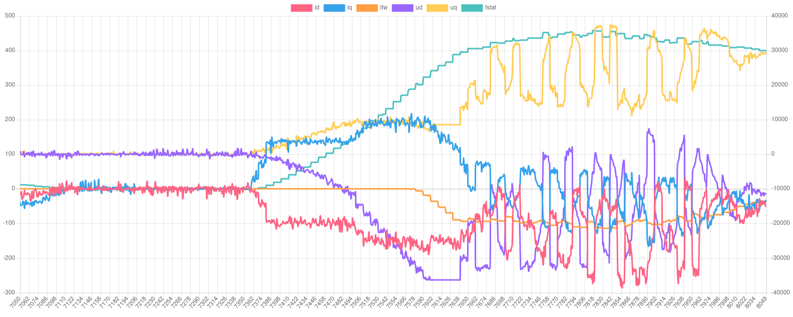

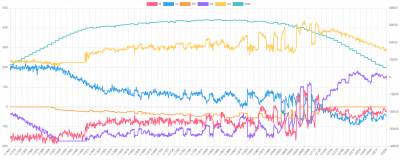

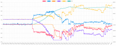

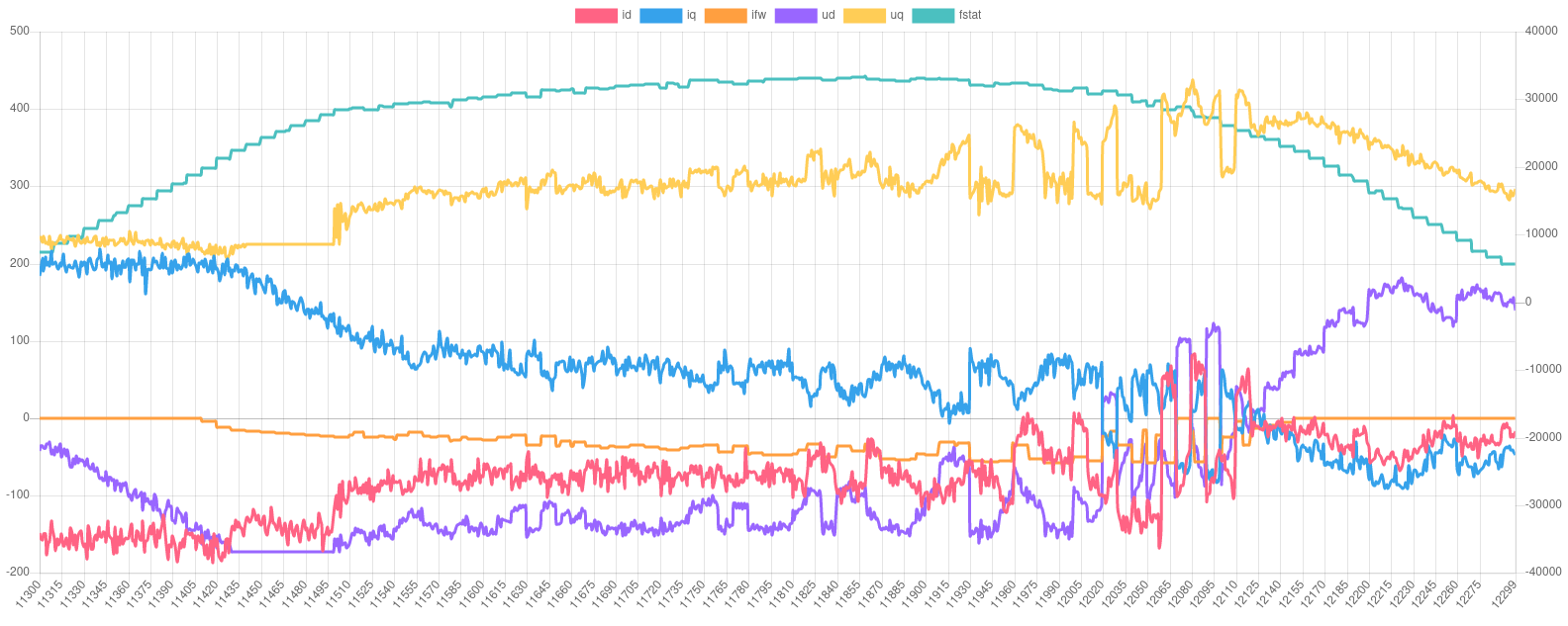

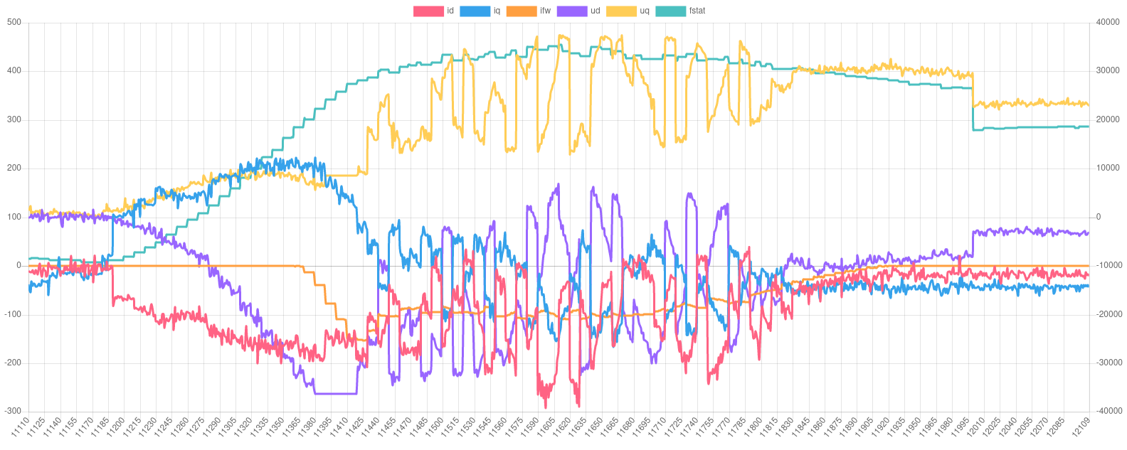

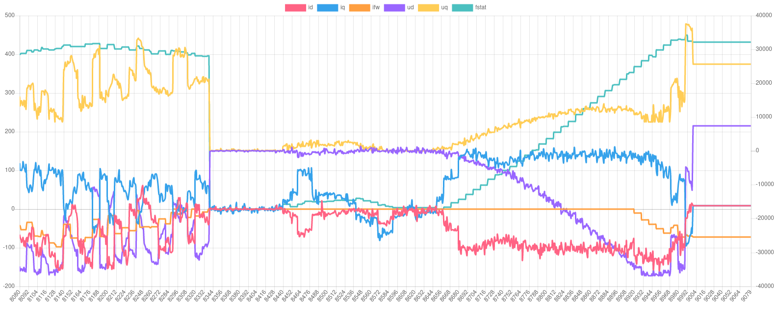

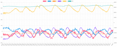

Now, more input from my side. I put the FW controller back into the PWM loop with kp and ki settable. Removed the filter.
First run with fwmargin=4000, fwkp=1, fwki=10. Seems FW controller actually works very well but comes in too late and its command isn't implemented by the d-controller fwmargin=6000, fwkp=1, fwki=40. Super high FW command, still seems too late, still isn't really implemented as FW is entered, but later on it is followed And finally fwmargin=5000, fwkp=1, fwki=20. Still saturated outputs, still oscillation. So next up reduce throttle input with another controller I guess...
EDIT: that said, I almost came completely off the throttle but that doesn't stop the oscillation. So not too optimistic on that.
EDIT2: I also thought about that anti-windup code in case of the q-controller. The limits are dynamic here. The integrator is frozen at a potentially high value when the output saturates. That could lead to instability as well. Now I think about calculating an integrator limit whenever updating ki or the saturation points and straight limiting the integrator to those limits.
EDIT3: looking at the second plot there is a point when the FW command is being followed nicely. So it's only the instance it comes in that is too late. Maybe some more kp and ki and less fwmargin?

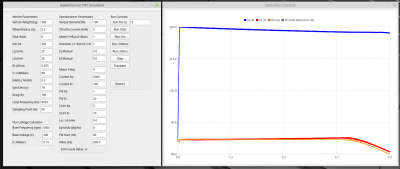

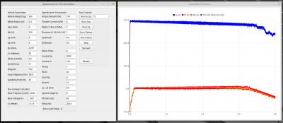

Found the problem with simulation. When I restart a simulation I clear out everything in the model but can't zero everything in stm32-sine so it sees a sudden jump in values when it's rerun. I must have been tuning my values to cope with this as they always seem OK. Bigpie's and Ev8's ki and kp values don't like this and the loops start oscillating and never settle back down. If I run the model with zero throttle for a few seconds between each real run I get this with Ev8's settings:
Much closer to results I get with my settings so that's good.
What's not so good is that the Uq and Ud between the model and the logs are very different. I'd believed that the back emf showed as a voltage in phase with and opposing Uq (so reducing the ability to generate Iq and so torque). This doesn't appear to be what's happening in the logs, in those Ud seems to be proportional to speed suggesting the back emf is in phase with Ud. Need to do a review of the model and the equations to see what's going on here.
EDIT - I must be missing something obvious here, I can't understand how the back emf can be in phase with Ud. Every way I think about it says it should be in phase with Uq. Can anyone explain?

Logic would say that the back emf should peak at the maximum rate of change of flux which is the quadrature component so again Uq?
Yet in the logged plots there is a clear speed dependant component in Ud and not in Uq - or am I misreading the logged plots somehow?
