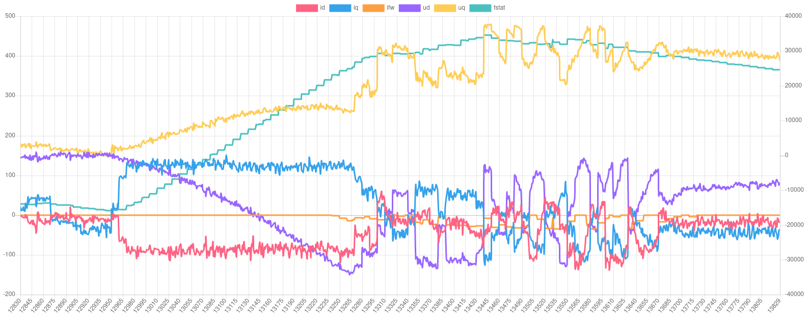

More test driving, 9 and B uphill, A and C downhill
First uphill, fwkp=5, fwki=40, fwmargin=3000. Field weakening kicks in early enough but causes oscillation in both id and iq
Now downhill, fwkp=5, fwki=10, fwmargin=3000. Field weakening kicks in but as soon as I enter regen the inverter faults out with DESAT! I haven't seen that for ages. Maybe the overflow in the inverse transform?
And uphill again, fwkp=5, fwki=1, fwmargin=3000. Pretty good, feels stable while on throttle but when getting near the coasting point oscillation comes back in. We still see some voltage saturation but it is resolved.
And the last run, downhill, fwkp=5, fwki=1, fwmargin=4000. Regen comes in even at regen but the whole thing still looks far from stable.
Another method could be removing fwki and instead filter the amplitude. Of course it slows down response but it seems like the FW controller doesn't have to be very fast. With the filter fwkp could be raised again.
EDIT: might also be worthwhile to run the torque throttling in a separate controller as you did.

I did a build of latest code and give it a little test. Feels perkier. 0.6 ldminuslq, 90 fluxlinkage, 0 syncadv
Will have more time to mess with params at the weekend.
The more interesting bit of the graph had gone off screen by the time I'd stopped :D

Bigpie wrote: Thu Sep 08, 2022 4:28 pm The more interesting bit of the graph had gone off screen by the time I'd stopped :D
Sounds familiar. I now put the focus on the pause button so I just need to hit space when something interesting happens
Speaking of which... The FW-controller seems to output something meaningful but then the d-controller has trouble implementing it at higher speeds. To I took a closeup and we see the two controllers awfully oscillate. I'm thinking the PI gains aren't right yet.
So starting to think this through. In the pesky "new tricks" video ki=R/L. So bexander measured 75mOhm and Ld=2.15 mH, Lq=6.33 mH. So then ki_d=75/2.15=35 and ki_q=75/6.33=12. But I have set it to 20000. Or have I?
Above factor expects SI units, not weird digits. So lets say full amplitude 37500 yields 255V AC (360V DC input). A factor of 148. That leaves us with 20000/148=135. So from the supposed 20000 loop gain we are left with 135. Going back from that we'd end up with curki=35*148=5180 and 12*148=1776.
kp should be L*bandwidth in rad/s. Does that mean maximum desired electrical frequency? So curkp=2.18*600Hz*2*3.1415=8 and 24 for q-controller.
So that would be MGR parameters. Do we need to introduce a second set of curkp/ki parameters?
EDIT: above plots were done without MTPA and with filtered amplitude. Filtered in PWM ISR with filter constant of 8.
EDIT2: I've never seen felt or seen these oscillations with the d-current commanded by MTPA. So it's probably the quick variation in d-current that throws the controller off...

When I simulate different FW controller gains this is what I get with very low fkkp:
As soon as the fwkp is increased it turns to this:
The second looks much closer to the results you are getting which makes me wonder whether this is the issue? Of course it could be the lack of noise in the simulation that allows low kp to work so well. I'll add a bit of noise and try it again.
The other issue I had with the fw controller was that the input range to the control meant that it was very one sided. To increase FW current the max error term could only be a few thousand (fwmargin), for decreasing it could be much bigger (GetMaximumModulationIndex() - fwmargin). This means that the controller output can move in one direction much faster than the other leading to an imbalance in the response. I found limiting the error term to prevent this helped with stability.

Now, more input from my side. I put the FW controller back into the PWM loop with kp and ki settable. Removed the filter.
First run with fwmargin=4000, fwkp=1, fwki=10. Seems FW controller actually works very well but comes in too late and its command isn't implemented by the d-controller
fwmargin=6000, fwkp=1, fwki=40. Super high FW command, still seems too late, still isn't really implemented as FW is entered, but later on it is followed
And finally fwmargin=5000, fwkp=1, fwki=20. Still saturated outputs, still oscillation.
So next up reduce throttle input with another controller I guess...
EDIT: that said, I almost came completely off the throttle but that doesn't stop the oscillation. So not too optimistic on that.
EDIT2: I also thought about that anti-windup code in case of the q-controller. The limits are dynamic here. The integrator is frozen at a potentially high value when the output saturates. That could lead to instability as well. Now I think about calculating an integrator limit whenever updating ki or the saturation points and straight limiting the integrator to those limits.
EDIT3: looking at the second plot there is a point when the FW command is being followed nicely. So it's only the instance it comes in that is too late. Maybe some more kp and ki and less fwmargin?
