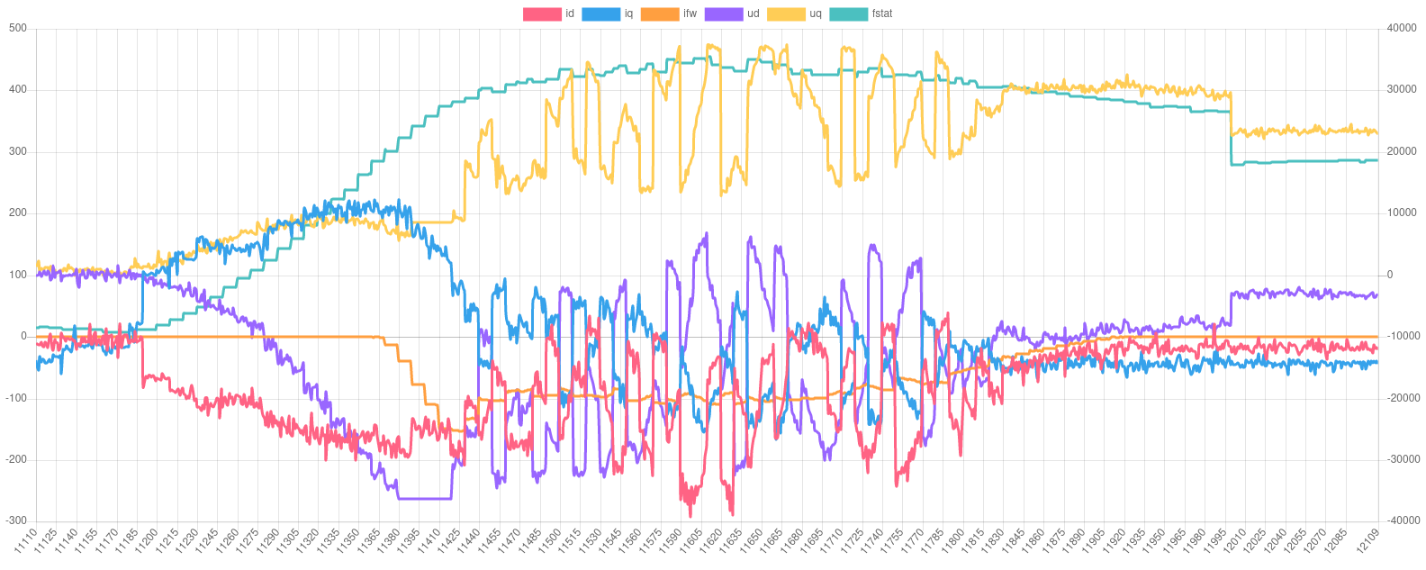

More test driving, 9 and B uphill, A and C downhill
First uphill, fwkp=5, fwki=40, fwmargin=3000. Field weakening kicks in early enough but causes oscillation in both id and iq Now downhill, fwkp=5, fwki=10, fwmargin=3000. Field weakening kicks in but as soon as I enter regen the inverter faults out with DESAT! I haven't seen that for ages. Maybe the overflow in the inverse transform? And uphill again, fwkp=5, fwki=1, fwmargin=3000. Pretty good, feels stable while on throttle but when getting near the coasting point oscillation comes back in. We still see some voltage saturation but it is resolved. And the last run, downhill, fwkp=5, fwki=1, fwmargin=4000. Regen comes in even at regen but the whole thing still looks far from stable. Another method could be removing fwki and instead filter the amplitude. Of course it slows down response but it seems like the FW controller doesn't have to be very fast. With the filter fwkp could be raised again.
EDIT: might also be worthwhile to run the torque throttling in a separate controller as you did.

Did you try winding fwkp right down? I found anything above 1 started to cause oscillation. I think it is because the controller is run much less often now it needs to rely a lot more on the i than the p.

Good to see, that was Outlander+Prius, right?
Speaking of which... The FW-controller seems to output something meaningful but then the d-controller has trouble implementing it at higher speeds. To I took a closeup and we see the two controllers awfully oscillate. I'm thinking the PI gains aren't right yet. So starting to think this through. In the pesky "new tricks" video ki=R/L. So bexander measured 75mOhm and Ld=2.15 mH, Lq=6.33 mH. So then ki_d=75/2.15=35 and ki_q=75/6.33=12. But I have set it to 20000. Or have I?
Above factor expects SI units, not weird digits. So lets say full amplitude 37500 yields 255V AC (360V DC input). A factor of 148. That leaves us with 20000/148=135. So from the supposed 20000 loop gain we are left with 135. Going back from that we'd end up with curki=35*148=5180 and 12*148=1776.
kp should be L*bandwidth in rad/s. Does that mean maximum desired electrical frequency? So curkp=2.18*600Hz*2*3.1415=8 and 24 for q-controller.
So that would be MGR parameters. Do we need to introduce a second set of curkp/ki parameters?
EDIT: above plots were done without MTPA and with filtered amplitude. Filtered in PWM ISR with filter constant of 8.
EDIT2: I've never seen felt or seen these oscillations with the d-current commanded by MTPA. So it's probably the quick variation in d-current that throws the controller off...

I think the equation for kp here is just taken from Xl=2πfL. Reactance is sort of V/I, if you ignore the phase shift, which is sort of the loop gain required to give the voltage needed to produce a given change in current. I'm not too keen on this and prefer to use the V = L di/dt version of the equation. For small t (such as the control loop period) this simplifies to V = L x I/t or V/I = L/t. If t is the loop period it becomes V/I = L x f (f in Hz). Think about it this way, if we have a 1A error at the start of the loop and we want to reduce this error to zero by the end of the loop how many volts do we need, V = L x f or 6.33mH x 8800 = 56V. Allowing for the voltage scaling would be 56 x 148 or 8288. This is a fairly simplistic approach but gives somewhere to start. Does the voltage compensation factor above include the effect of space vector modulation or should it be a little smaller?johu wrote: ↑Thu Sep 08, 2022 6:09 pm Speaking of which... The FW-controller seems to output something meaningful but then the d-controller has trouble implementing it at higher speeds. To I took a closeup and we see the two controllers awfully oscillate. I'm thinking the PI gains aren't right yet.
I'm not too sure of the derivation of the ki equation but it looks like it is aiming to compensate for resistive winding losses. I wonder whether a better approach would be to try to calculate what is needed to compensate for the back emf on the iq term instead. Either way I'd treat it as a starting point rather than an absolute.
The trouble with treating the two separately is that they aren't, having a bit of kp means that you can get away with a bit less ki and vice versa. They also have different effects on stability.
The trouble is neither of these are intended to address stability, just to make sure there is enough gain in the system to meet the setpoint. Stability analysis is more complicated but essentially you need either enough phase margin, enough gain margin and preferably both. To understand phase margin imagine a system where you have an input that controls an output. The output is also subject to another signal that is varying with a period t. Your job on the control input is to keep the output constant regardless of the varying signal. One other factor, there is a delay between the input signal and the output. Now on a slowly moving signal it easy, the output goes up, you reduce the control input and the output comes back down. The trouble is that as the varying signal frequency increases you get to a point where the delay between the input and output means that by the time you see the output go up the input is already dropping so when you reduce the control signal to get the output back to where it should be you are actually making the error on the input worse and so a time delay on the output later you have twice the error on the output but in the opposite direction. This cycle continues with the output error getting bigger on each pass. This is instability due to inadequate phase margin. Gain margin basically says that for the output to get bigger on each cycle the gain needs to be greater than unity at that frequency. So to stay stable you can either reduce the gain or increase the phase margin but note if you have inadequate phase margin the output will still be a mess it just won't be getting worse each pass round the loop.
So what does this mean in the real world? First only use as much gain as you need, it's tempting to wind things up to try and get zero error but it can cause more problems. Second make sure you have phase margin. Now this is difficult as it's all about delays. The best fix is to try and reduce the delay as much as possible. If you can't do that you need to add extra filtering to compensate, you will hear about adding poles and zeros on the phase diagram to do that. I must admit I don't have much time for that approach - if you have a full characterisation of the system and can represent it accurately algebraically then you have a chance - I've never managed it. I also don't like the idea of coping with one set of non-ideal behaviour by adding another one to compensate - I'm sure it can work wonders if done right, I'm also sure it can make things worse if done wrong. I always end up trying to reduce the delays, or phase shift, to improve the phase margin first (which is why I'm keen to reduce latencies as much as possible) and keep the other approaches as a backup.
Having said all that, and sorry about the long, waffly, and overly technical post, the iq and id stability in those plots doesn't look too bad at all. Pretty much all the problem looks to be coming from the FW controller. The test would be turn off the FW and see how they look, if they are OK then the leave them be and concentrate on the FW controller gains.
Edit - some of the above isn't quite complete. If you have a control loop that is unstable well outside the frequency range in which you need it to work then the first thing you do is add filtering to kill the gain at that frequency. Increasing phase margin in that case, especially if it's at high frequencies, isn't usually a realistic option to fix it.
Edit2 - filtering also needs to be done carefully as if done wrong it can reduce the phase margin considerably and make stability worse

When I simulate different FW controller gains this is what I get with very low fkkp:
The other issue I had with the fw controller was that the input range to the control meant that it was very one sided. To increase FW current the max error term could only be a few thousand (fwmargin), for decreasing it could be much bigger (GetMaximumModulationIndex() - fwmargin). This means that the controller output can move in one direction much faster than the other leading to an imbalance in the response. I found limiting the error term to prevent this helped with stability.
As soon as the fwkp is increased it turns to this:
The second looks much closer to the results you are getting which makes me wonder whether this is the issue? Of course it could be the lack of noise in the simulation that allows low kp to work so well. I'll add a bit of noise and try it again.The other issue I had with the fw controller was that the input range to the control meant that it was very one sided. To increase FW current the max error term could only be a few thousand (fwmargin), for decreasing it could be much bigger (GetMaximumModulationIndex() - fwmargin). This means that the controller output can move in one direction much faster than the other leading to an imbalance in the response. I found limiting the error term to prevent this helped with stability.

Now that's interesting, noise didn't make a difference but Lq and Ld do. First tried with a lower matched values of Lq and Ld:
Looks like your idea of different kp and ki for Iq and Id may be on the money
Edit - Not so sure now, it seems that it's the fwmargin value, increasing this to 8000 (I think that's the value you use) fixed it: Note : the loss of control at the right hand side (where it runs out of FW) is at around 1000rpm.
It could be that individual kp and ki could allow a reduced fwmargin though?
Rather than having separately tuned values could try scaling them according to the Lq/Ld ratio?
Edit - Just tried scaling ki and kp for d to be 2/3 the value for q - made no significant difference to the plot.
Bit worse but not too bad. Then with non matching Lq and Ld:
Not good! Finally went back to larger Lq and Ld but still non-matching:
Also not good.Looks like your idea of different kp and ki for Iq and Id may be on the money

Now, more input from my side. I put the FW controller back into the PWM loop with kp and ki settable. Removed the filter.
First run with fwmargin=4000, fwkp=1, fwki=10. Seems FW controller actually works very well but comes in too late and its command isn't implemented by the d-controller fwmargin=6000, fwkp=1, fwki=40. Super high FW command, still seems too late, still isn't really implemented as FW is entered, but later on it is followed And finally fwmargin=5000, fwkp=1, fwki=20. Still saturated outputs, still oscillation. So next up reduce throttle input with another controller I guess...
EDIT: that said, I almost came completely off the throttle but that doesn't stop the oscillation. So not too optimistic on that.
EDIT2: I also thought about that anti-windup code in case of the q-controller. The limits are dynamic here. The integrator is frozen at a potentially high value when the output saturates. That could lead to instability as well. Now I think about calculating an integrator limit whenever updating ki or the saturation points and straight limiting the integrator to those limits.
EDIT3: looking at the second plot there is a point when the FW command is being followed nicely. So it's only the instance it comes in that is too late. Maybe some more kp and ki and less fwmargin?
