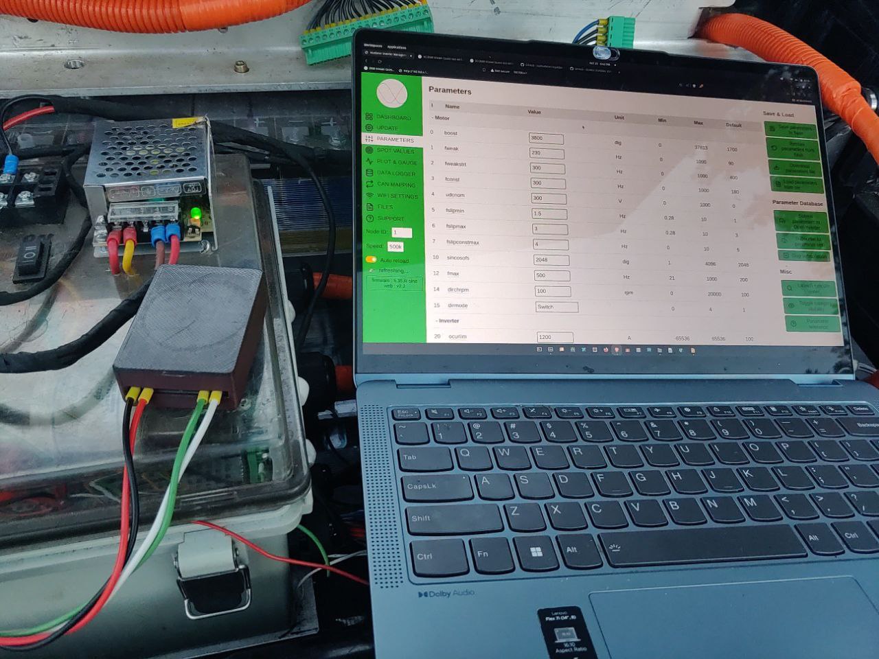

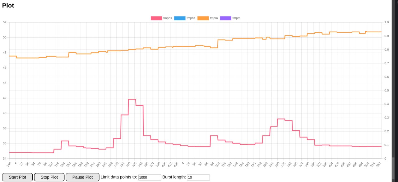

At this point I think I spent 1 year troubleshooting something that never worked?? I am on the latest code and same CURRENTLIMIT error. The inverter/motor temperature is good.
Accelerating backwards (originally motor forward) works, but going forward(original motor reverse) cuts out and is jerky if I keep pressing the acceleration after the initial power loss and is violent if I accelerate to much. Going in reverse(originally forward) sometimes cuts out but is not violent, and can also accelerate hard going backwards.
Not sure if when I tested the car initially with just a solar panel and super capacitors at 40v, and no water cooling the inverter, might have damaged the inverter.
Also I do not understand why the power loss is violent when I am going forward (originally reverse). same time other people are using the Tesla SDU in reverse with no issues.
I ordered a new motor that should be on the way. Not sure if I should move the existing Open Inverter board in the new Inverter or just ordering a new one.
I played with a bunch of settings and I see the difference in acceleration but power still cuts out going Forward.
- Been thanked: 1918 times
Have you tried iacmax 0 and tmphsmax 120? This disables current and temperature limit. Might fry the inverter for good but you have a new one coming anyway

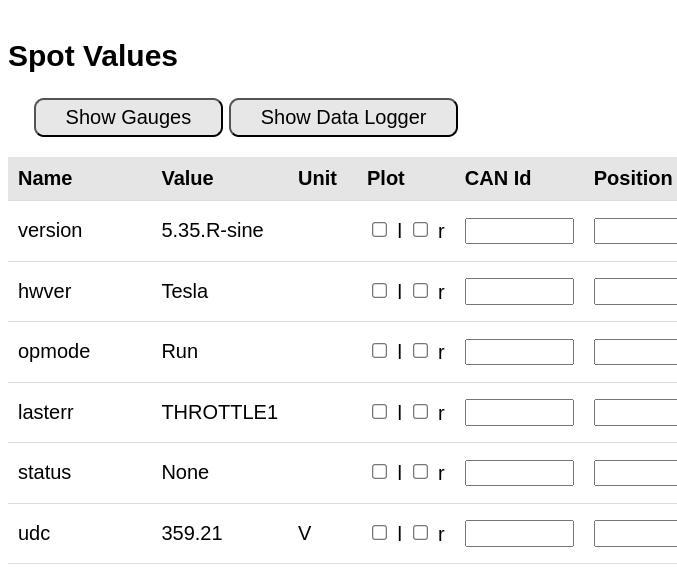

Now the last error is THROTTLE1

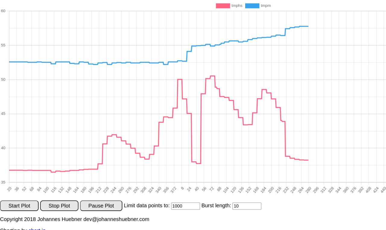

I'm fighting high inverter temps myself right now. Looking at your graph perhaps tmpm is on the high side? Try plotting tmpm vs. speed, idc vs. speed and udc vs. speed (one value on the left, another - on the right, since these have different units)

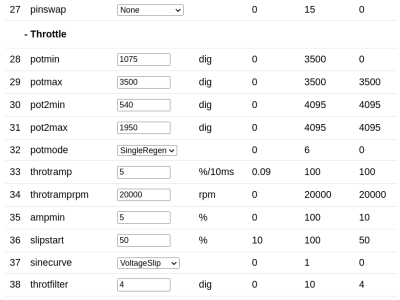

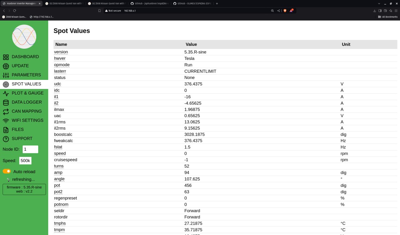

So I corrected the screenshot above with the throttle pedal sensor 1 and 2.
Sensor 1 has higher voltage and was the one I was using. I tried today the Sensor 2 but the car was moving only after the pedal was already half pushed so I reversed to sensor 1.

That makes sense if you didn't adapt the potmin and potmax after changing the pedal output.

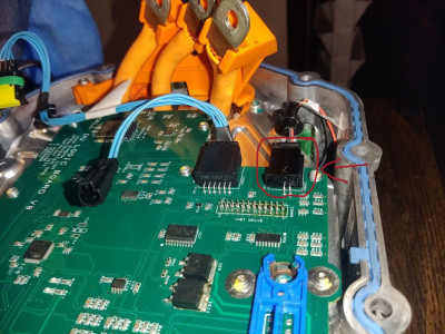

I just got the 2nd inverter and I observed that the HVIL connector was only half way pushed in. Can that give the symptoms I observed so far.
HVIL faults show as "OVERCURRENT". You can override HVIL by shorting the pins
- Proton
- Posts: 366
- Location: Georgia/US
- Has thanked: 227 times
- Been thanked: 57 times

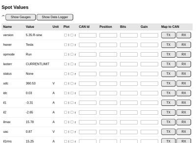

I pushed in the connector and tried again. No luck - CURRENTLIMIT. I will have to swap the open inverter board on the new Inverter.
It still bothers me why only affects Forward and not Reverse.
I don't understand how you can still get the CURRENTLIMIT message with iacmax=0. Here's the code
s32fp imax = Param::Get(Param::iacmax);
s32fp ilMax = ProcessCurrents();
//setting of 0 disables current limiting
if (imax == 0) return ampnom;
... Here comes the current limit code that should no longer be executed ...

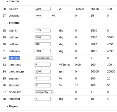

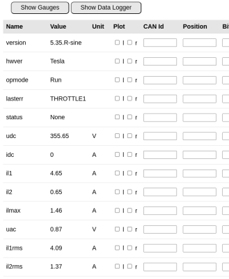

with iacmax=0 now, as soon as I put the ignition on I get THROTTLE1 error.I do not even have to be in Forward or Reverse.
Car is still moving full speed in reverse(originally forward) and forward keeps doing the same thing; slowly moving and if I push little on the acceleration it cuts out.and keep cutting out and vibrating if I keep my foot on the acceleration even a little.
The error never changes from THROTTLE1 I also attached the throttle settings.
THROTTLE1 means the throttle calibration is off. Have you read and done this? viewtopic.php?t=5075
The 5.35.R firmware requires it. You can also revert to 5.32 to skip this for now
EDIT: it's also helpful if you try to pull a json dump in the respective situation. Like calling http://192.168.4.1/cmd?cmd=json at the very instant where the problem occurs. Then attach the result as a text file.

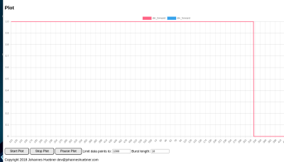

So to my dismay tmphsmax is still at 85°C. I told you to set it to 110 to disable the derating.
But maybe that isn't the problem. In cmd-T.txt din_forward=0 so no direction selected. In cmd-T2.txt it is 1, so forward selected. Could it be that your forward signal is unstable? This would explain why it works in reverse but not in forward. You can plot din_forward during standstill and see if it is stable. Also wiggle your cables a bit to provoke an intermittent connection

- Proton
- Posts: 366
- FWD and RWD wires reversed
- iacmax 0 and tmphsmax 110
- tried dirmode=DefaultForward
- din_forward shows 1 until I lift my foot of the acceleration.
-still no error and same results.

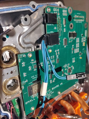

I did not try yet the new inverter. I ordered another board from Johu, and also the current sensors. I want to replace as many parts as possible. Once I receive the board I will test the new inverter.
Did not want to use the same board either; just in case, but I think the board is good after repair.

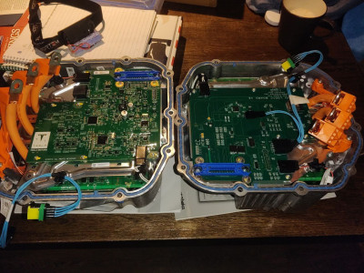

Painful updates.
New board, new sensors, new inverter but the same motor = same behavior stopping and stuttering going forward.
The external esp 32 board works perfect. and it is fast.
Next step is to replace the original motor with the one that I just bought. this is very complicated since I already have the batteries on top.
I will have to uninstall the old motor and install the new one without the oil pump modification just to test.
if that works I have to take it down again and do the oil pump modification.
Draining the oil etc.
Not sure if it is possible to mess up something with the oil pump modification. the parts go back in only one way.
I remember there were 2 white wires that come from the motor all the way up to the inverter board. I am guessing these must be the temperature sensor wires? i think I stretched them a little bit when I opened first the motor.
