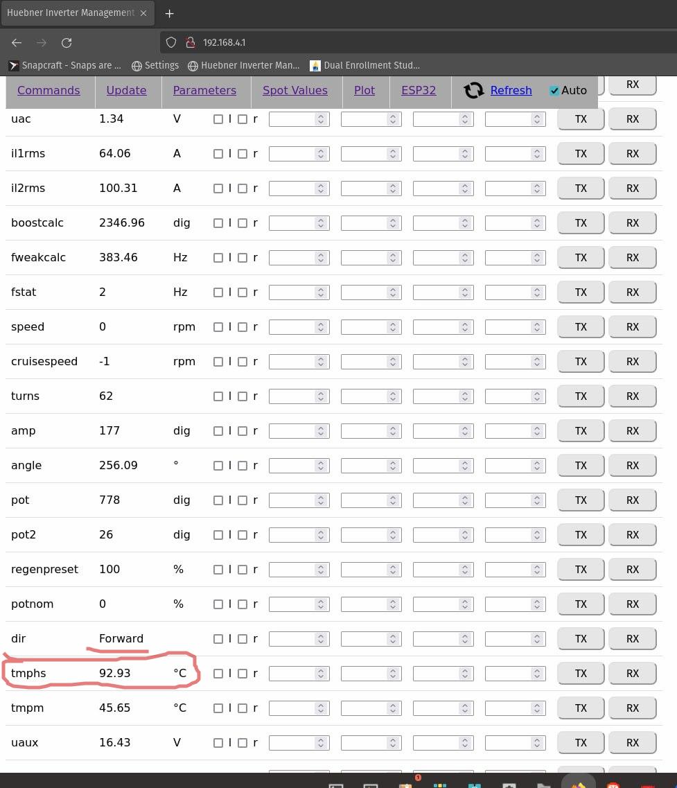

I think I successfully replaced the mosfets and the motor is spinning. Issue is that I can only drive for about a second and tmphs temp goes to 100C and motor stops.
Water pump works and stops too. I checked the voltage and it always has 12v.
Even when the water pump works the inverter gives the over-temperature error TMPHMAX

In the best case it's just an air pocket. In the worst case some inverter damage. Have you made sure coolant circulates bubble free?

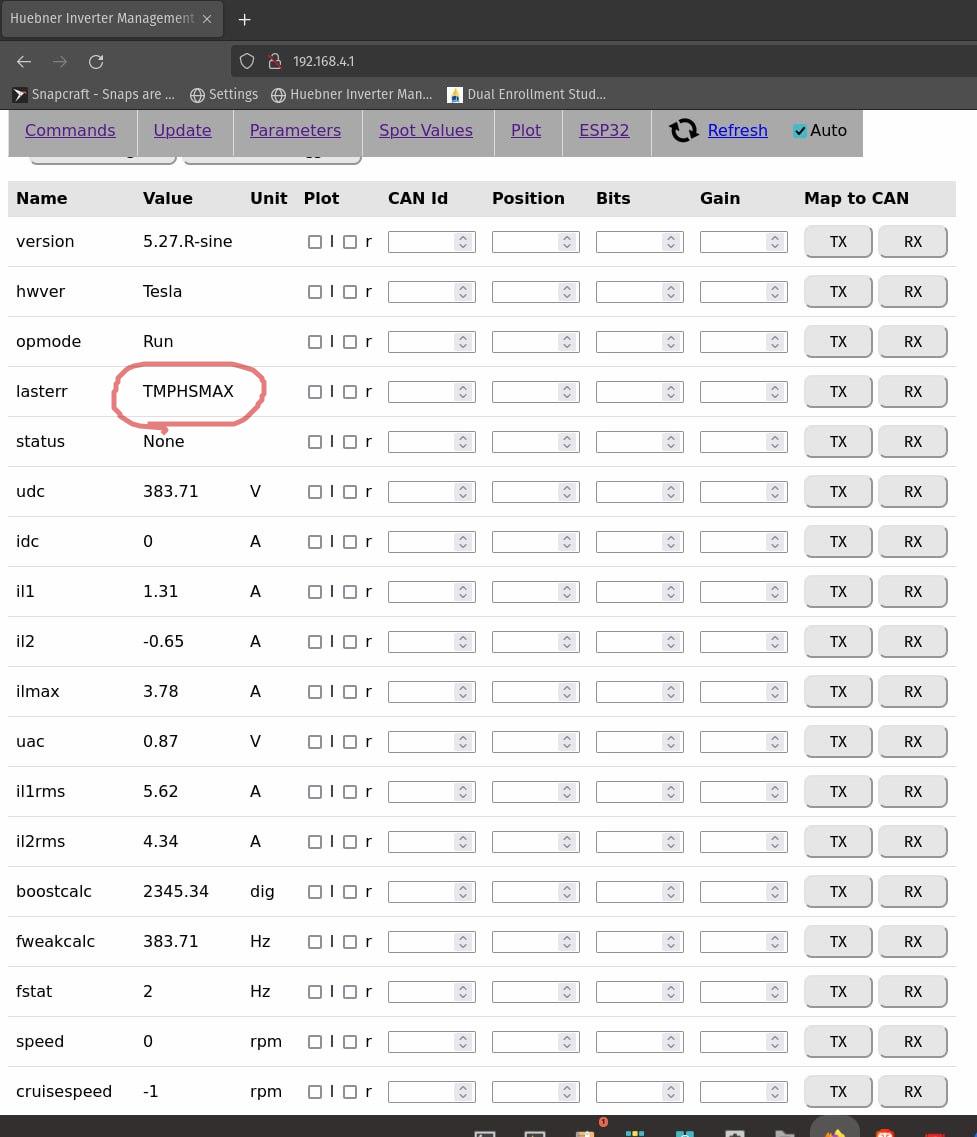

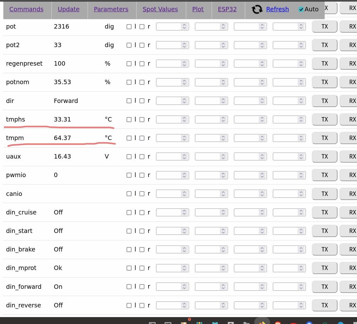

I was able to connect the laptop and get some screenshots while driving. Temperature is under control but the behavior is the same. The error I am showing is: CURRENTLIMIT
- Been thanked: 1914 times

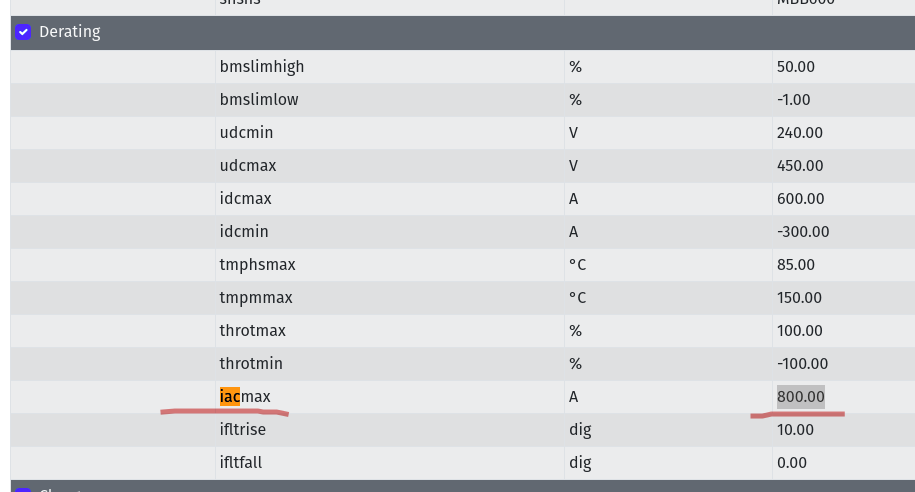

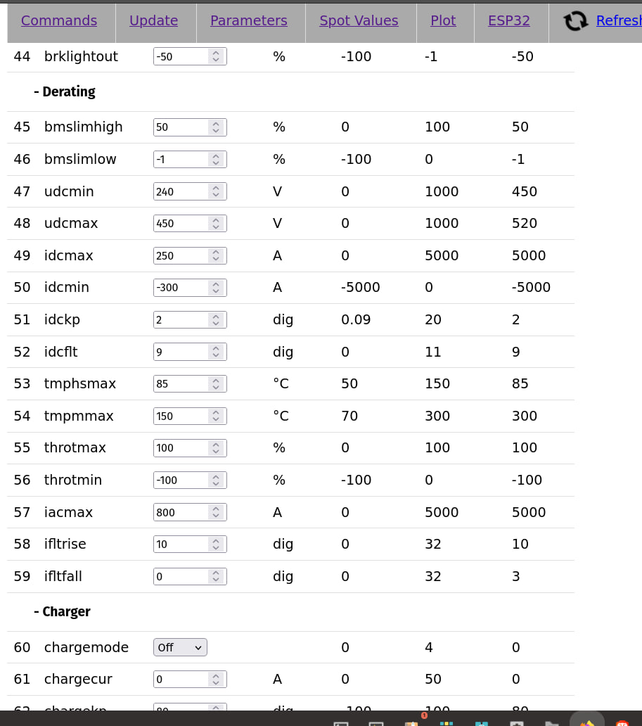

What is the value of iacmax?
Can the Tesla buddies chime in? What is a good value for iacmax?

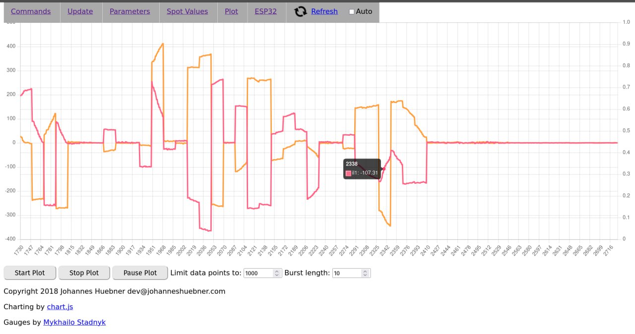

Were do driving hard or just slowly? 800A sounds like a lot to surpass if it's real. Can you plot il1/il2 with 1000/1000 plot configuration

Driving very slowly.
I tried to plot few times in the past but nothing shows up on the graph. Maybe I do not know how to use it.
I will try again afternoon.
Put a checkmark on il1 and il2 then press Start Plot below

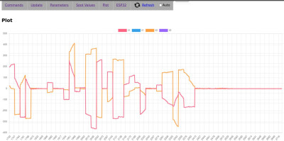

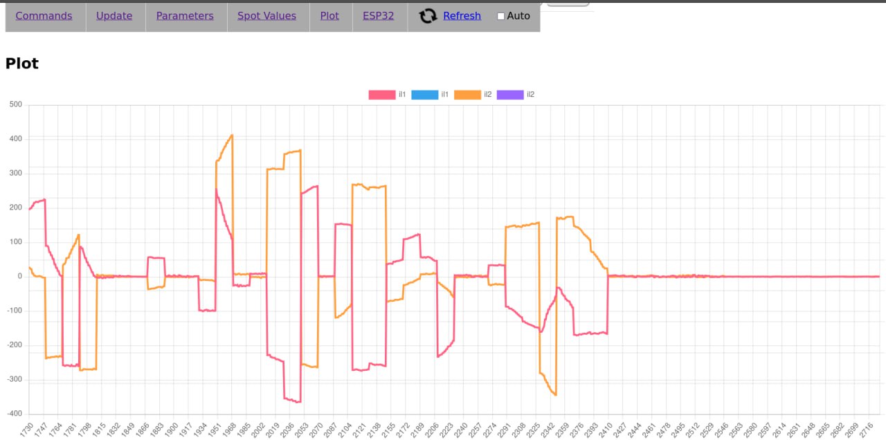

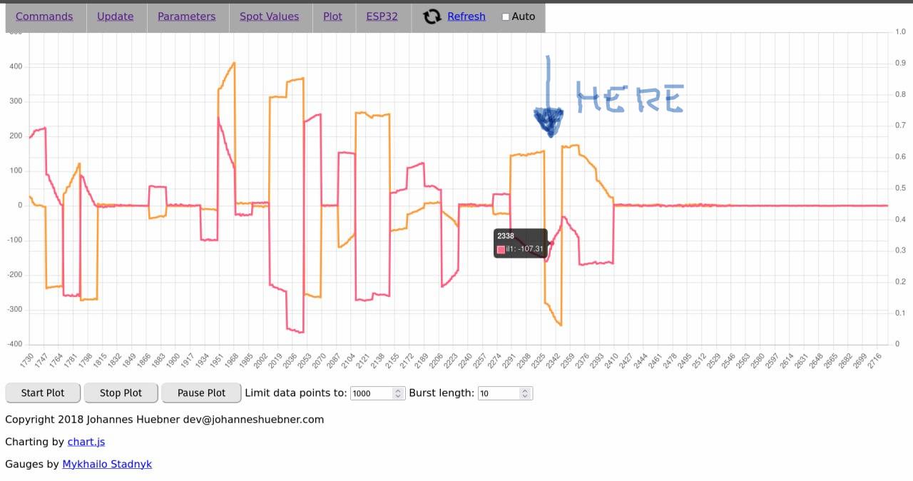

I got both, a screenshot and a log file. Not sure which one is better.
So while you recorded this plot you still got juddering?
You can try disabling the iaclim by setting it to 0 and don't punch too hard until someone confirmed it's wise to do so.

Yes, If I recall right I have placed an arrow in the screenshot for one of the stops.

I changed IACMAX to 0 and same thing happened. In the beginning I can go forward slowly for few seconds but after it stops I have to wait longer and longer time to move forward for few seconds. Then I realized that if I go backwards it is not happening and started to go only backwards and works with no interruptions. as soon as I change to forward and try to accelerate it stops. if it is flat or downhill I can go longer forward.

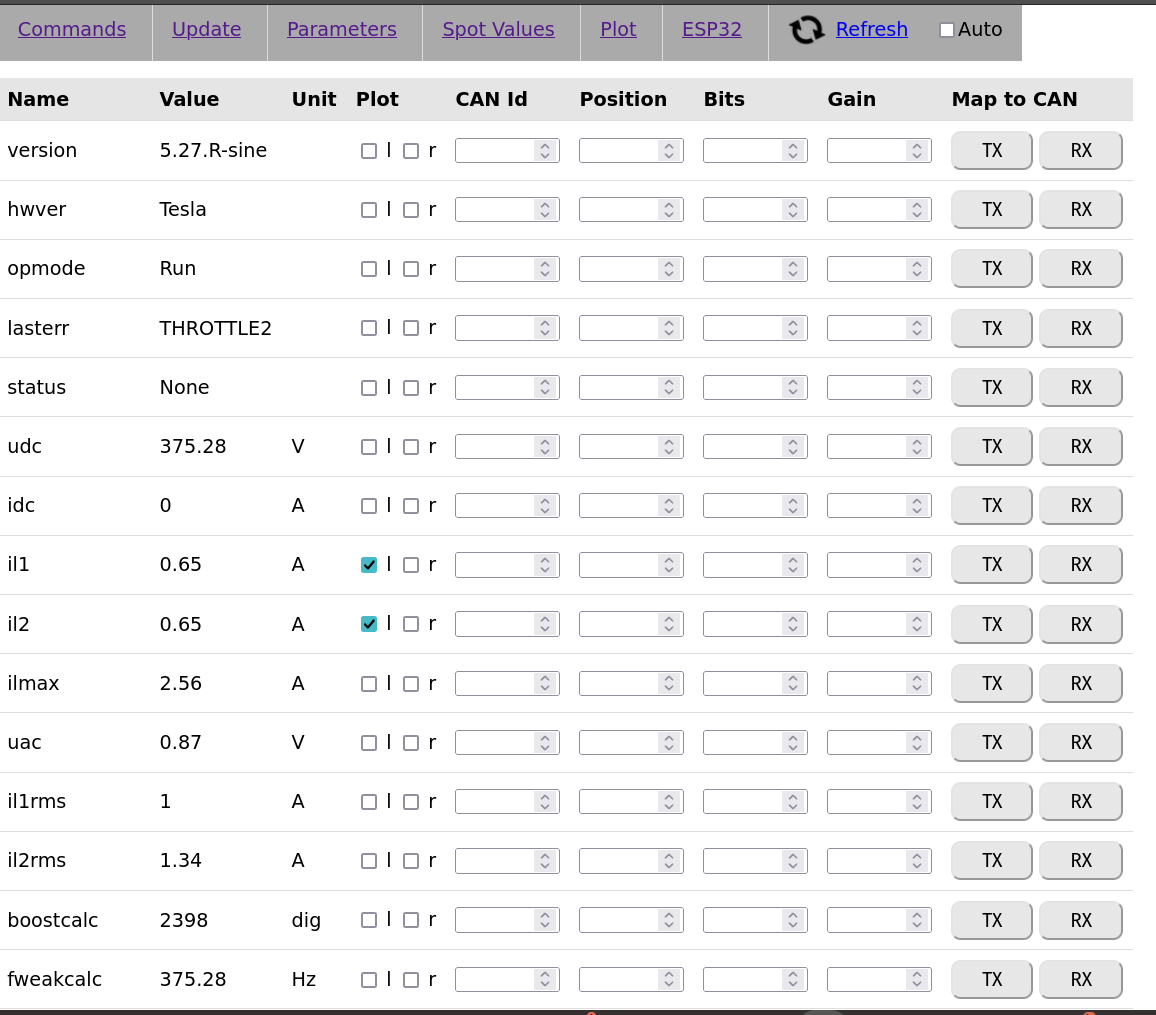

Also the error I got today was "THROTTLE2"
Could it be something mechanical?
You are using potmode=DualChannel and maybe the second channel is not connected?

For the throttle error, indeed I am not using 2nd channel.
Did not know there I a setting for that. I will correct that and see what error I get next. If therebins going to be an error.

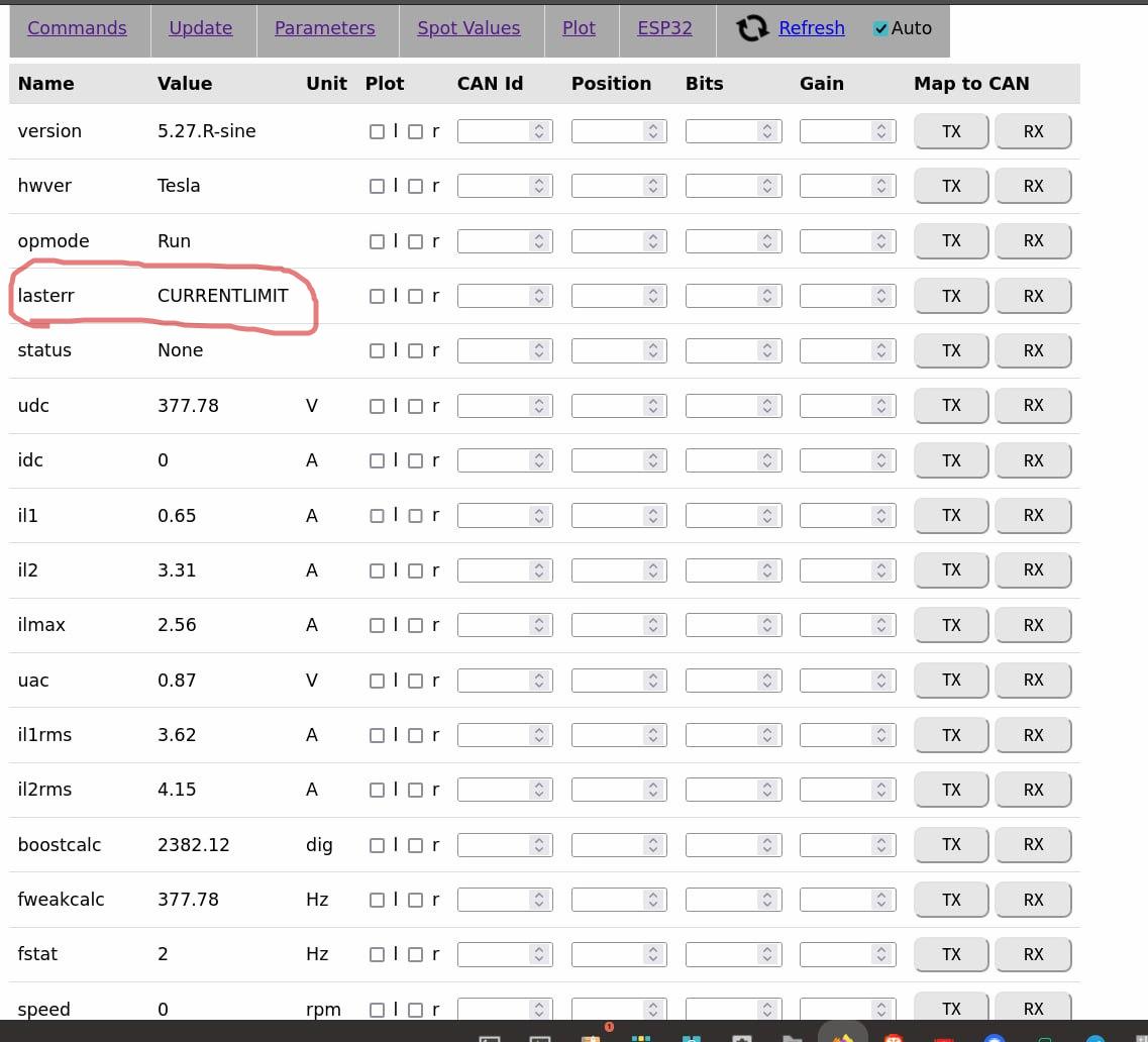

OK, another test-drive on the road and Video.
There is any setting that would limit the Motor spinning backwards?
I am still getting the CURRENTLIMIT error.
The settings I have I are from here:
https://openinverter.org/parameters/ It shows as experimental, but that is all I found there to start with.

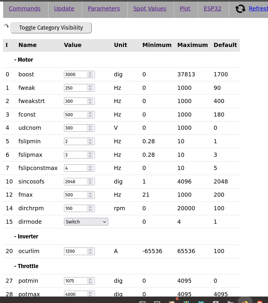

I tried to use this firmware before but the car does not start. I do not have a wire from the brakes. I installed it again today but I cannot figure out how to start. is there any setting I can change to run without pushing the brake pedal until I install that wire?
And there are any parameters you suggest that you know should work on SDU? I tried already few of them I found on this forum like
this one : https://openinverter.org/parameters/view.html?id=27
These are known good, yes.
