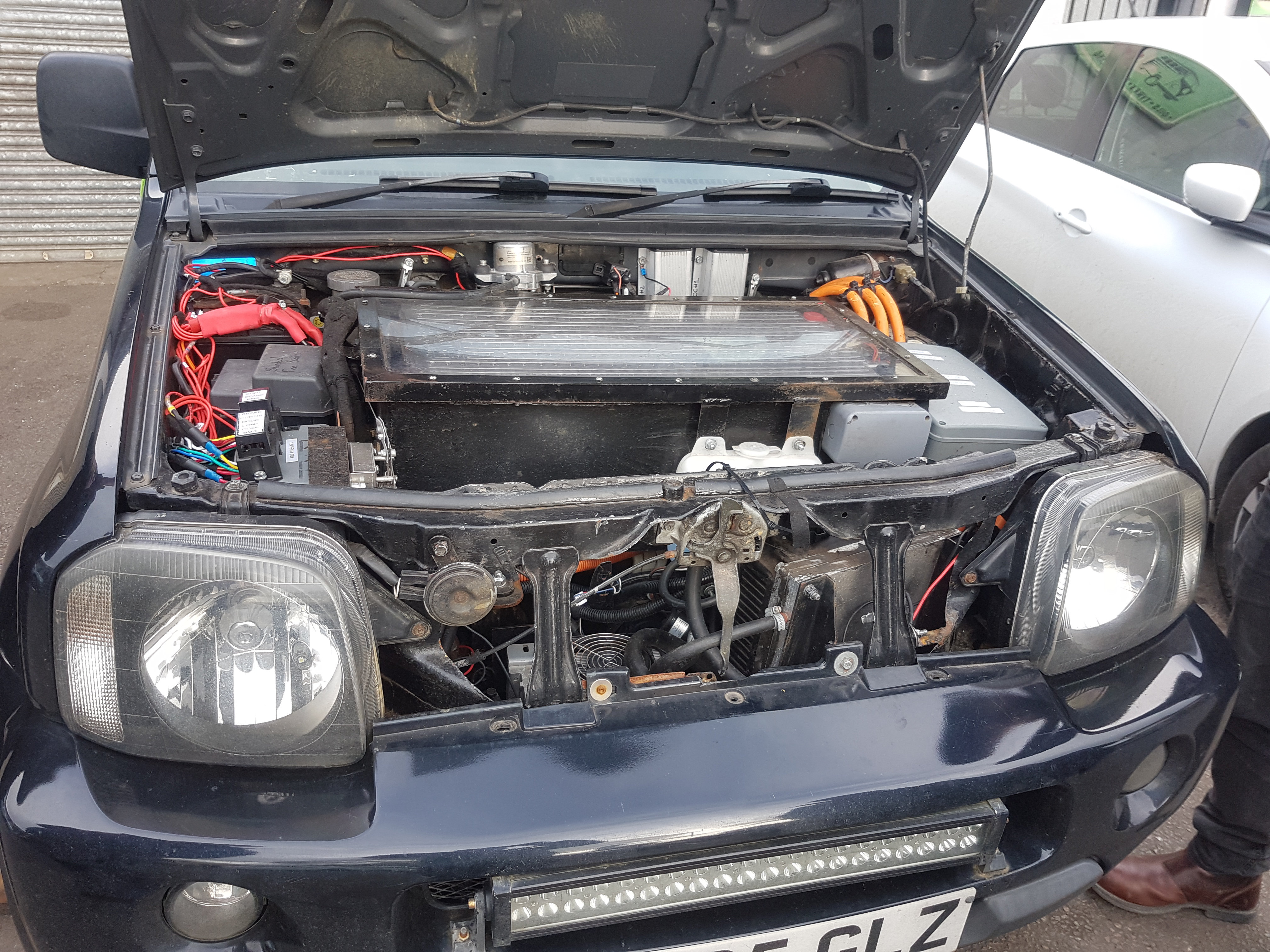

So I've welded closed a Panasonic AEV14012 that came with my battery pack. They are only rated at 140amp so probably a little too weak. Need to source replacement beefier contactors.

It's ok thanks. Got some gigavacs from Damien and back on the road.

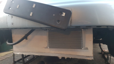

This weekend I've put a bigger radiator on and mounted the outlander water heater. Need to finish wiring it in then I can be warm

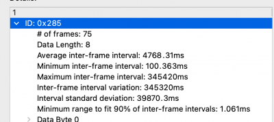

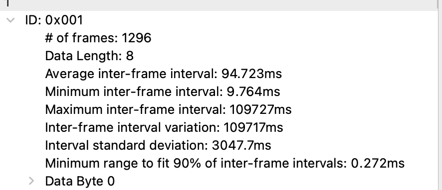

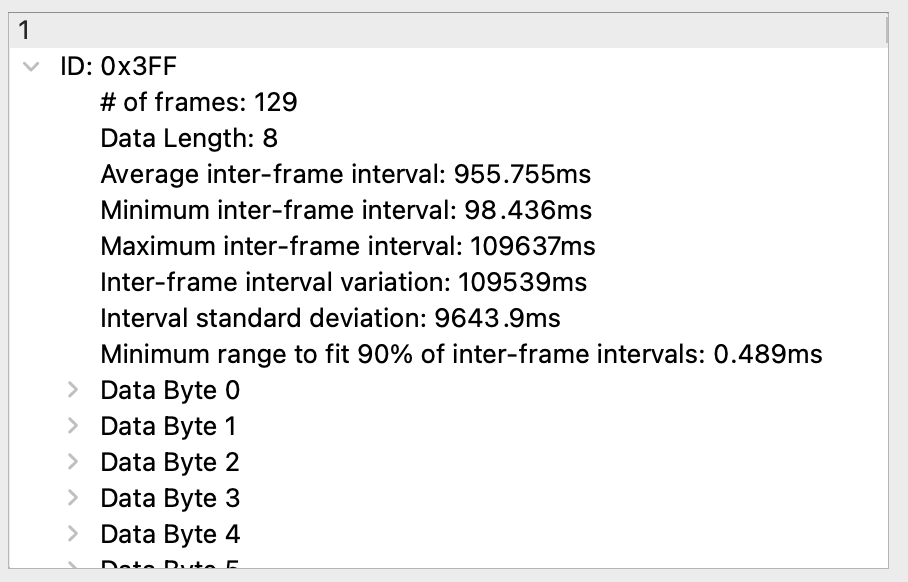

So I still seem to be blighted with the CAN BUS issues and not really sure what could be the cause or even if it's an issue.
Symptoms:
Charger isn't pulling down the CP reliably, it'll intermittently do so. for this 0x285 is required every 100ms. I have this broadcast from SimpBMS configured at 50ms
Other information:
I have the Prius OI board configured to transmit 0x3FF
I have a Rev 3 board for VCU running stm32-car transmitting 0x001 at 10ms intervals
The average inter-frame interval are quite a bit higher.
Symptoms:
Other information:

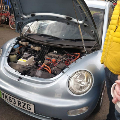

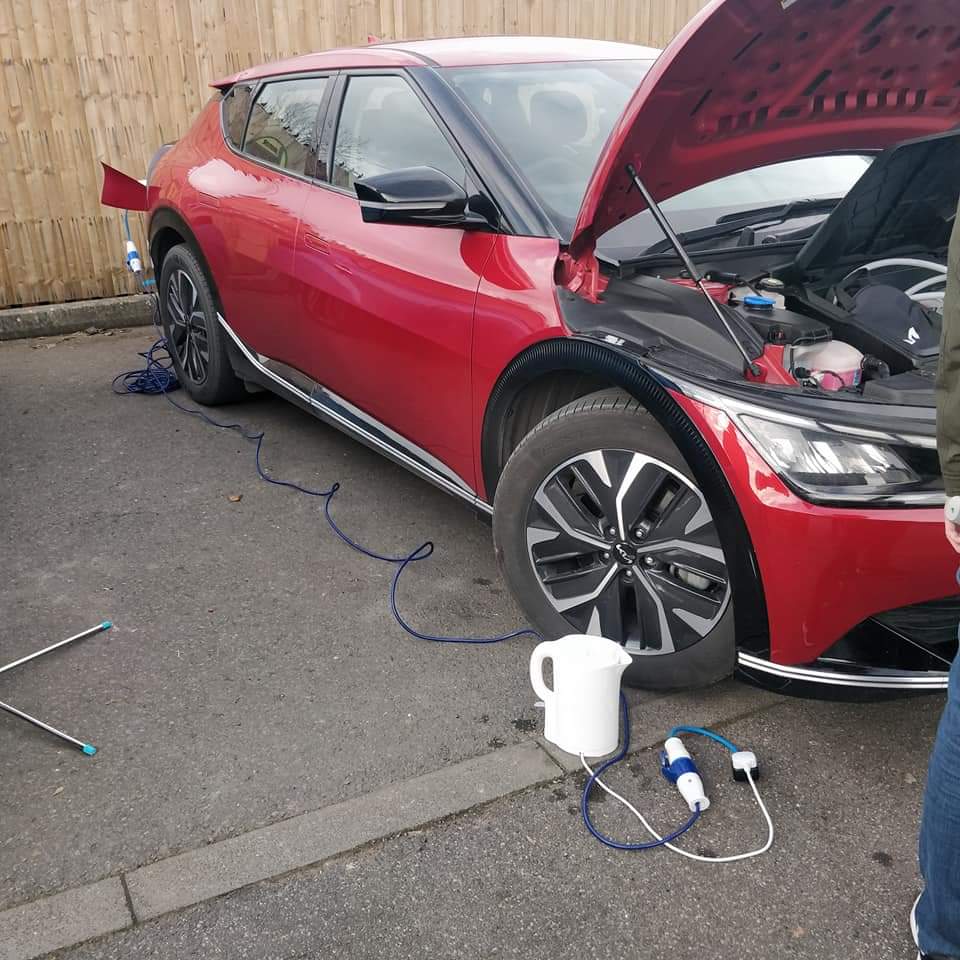

Took the car to an EV meet, with bobby_come_lately, we got a charge from an 800v EV6.
Fair to say the 2 conversions there got a fair bit of attention.

Managed to get a second pack, another 8.8kwh Golf GTE pack, £700 delivered.

Wasn't as cheap as the first pack (£500) but still, double the range when installed so can't grumble

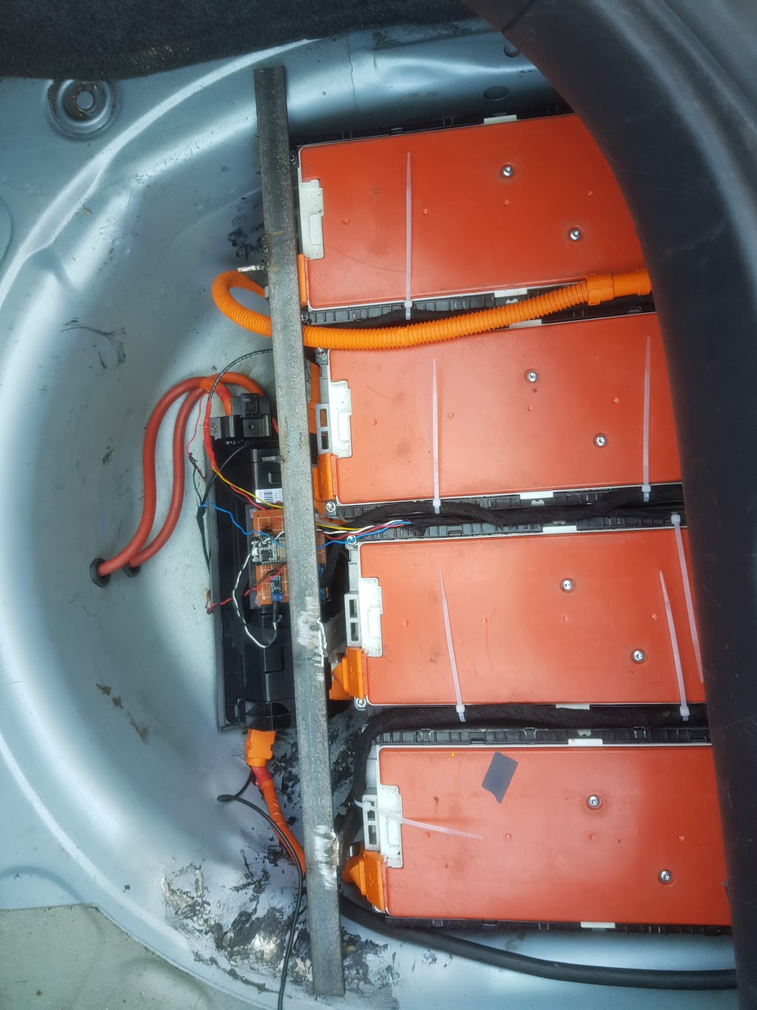

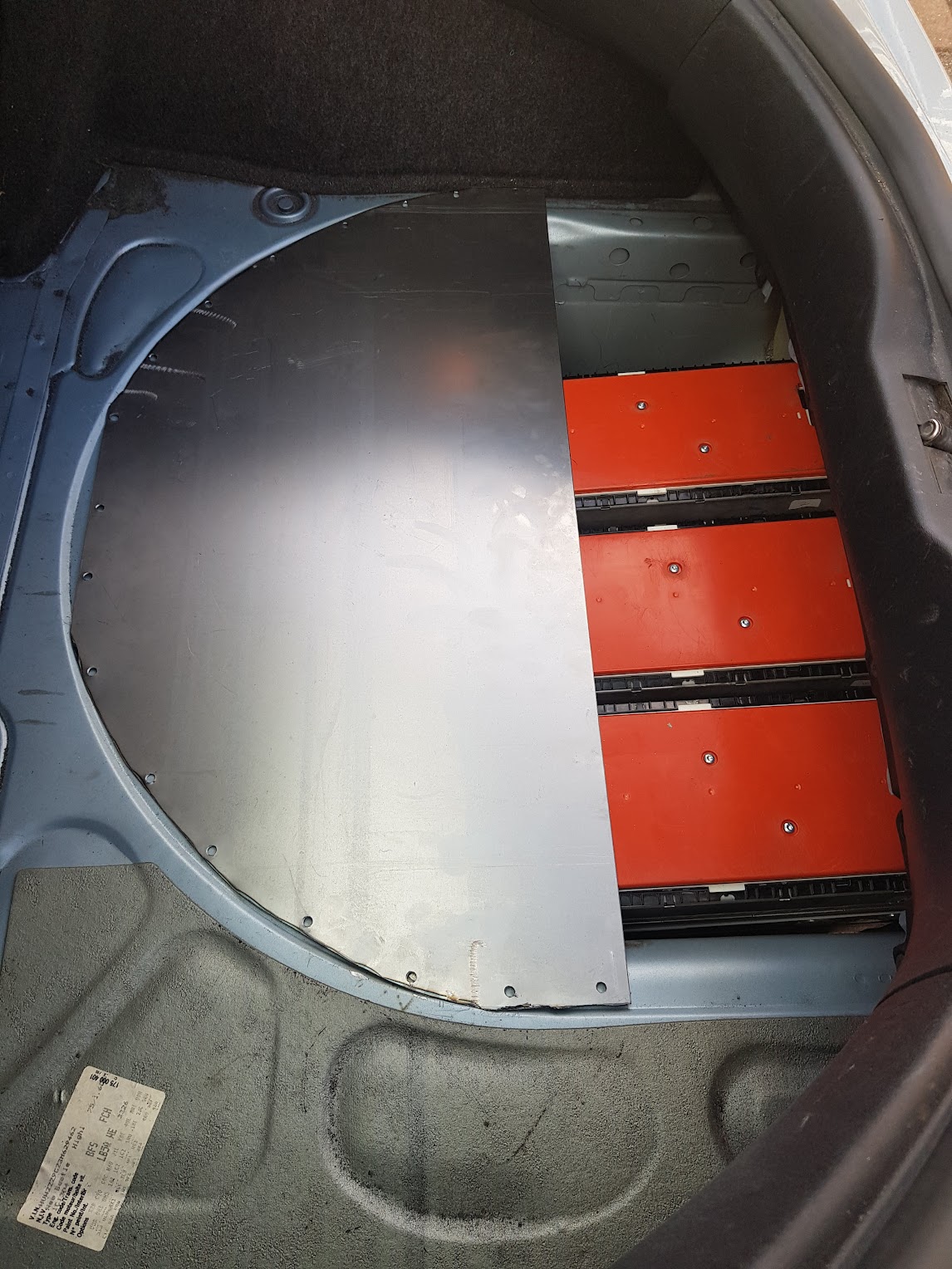

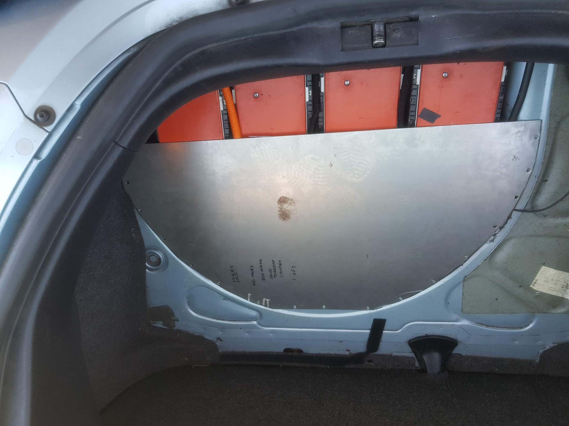

2nd Battery pack is in and running now, ish. It's connected, but not got the BMS readings from it yet, and I want to tweak the mounting a bit, but I now should have 50 to 60 miles range
Boot floor doesn't quite sit flat, so I'll need to tweak something, either try and get the modules a little lower in the spare wheel well or put some 5mm ply down, which I can then fasten the metal cover to, once painted.

Re: VW - Beetle 2003
Perhaps a little "gentle persuasion" on the wheel well floor?Bigpie wrote: ↑Mon Jun 13, 2022 12:16 pm 2nd Battery pack is in and running now, ish. It's connected, but not got the BMS readings from it yet, and I want to tweak the mounting a bit, but I now should have 50 to 60 miles range![]()
I'll need a bigger persuader, I only have a little claw hammer, a lump hammer may well do the trick.
Getting there now with the rear pack. Couldn't quite squeeze the modules inline and still got to finish bolting down the front mount and the top and a few other little jobs.
So what next?
No idea where I'll be able to fit this monster, it's fairly large, also workout how air conditioning works. It's been a little uncomfortable in this heat.

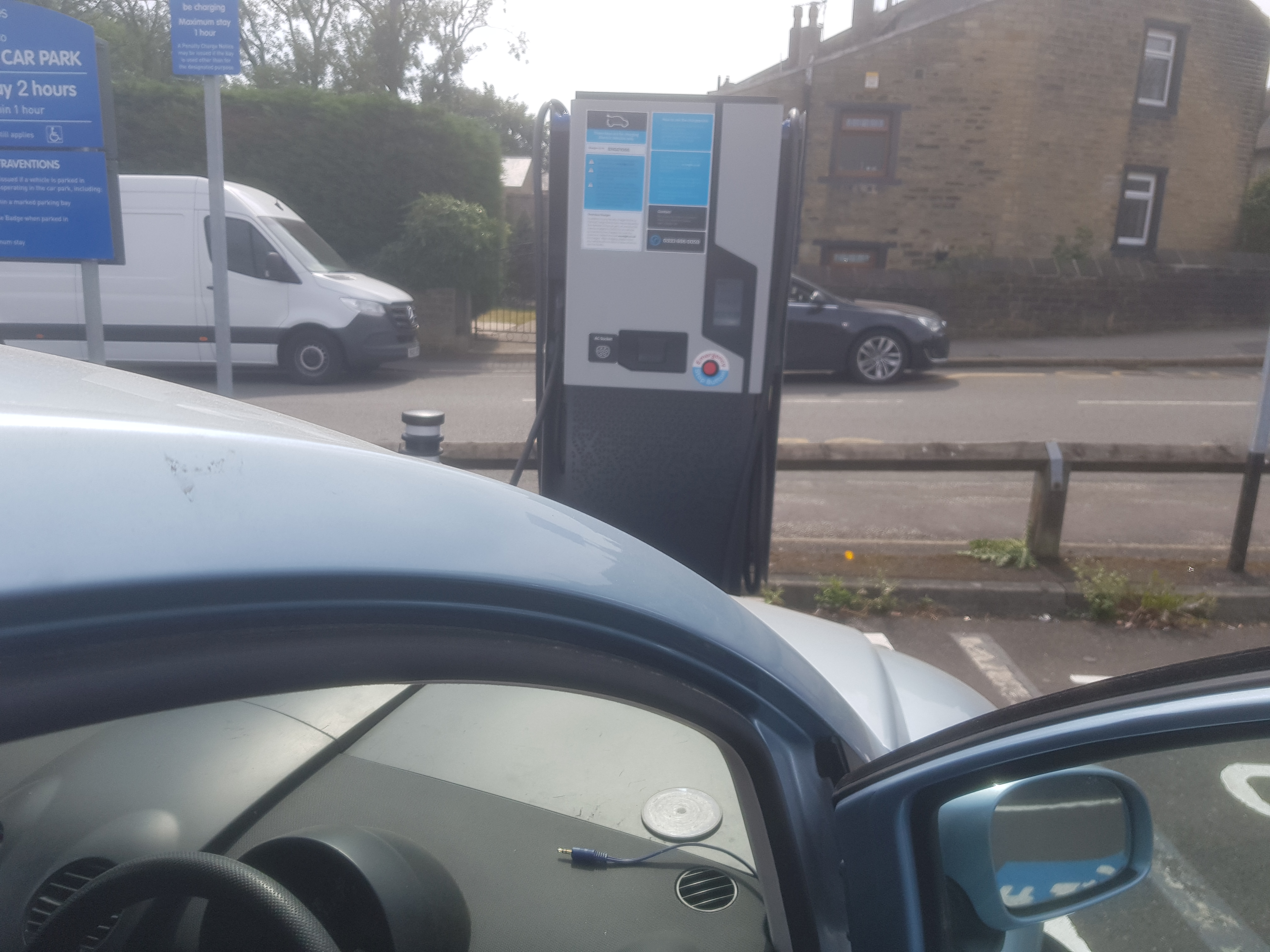

Did a longer trip today and got a charge on chademo
Did some motorway miles and while the car was mostly ok, it was obviously lacking in umph. Would cruise happily at 60 but maintaining 70 up hill wasn't so effortless.
Mart.y hit me with a well timed PM offering a leaf motor so an upgrade is in order. Going to be a tight squeeze.
