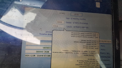

Thanks, managed to disable it, it was a little different to Johannes in that I had to change to softcode instead of adaptations.
Changing the second to last value to 3 did it. No Service intervals. Still got a few more issues to chase on the car errors front but that's one ticked off.

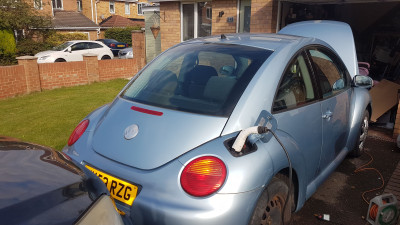

First time charging the car, only left it running 10-15 min for testing. Should be ready for MOT in next week or 2.

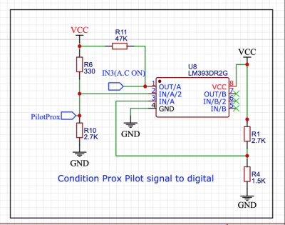

I'm going to use the CP signal with a diode and a IRF520 with a capacitor to switch on a relay to power up the VCU, Simpbms and inverter, with diodes to prevent powering up the rest of the ignition. A comparator for the PP pin for pulling AC present high in SimpBMS.
That's the plan at the minute anyway.

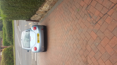

Well I got insurance with Keith Michaels and had a little test drive.

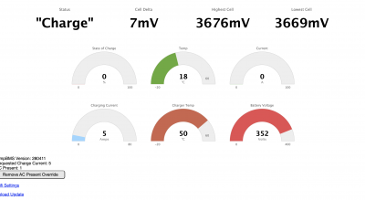

It's getting some Beetle Juice now, only at 5 amp for now. Still got a few bugs to squash in my SimpBMS Web interface but it's looking good.

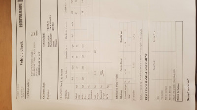

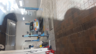

MoT test passed today
Got a nice print out of the axle weights too.

yes, need to get more 'beans' it needed a push off the rollers.

Longest trip to date, 16 miles round trip, with 56% battery remaining according to bms. Just over 4100mv to 3665mv. Didn't quite have the umph to reverse up my mum's steep driveway, I think I'll have to parallel MG1 and MG2 maybe.
Re: VW - Beetle 2003
What have you set your lower cell voltage limit to in simpbms? First time out I was showing 50% battery at 3.5v but the bmw modules seem to start falling of the cliff at 3.4v so be careful until you work out where your modules are actually happy being drawn down to!
- Posts: 1884
- Has thanked: 91 times
- Been thanked: 517 times
From memory I've got 100% at 4100 and 10% at 3200. I'll bare that in mind though when testing. I've got a tesla shunt to put in there so will be able to measure in and out better.
