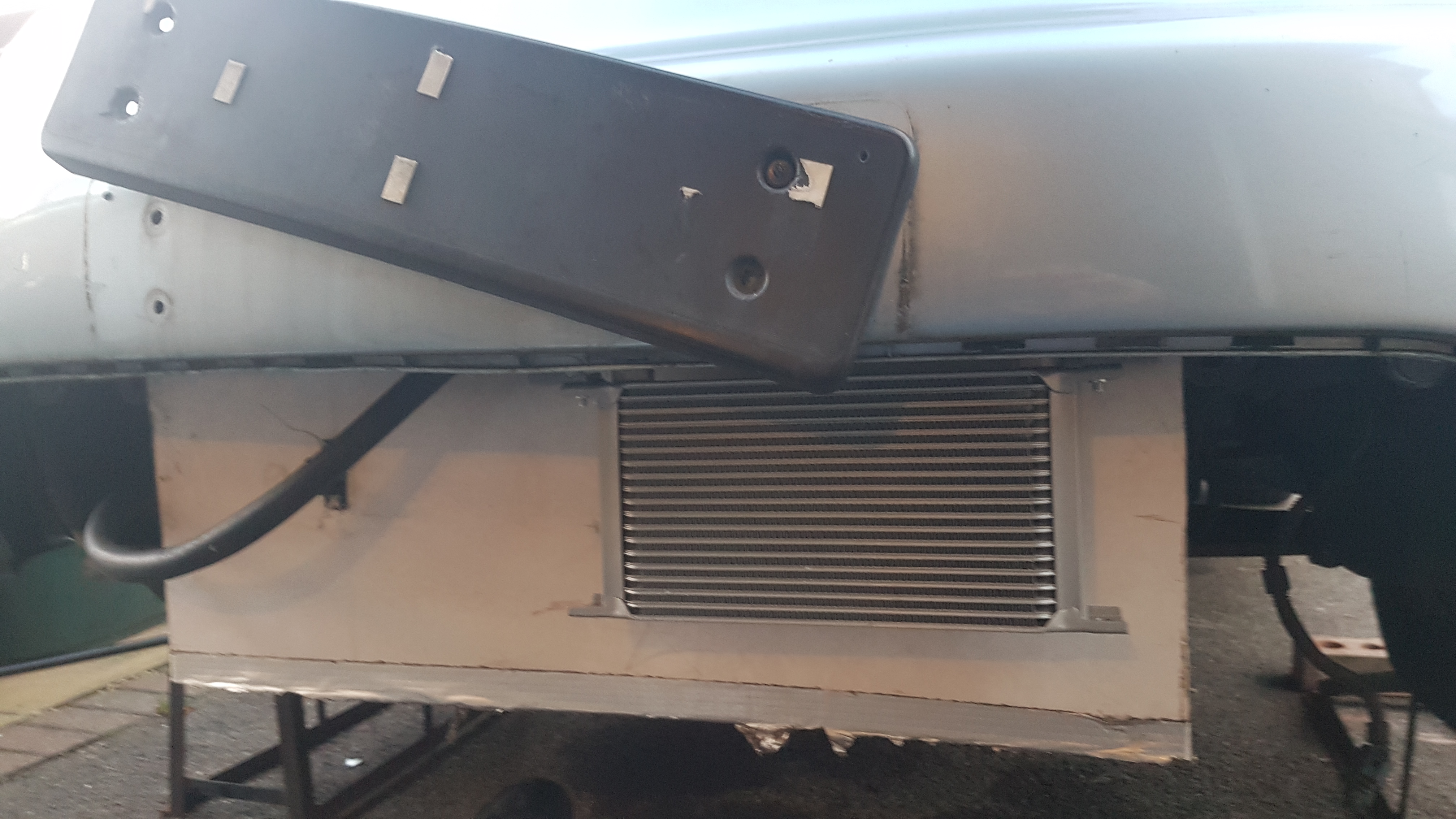

This weekend I've put a bigger radiator on and mounted the outlander water heater. Need to finish wiring it in then I can be warm

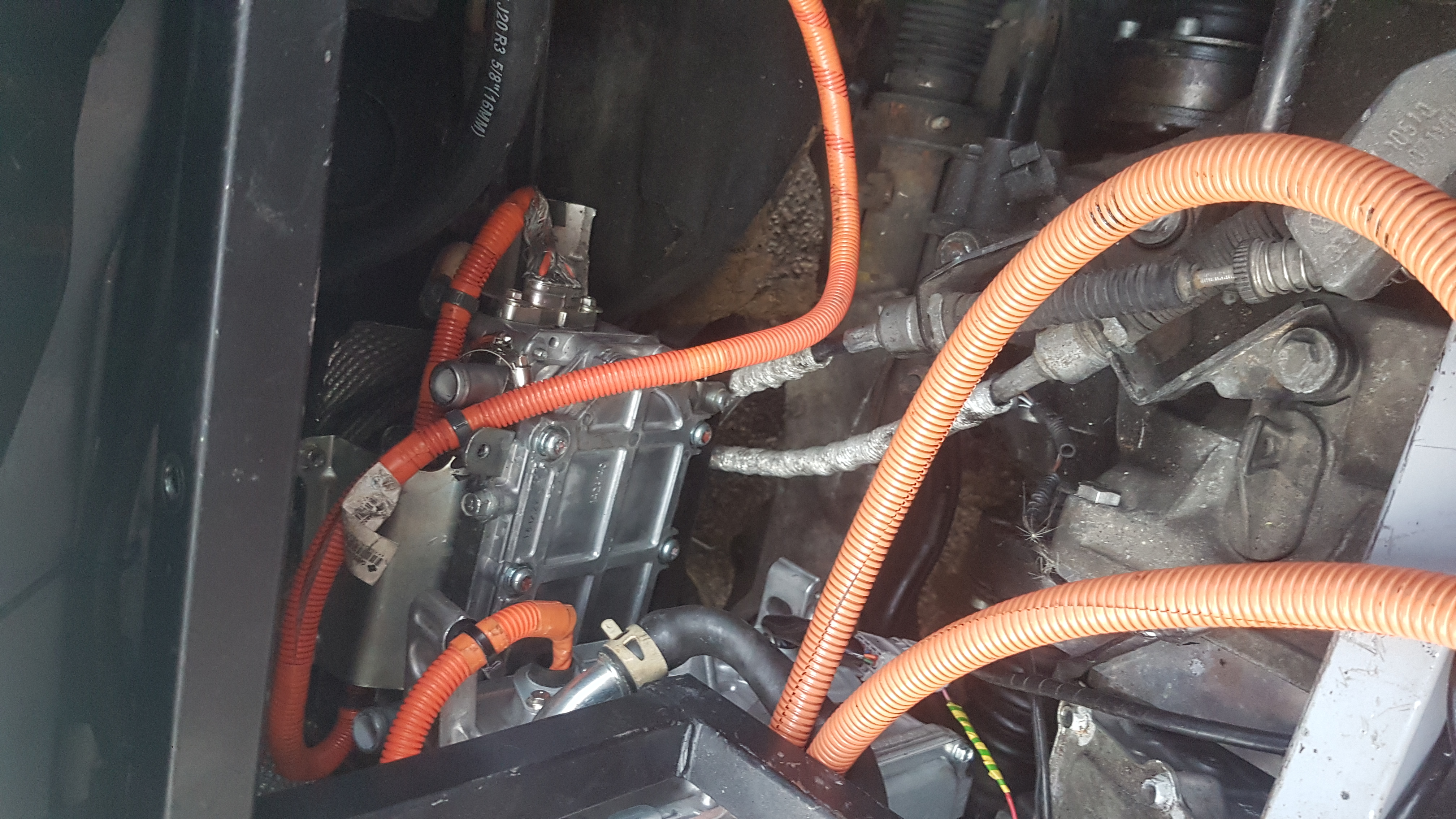

Getting there now with the rear pack. Couldn't quite squeeze the modules inline and still got to finish bolting down the front mount and the top and a few other little jobs.
So what next?

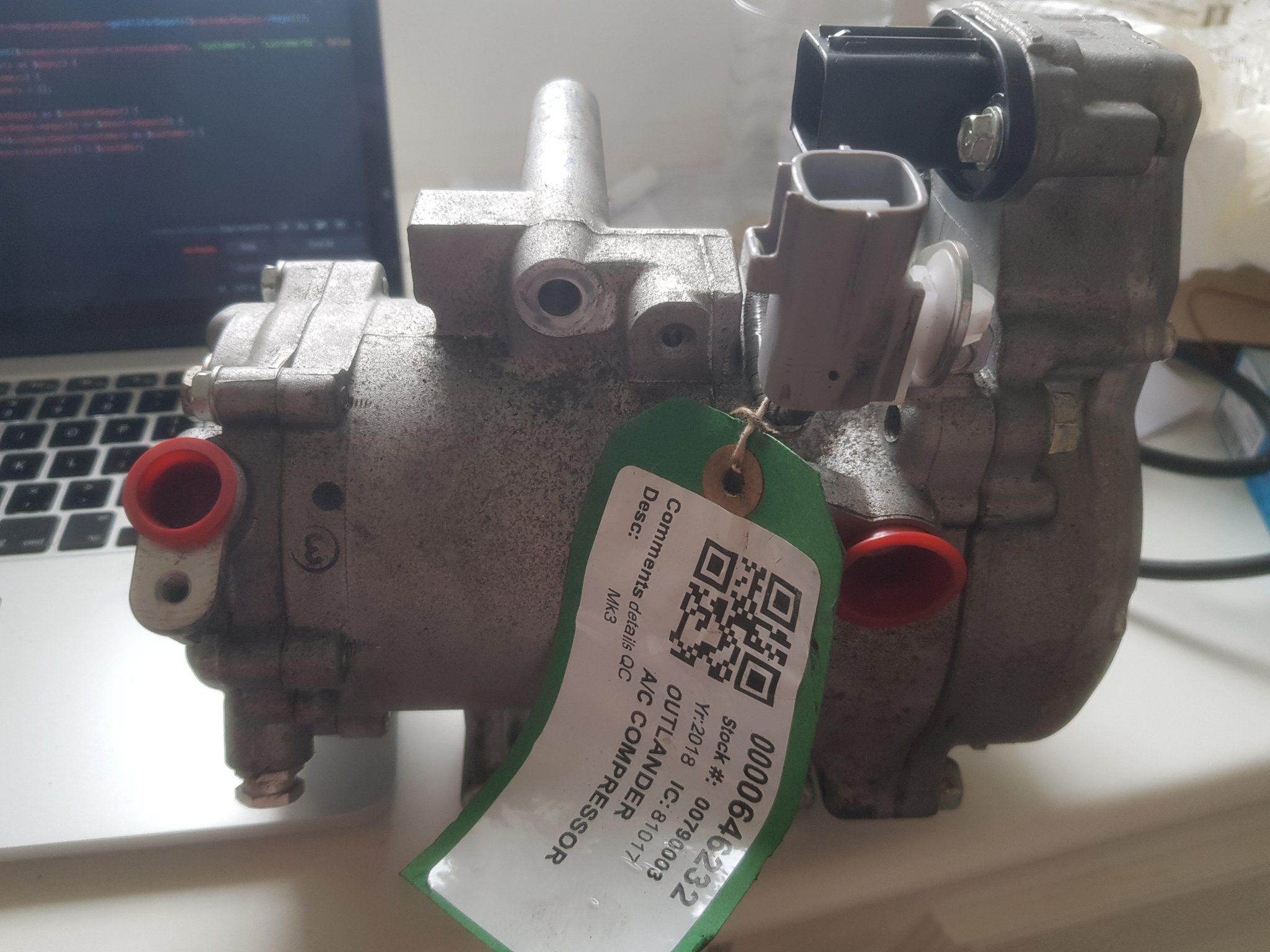

No idea where I'll be able to fit this monster, it's fairly large, also workout how air conditioning works. It's been a little uncomfortable in this heat.
