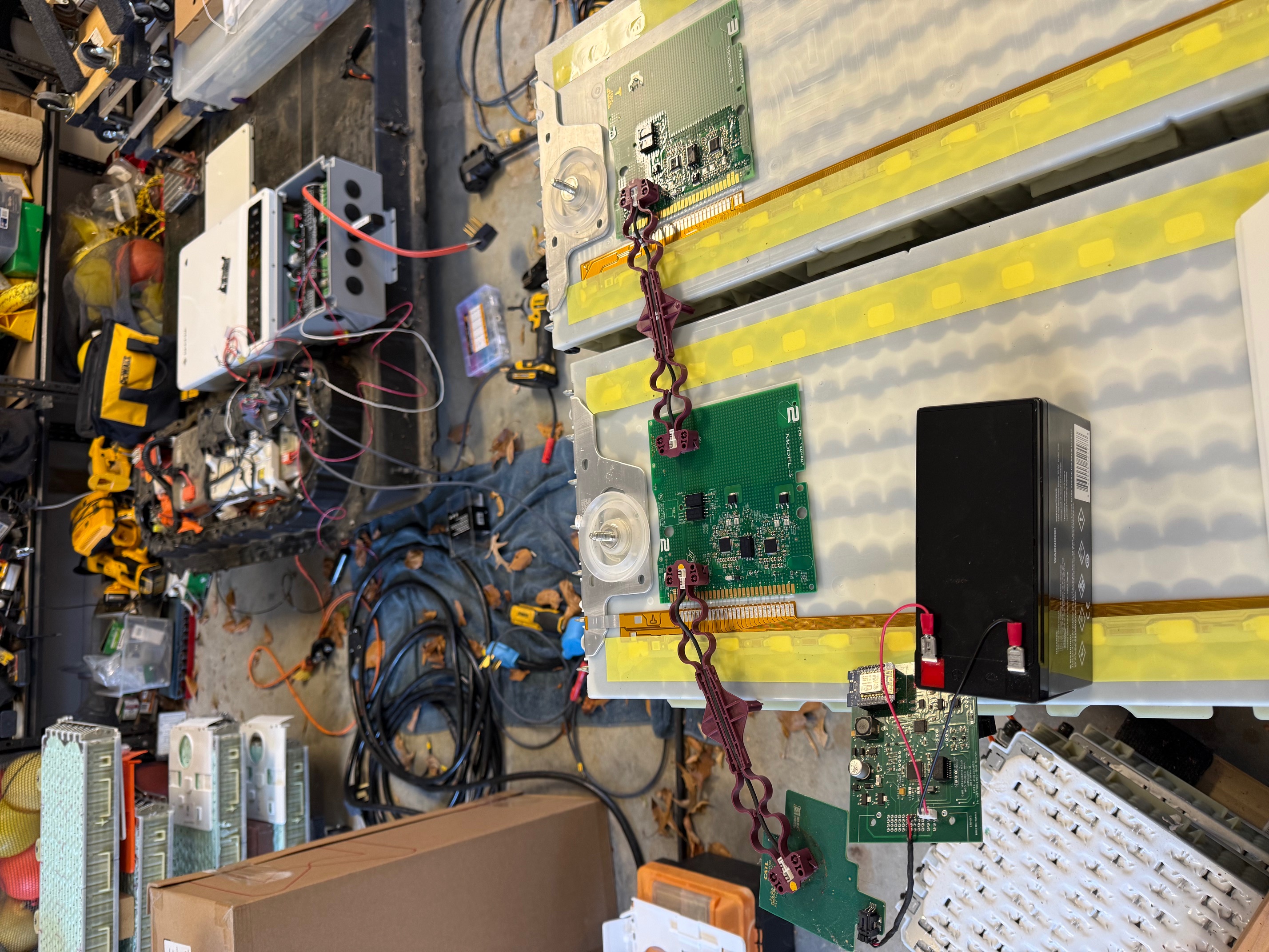

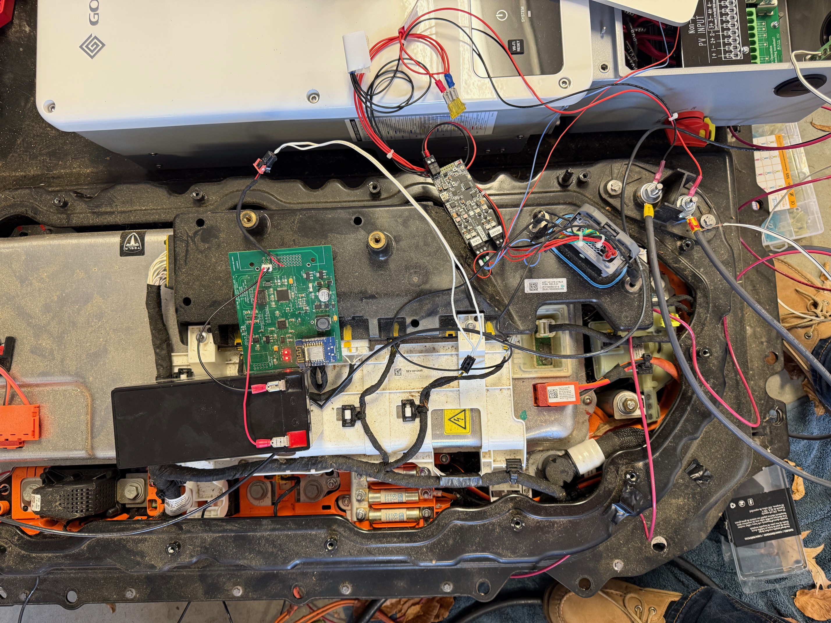

Here's my setup. This is with a Tesla RWD Model Y Long Range pack. Both ends of the ISO-SPI ring are disconnected from the HV Controller in the pack. The PCB being tested is connected to one end of that loop.
I'm only seeing cell voltages from one of the 23 cell block packs in the spot values. But I do see the correct overall pack voltage and the right voltage summaries from each of the BMBs down towards the bottom of the spot values.

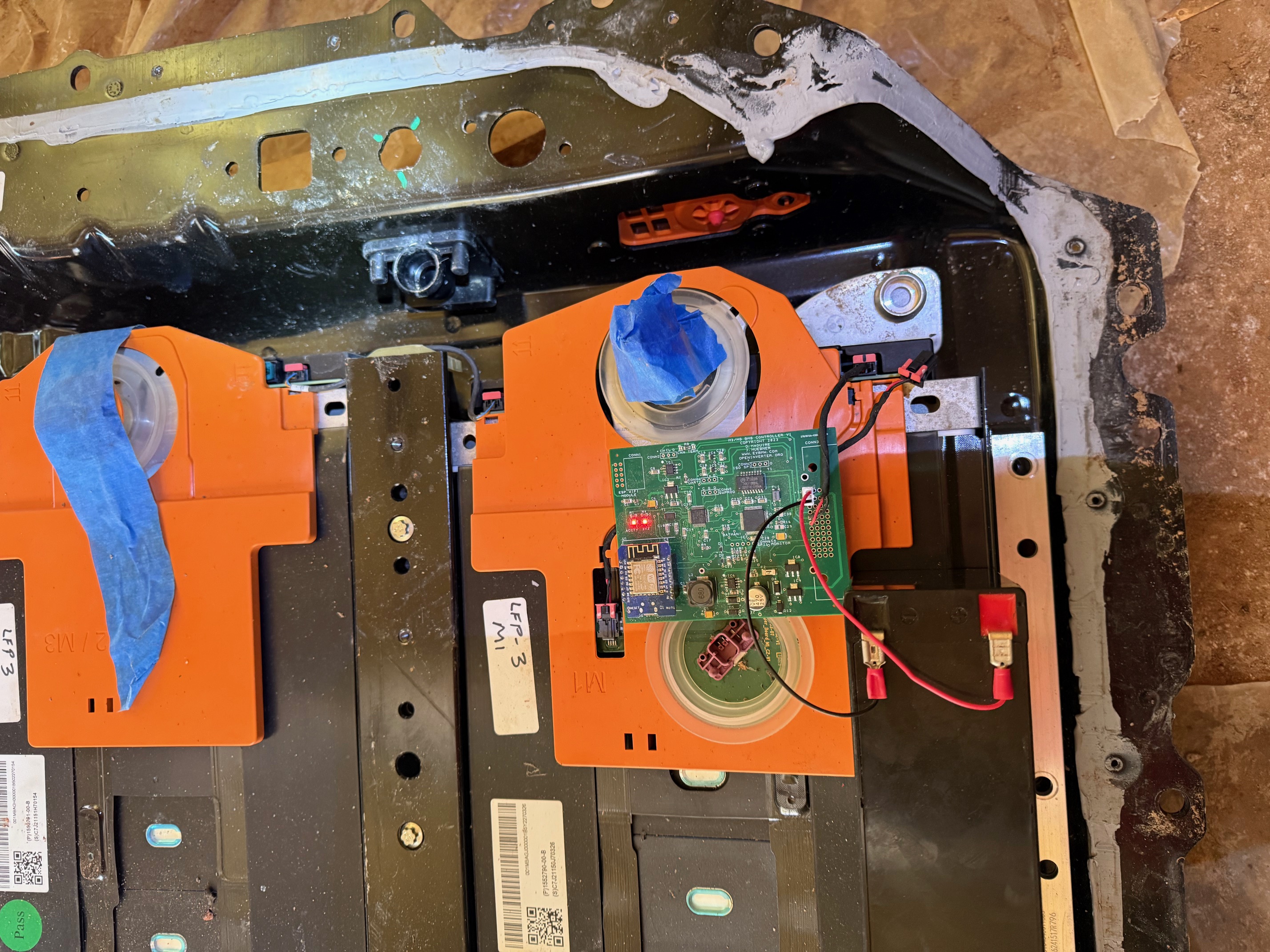

Did another test, this time with a Model 3 standard range LFP pack with just the bare modules. These modules have 26-28-28-26 cell blocks.
You can barely see in this picture that the module to module ISO-SPI interconnection jumpers are in place
It did show 26 cell voltages, which would be the right number for the first module, but the last value was truncated by 1/10.

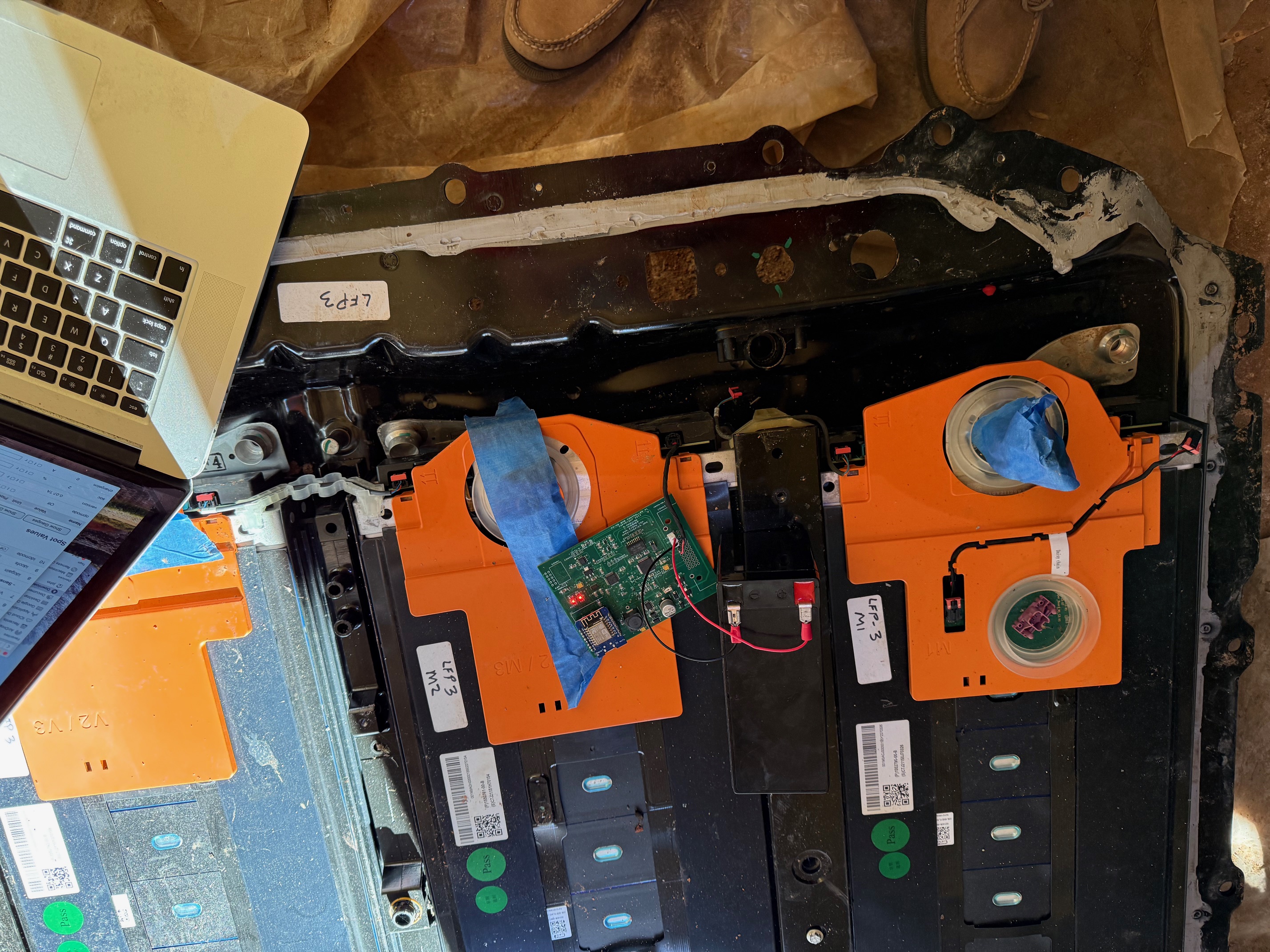

One last test on the LFP modules. I moved the board to connect to the second module with the first module emitted from the loop.
Strangely showed 27 cell blocks instead of 28 for the first module.

Re: Tesla Model 3 Battery Hacking
Please run the newer firmware, the one I sent you in DM. You need to save settings to flash for them to stay permanent.

Not saving the parameters to flash was certainly a problem. Now that I understand that, the standard long range pack with 23-25-25-23 cell groups seems to be working properly. I'll try the other pack configurations shortly.
