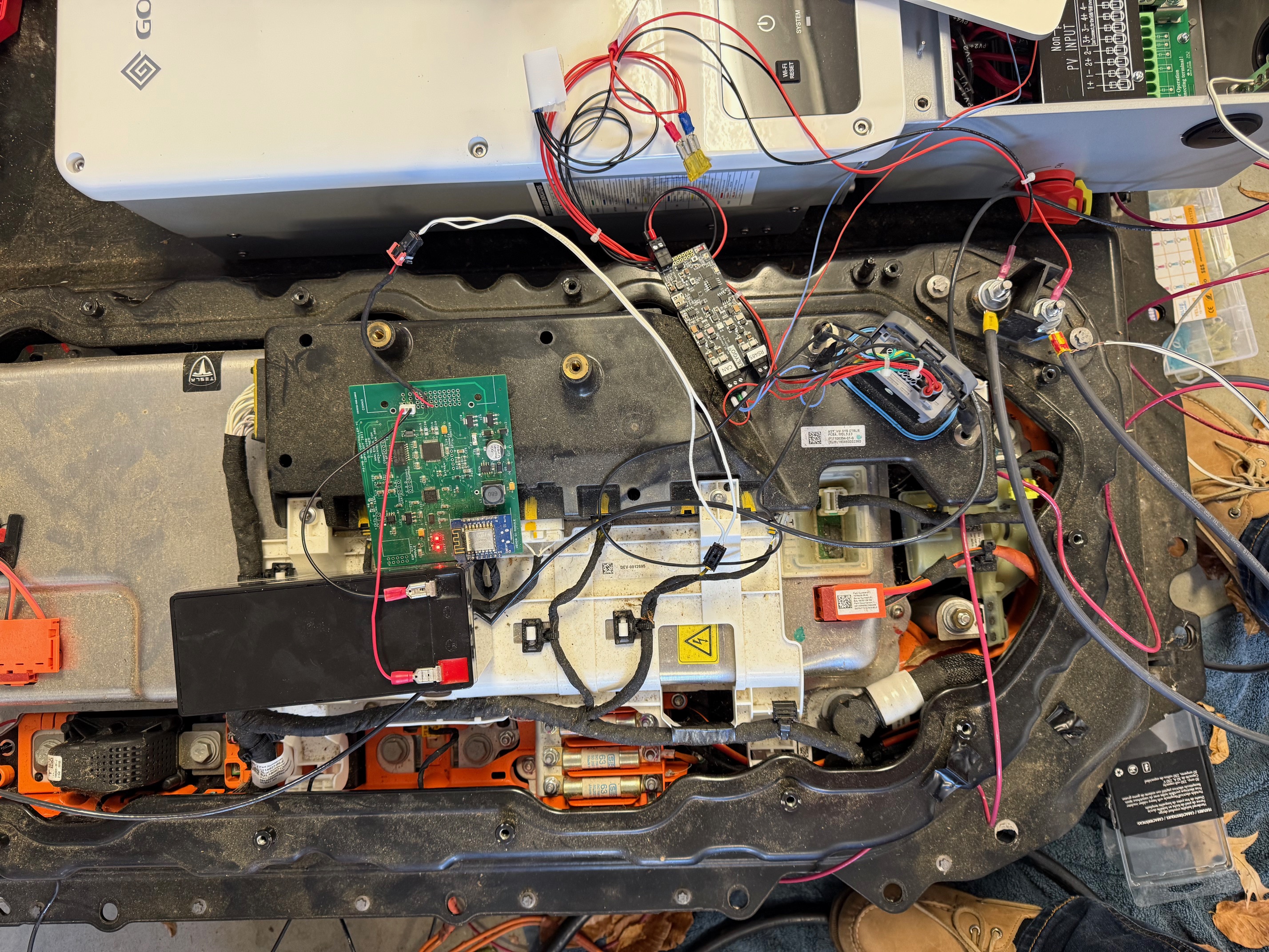

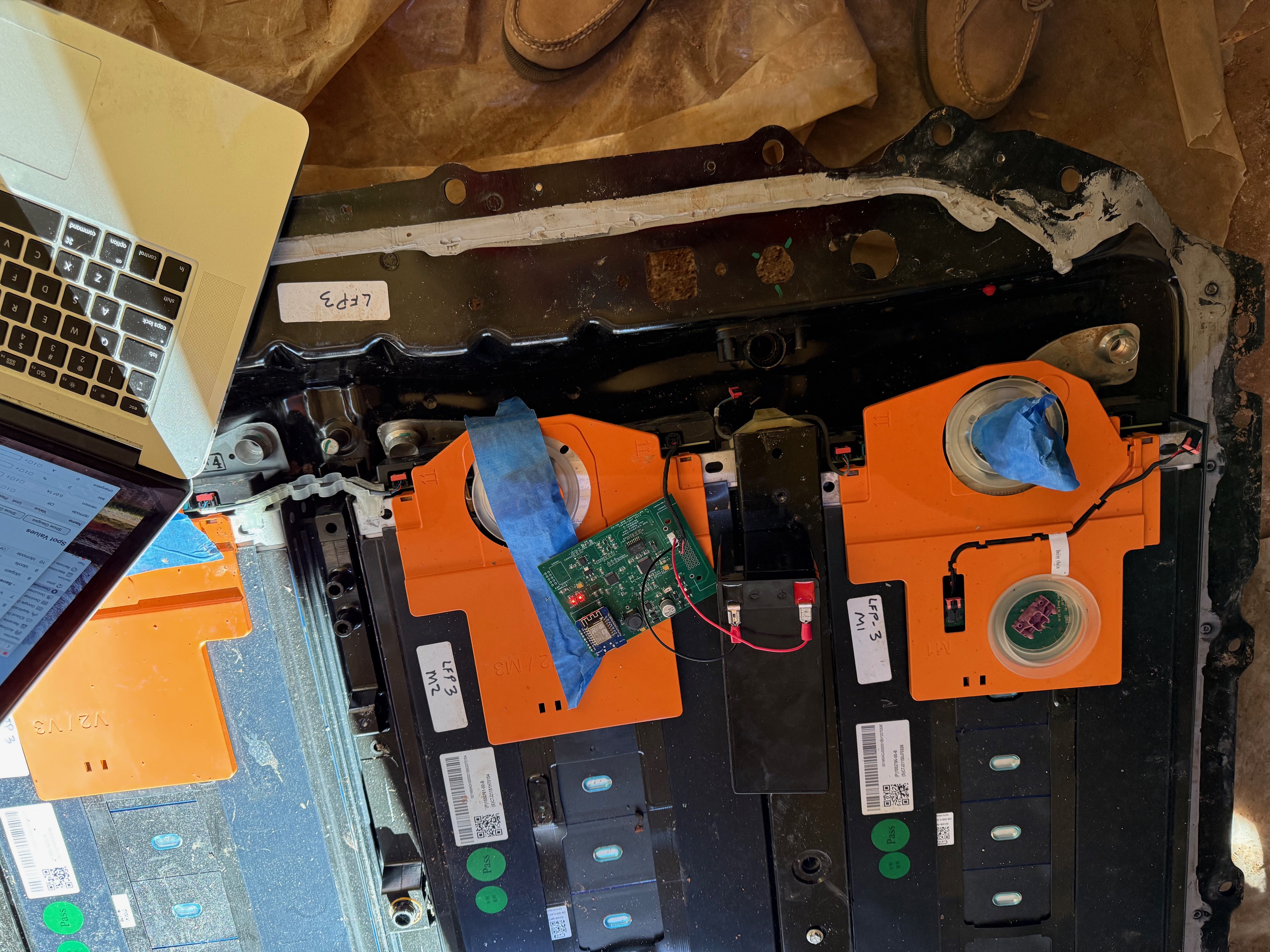

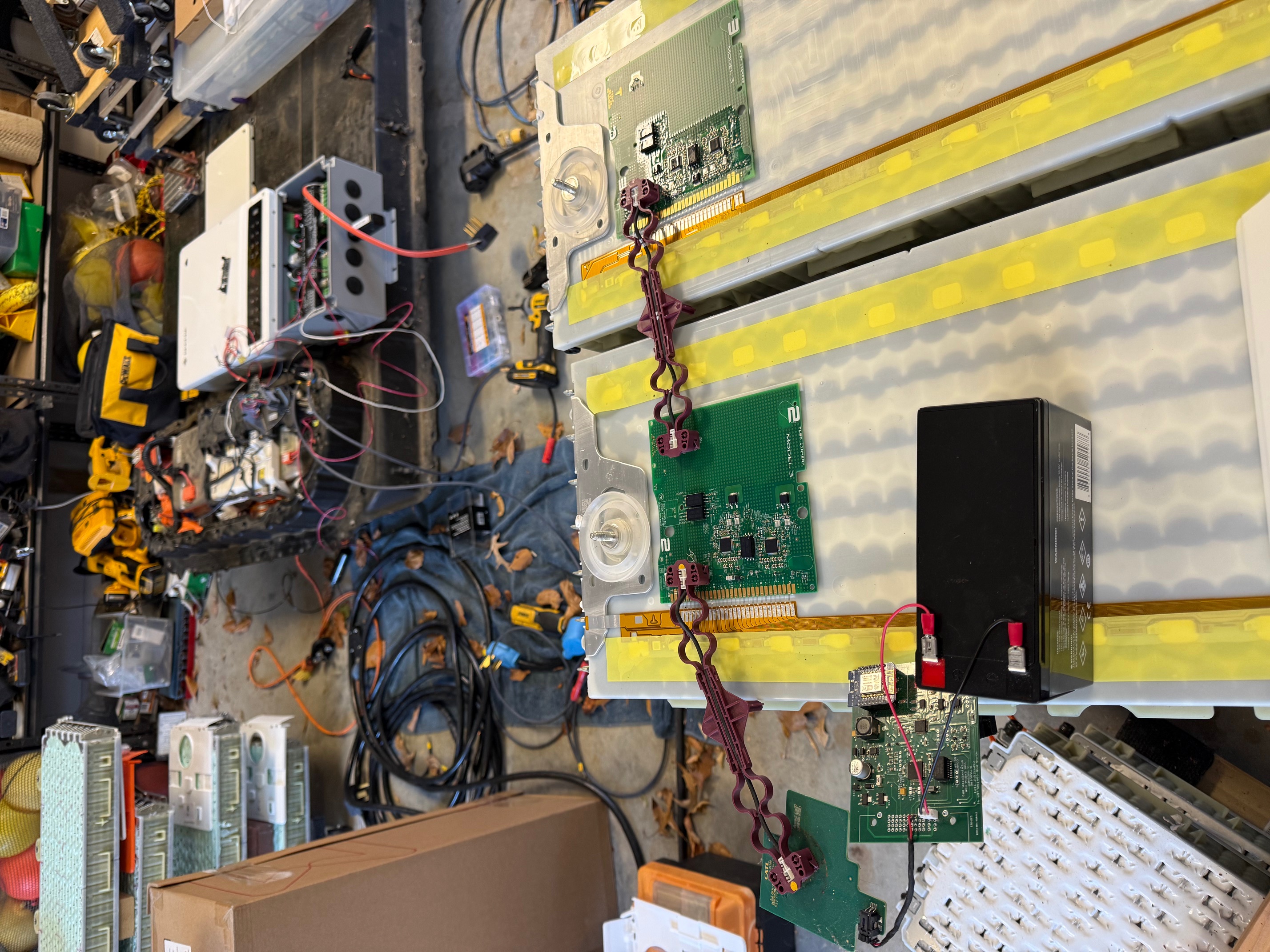

I am looking into this again and realised I only have a 24s BMB.
The weird part is that the 23s BMBs are reporting wrong amounts of cells where the 25s BMBs are fine.
If anyone has a spare 23s BMB I would be happy to do bench validation in exchange for it.

I think I know why things are going wrong with 23s modules. With the 23s modules there is a gap with an invalid value between cell 13 and 14 when reading out the data
- Posts: 2410
- Location: Bristol
- Has thanked: 209 times
- Been thanked: 572 times
Re: Tesla Model 3 Battery Hacking
Not quite, its cell 8 is skipped. I have this sorted and someone is testing these fixes. But I think there are issues with their comms between modules.muehlpower wrote: ↑Wed Apr 16, 2025 7:15 pm I think I know why things are going wrong with 23s modules. With the 23s modules there is a gap with an invalid value between cell 13 and 14 when reading out the data
Will probally push an update to github soon.
