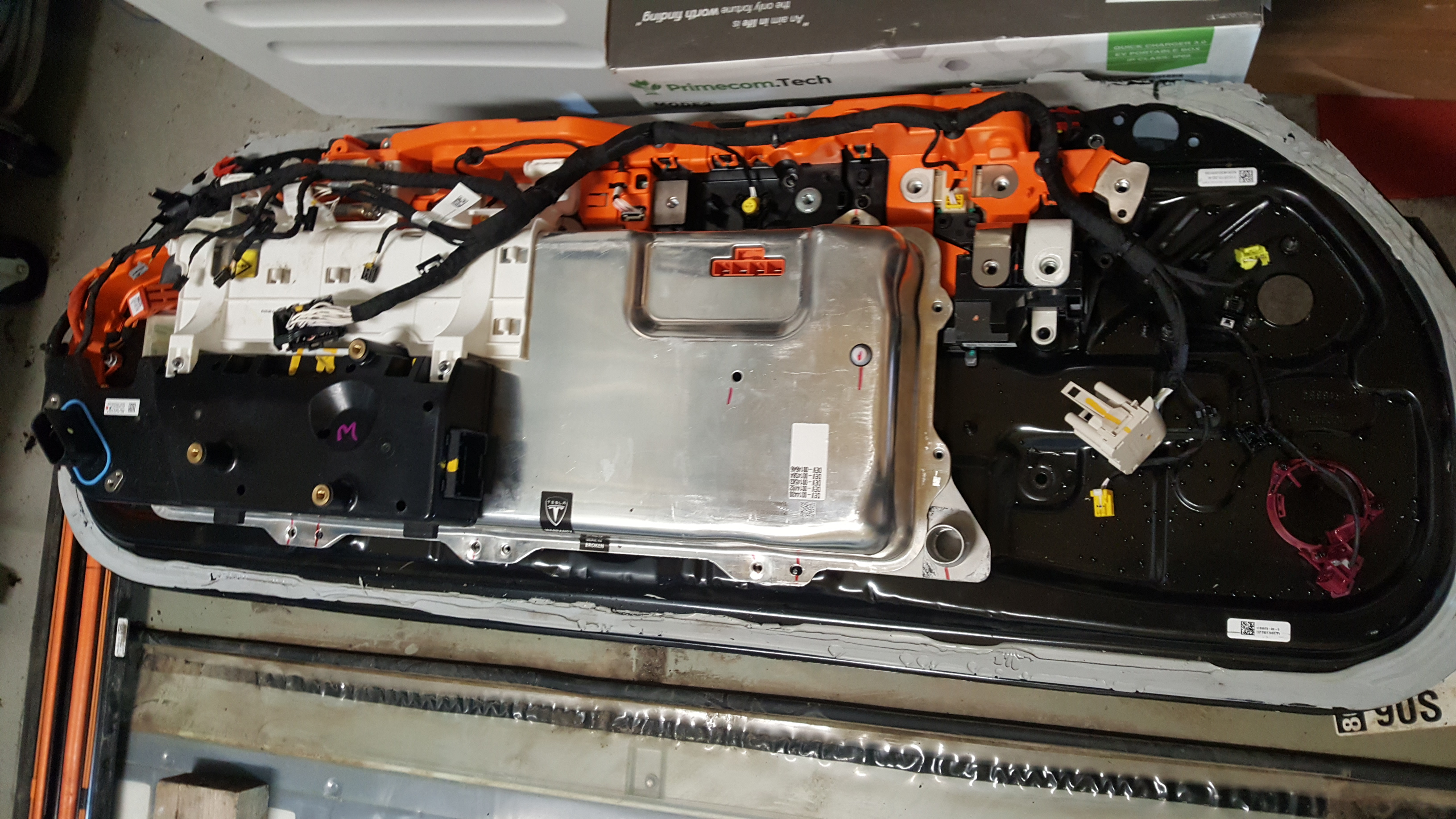

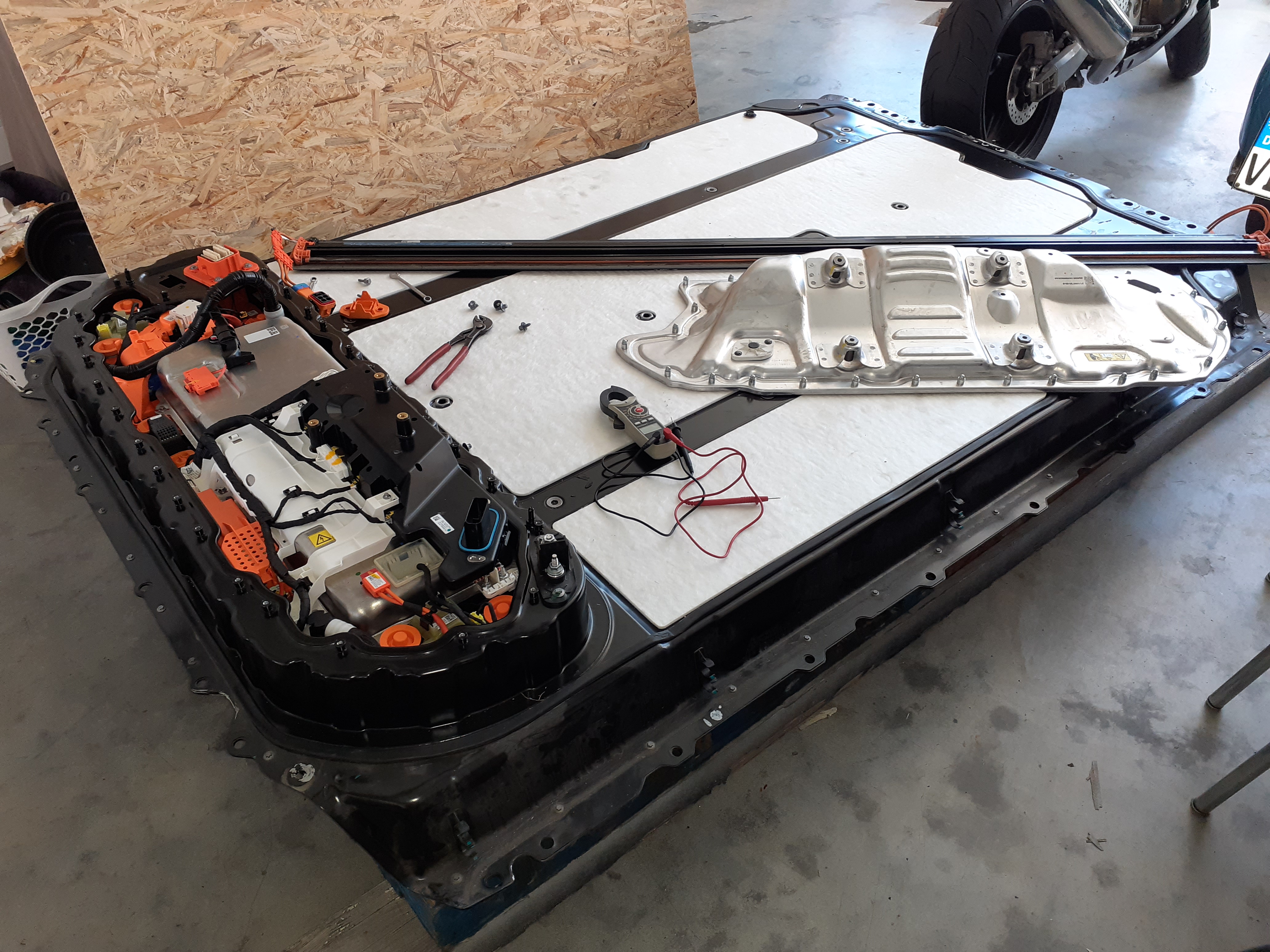

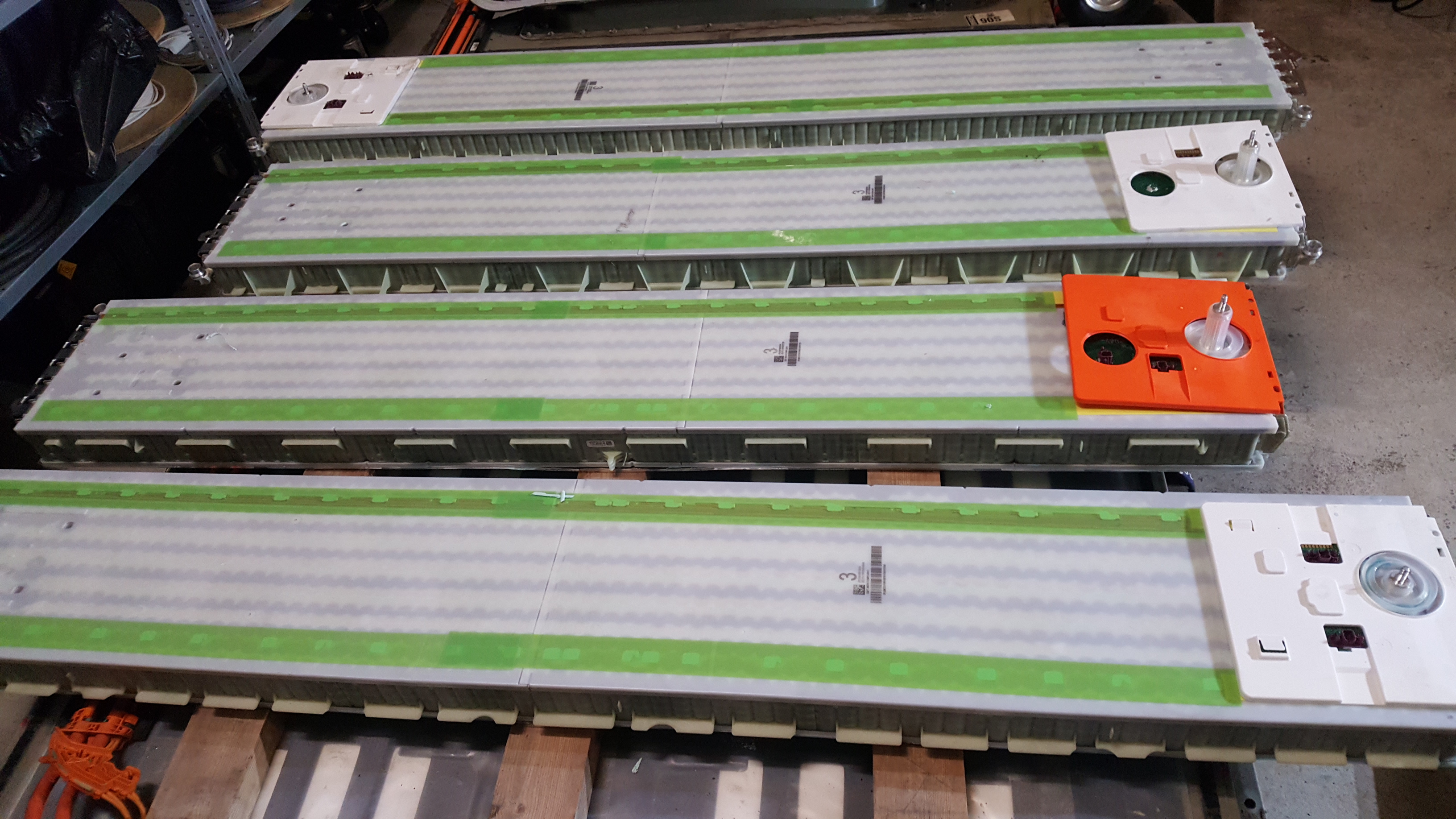

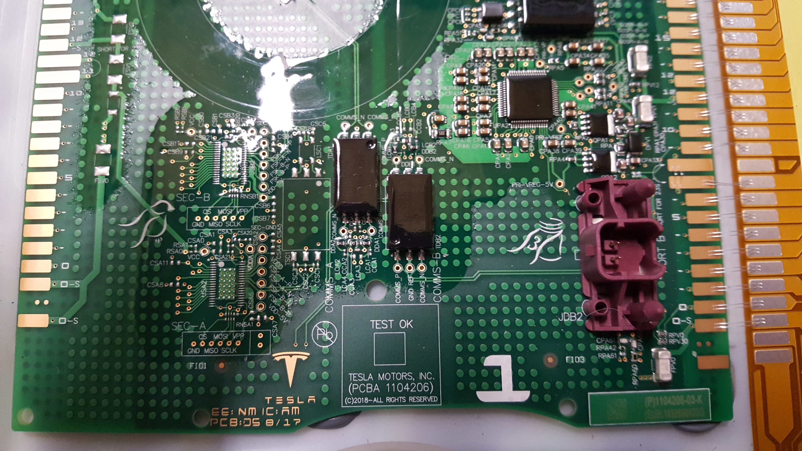

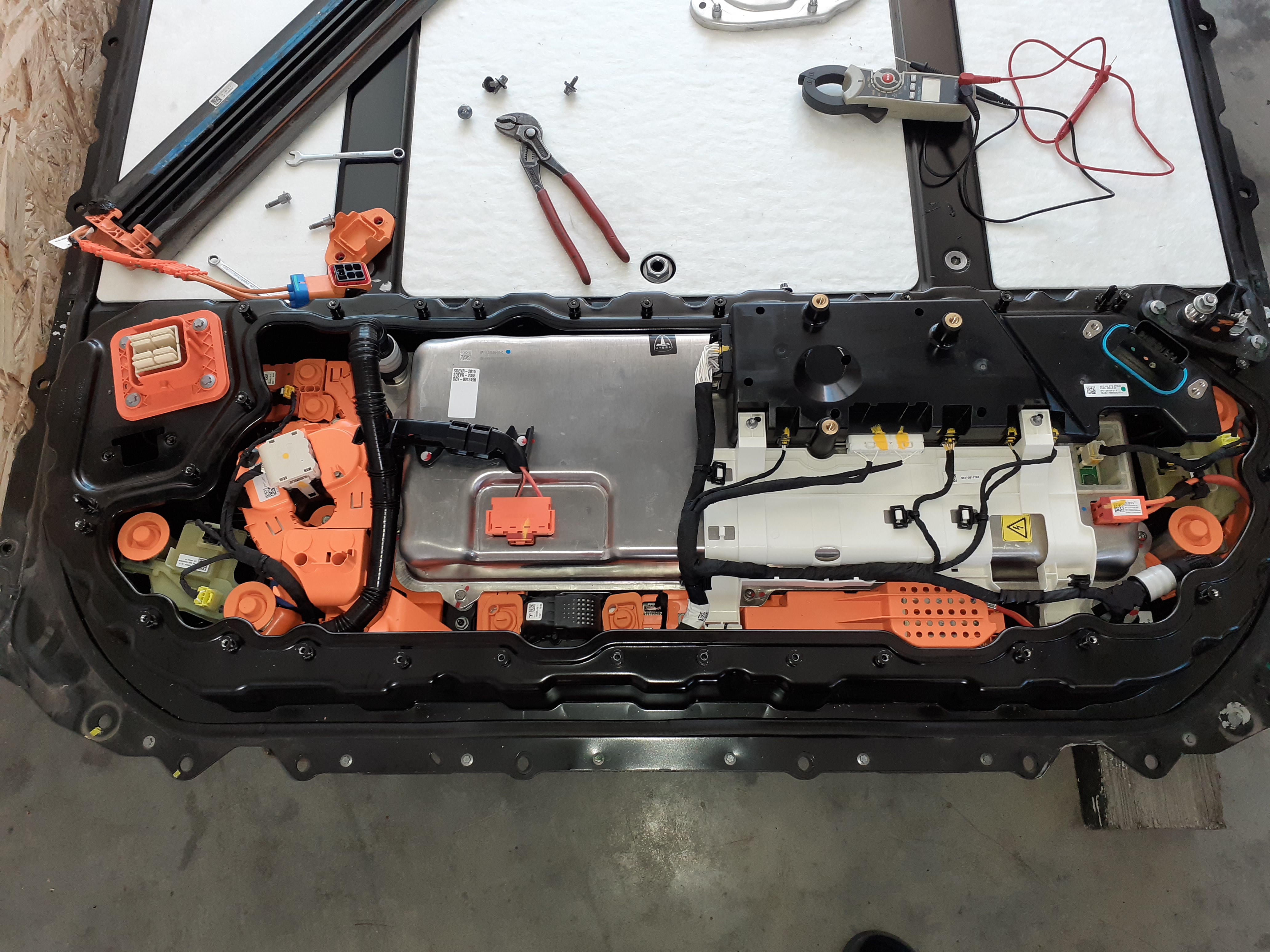

Setting up a thread to document the reverse engineering of the Model 3 battery. The specimen is from a European 2019 car with just over 20k km on the clock. We have the full guts of the battery minus the casing. First task will be putting it back together so we can begin discovering how the bms communicates with the cell modules. This will also provide a way to get some much needed info on the PCS communications with the hv controller.

The battery modules communicate via a variant of the ISO-SPI from LTC.
I have struggled myself trying to get it to work with the available dev kits from LTC, had no real luck getting it working.

DCA2617A with an LTC6820 on it. I have found some others who tried the same as myself and just found it too much of a struggle to get working.
I would almost think Tesla has taken the ISO-SPI and gave it their own spin, like they done with the Model S battery slaves.

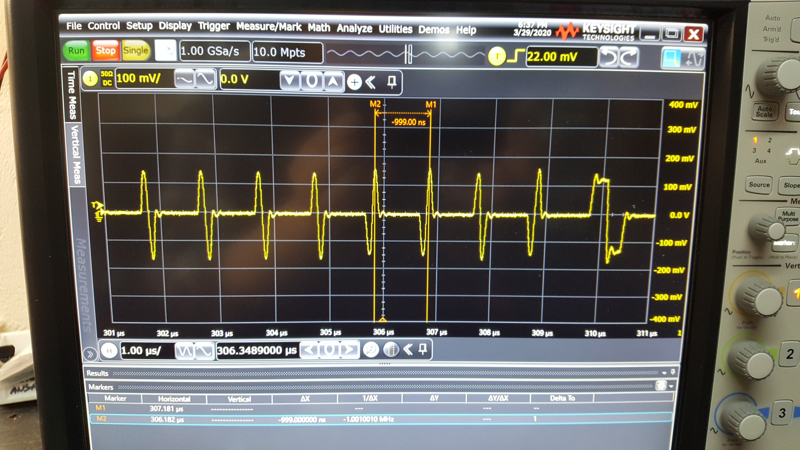

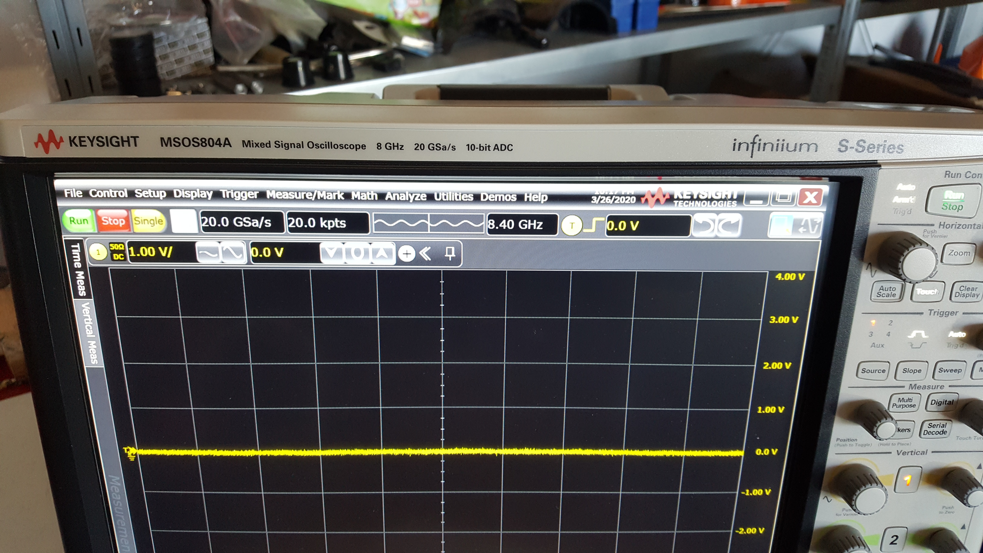

Posts: 3999
Been thanked: 1114 times
Re: Tesla Model 3 Battery Hacking

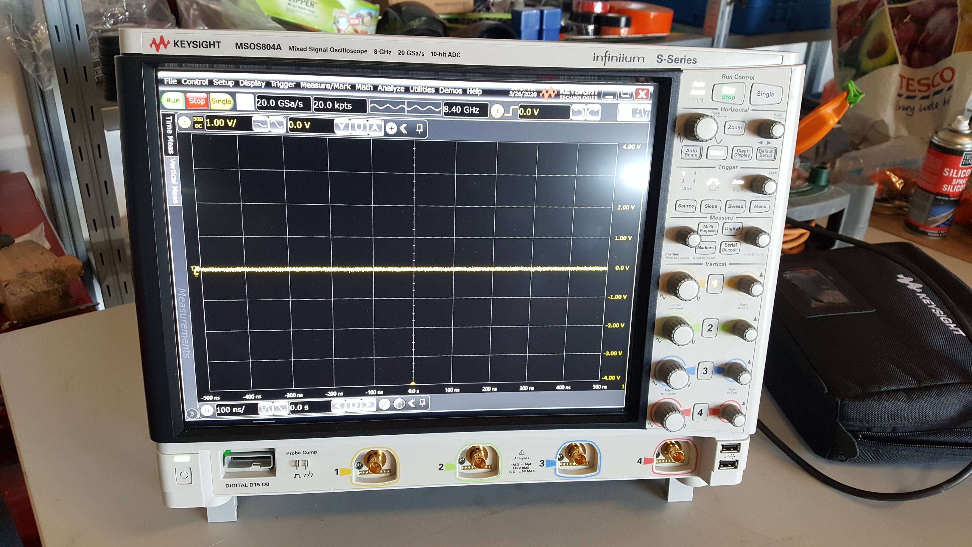

Let's see what this baby makes of Elon's weird bms comms ...
cloudy
Posts: 210
Location: UK
Been thanked: 7 times
Post by cloudy »
A little overkill perhaps?! That's a rather nice (and expensive) scope! : :D
Bentto
Posts: 27
Joined: Thu Feb 13, 2020 6:55 pm
Location: The Netherlands
Post by Bentto »
WTF that's a serious badboy.
Posts: 3999
Only the best for Mr.Musk:)
clanger9
Posts: 205
Location: Chester, UK
Post by clanger9 »
Crikey, where did you steal acquire that from??

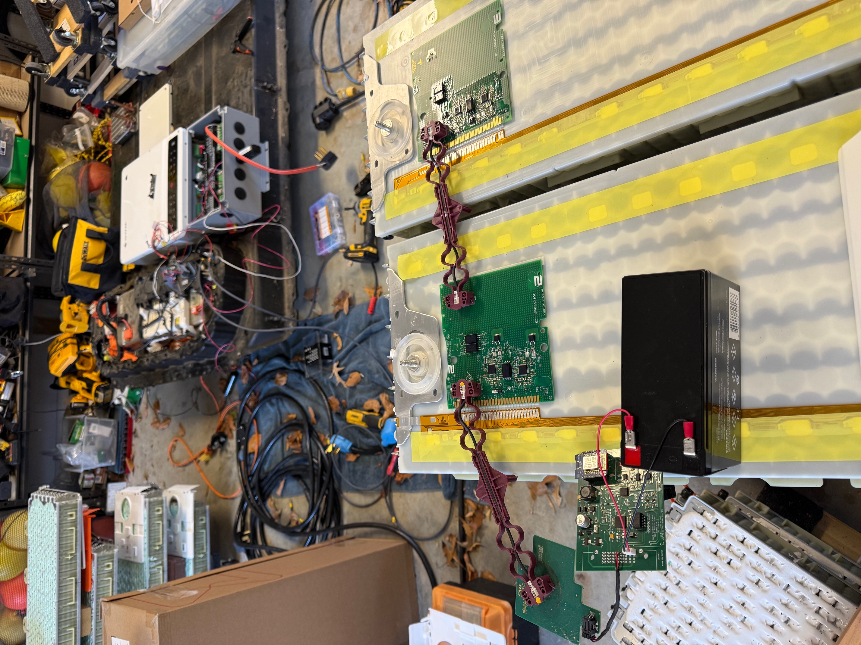

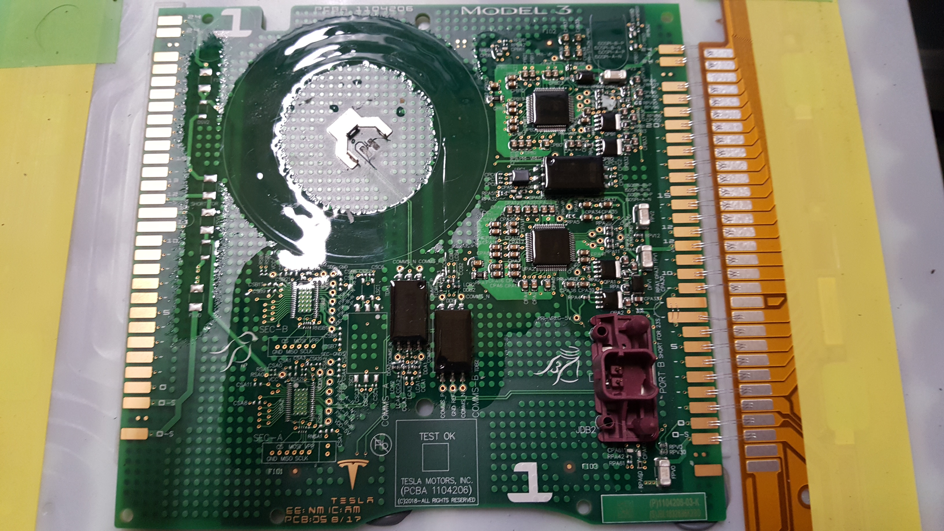

Let's see if we can figure out what Batbrain and the Boy blunder are at.......

clanger9 wrote: Thu Mar 26, 2020 8:05 pm Crikey, where did you steal acquire that from??
https://twitter.com/EvBmw/status/124319 ... 47526?s=20
Datasheet for the isolation transformer used on the bms comms.
XFBMC29DNC-BA09-A.pdf
