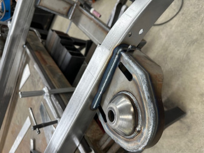

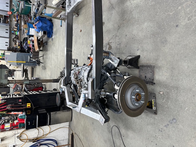

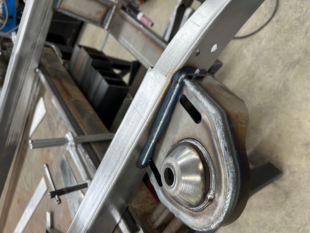

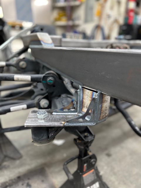

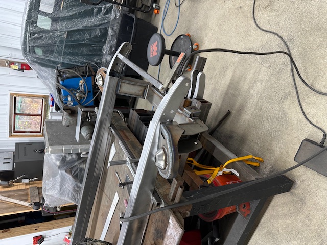

I'm just starting a project. I have a 1930 Model A ford that I'm converting to Electric.
I have a M3 980 motor and subframe just about ready to assemble. Im still looking into battery options. Any suggestions are more them welcome.

Nice project. I also have a 1930 Ford. Yours appears to be a coupe. With the Mustang II front axle and the height of the frame, I assume it will be a full fender. Do you drive with a hood? Then you have enough space for the battery, and without a cardan shaft, there is also space for a few modules between the frame tubes. Do you have a seat or trunk in the back?

I will have fenders and a hood. I would like it to look as stock as possible. The car has a trunk in the back I would like to keep the weight as far back as I can with luck it will wheelie. I'm going to pick up the body in Florida next week and once I get it on the frame I will know more. I would love to see more pics of your car.
