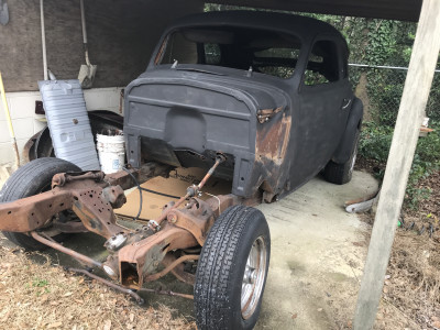

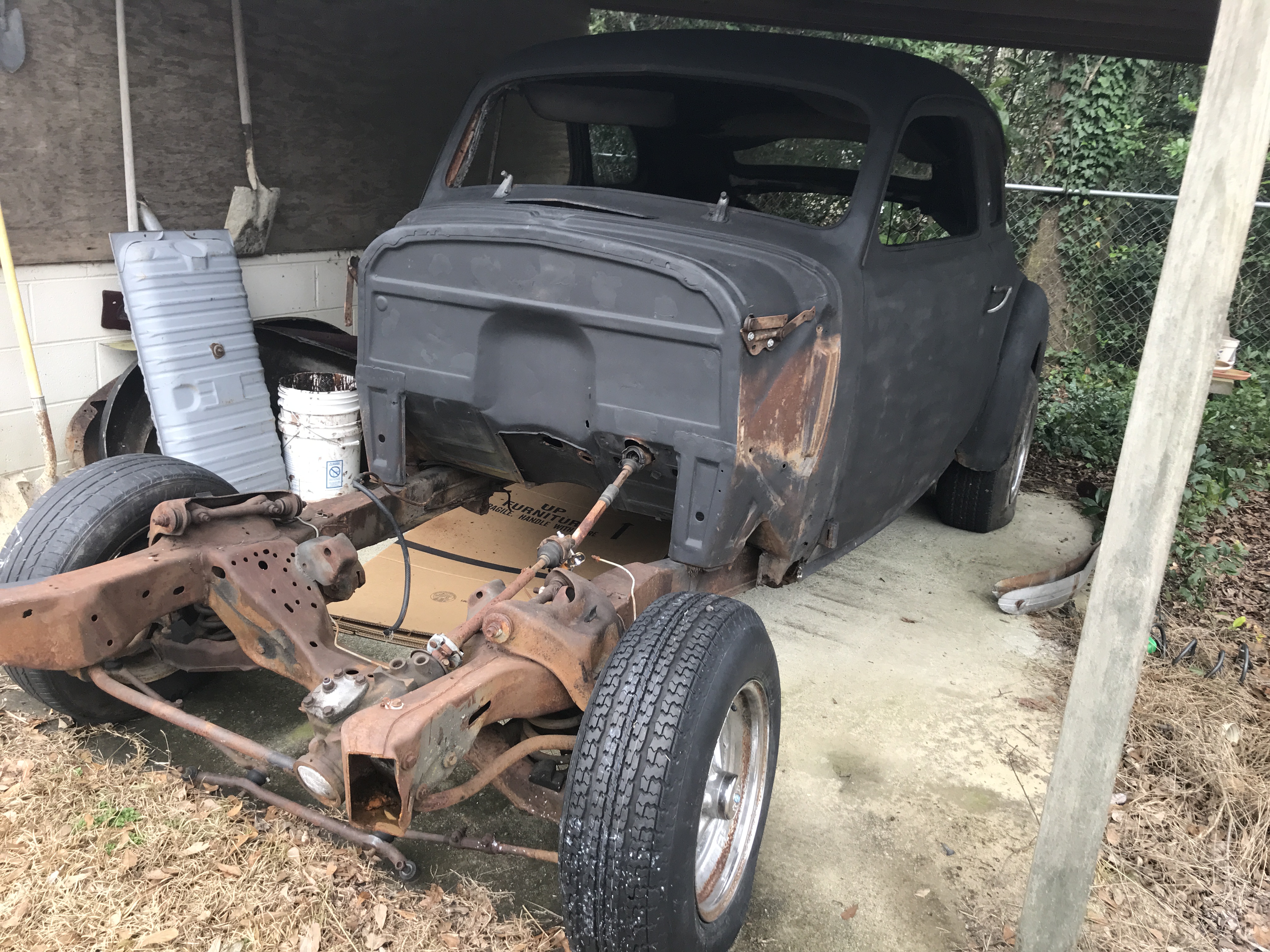

I am working on a 1940 Chevrolet coupe which will be getting a Tesla LDU with Damien's control board, as soon as I have the money for both.
Other planned components:
-LG Chem Chrysler Pacifica batteries
-Orion BMS and Elcon charger, providing CHADEMO and J1772
Goals:
-1st EV Conversion on Hot Rod Drag Week
-NEDRA Record hunting
-local bracket racing
I'll add some photos soon

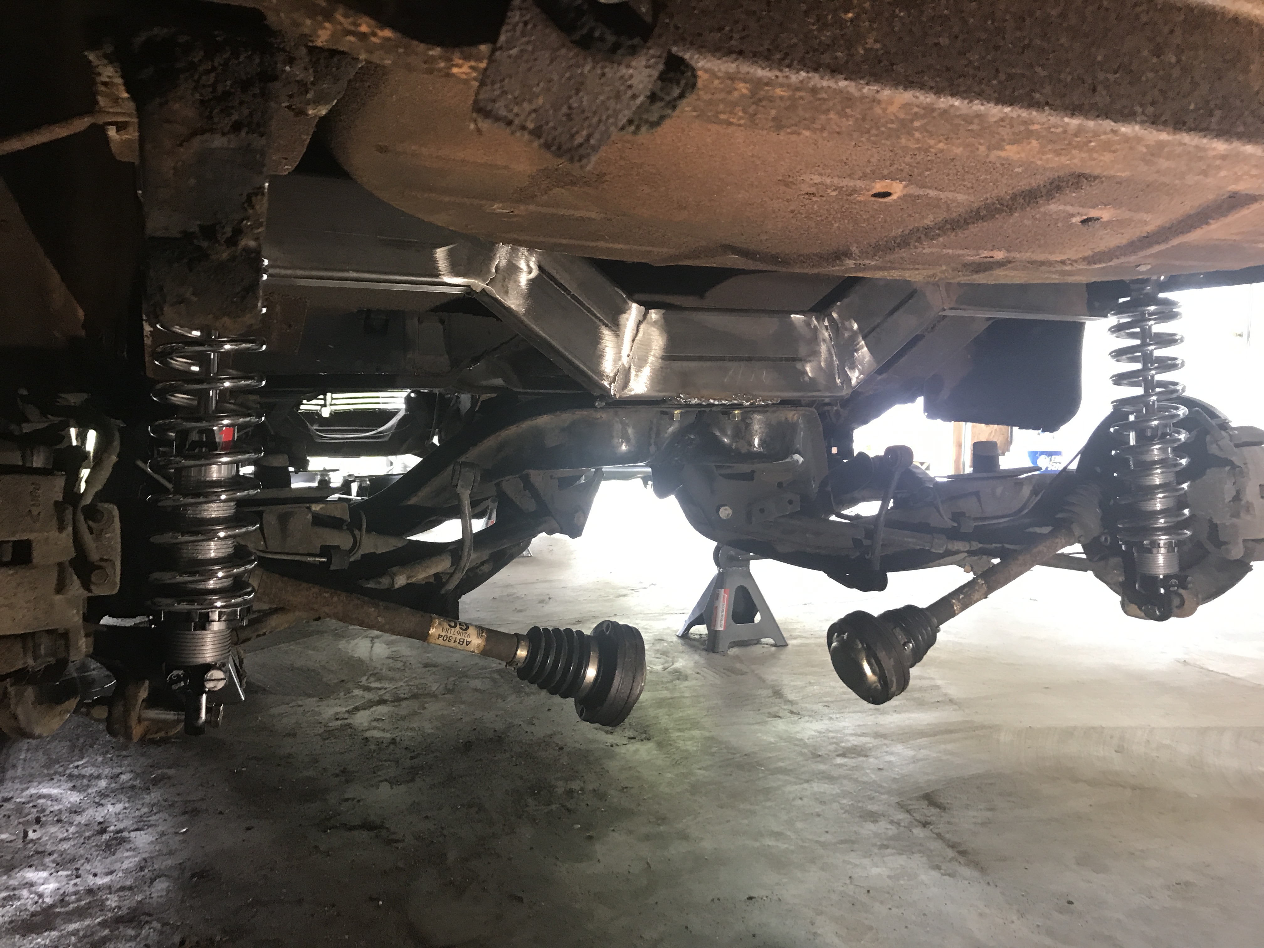

Picked up suspension parts this weekend, I'll post photos when I get a chance.
I'm going to be using the suspension from a 2004-06 Pontiac GTO, so that I can use the LDU in its original orientation and location.
Now to cut out the old live axle, narrow the GTO stuff, build mounts, pick up a motor, build more mounts.....

Yes, and the model is how I threw out a few other suspension options (C5 and C6 Vette, 15+ Mustang).
I was looking at a custom designed IRS but stumbled across a video of a GTO rear suspension and realized that nothing is behind the axle line.
I don't have good measurements of the '40's frame (the service manuals only have a few dimensions) but I'm hoping to get some once I pull the live axle this weekend. I'm only going to have to narrow the GTO stuff by about 3-inches to keep the wheels and tires I want under the stock sheet metal. In theory.

I can see the appeal of the GTO suspension, only two mount points each side. The Model S suspension is really neat but a massive pain to fit to a live-axle chassis. I'm persisting for now because I'd like to keep the air-struts... this may change.
You can get surprisingly good results by putting a screenshot of the frame out of the workshop manual in cad and sketching over it by eye in plan and side view then intersecting the two sketches. Add a few waypoint dimensions from your actual frame and it'll be pretty close. I bought a 3d scanner and found it easier to dump .stl files into cad and reference them to the factory manual dimensions

Its nearly impossible in something narrow like the '40. I bet you'll have a bit easier time in the '57.

Because it is simpler to swap in a factory setup, and since the goal is to run this on drag week I wanted to have the highest chance possible that I can get parts to fix things I break on the road.

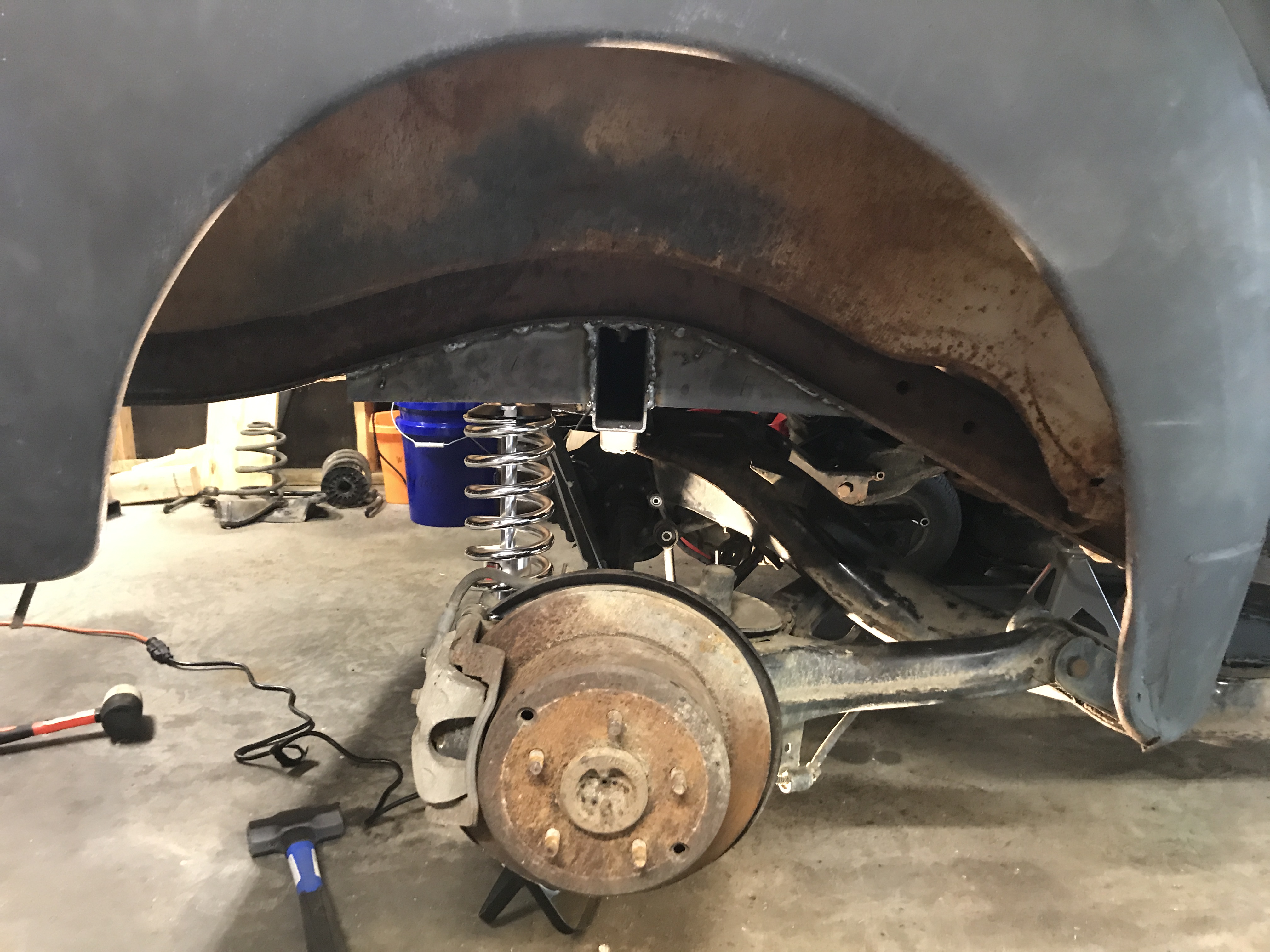

My main rear suspension mounts are done, and the passenger side rear control arm is in place. The driver's side just needs to be bolted in, I ran out of time this weekend. From there, I will just need to fabricate coil spring perches and shock mounts. I hope to switch to coil overs in the future, but right now I just want to get it running.
Further work is on a tentative hold. I need more parts before I can do anything, and I've put a hold on spending due to the covid-19 crisis. Mostly being over cautious and diverting "fun" money to emergency savings. So for now, its just finishing up what I already have, and prepping as much as I can for when I can get the next big items (motor and cage) purchased.

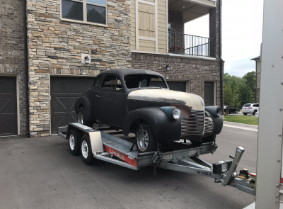

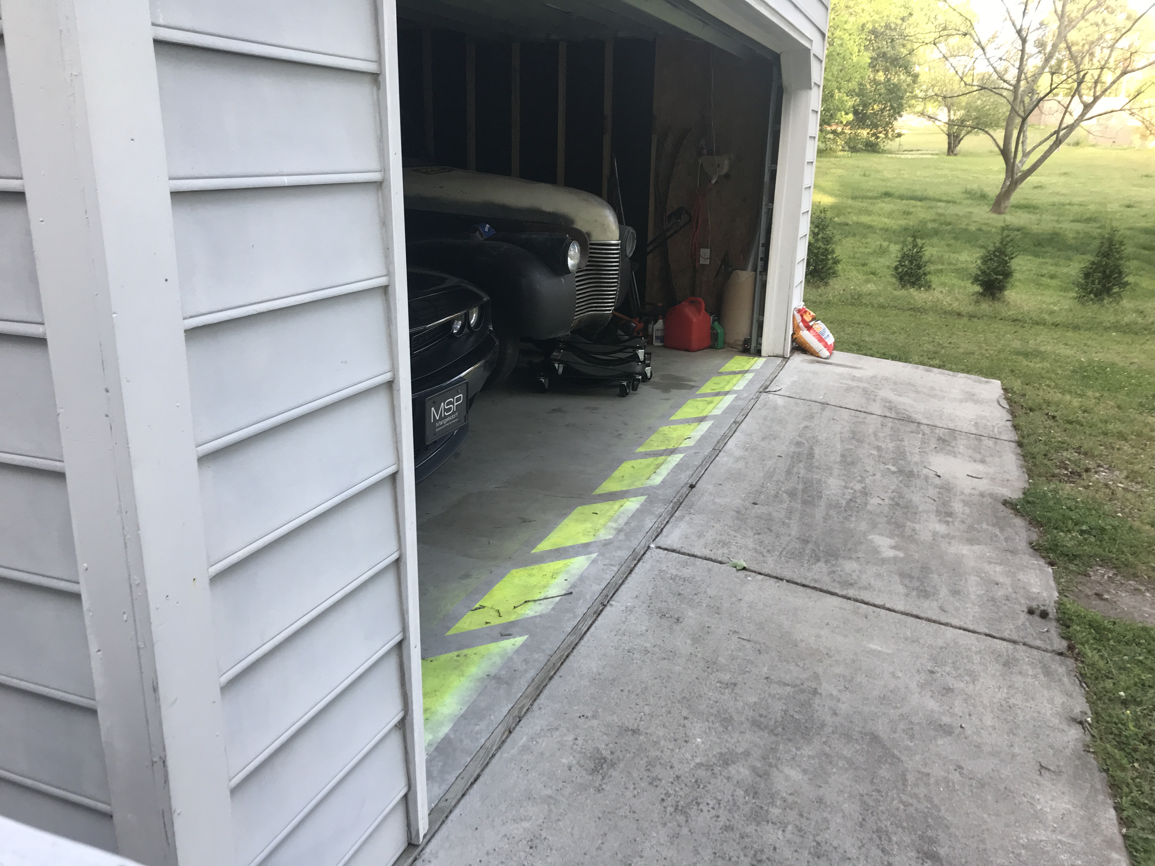

Finally an update with photos!
The rear suspension is complete. The shocks will need adjusting once everything is together, and I will likely need to tweak the spring rate once all of the weight is in the car. Good thing vibrations are my field. The plan will be to get everything put together, and then adjust the rear spring rate until everything is compressed the right amount at the right ride height etc. Then I'll se the front spring rate with math so that the vibrational modes are decoupled.
At this point I cannot proceed until I get an LDU in the garage. Likely in the next 1-2 months.
Photos include
-When I bought the car (no nose)
-Moving from my apartment to my house
-the full rear suspension
-the rear suspension from the passenger side
-a cool shot (in my opinion) of the 40 and my daily in the garage
