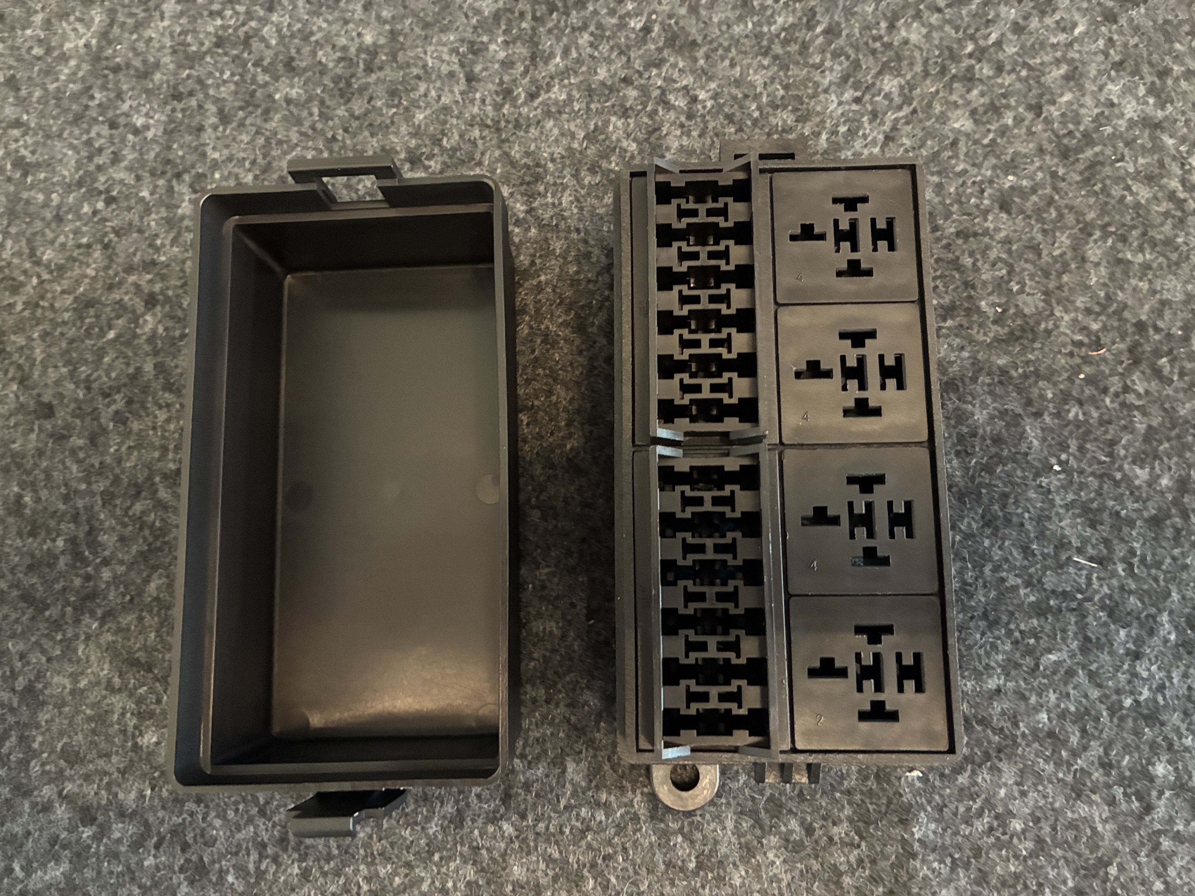

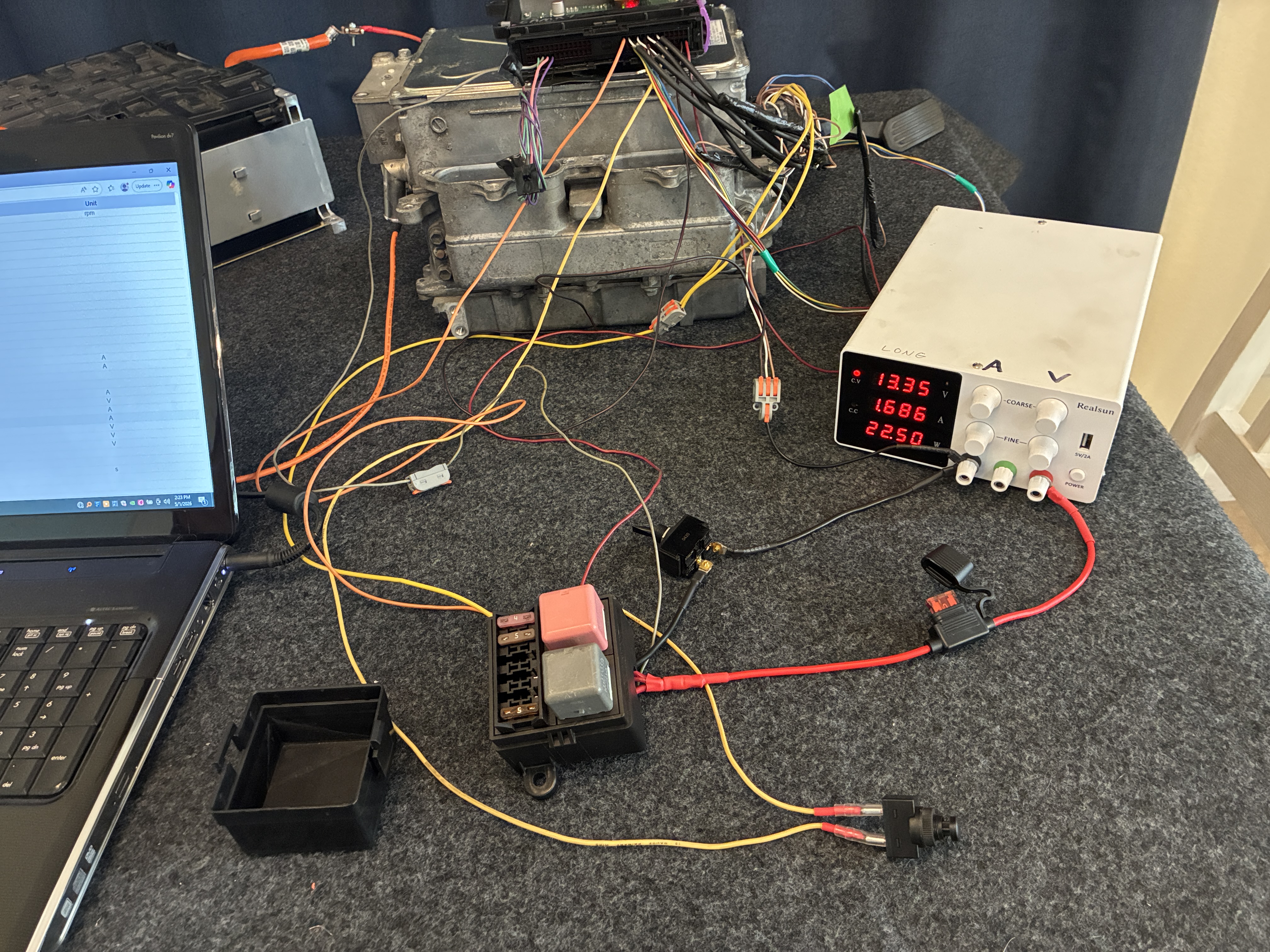

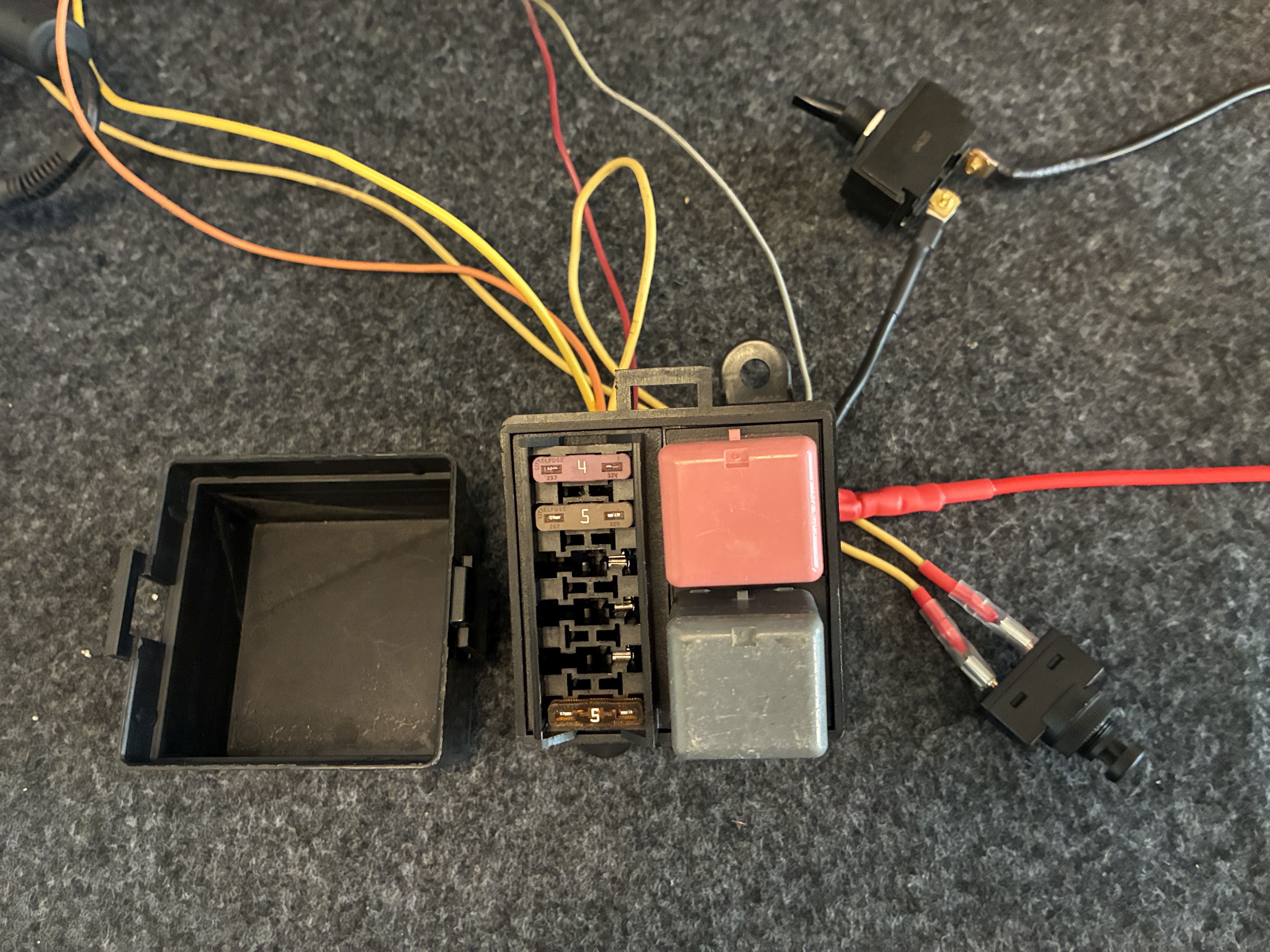

nothing to see here just working on a fuse/relay box prototype to start including with the kits, there will be two versions of this box, a BASIC pictured below and an [ahem] Not Basic, for expandability. All you will have to do is connect two wires to the 12v car battery, there will be an On/Off switch and a Start button. This is designed to act like a completely stand alone EV wiring harness/system, which you can run as is or integrate to your vehicle.
I hope to feature this in my eBug conversion soon.
