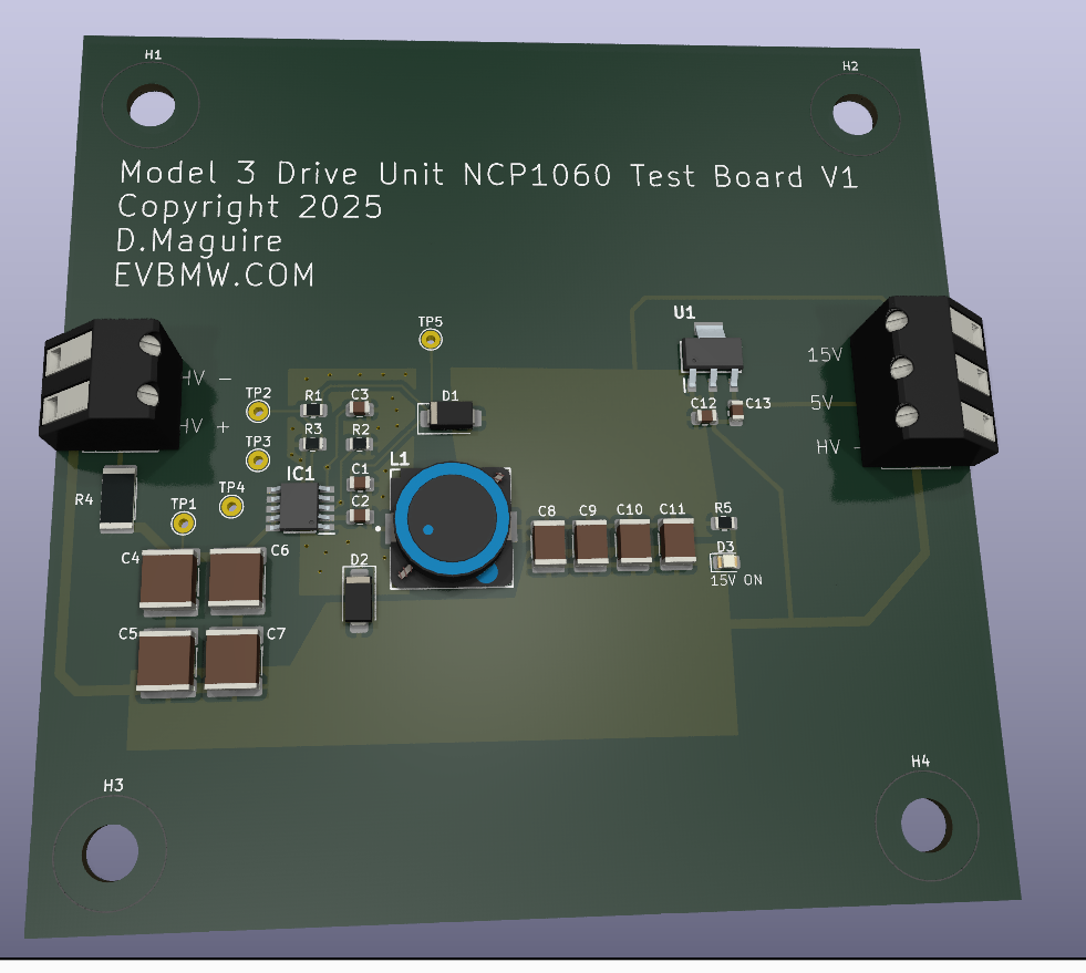

That looks spicy. Might it be an idea to put that on a small mod board to test out before going for broke on one of your giant PCBs?

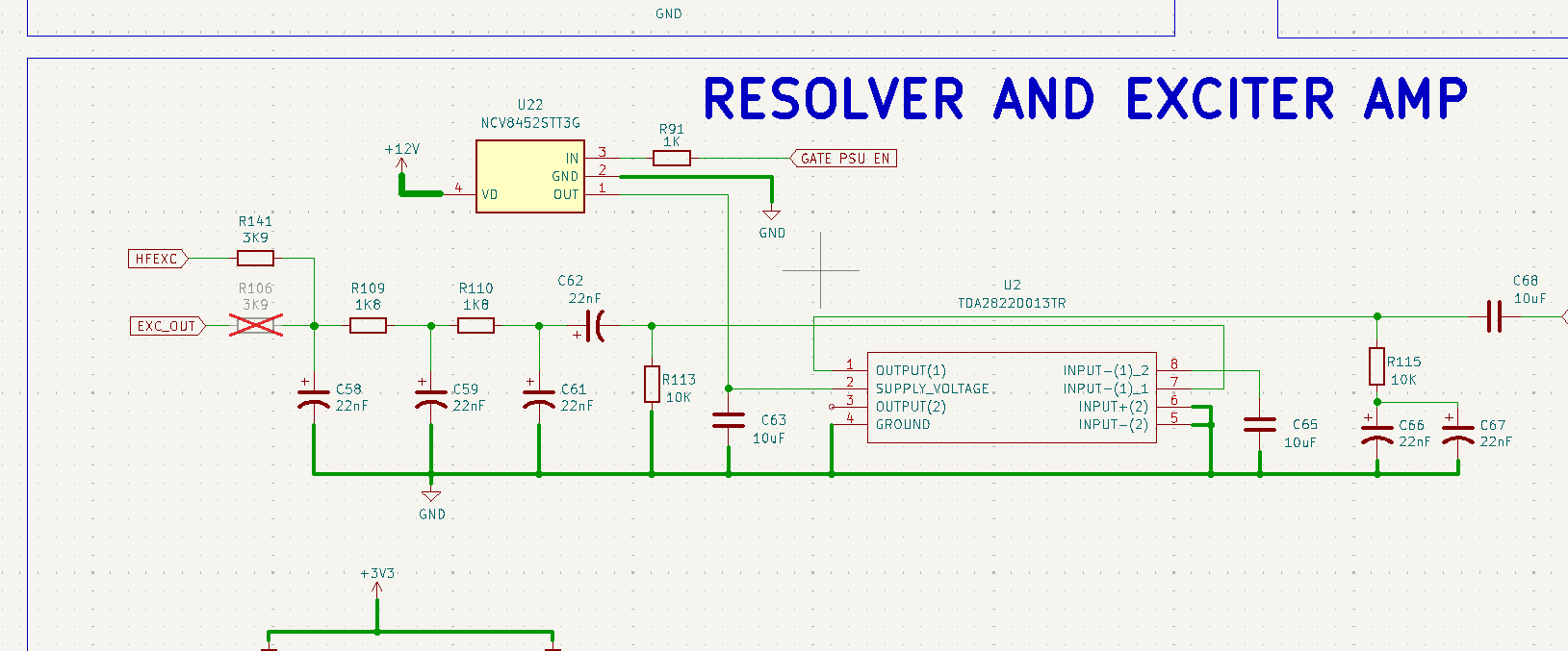

I'll do that Dave. Good plan. Have added a NCV8452 high side load switch to the resolver amp. This allows it to be powered down by the MCU for sleep mode.

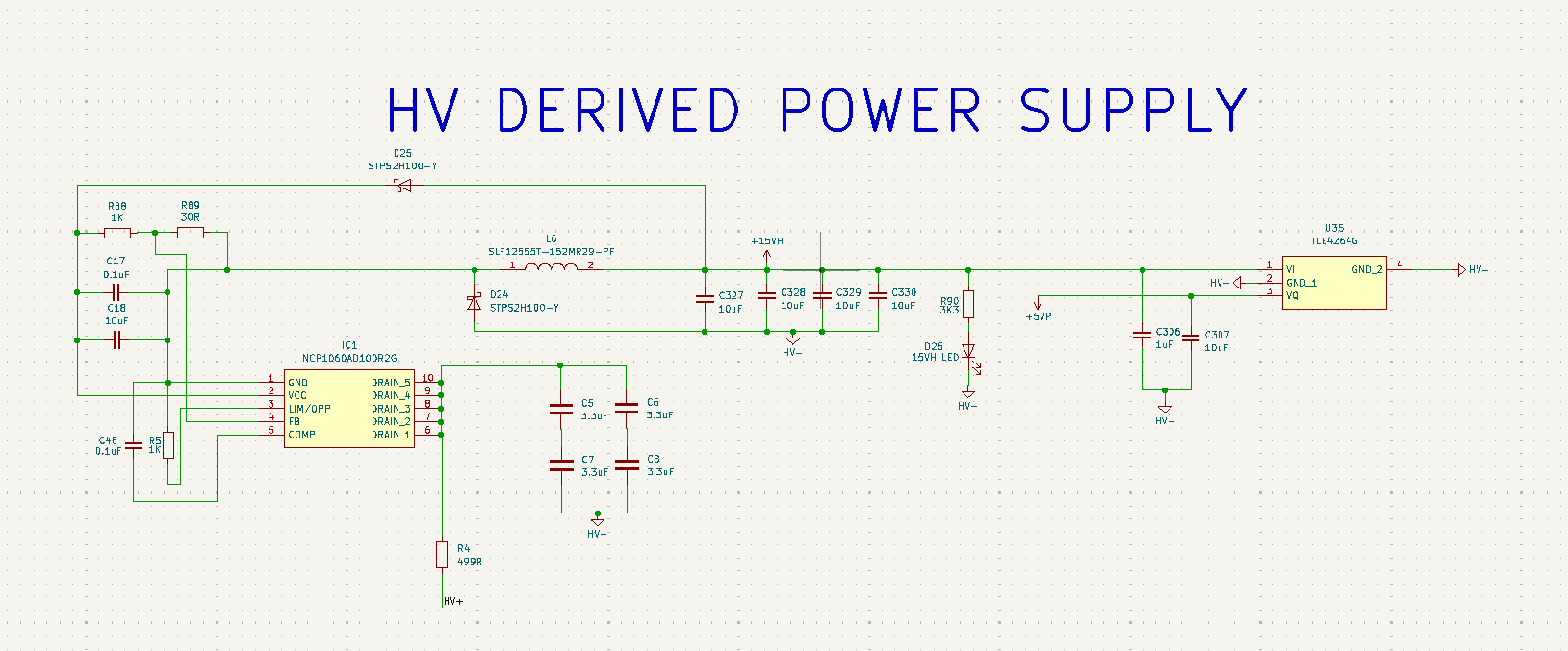

A crude test board to see if the NCP1060 circuit behaves.

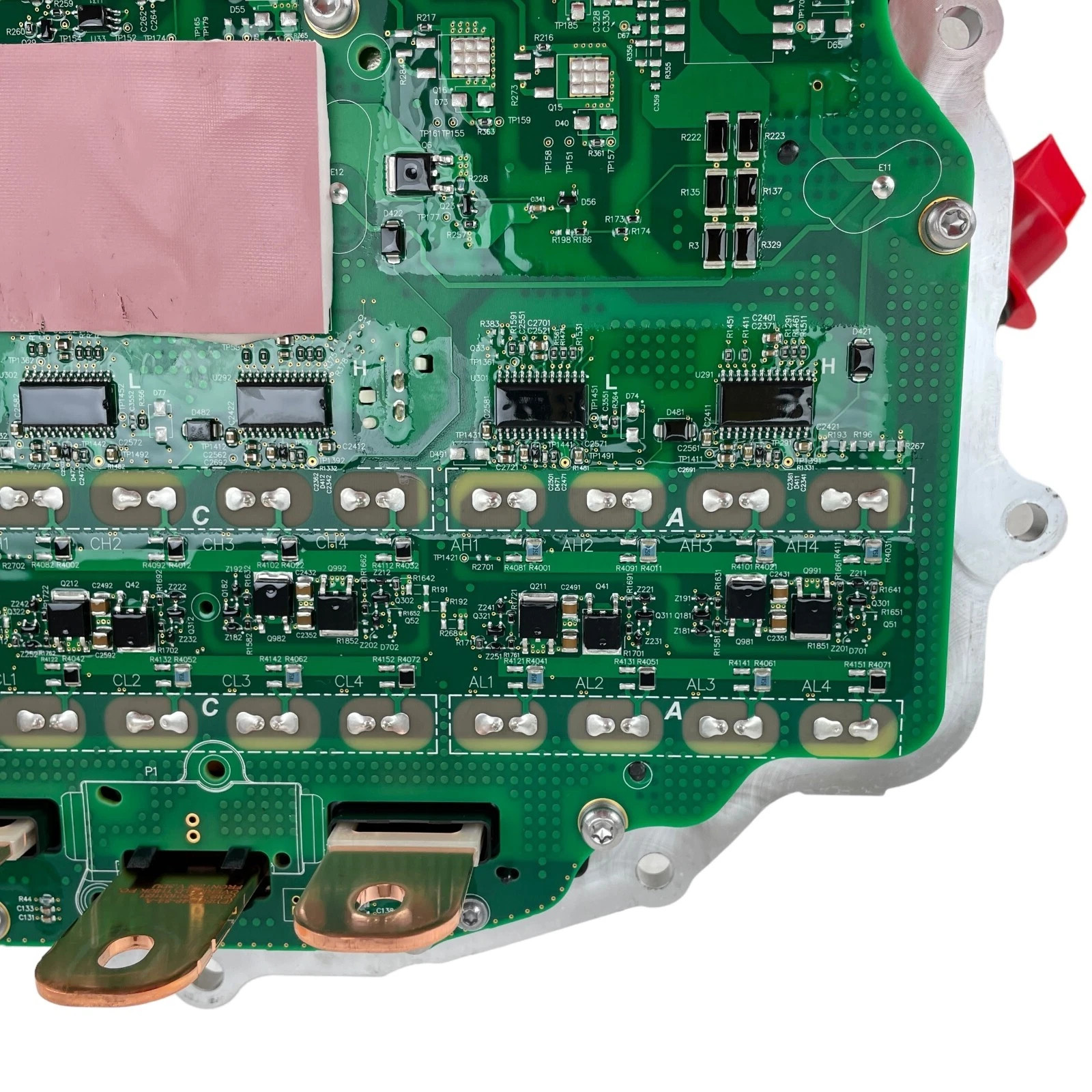

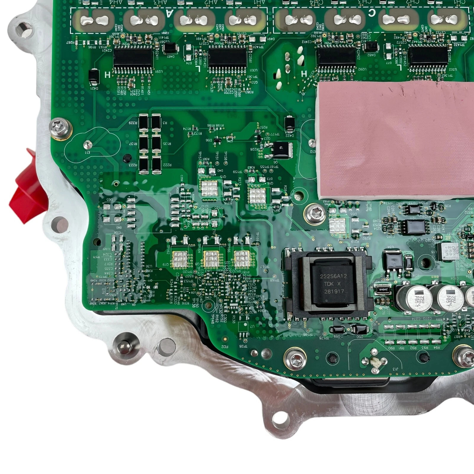

Does anyone have access to a board like the one in the pic? I believe it is fro ma "960" inverter.

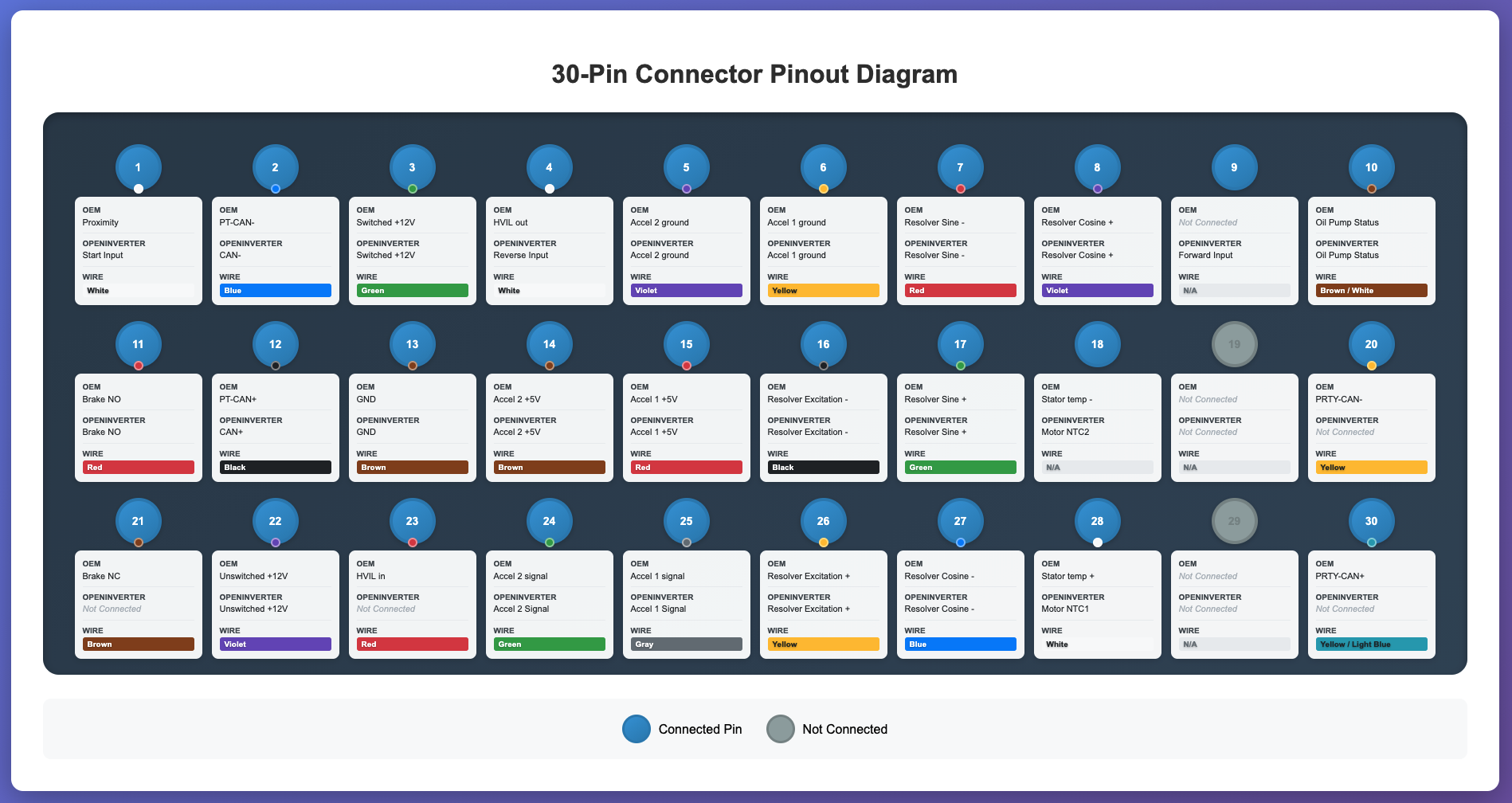

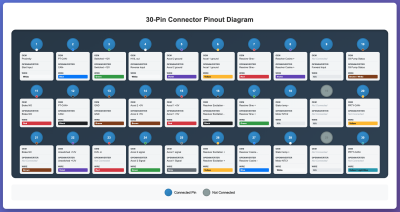

I've spotted a small error in the diagram. Pin 1 is Proximity Input on the OEM but is the Start Input on the OI board. Would be nice to get an update.outlandnish wrote: ↑Tue Nov 18, 2025 12:01 am Here's the OEM to OpenInverter pin mapping if anyone needs it:

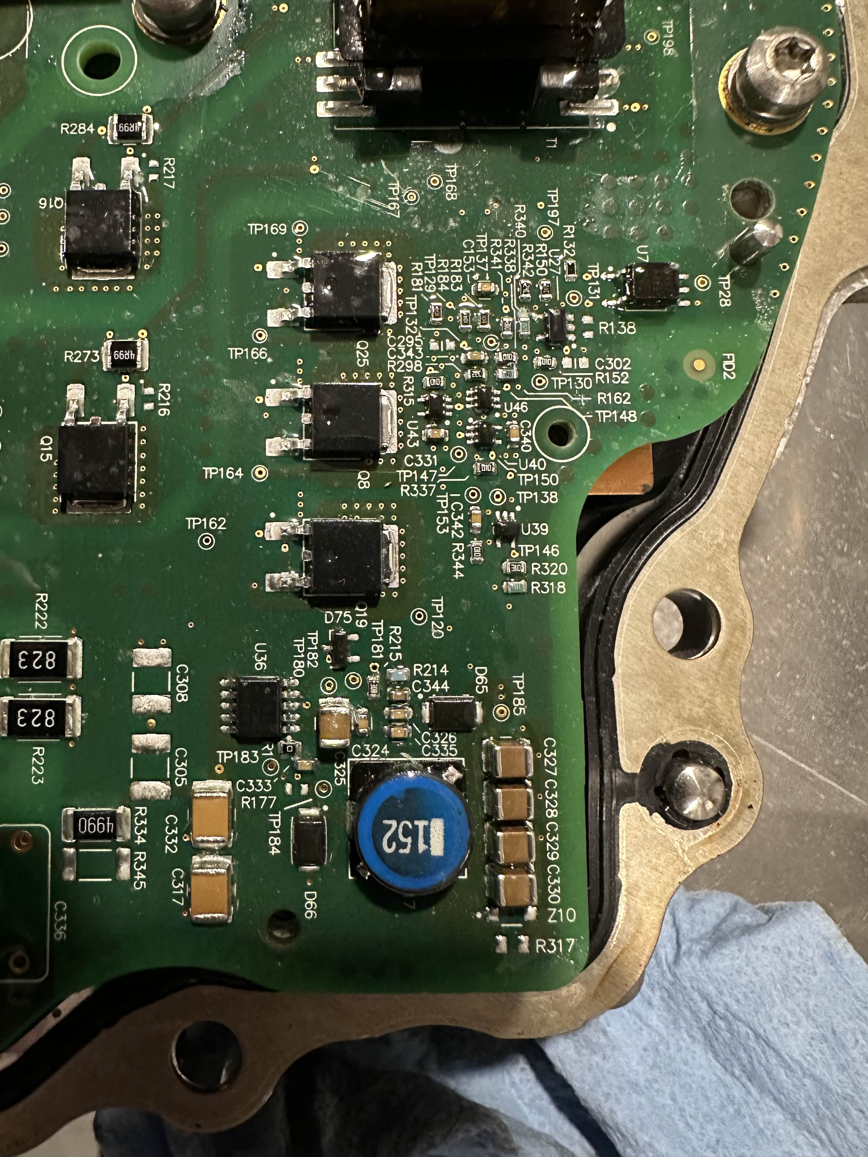

i have this inverter and also the one that have these parts populated, i have almost all of the different types (They all have a problem, that's why I have them, but perhaps they can still be used for reverse engineering.). what information from it are you looking for? or do you want me to send one to you?Jack Bauer wrote: ↑Mon Dec 01, 2025 12:46 pm A crude test board to see if the NCP1060 circuit behaves.

Oh good call out! Let me update that.davefiddes wrote: ↑Mon Dec 01, 2025 6:20 pm I've spotted a small error in the diagram. Pin 1 is Proximity Input on the OEM but is the Start Input on the OI board. Would be nice to get an update.![]()
On that note, is the idea for the next board iteration to have HVIL? We may want to move the pins that re-use those to the unused pins on the connector instead so we have that option for the future.

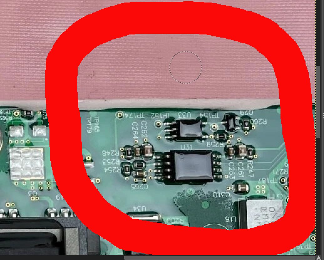

@Nathaniel, the board scan is perfect thanks. I can highlight on a few pictures the measurements I need if thats ok?

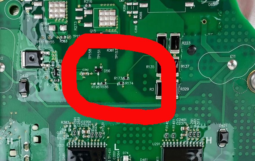

On the "960" board with the missing parts, could you measure the values of R173 , R174 , R186 as circled in red? I suspect D56 is a zener diode. Could you measure its voltage? will probably need to be removed to measure properly.
- Posts: 4006
- Been thanked: 1136 times
Also on the 960 ,and this will be the tricky part, U31 gets its HV side 5v supply via R243. I need to know where R243 connects and how they derive the HV side 5v on this revision.
- Posts: 4006

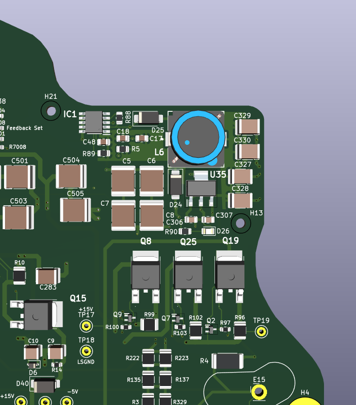

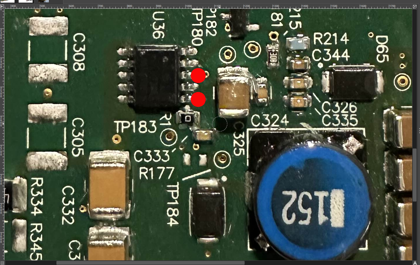

And finally on the board that uses the NCP1060 , I need to know how pins 3 and 5 of U36 (the NCP1060) connect and what value components are used.
Many thanks. If too much work am happy to pay postage for the boards and return them to you once measurments are complete.

- uhi22
- Posts: 1244
- Has thanked: 245 times
- Been thanked: 684 times
If this is a NCP1060, the red dots are not 3 and 5.
I will do the measurements tomorrow evening, but i have both of the versions of the boards you are looking for. But the u36 ncp1060 i found that only in a older board with the 3D1 and 980 making. Al the newer ones looks different in that part of the board.
