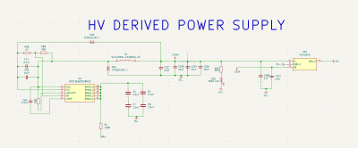

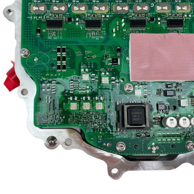

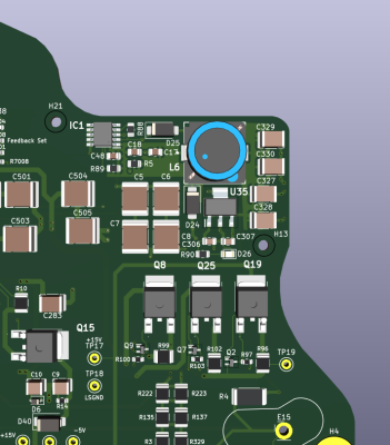

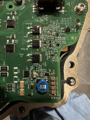

So work on the V3.1 continues. Cleaning up on find from the beta boards as well as implementing some feedback. In doing so i decided to go for broke and have a try at the using the NCP1060 based HV derived power supply used on some of the newer revs of M3 board. As I don't have one of these boards am working from pictures and the NCP1060 datasheet. Unlike the the older boards that used the Viper16 chip and custom transformer, this version is all off the shelf at JLC.

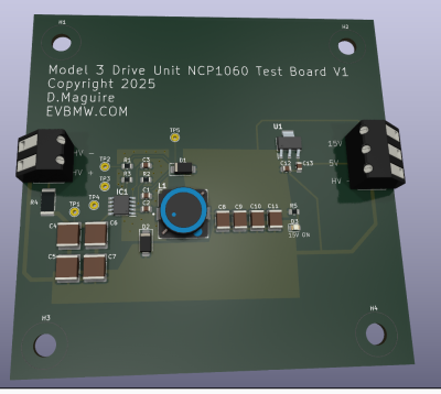

That looks spicy. Might it be an idea to put that on a small mod board to test out before going for broke on one of your giant PCBs?

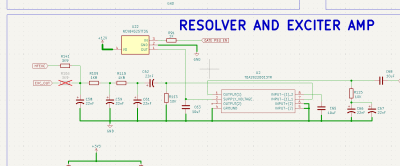

I'll do that Dave. Good plan. Have added a NCV8452 high side load switch to the resolver amp. This allows it to be powered down by the MCU for sleep mode.

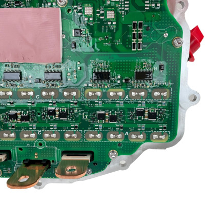

A crude test board to see if the NCP1060 circuit behaves.
Does anyone have access to a board like the one in the pic? I believe it is fro ma "960" inverter.

i have this inverter and also the one that have these parts populated, i have almost all of the different types (They all have a problem, that's why I have them, but perhaps they can still be used for reverse engineering.). what information from it are you looking for? or do you want me to send one to you?Jack Bauer wrote: ↑Mon Dec 01, 2025 12:46 pm A crude test board to see if the NCP1060 circuit behaves.
also i finished the new laserscan 3D scan DXF pcb export, this one is very precise and I have very high confidence that this is 100% correct.
