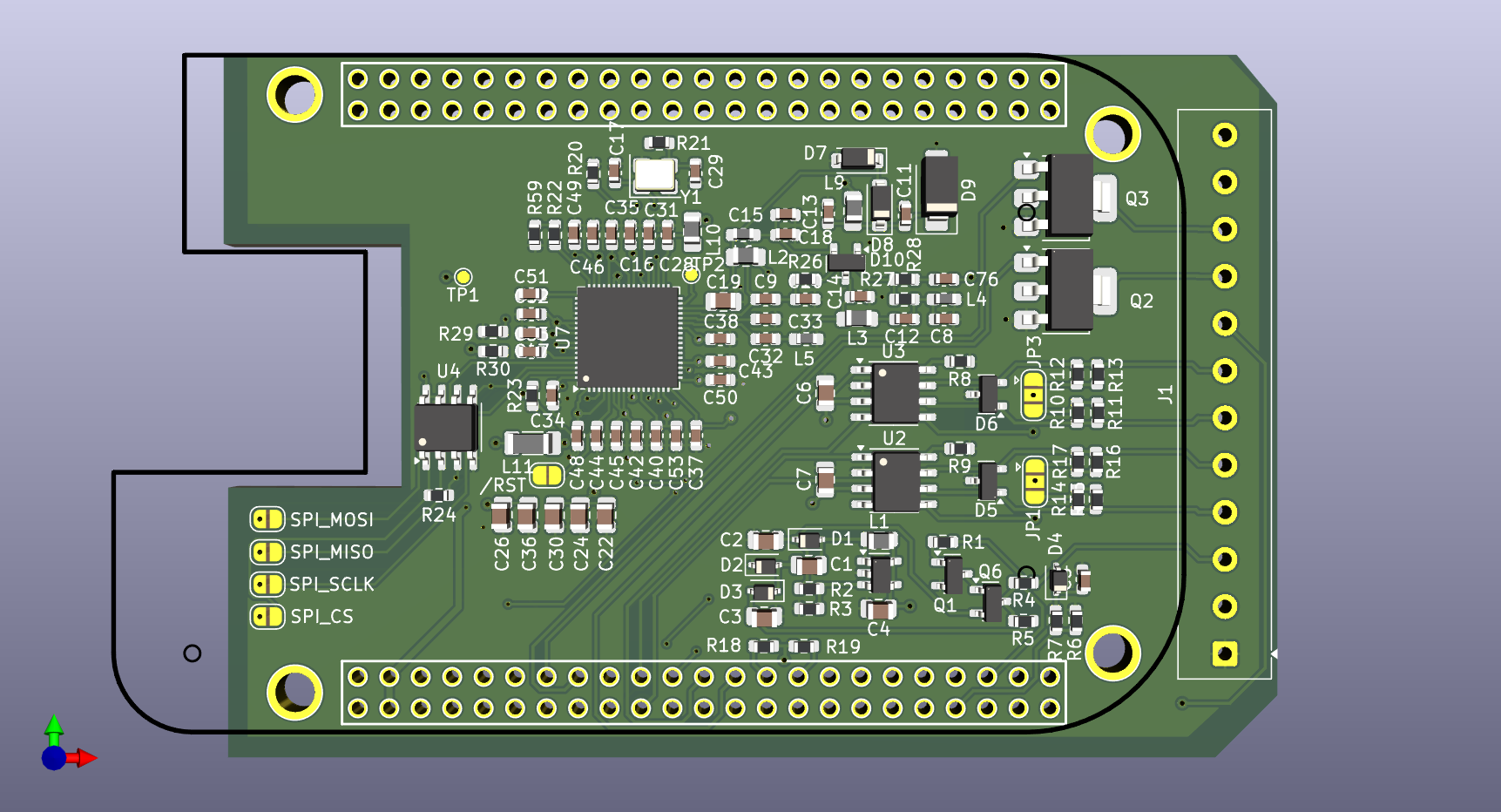

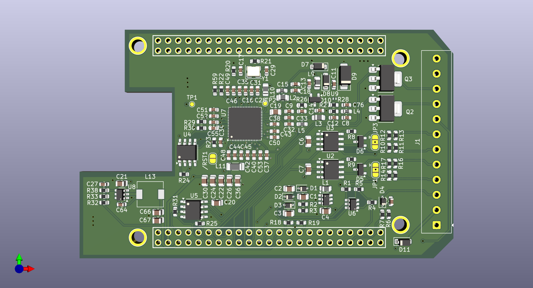

As mentioned here I've always wanted to create an all-in-one energy controller to clean up the mess in my basement. It is based on the popular BeagleBone Black or Green, so it's called a "cape".
Hardware-wise it is mainly communication stuff. The task of the thing is to control various energy conversion equipment such as
- PV inverters
- Batteries (or BMSes to be precise)
- CCS
- Relays
It also talks to web services such as spot market price providers, data loggers and of course has infinite connectivity over Wifi or Ethernet.
I pretty much copied the hardware that I currently use so the interfaces are
- 2x CAN
- 1x PLC for CCS charging, including CP signalling
- 2 relay drivers
- Input for push button with LED (button just shorts out LED current
I might add RS485 as well as I have only used up 10 of 12 screw terminals.
So far this is how it looks
PLC part still to be done.
Source code for control software is here: https://github.com/jsphuebner/esp-egyco ... ry-control

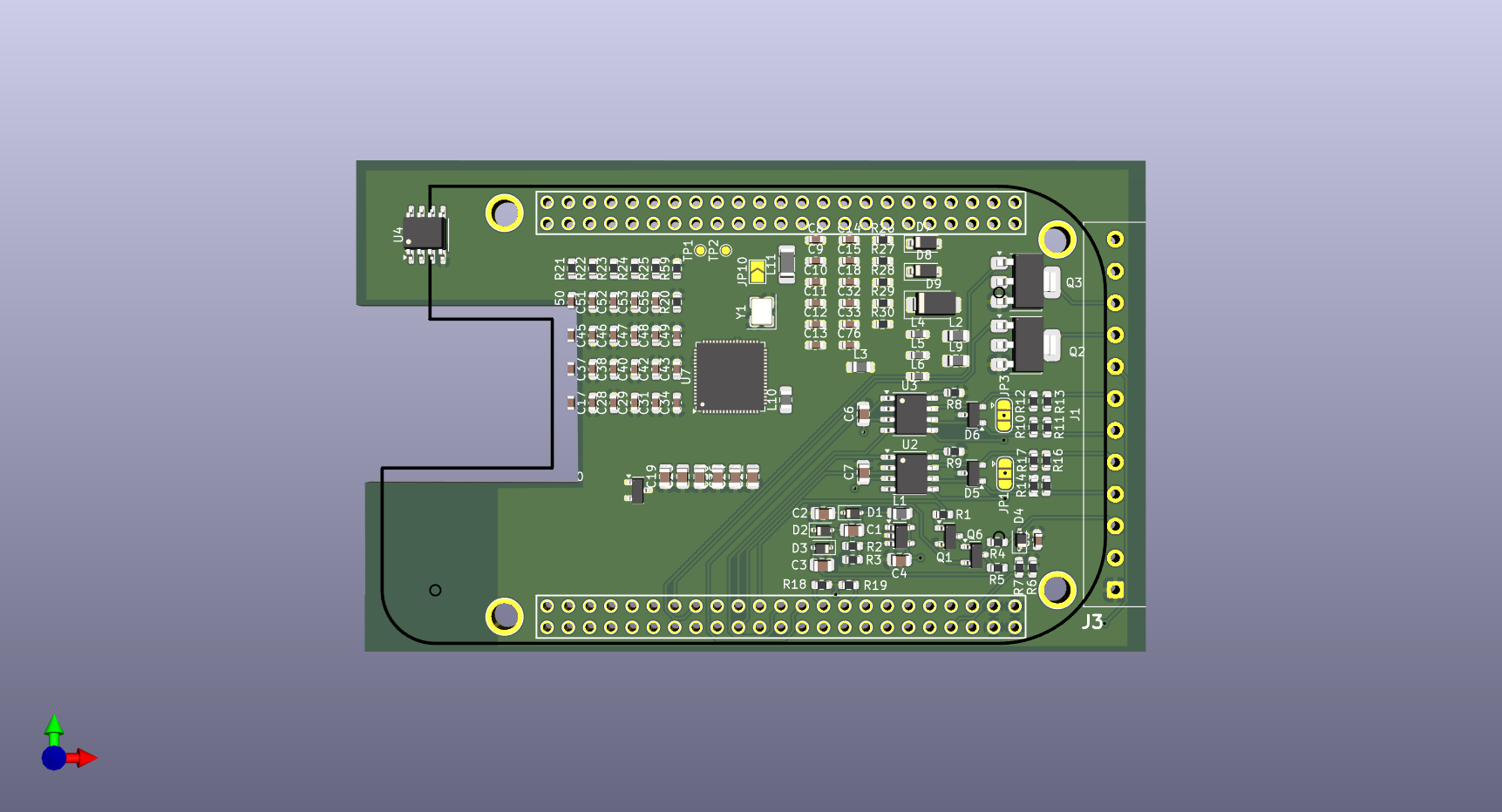

First cut done, only RS485 missing
SPI flash can be connected to the SPI bus for initial programming by the BeagleBone itself

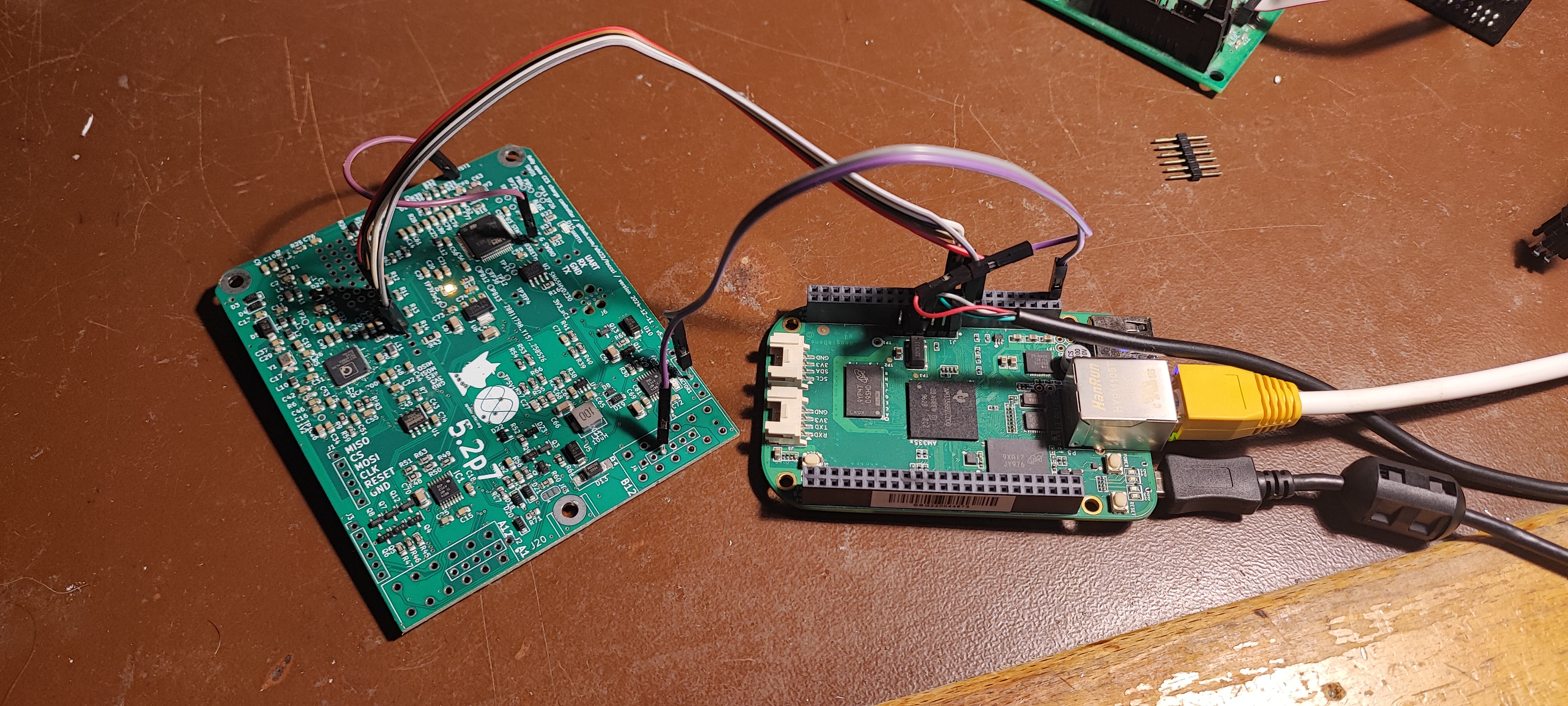

Before ordering I wanted to make sure that I can talk to the QCA with the linux kernel.
It is a bit of a palaver.
Here's the howto running QCA7000 on BeagleBone via SPI

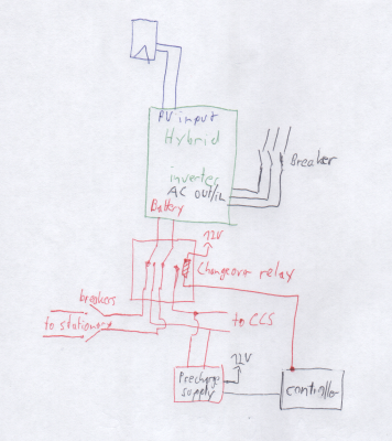

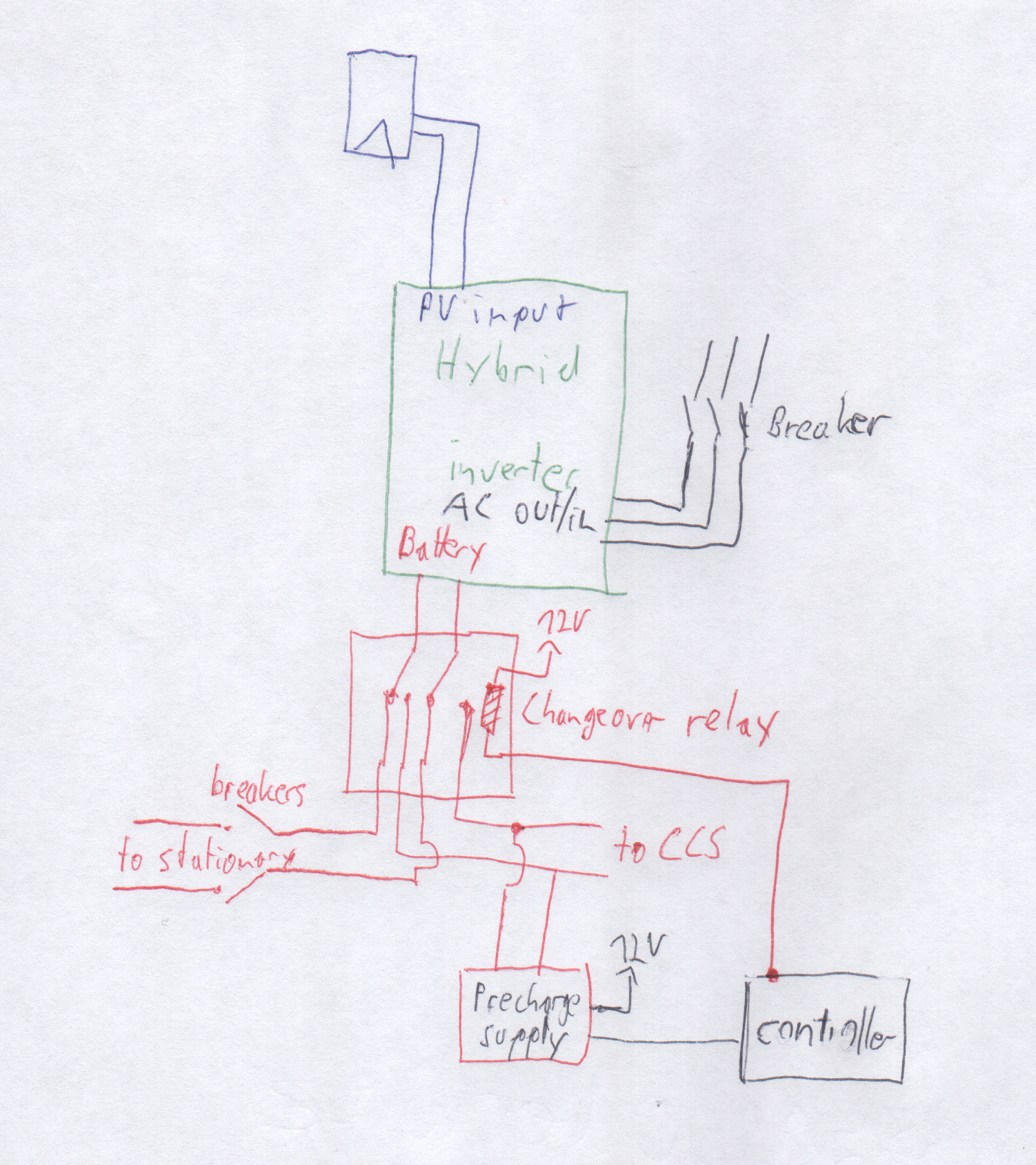

Super interesting subject ! Could this be used to do bi-directional charging from solar / to house ?
uhi22
Posts: 1244
Location: Ingolstadt/Germany
Has thanked: 244 times
Been thanked: 684 times
Re: Energy Controller including CCS interface
Post by uhi22 »
This is exactly the topic. However, this is just the control box, it needs an additional power device like a hybrid solar inverter.

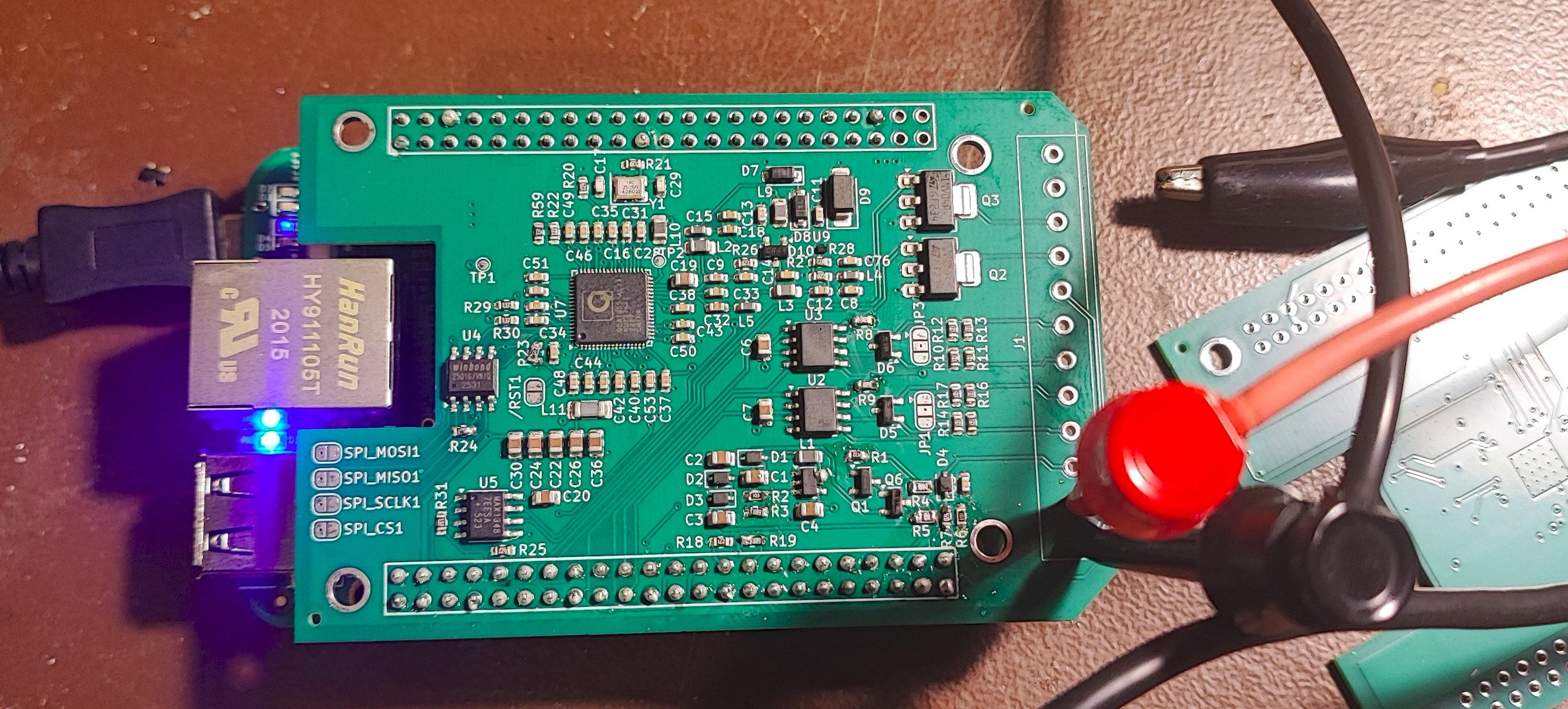

And it's on the table
Almost worked out of the box, some resistors were not fitted and there ist a minor mistake in the pin mapping of the boost converter that makes +-12V for CP PWM.
With that fixed we have PWM
and the QCA chip is detected and communicates
Currently no firmware on the flash, I'm trying to figure out whether I can flash it via plctools without messing with the solder jumpers. If anyone knows where to find a firmware image for the QCA7005 or how to extract it from uhis binary, let me know
https://github.com/uhi22/Ioniq28Investi ... _33_79.bin

Flashed the image directly today, works well with the solder jumpers.
Changed the PIB file for EVSE use and simply flashed with plctool. I had to change more than the 4 items commonly mentioned here, used this script: https://github.com/qca/open-plc-utils/b ... ac/evse.sh
I also changed the MAC address using "modpib -m" as otherwise it's the same as Focccis.
Then started CP PWM, connected to Foccci which woke right up and off we go into CurrentDemand :)
Analog reading of CP PWM divided value reliably detects states A-C
Also tested CAN which also works. Very suspicious, no mistakes? huh

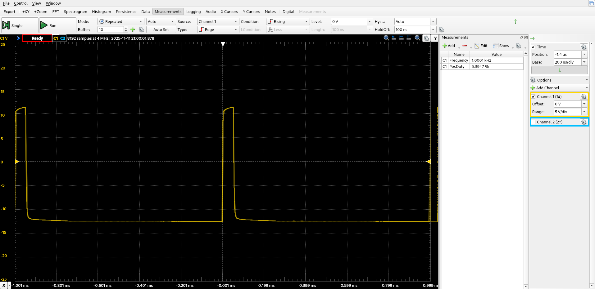

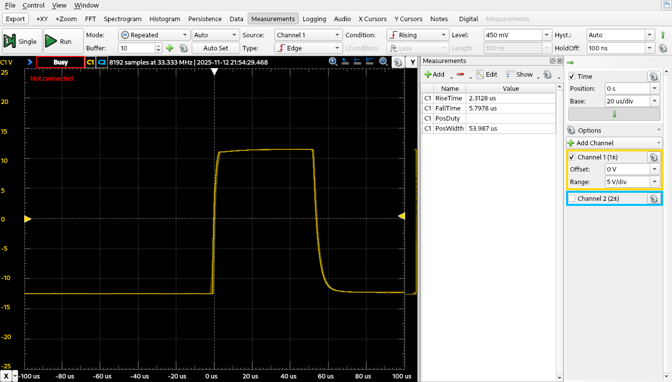

And here's another closeup of the CP PWM slew rate
On V2 will probably change it to TLV1805

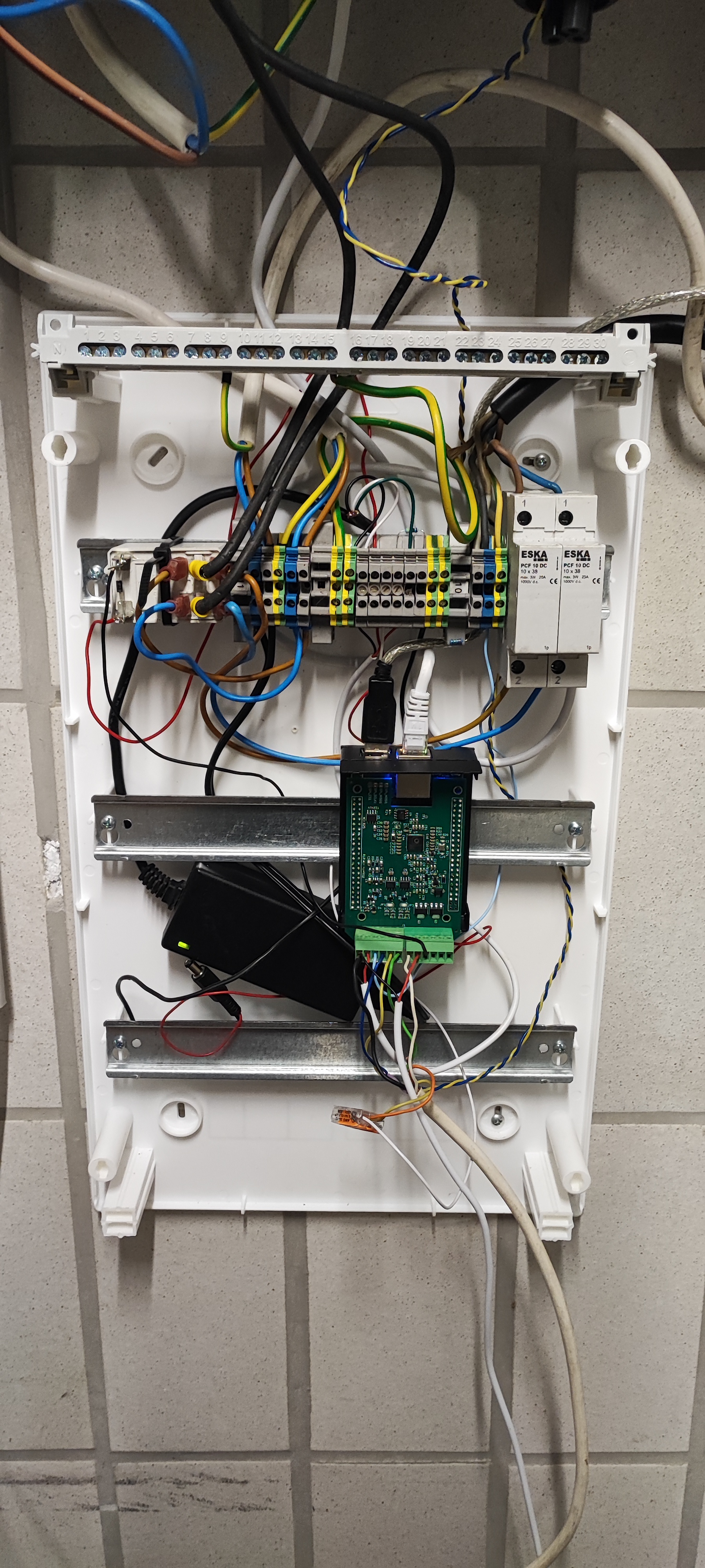

And it's in :)
Just a reminder of what it used to look like
The switch became redundant for now because Ethernet is now only needed for inverter comms.
With a bit of consolidation I could go back to my single DIN rail enclosure

I set up a wiki page https://openinverter.org/wiki/FoccciCape
I've also added the precharge supply back in. I connected a 10uF 400V elcap and a 1M resistor to the output. This gives it a pretty deterministic voltage ramp which I think is also slow enough (0-400V in 6s) so that the vehicle will just report precharge completed.
Will start selling it on the shop soon. Hows interest?
Love how this project combines a whole bunch of open source projects into one.
Would it be possible for you to draw a simple overview diagram of how the energy flows work?
I am not 100% sure how you move the power in and out of the Car and the stationary battery.
Been thanked: 1913 times
Thanks. Would love to base it on something fancy like HomeAssistent but have 0 experience with these platforms. At least now it's very slim.
Tried to make a diagram. You can see that no energy can be exchanged between stationary and car battery. Perhaps you could connect the stationary to a free PV input if you really wanted that option. Not sure if inverters with 2 battery inputs allow exchanging energy between the two?
Posts: 2962
Has thanked: 328 times
Been thanked: 847 times
Thank you for the clarifying diagram.
Ah so you are doing a change over between the two. Which is fine really, unless you are looking to do "cheap" EV charging, but could always just use the AC charging for that.
Of course you could look at a DC-DC stage to link the vehicle via CCS to the battery bank.
I am currently working on Battery Intergrated Chargers with multiple power modules AC/DC and DC/DC. Im sure one could get second hand modules or "abuse" a Hybrid PV inverter some more. Key issues with PV inverters is the referencing they do as they are not galvanically isolated so you have a to be extra careful.

Did some minor changes for V2
It has a 7-20V 28V power supply now and a comparator for PWM generation.
Removed the Flash SPI for now as it can be programmed from the host.
Posts: 2962
johu wrote: Mon Dec 01, 2025 2:55 pm 7-20V power supply now
Can you not go to 30V make it 24V compatible? Lots of industrial gear is 24V.
Does it have reverse polarity protection?
In fact it's the TPS54302 also used on Foccci, so takes 28V. Yes D11 protects against reverse polarity.
