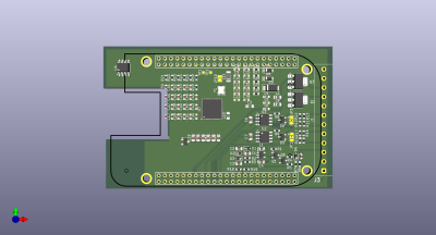

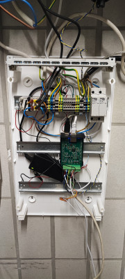

As mentioned here I've always wanted to create an all-in-one energy controller to clean up the mess in my basement. It is based on the popular BeagleBone Black or Green, so it's called a "cape".
Hardware-wise it is mainly communication stuff. The task of the thing is to control various energy conversion equipment such as
- PV inverters
- Batteries (or BMSes to be precise)
- CCS
- Relays
It also talks to web services such as spot market price providers, data loggers and of course has infinite connectivity over Wifi or Ethernet.
I pretty much copied the hardware that I currently use so the interfaces are
- 2x CAN
- 1x PLC for CCS charging, including CP signalling
- 2 relay drivers
- Input for push button with LED (button just shorts out LED current
I might add RS485 as well as I have only used up 10 of 12 screw terminals.
So far this is how it looks PLC part still to be done.
- PV inverters
- CCS
- Relays
- 2x CAN
- 2 relay drivers

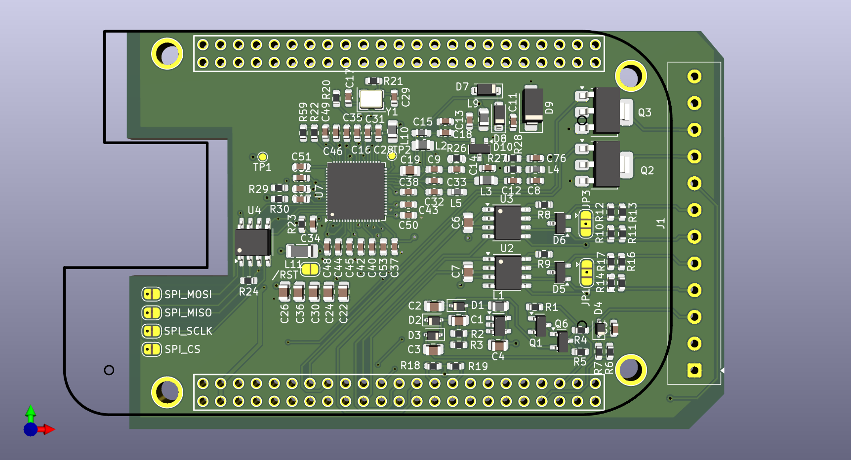

First cut done, only RS485 missing SPI flash can be connected to the SPI bus for initial programming by the BeagleBone itself

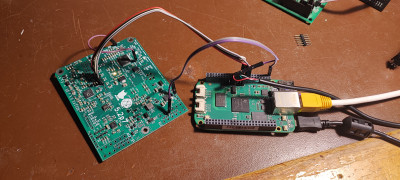

Before ordering I wanted to make sure that I can talk to the QCA with the linux kernel.
It is a bit of a palaver.
Here's the howto running QCA7000 on BeagleBone via SPI

Ultimately you should see
[ 28.949382] qcaspi spi0.0: ver=0.2.7-i, clkspeed=12000000, burst_len=5000, pluggable=0
[ 29.041706] qcaspi spi0.0: Using random MAC address: 56:7b:be:8b:cd:74
> int6klist -v -i eth1
00000000 00 B0 52 00 00 01 AA 38 9F A8 13 32 88 E1 00 00 ..R....8...2....
00000010 A0 00 B0 52 00 00 00 00 00 00 00 00 00 00 00 00 ...R............
00000020 00 00 00 00 00 00 00 00 00 00 00 00 00 00 00 00 ................
00000030 00 00 00 00 00 00 00 00 00 00 00 00 ............
00000000 AA 38 9F A8 13 32 04 65 65 FF FF FF 88 E1 00 01 .8...2.ee.......
00000010 A0 00 B0 52 00 22 25 4D 41 43 2D 51 43 41 37 30 ...R."%MAC-QCA70
00000020 30 35 2D 31 2E 31 2E 30 2E 37 33 30 2D 30 34 2D 05-1.1.0.730-04-
00000030 32 30 31 34 30 38 31 35 2D 43 53 00 CC CC CC CC 20140815-CS.....

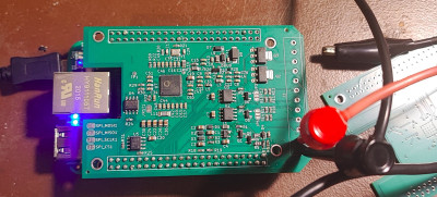

And it's on the table
Almost worked out of the box, some resistors were not fitted and there ist a minor mistake in the pin mapping of the boost converter that makes +-12V for CP PWM.
With that fixed we have PWM and the QCA chip is detected and communicates
Currently no firmware on the flash, I'm trying to figure out whether I can flash it via plctools without messing with the solder jumpers. If anyone knows where to find a firmware image for the QCA7005 or how to extract it from uhis binary, let me know
https://github.com/uhi22/Ioniq28Investi ... _33_79.bin

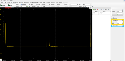

Flashed the image directly today, works well with the solder jumpers.
Changed the PIB file for EVSE use and simply flashed with plctool. I had to change more than the 4 items commonly mentioned here, used this script: https://github.com/qca/open-plc-utils/b ... ac/evse.sh
I also changed the MAC address using "modpib -m" as otherwise it's the same as Focccis.

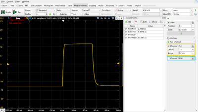

Then started CP PWM, connected to Foccci which woke right up and off we go into CurrentDemand
Analog reading of CP PWM divided value reliably detects states A-C
Also tested CAN which also works. Very suspicious, no mistakes? huh

Re: Energy Controller including CCS interface
And here's another closeup of the CP PWM slew rate
On V2 will probably change it to TLV1805

And it's in
Just a reminder of what it used to look like
The switch became redundant for now because Ethernet is now only needed for inverter comms.
With a bit of consolidation I could go back to my single DIN rail enclosure

haha, managed to boot strap the SPI flash without solder jumpers on my second module
All you need is the firmware image from uhis repo (https://github.com/uhi22/Ioniq28Investi ... _33_79.bin) and open-plc-utils.
We start with
See how it says "BootLoader"? That's what we want.
Then do
First command results in 3 files from the "file system" of the flash. We merge them back together.
Then we splice 64k from the beginning of the file which brings us to the firmware "partition" and repeat the same trick. Same with the PIB file which we modify for EVSE use.
And now we get
So the new firmware and the new MAC address from the PIB file.
We start with
> int6klist -v
< 00000000 00 B0 52 00 00 01 AA 38 9F A8 13 32 88 E1 00 00 ..R....8...2....
00000000 AA 38 9F A8 13 32 00 B0 52 00 00 01 88 E1 00 01 .8...2..R.......
00000010 A0 00 B0 52 00 06 0B 42 6F 6F 74 4C 6F 61 64 65 ...R...BootLoade
00000020 72 00 00 00 00 00 00 00 00 00 00 00 00 00 00 00 r...............
00000030 00 00 00 00 00 00 00 00 00 00 00 00 00 00 00 00 ................
00000040 00 00 00 00 00 00 00 00 00 00 00 00 00 00 00 00 ................
00000050 00 00 00 00 00 00 00 00 7C 58 1B 00 00 00 00 00 ........|X......
00000060 01 00 00 00 3F 00 00 00 00 00 00 00 ....?.......
00:B0:52:00:00:01
Then do
nvmsplit -v CCM_FlashDump_SpiFlash_2MB_Ioniq_00_33_79.bin
nvmmerge CCM_FlashDump_SpiFlash_2MB_Ioniq_00_33_79-0* > softloader.nvm
tail -c +65537 CCM_FlashDump_SpiFlash_2MB_Ioniq_00_33_79.bin > firmware.bin
nvmsplit firmware.bin
nvmmerge firmware-* > firmware.nvm
tail -c +917505 CCM_FlashDump_SpiFlash_2MB_Ioniq_00_33_79.bin > pib.bin
nvmsplit pib.bin
nvmmerge pib-0* > evse.pib
setpib evse.pib 74 hfid "EVSE"
setpib evse.pib F4 byte 2
setpib evse.pib 1653 byte 2
setpib evse.pib 1C98 long 10240 long 102400
setpib evse.pib 1F80 byte 0
setpib evse.pib 16D2 byte 0
setpib evse.pib 16D3 byte 1
modpib -M 04:65:65:FF:FF:00 evse.pib
plcboot -F -S softloader.nvm -N firmware.nvm -P evse.pib
And now we get
> int6klist -v
00000000 AA 38 9F A8 13 32 04 65 65 FF FF 00 88 E1 00 01 .8...2.ee.......
00000040 CC CC CC CC CC 00 00 00 00 00 00 00 00 00 00 00 ................
00000050 00 00 00 00 00 00 00 00 00 00 00 00 00 00 00 00 ................
00000060 00 00 00 00 00 00 00 00 00 00 00 00 00 00 00 00 ................
00000070 00 00 00 00 00 00 00 00 00 00 00 00 00 00 00 00 ................
00000080 00 00 00 00 00 00 00 00 00 00 00 00 00 00 00 00 ................
00000090 00 00 00 00 00 00 00 00 00 00 00 00 00 00 00 00 ................
000000A0 00 00 00 00 00 00 00 00 00 00 00 00 00 00 00 00 ................
000000B0 00 00 00 00 00 00 00 00 00 00 00 00 00 00 00 00 ................
000000C0 00 00 00 00 00 00 00 00 00 00 00 00 00 00 00 00 ................
000000D0 00 00 00 00 00 00 00 00 00 00 00 00 00 00 00 00 ................
000000E0 00 00 00 00 00 00 00 00 00 00 00 00 00 00 00 00 ................
000000F0 00 00 00 00 00 00 00 00 00 00 00 00 00 00 00 00 ................
00000100 00 00 00 00 00 00 00 00 00 00 00 00 00 00 00 00 ................
00000110 00 00 00 00 00 7C 58 1B 00 00 00 00 00 01 00 00 .....|X.........
00000120 00 3F 00 00 00 00 00 00 00 .?.......
04:65:65:FF:FF:00
