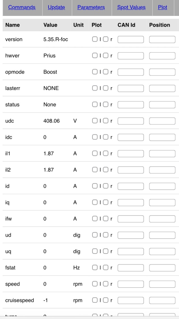

I've got a 100s pack, so I decided to give it a go. I've got everything wired up (including my charge port!). But when I plug it in, I'm not getting any current to the pack, and just a slight rhythmic click from the buck/boost converter.
I'm wondering if I need to run through the other current sensor? Right now i believe I'm running though il2.

I checked to make sure I was getting power into the inverter- I have AC voltage going into the rectifier, and dc coming out (if it's disconnected from the inverter). With everything hooked up, I'm seeing the low side of the buck/boost cycling between ~350V and ~400V on the multimeter. I'm getting the same reading with the inverter in run mode. my battery voltage is sitting about 408V right now, so it seems like the booster isn't boosting. Attached are my charging parameters and spot values. Any direction would be greatly appreciated, I feel like I've hit a wall and don't know what to try next.

Re: Doing useful things with the Prius Gen2 buck/boost converter
huh. I'm also not getting output from my DC-DC converter. I swapped in the converter from my other inverter with the same results. some clicking, but it doesn't seem to be working.
Edit so I’m not just replying to myself: I went back and checked my wiring (and soldering) and I have good continuity all the way from the pin on the IC on the control board to the blue wire on the connector that goes into the buck/boost converter. In run mode, I’m getting 2.5v at the connector to the buck/boost. I tried disconnecting the wires that run down to the ac inverter/dcdc converter, no change in charging. I tried disconnecting where I have my bridge rectifier hooked up, and no change to getting the dc-dc converter to come to life. I’m at a loss as to what to try next, or what I’m missing.

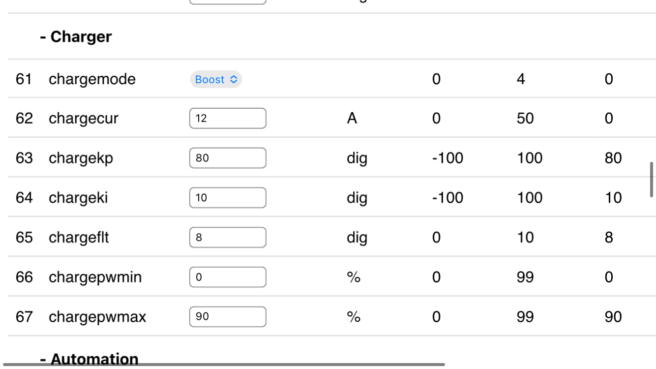

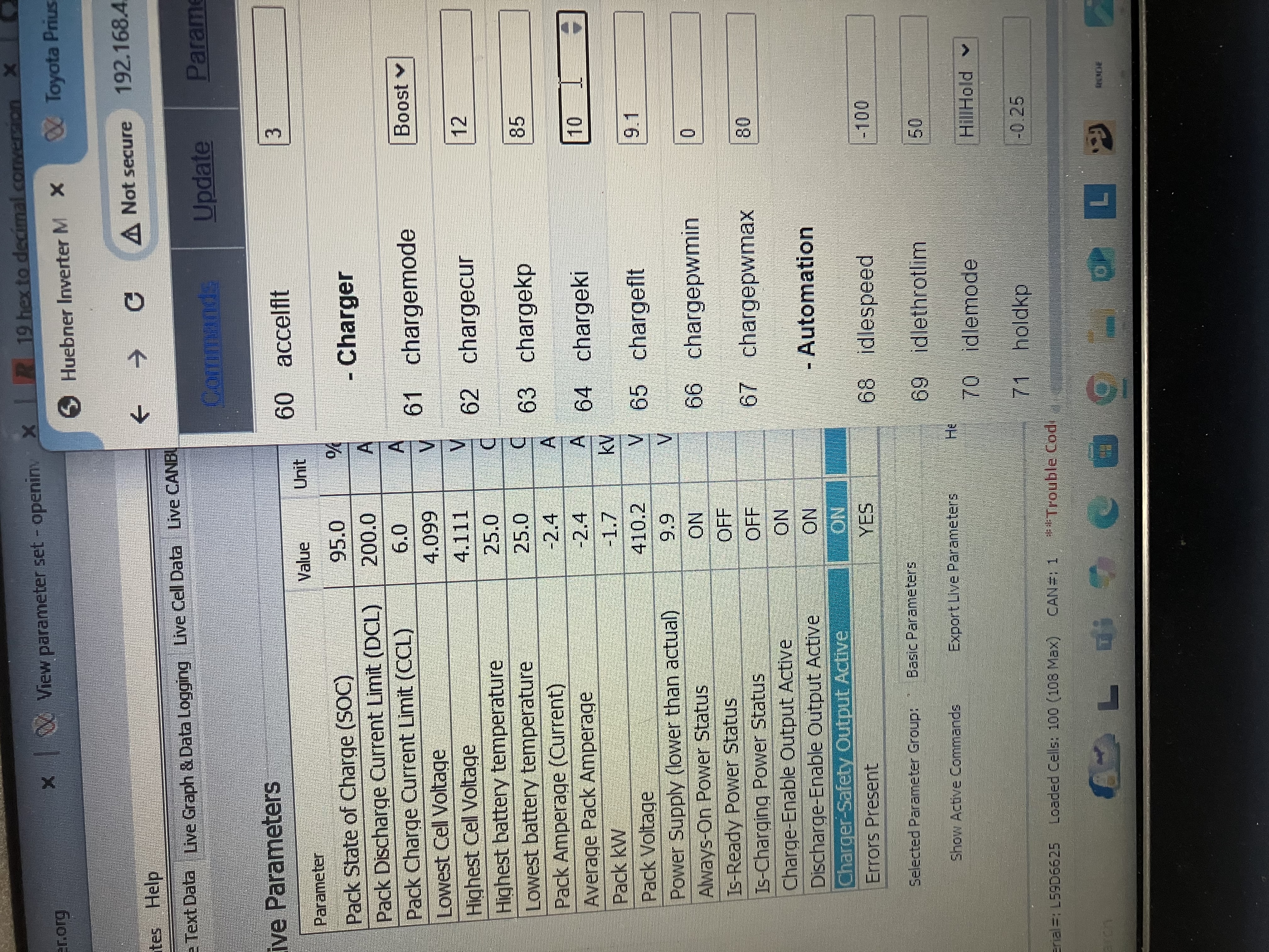

I’m charging!!!!!!!! (Negative pack current on the bms means power is flowing in). I’m using a 1.4kw charger, so 100% efficency would give me about 3.5a at the pack, so I’m hoping I can tune it a bit better.
I went back and watched Johu’s parameters video last night and when he got to charging parameters he said “hardly anyone uses these so we’ll skip them.”
Can I get a brief explanation of tuning chargekp, chargeki, and chargeflt? It looks like my current sensor is really noisy, so I adjusted chargeflt until I got 12a on my clamp meter on my ac input. Not sure if there’s a good process for tuning chargekp or chargeki other than….FAFO?

- Been thanked: 1913 times
Great
You can find some parameters here. Unfortunately the frontend puts most of them into "Regen"
https://openinverter.org/parameters/view.html?id=29
chargeki is not so critical, leave it at 10.
chargekp in conjunction with chargeflt tunes the ability of the controller to keep up with the sinusoidal shape, i.e. do some PFC. More chargekp and less chargeflt results in better tracking but also more noise. High chargeflt and low chargekp results in low noise, poor power factor

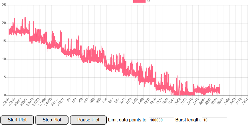

I’ve made enough progress to make a video one it: Boost Charging with the Gen 2 Prius Inverter
I’ve also now got a cooling system, so as soon as I can run the battery down a bit, I can try to do some more tuning.
Brilliant, cool to see someone actually having some success in pursuing that path
Speaking of derating it will cut back before reaching udcmax just like it would under regen. You can also setup some CAN mapping between Orion and the inverter to modify the chargecur parameter.
As for efficiency I'd expect it to go up with higher power. Right now the idle draws eat into it quite badly. Since in the Audi I never noticed any significant warming it must be quite efficient at the 3 kW I limit it to.
