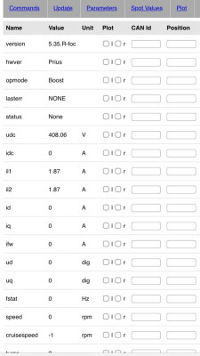

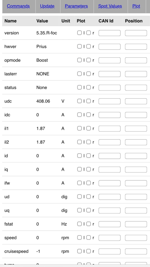

Reporting back....I gained access to the MG1 current sensors, and ran a piece of wire though them, hooked it up to my benchtop power supply, and ran varying amounts of current though it to see what it would do. Put the inverter in boost charge mode and got some really odd numbers back. I've attached a screenshot of the graph. I started at 10 amps on the power supply, and stepped down in 1 amp increments to zero. At 10 amps it was reading about 17 amps, and stepped down proportionally, but at 0A, it bumped back up, which seems odd. I'm not sure if I like what I'm seeing, and figured I should seek adult supervision.
I also had one of those "lying in bed" realizations that I wouldn't be able to charge my battery below the rectified mains voltage...but is that Vpeak or the average Vdc? If it's peak, I'm not sure there's much point in me continuing on with this, since my minium battery voltage would be ~250V.

Re: Doing useful things with the Prius Gen2 buck/boost converter
I've got a 100s pack, so I decided to give it a go. I've got everything wired up (including my charge port!). But when I plug it in, I'm not getting any current to the pack, and just a slight rhythmic click from the buck/boost converter.
I'm wondering if I need to run through the other current sensor? Right now i believe I'm running though il2.

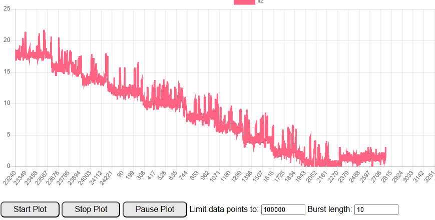

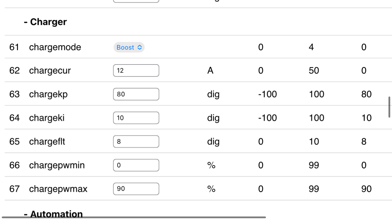

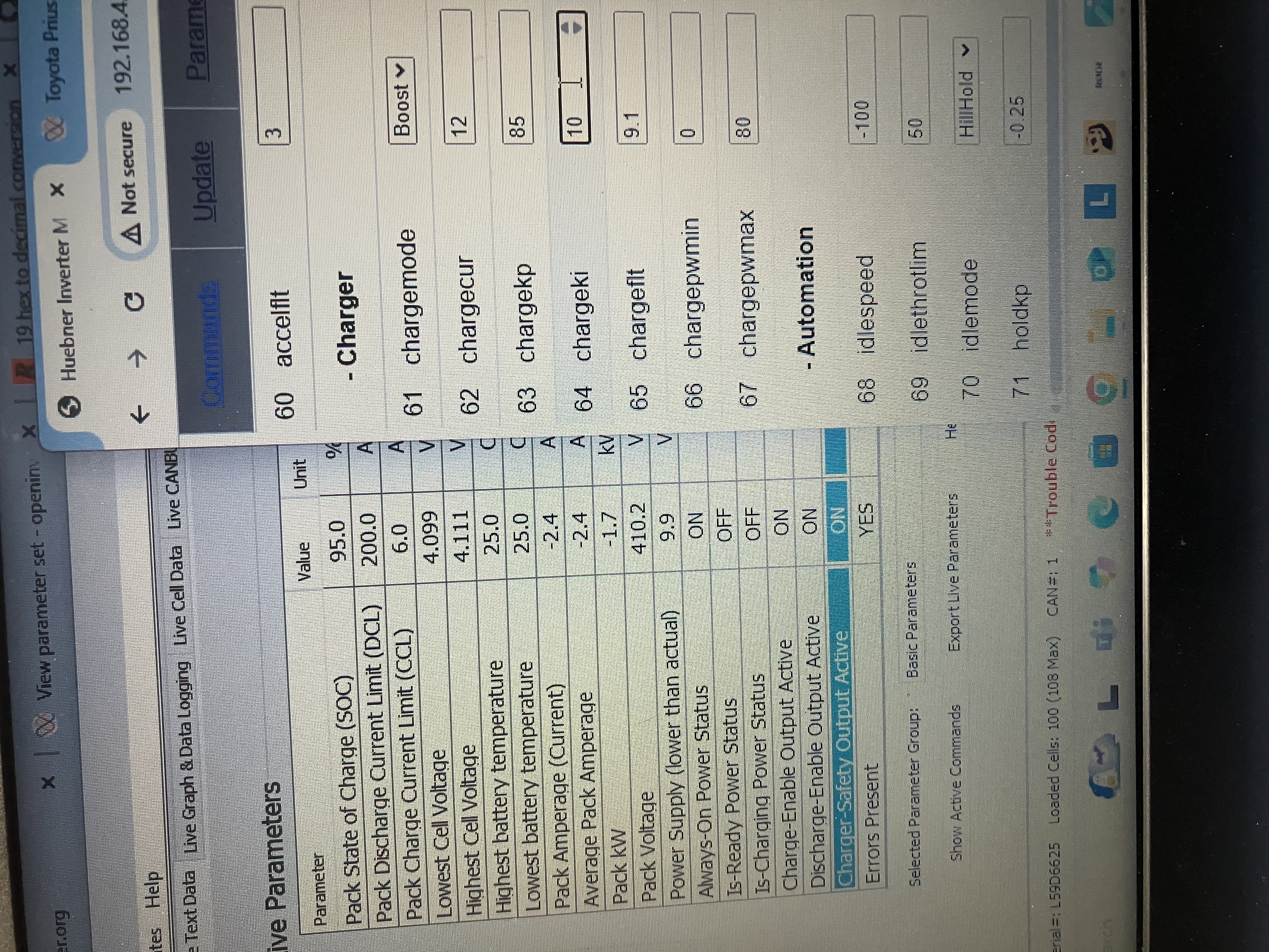

I’m charging!!!!!!!! (Negative pack current on the bms means power is flowing in). I’m using a 1.4kw charger, so 100% efficency would give me about 3.5a at the pack, so I’m hoping I can tune it a bit better.
I went back and watched Johu’s parameters video last night and when he got to charging parameters he said “hardly anyone uses these so we’ll skip them.”
Can I get a brief explanation of tuning chargekp, chargeki, and chargeflt? It looks like my current sensor is really noisy, so I adjusted chargeflt until I got 12a on my clamp meter on my ac input. Not sure if there’s a good process for tuning chargekp or chargeki other than….FAFO?
Great
You can find some parameters here. Unfortunately the frontend puts most of them into "Regen"
https://openinverter.org/parameters/view.html?id=29
chargeki is not so critical, leave it at 10.
chargekp in conjunction with chargeflt tunes the ability of the controller to keep up with the sinusoidal shape, i.e. do some PFC. More chargekp and less chargeflt results in better tracking but also more noise. High chargeflt and low chargekp results in low noise, poor power factor
Ah! I’d looked at that, but didn’t see the relevant parameters under charge, but I see them cleverly hidden now.johu wrote: ↑Fri Oct 31, 2025 3:20 pm Great
I need to get some of my wiring cleaned up (and probably also get a cooling system) before I really try to tune this thing, but I’ll give them a shot then.
I’m also trying to understand how the derating works for charging. Does it start derating at udcmax, or before that? I’m wondering because with a lower charegflt value, I’m seeing less amperage going in on the ac line. If I tweak chargeflt I can get it to match my charge current value, but too much chargeflt and it goes even higher.
