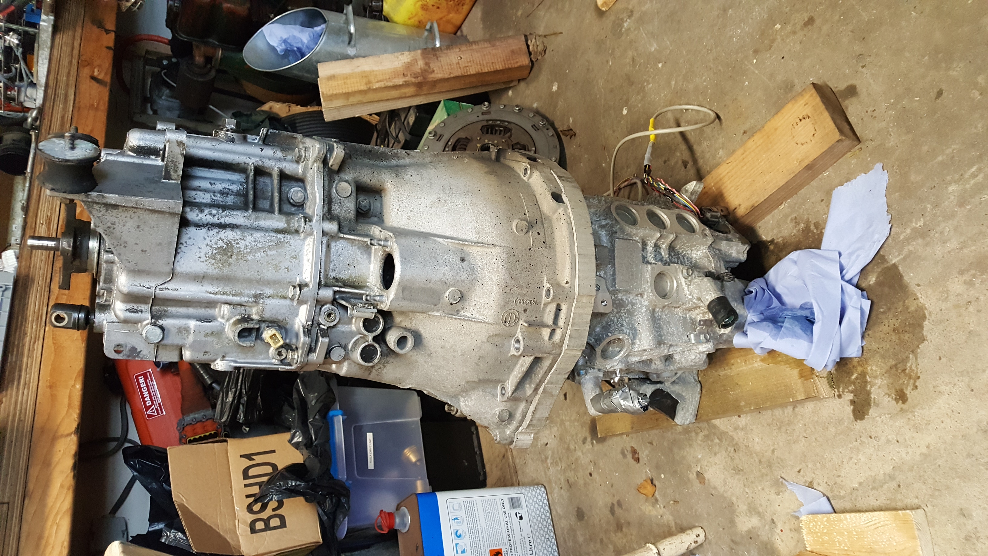

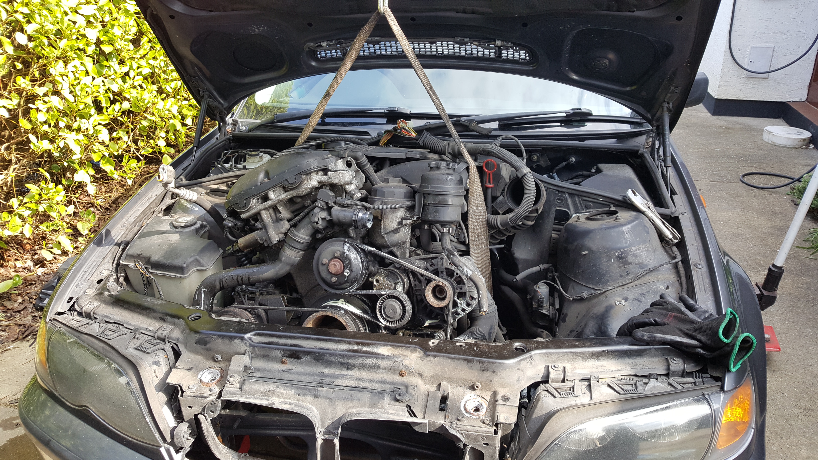

Another day, another EV project. This time we have a 2003 E46 touring formally powered by a mayonaise filled 2.2 petrol engine.
The plan :
Gen 1 Leaf motor
Lexus IS300h inverter
400v of LTO cells

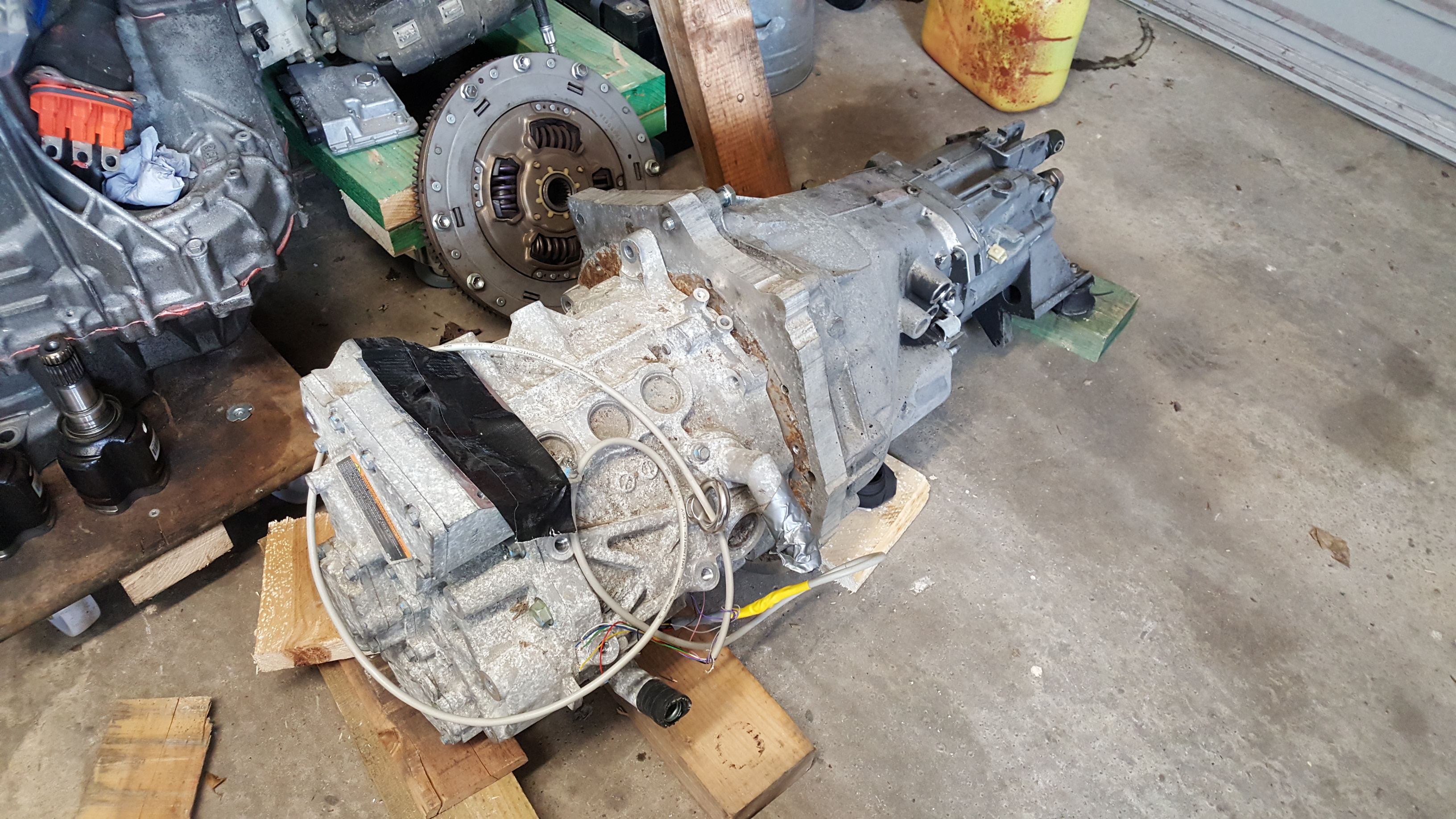

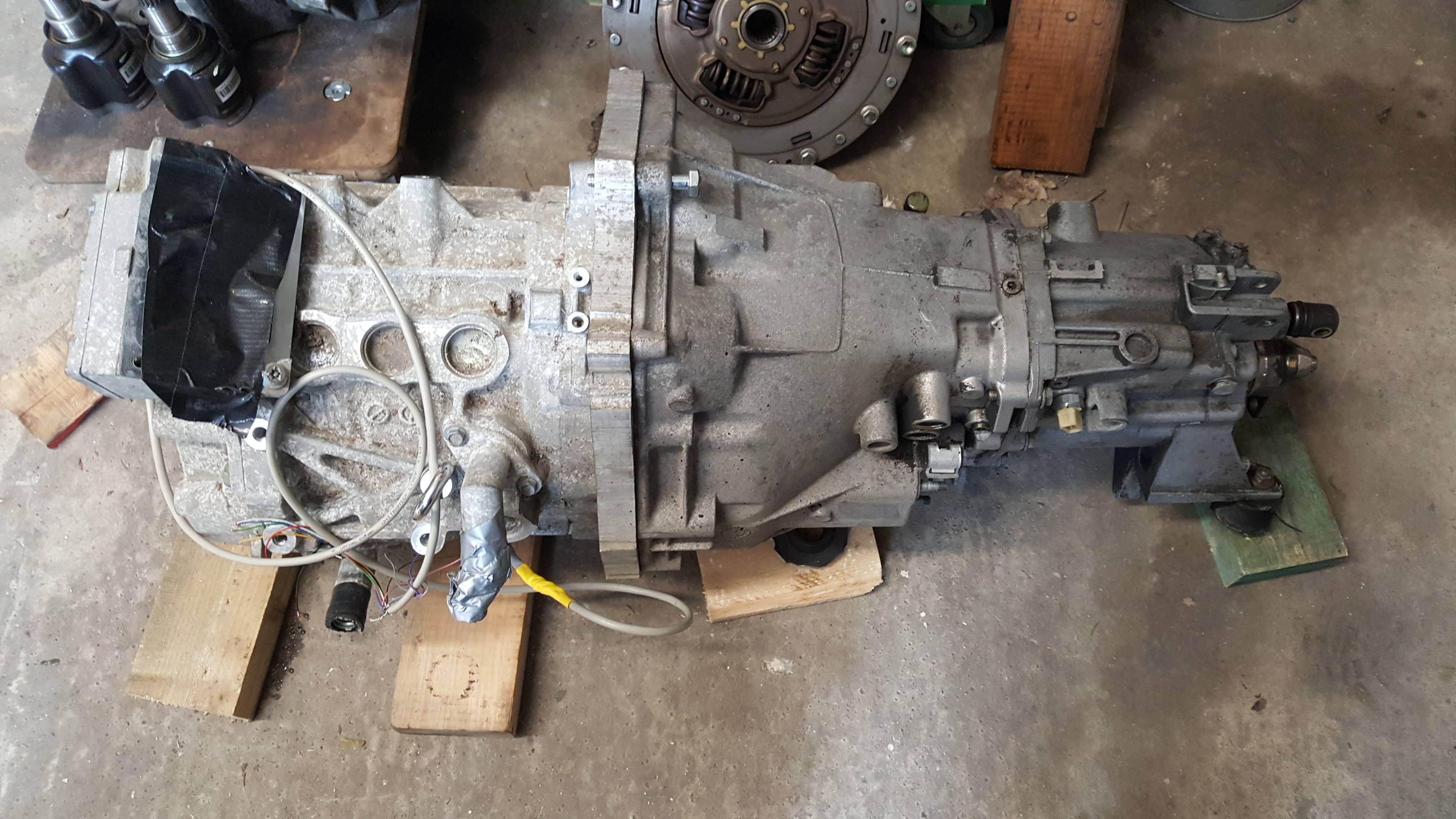

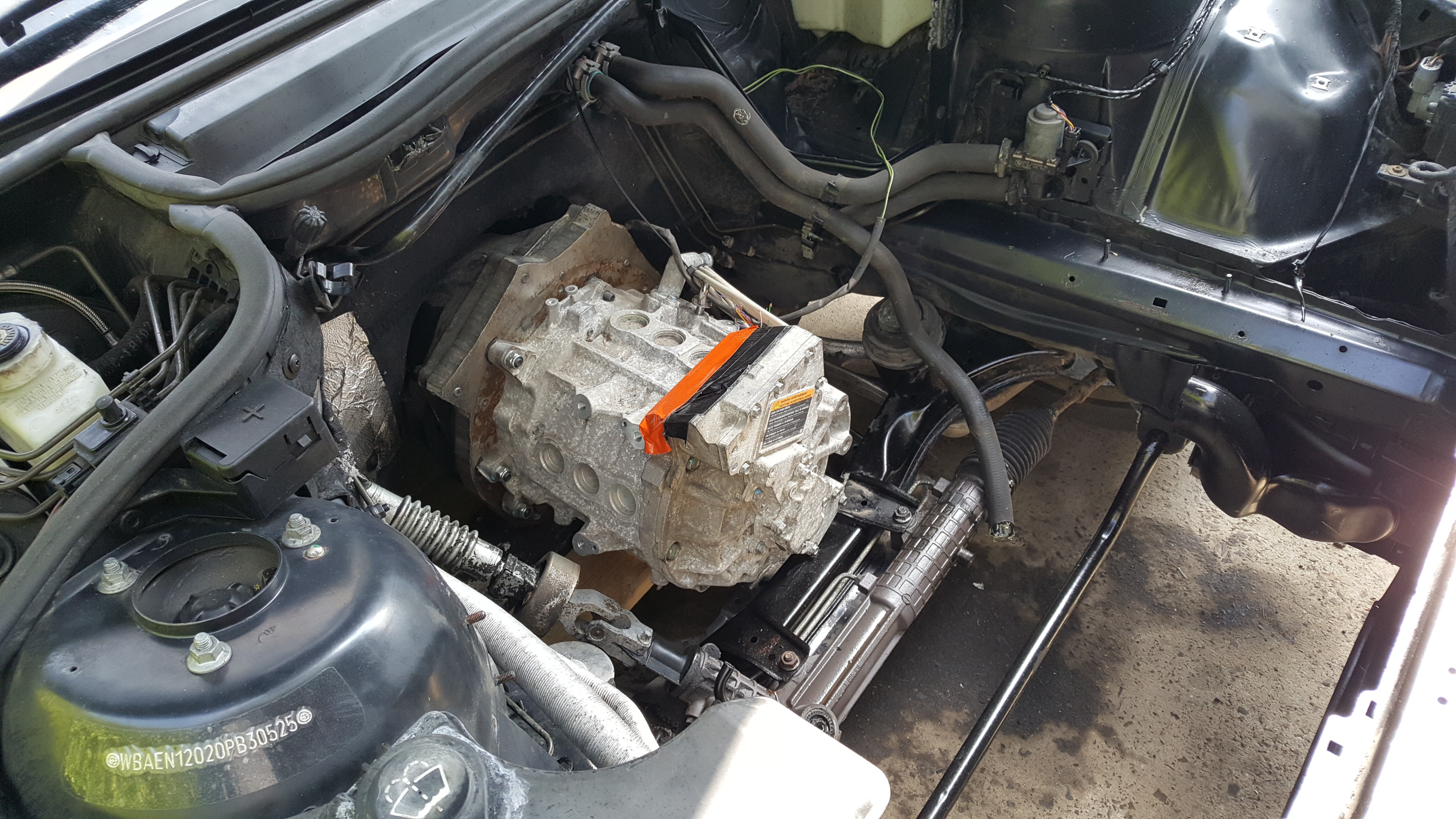

Motor and gearbox mocking up.

Re: Nissan Leaf Powered E46 Touring
Wow, that was quick. Can you come over and do mine :)
Is it again aluminium leftovers and a jigsaw for the adapter plate?
Post by zippy500 »
That looks really good
I have been emailing lots people about getting a leaf adaptor plate made only to be meet with silence.
Is that 25mm plate ? did you cut down the shafts on the motor or gearbox, On the EM57 the motor shaft looks like it sticks out over 50mm.
Yeah 25mm plate. Only had to cut the pilot bearing nose off the gearbox input shaft. about 8mm gap now.
Making adapter plates by hand is easy. Just a bit of work. I know everyone wants fancy cnc stuff these days but a jigsaw, drill press and some sweat gets its done just the same.

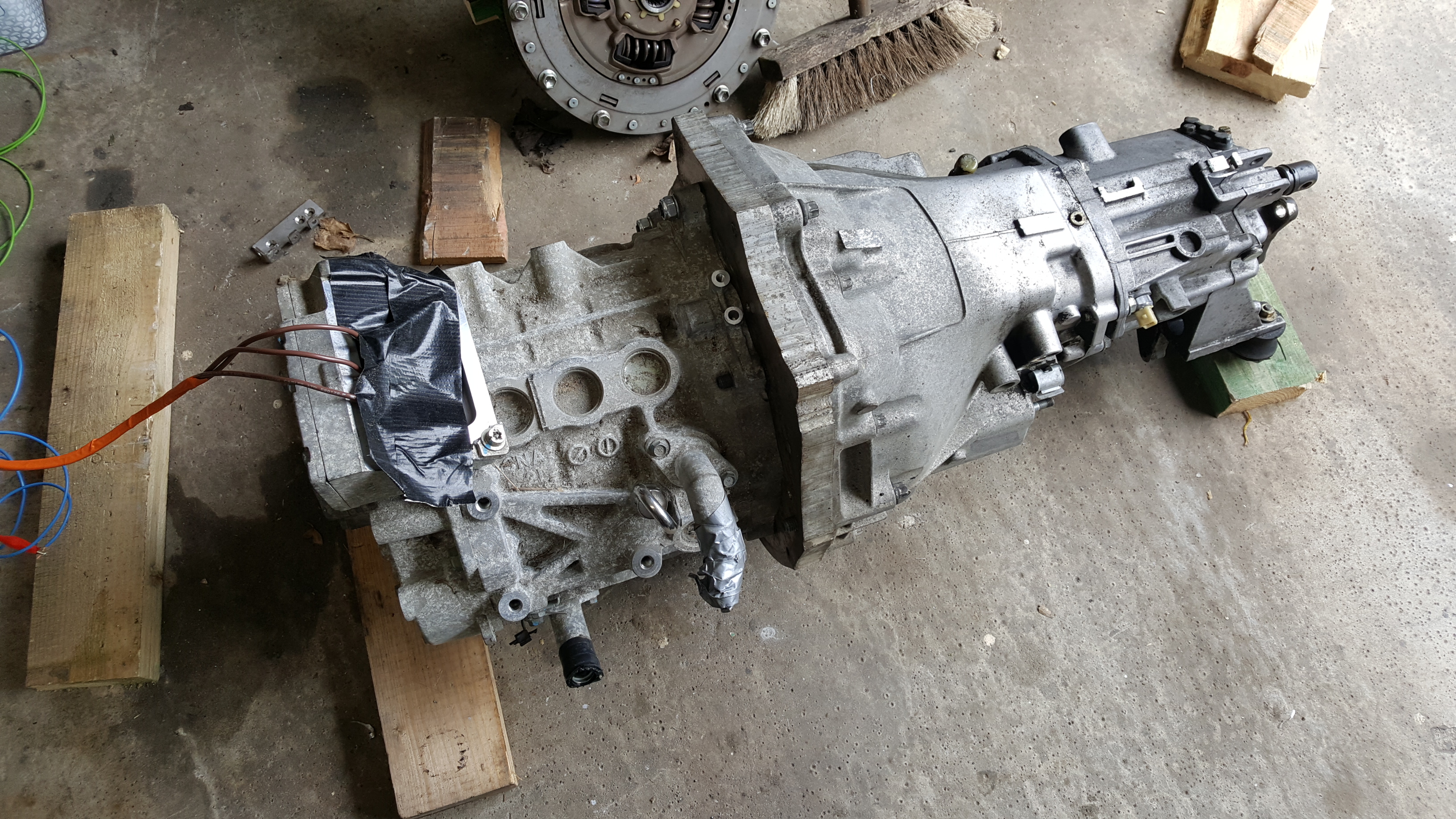

Forget $1400. I just did this in an afternoon because my brain was melted from learning fpga programming. Total cost about 100 Euros.
The lineup is easy. Sit the motor and gearbox vertically but only bolt one side. Motor or gearbox to the adapter plate. Then spin the motor slowly. any misalignment pushes the gearbox to the required position. The old guys did this with dc conversions back in the day. Only difference now is you need an inverter:)
Fiat multipla 1.6 petrol clutch friction plate. I did a shrink fit of the coupler tube onto it to help tighten the splines on the leaf motor shaft.
Motor and gearbox mated up and tested. Time to get it back in the car.

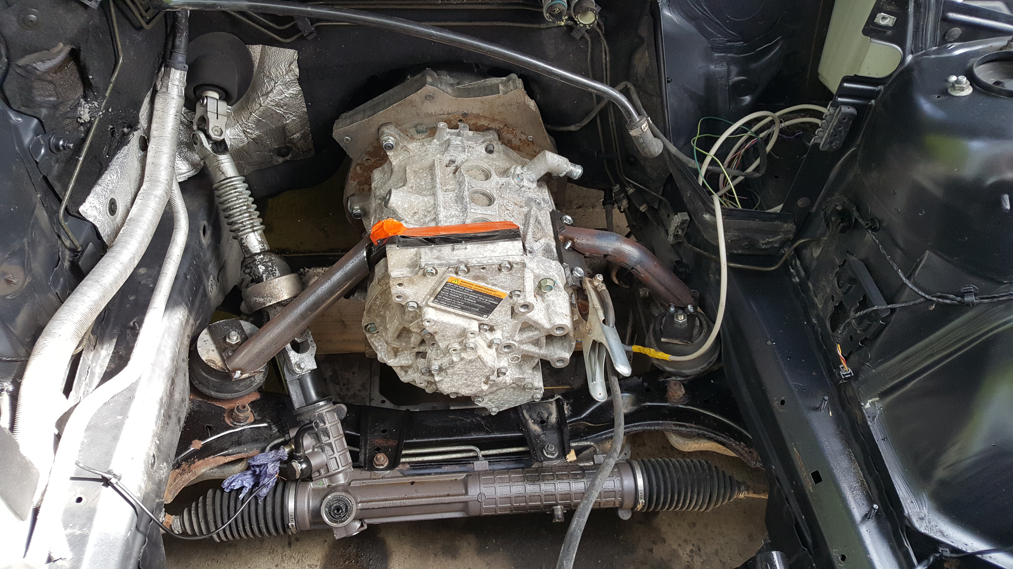

Back in the car and driveshaft hooked up.

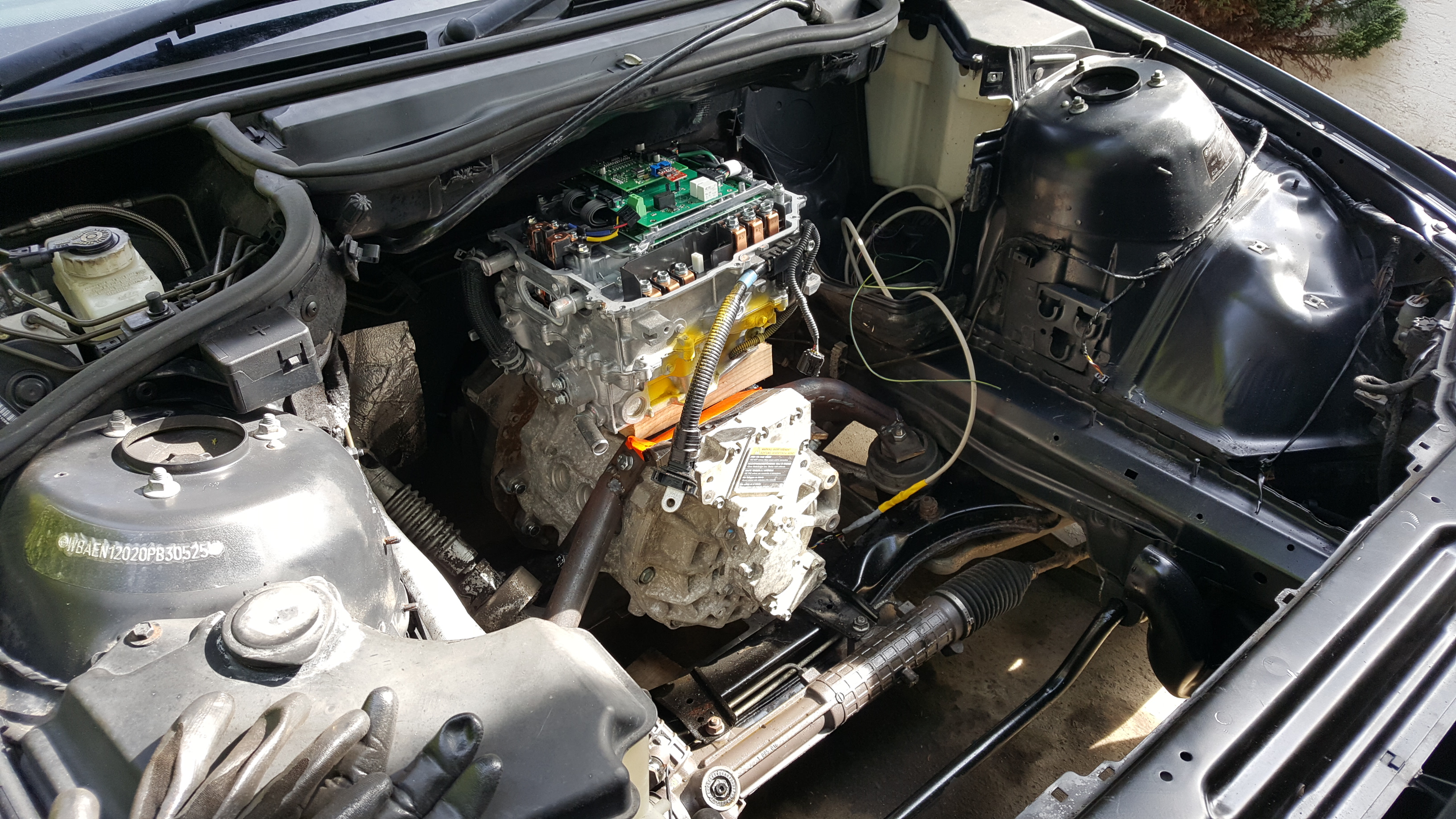

Some more progress. Motor now mounted and have started mocking up the positioning of the Lexus inverter.
Very nice diy motor mounts.
what are you going to fill the empty space with?

Post by dima »
Styrofoam :D
