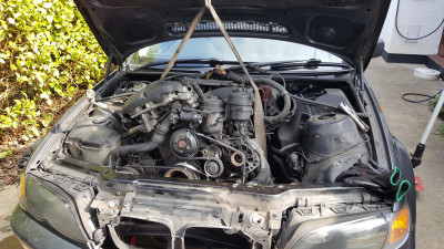

Another day, another EV project. This time we have a 2003 E46 touring formally powered by a mayonaise filled 2.2 petrol engine.
The plan :
Gen 1 Leaf motor
Lexus IS300h inverter
400v of LTO cells

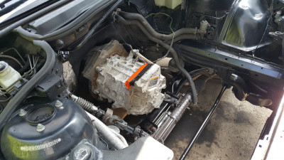

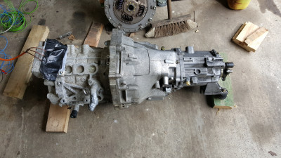

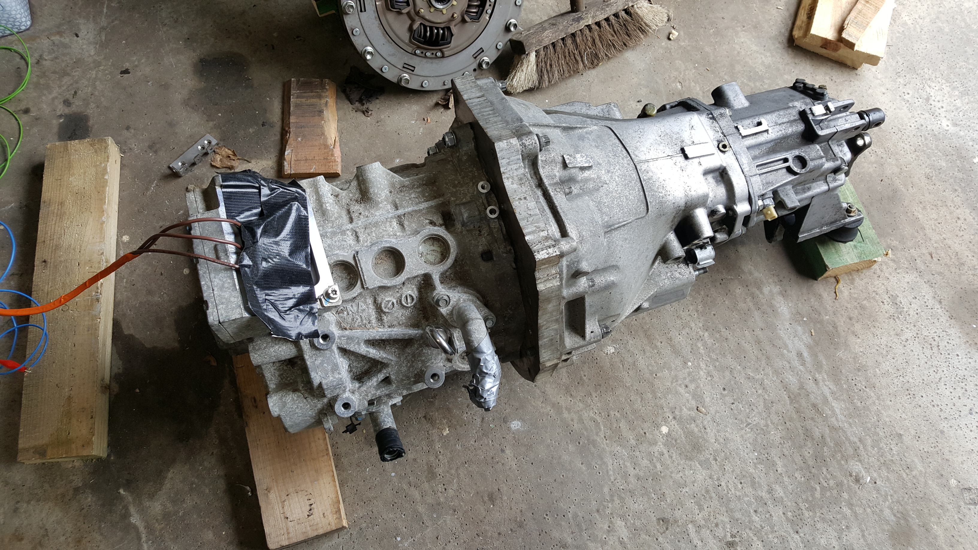

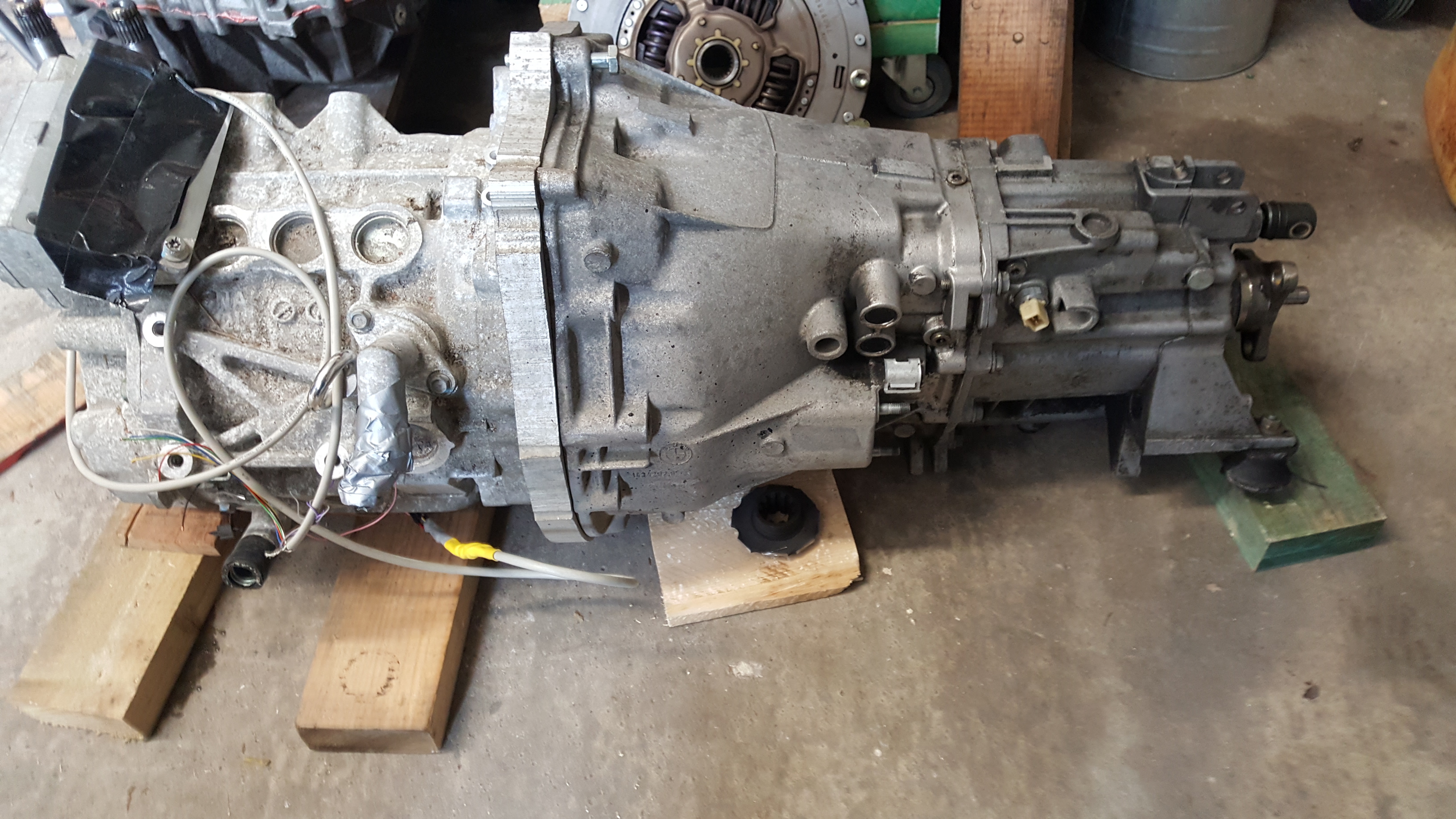

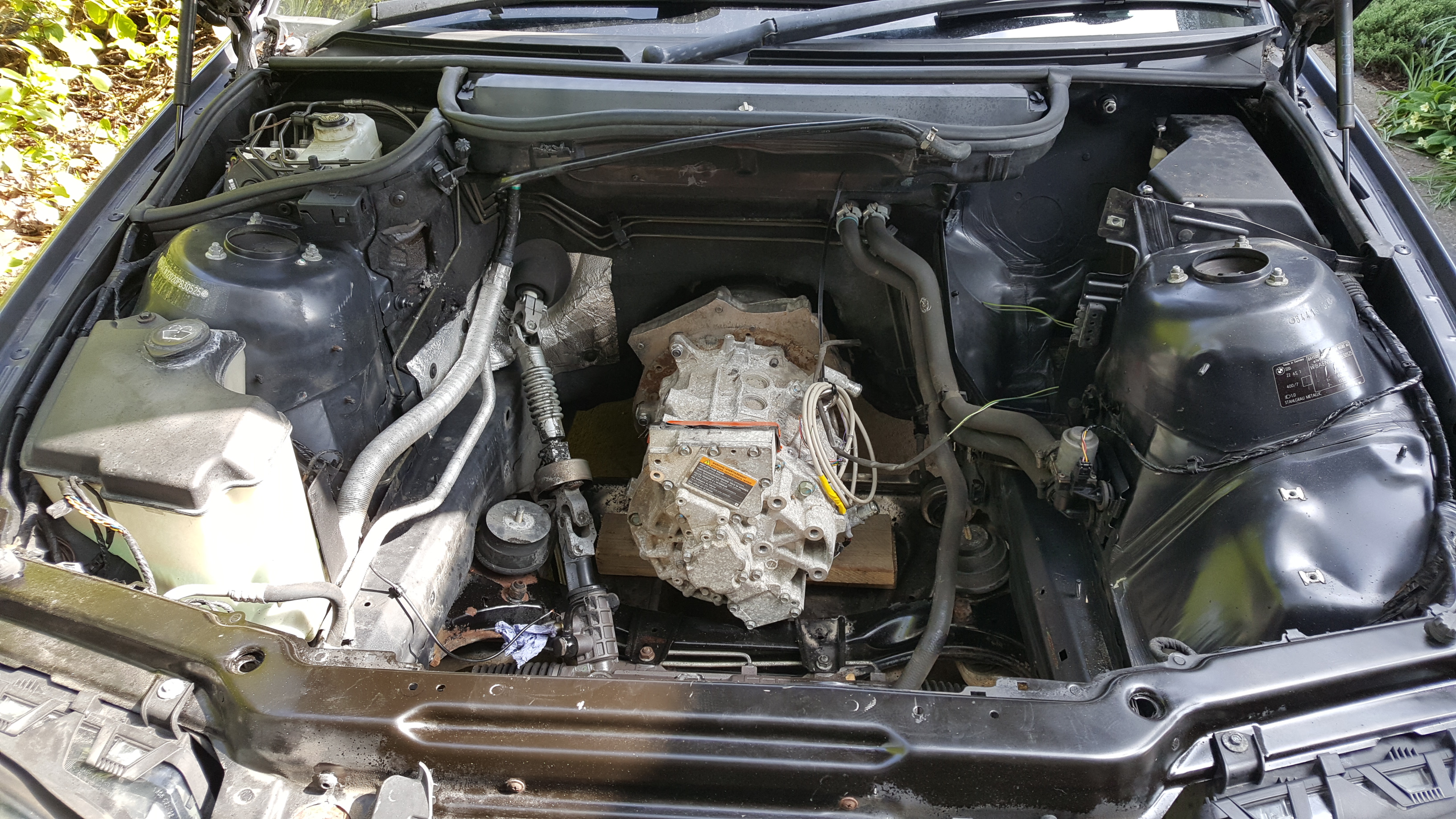

Motor and gearbox mocking up.

Been thanked: 1913 times
Re: Nissan Leaf Powered E46 Touring
Wow, that was quick. Can you come over and do mine :)
Is it again aluminium leftovers and a jigsaw for the adapter plate?

I have been emailing lots people about getting a leaf adaptor plate made only to be meet with silence.

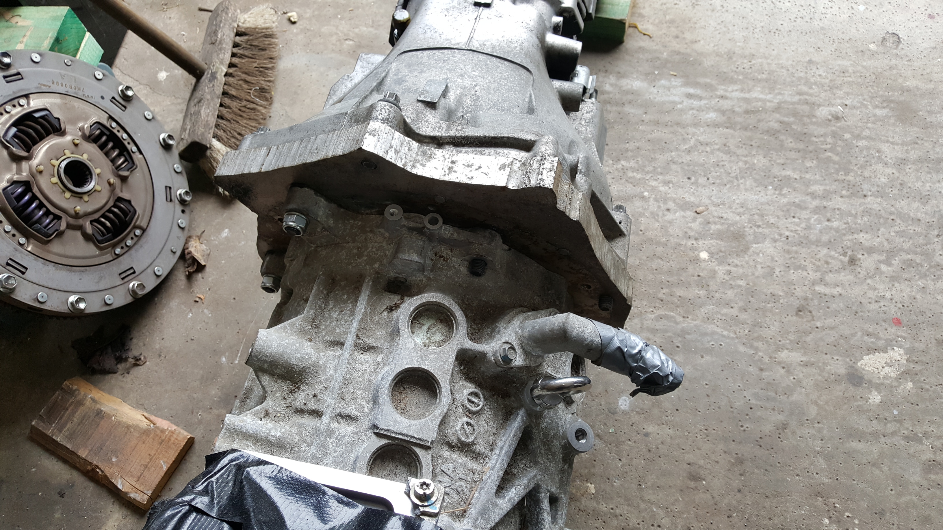

Is that 25mm plate ? did you cut down the shafts on the motor or gearbox, On the EM57 the motor shaft looks like it sticks out over 50mm.
Posts: 3999
Been thanked: 1114 times
Yeah 25mm plate. Only had to cut the pilot bearing nose off the gearbox input shaft. about 8mm gap now.
Making adapter plates by hand is easy. Just a bit of work. I know everyone wants fancy cnc stuff these days but a jigsaw, drill press and some sweat gets its done just the same.

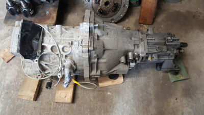

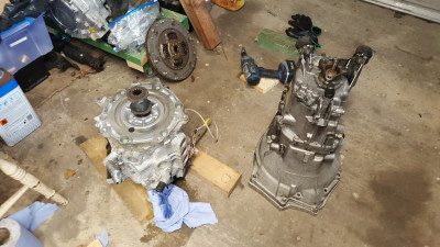

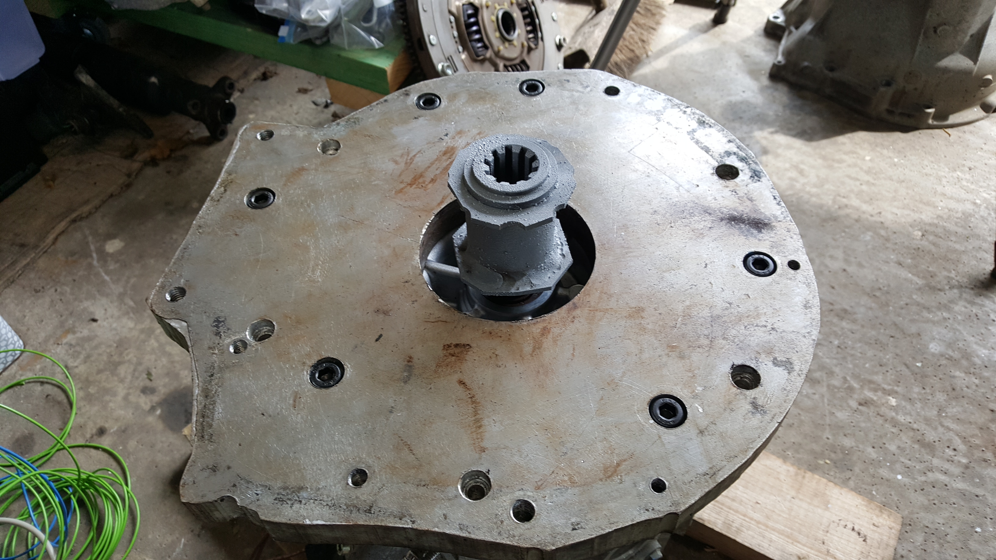

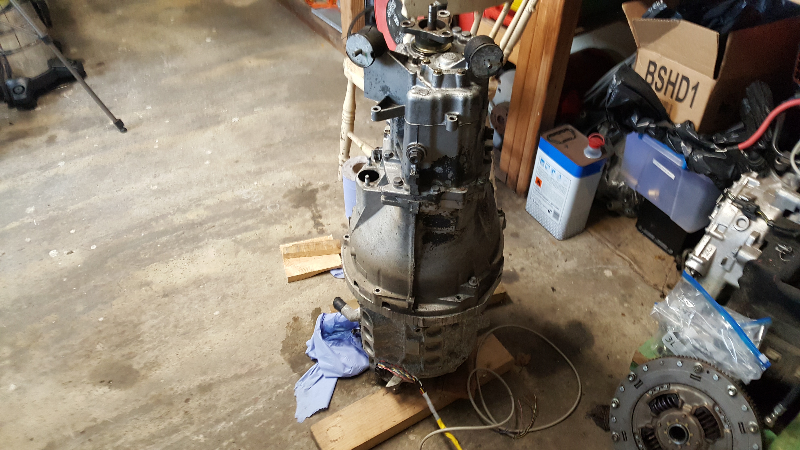

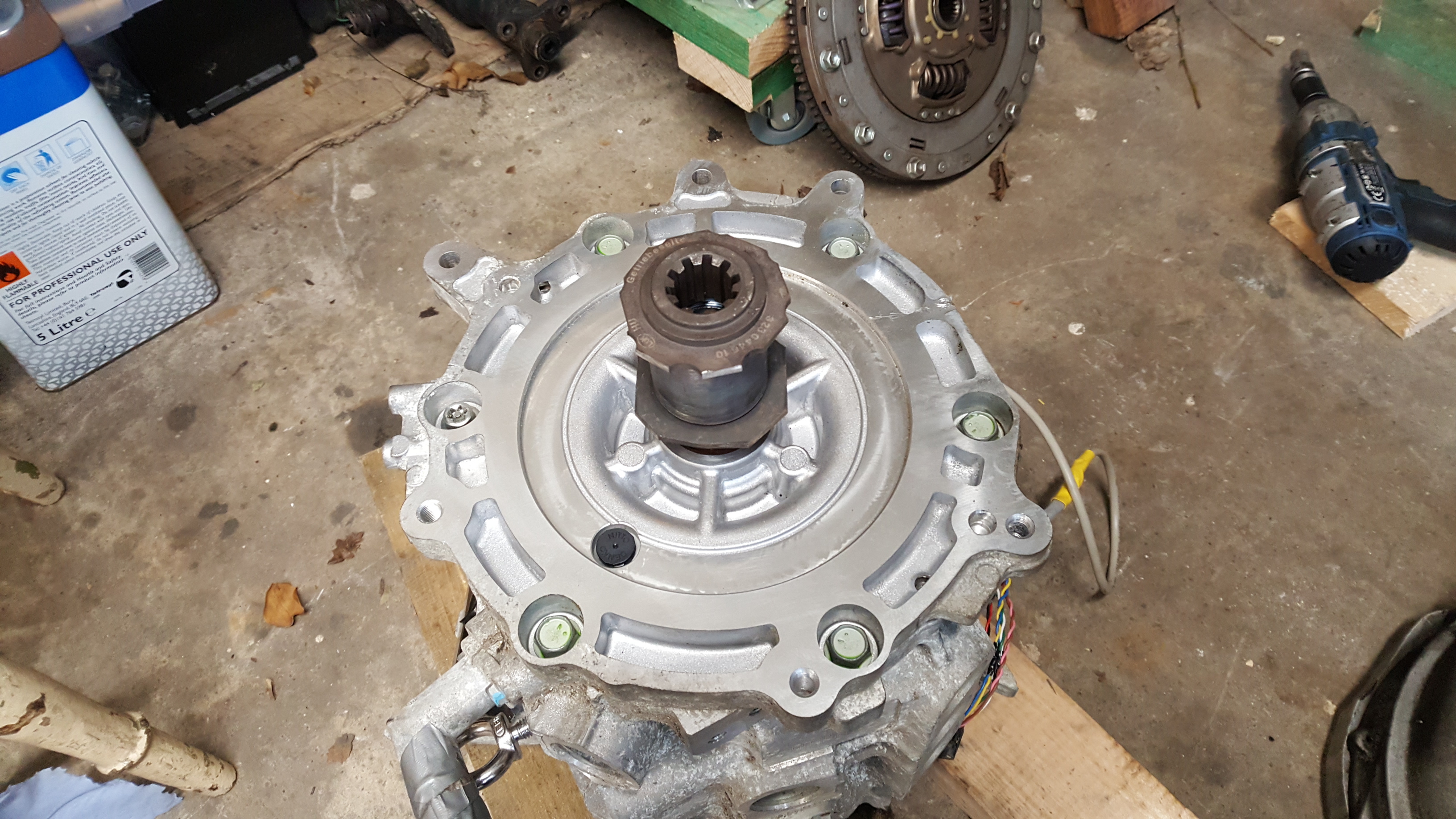

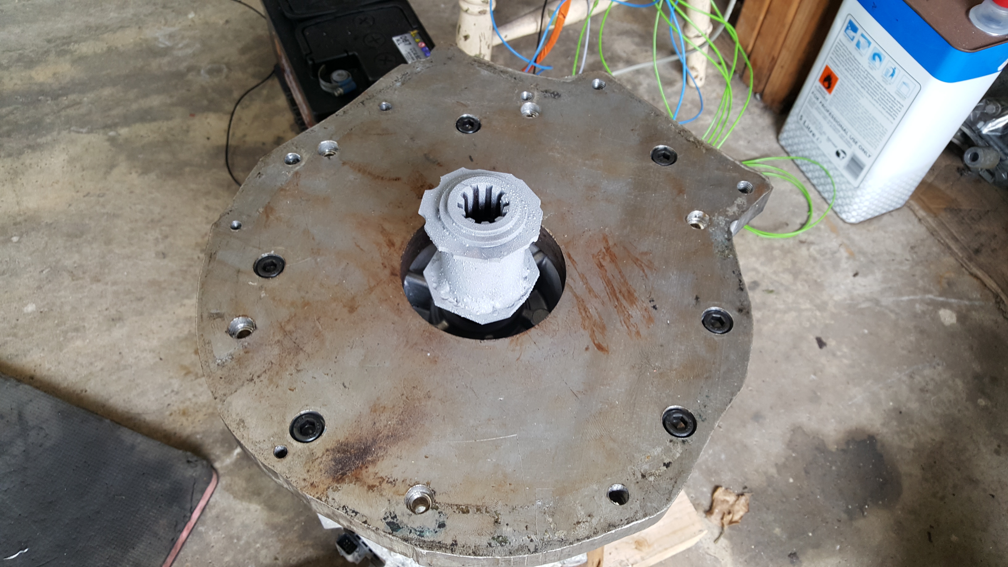

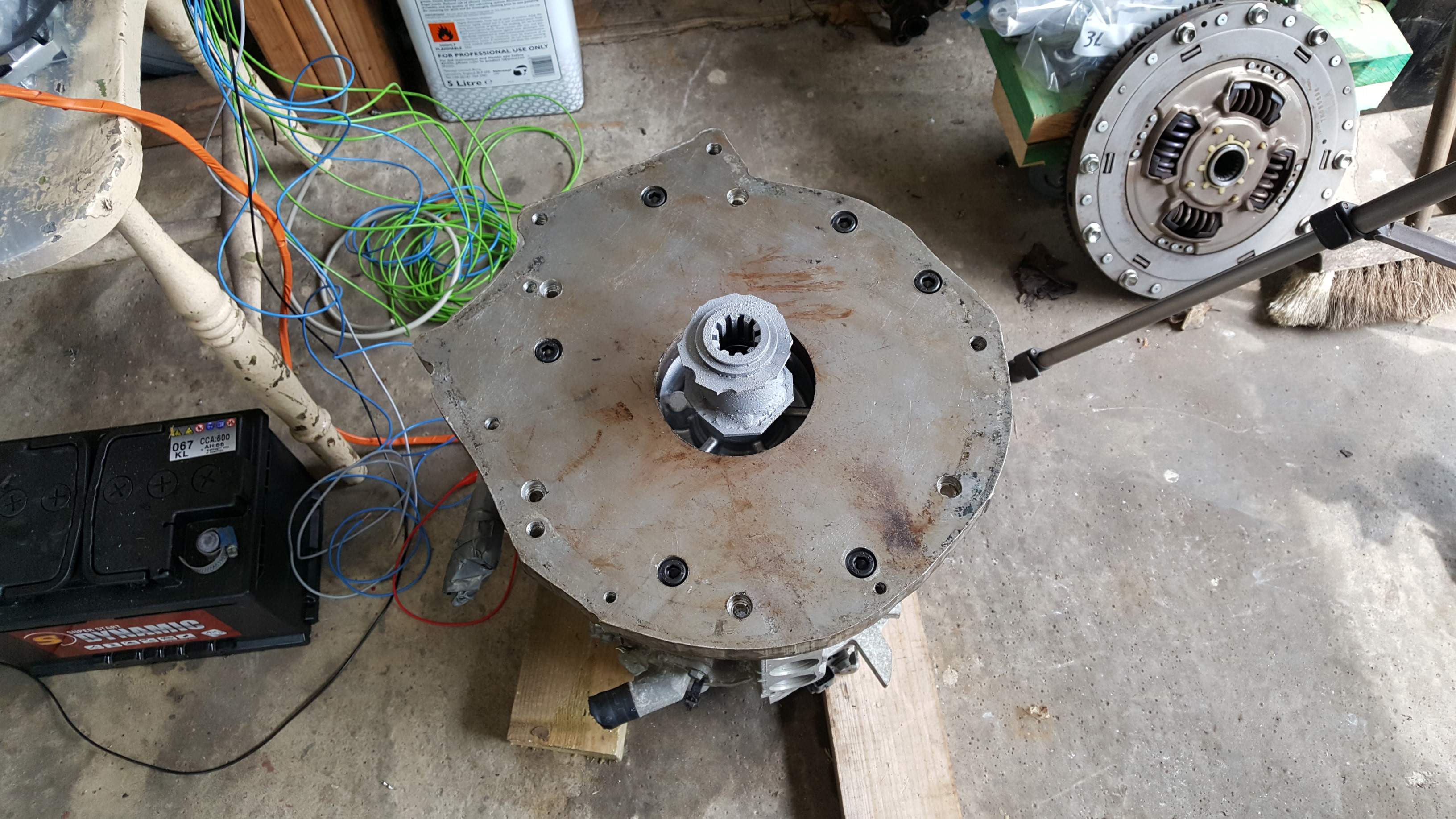

Forget $1400. I just did this in an afternoon because my brain was melted from learning fpga programming. Total cost about 100 Euros.
The lineup is easy. Sit the motor and gearbox vertically but only bolt one side. Motor or gearbox to the adapter plate. Then spin the motor slowly. any misalignment pushes the gearbox to the required position. The old guys did this with dc conversions back in the day. Only difference now is you need an inverter:)

zippy500
Posts: 247
Location: United Kingdom
Has thanked: 100 times
Been thanked: 7 times
Post by zippy500 »
Excellent work,

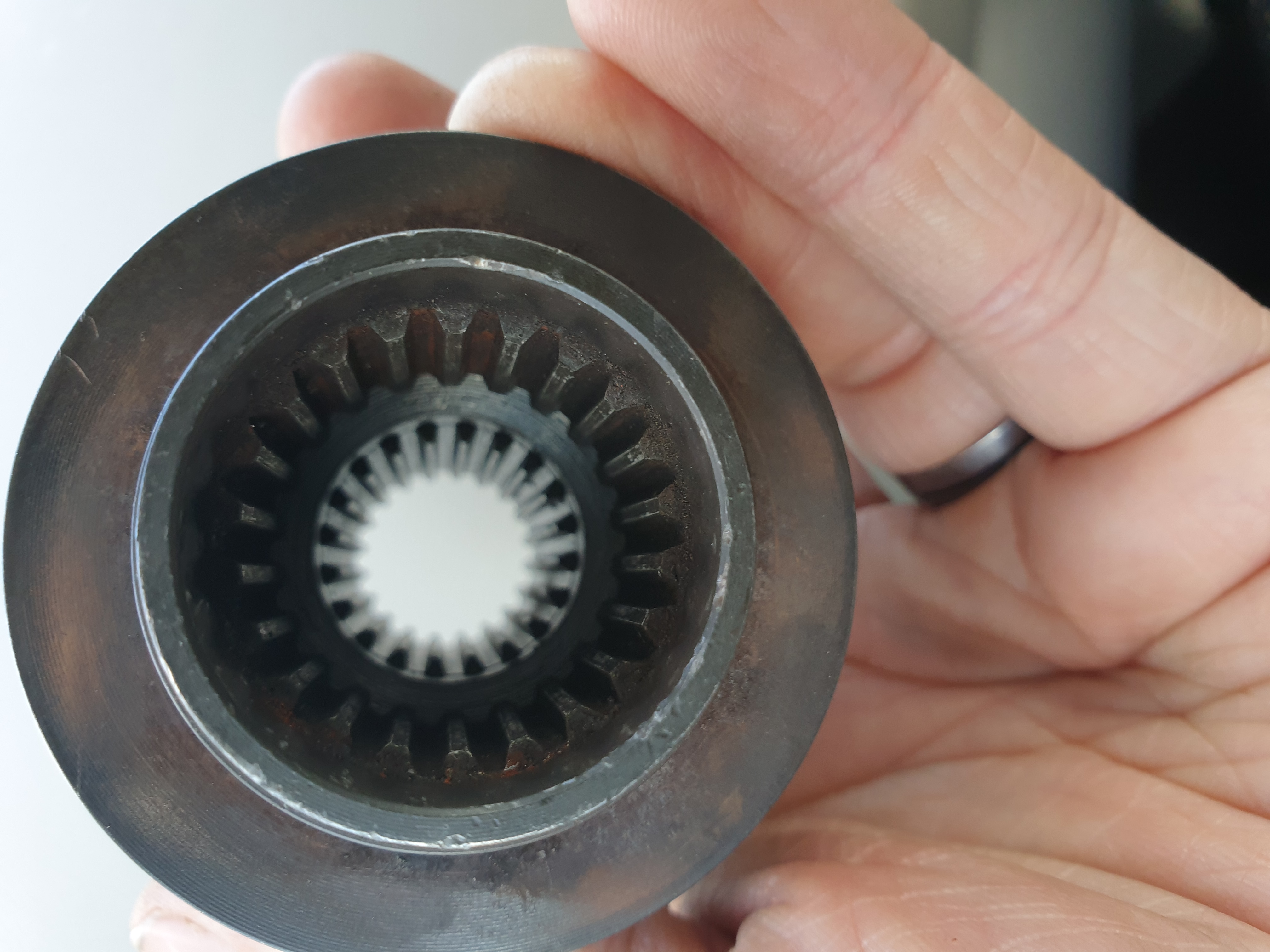

What coupler did you use on leaf spline shaft ?
Going to have a measure up later I think :D
Posts: 3999
Fiat multipla 1.6 petrol clutch friction plate. I did a shrink fit of the coupler tube onto it to help tighten the splines on the leaf motor shaft.

Can ask what do you mean by shrink fit, did you heat the coupler body fit the clutch part then let it cool ?

Jack Bauer wrote: Mon Apr 15, 2019 5:55 pm Fiat multipla 1.6 petrol clutch friction plate. I did a shrink fit of the coupler tube onto it to help tighten the splines on the leaf motor shaft.
And it did work didnt it :). I used the same technique and theese days i will use boroscope on my transmission bell just to be sure everything is ok.
Well the only issue may be that teeth profile are not right in the attitude. But tight clamping helps here also.
I still recommend Lovejoy style coupler between motor and transmission, due to the fact that some misalignment may still exist. Also that coupler is very good at absorbing impact force from motor torque.

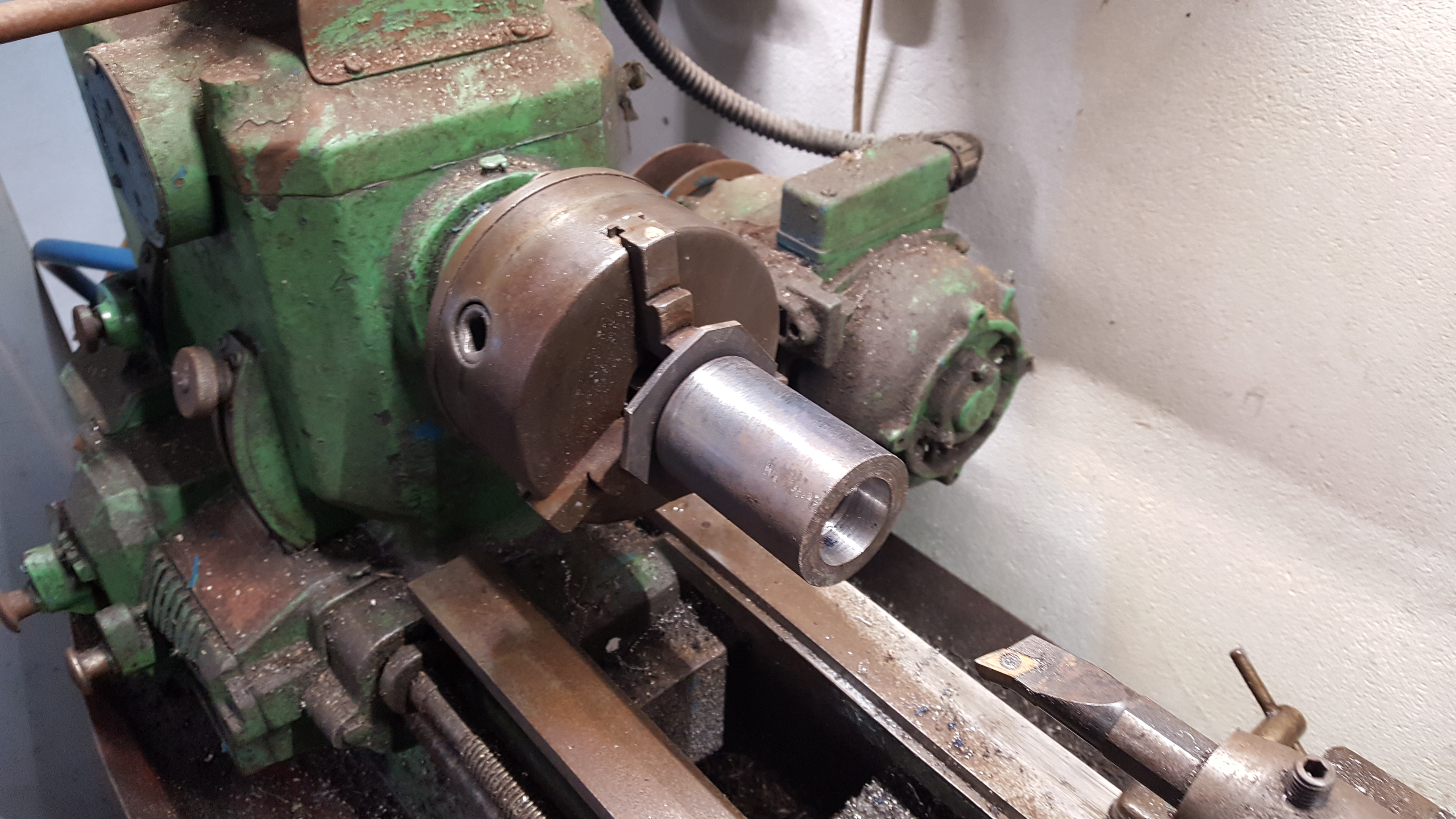

No need for that. I just put mine in a lathe and reduced depth from both sides appropriately so the joint came in the middle approximately. You still have to guarantee a good ammount of seat though. Note that i took more material from the transmission side since motor has longer shaft. https://mazdamx3ev.wordpress.com/2018/0 ... lopka-ven/
Those welds are just for ornament :) Splines are kept in position by bolts and shrink-fit of material.
I forgot you have the depth of the inside of the bell housing .
How do to stop the lovejoy coupler halves from sliding on the shafts and apart from each other ?
Might have to give the machining part to a shop, I don't have access to a lathe or machining skills

Yes i was fortunate enough that i had a long sleeve to support shaft in bell housing. To support transmission side coupler i used existing clutch bearing. I gave it a clearance of some 1mm or 2mm and supported in on the inside by another sleeve. I can hear it sometimes in the morning when shafts are cold. But later when everything heats up clearance is enough.
On the motor side i used 3x allen bolts with spring washer to keep the coupler in place. It is not ideal, but i could make it on short notice. Ideally the best would be to cut the coupler on one side and machine clamping mechanism into coupler. When you torque it down there is no possibility of axial movement. This also applies to transmission side. See here... https://www.ktr.com/en/products/power-t ... ping-hubs/

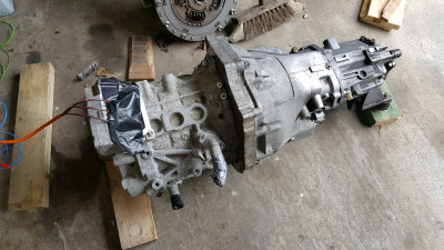

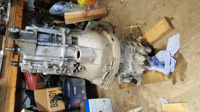

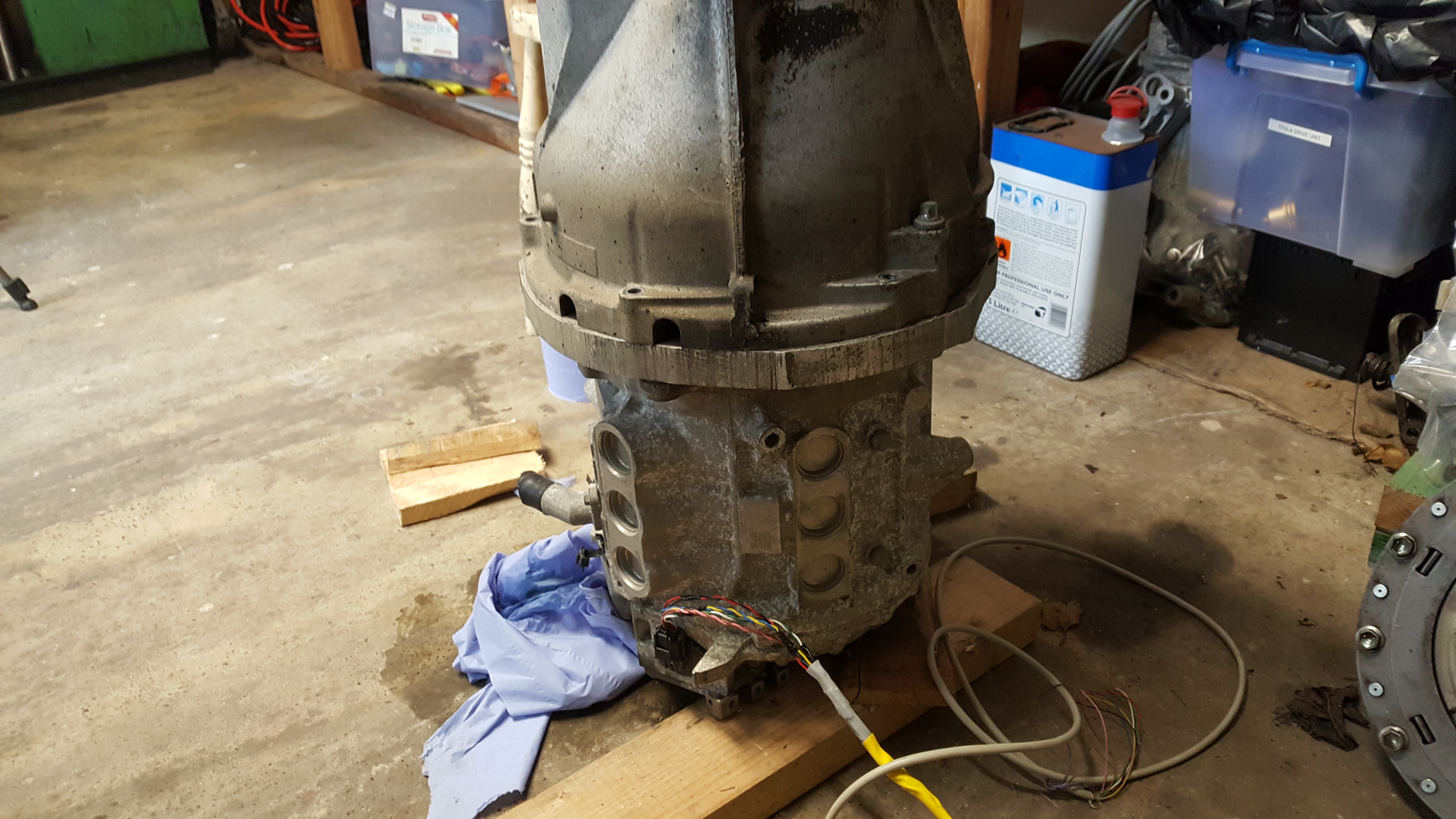

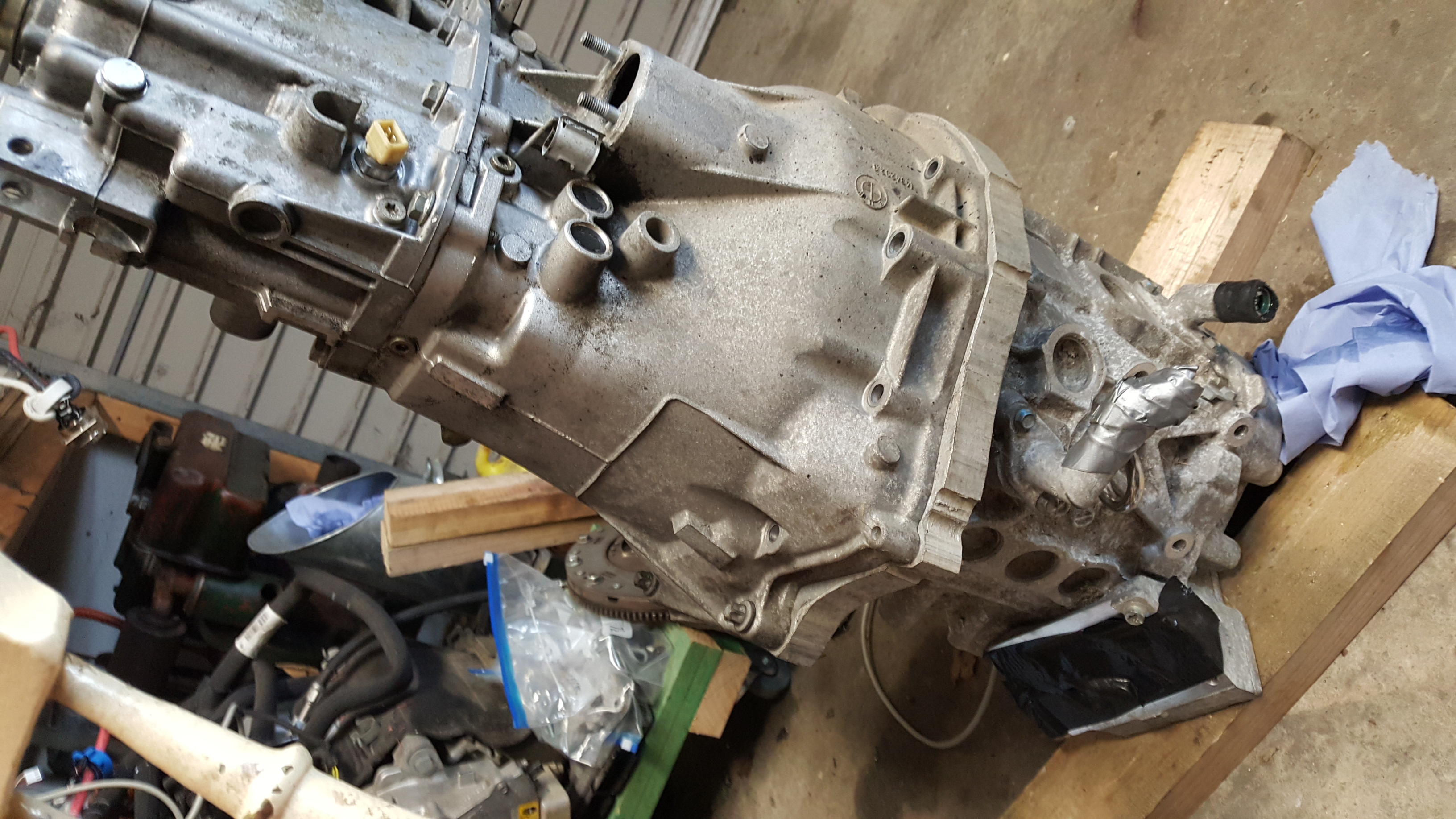

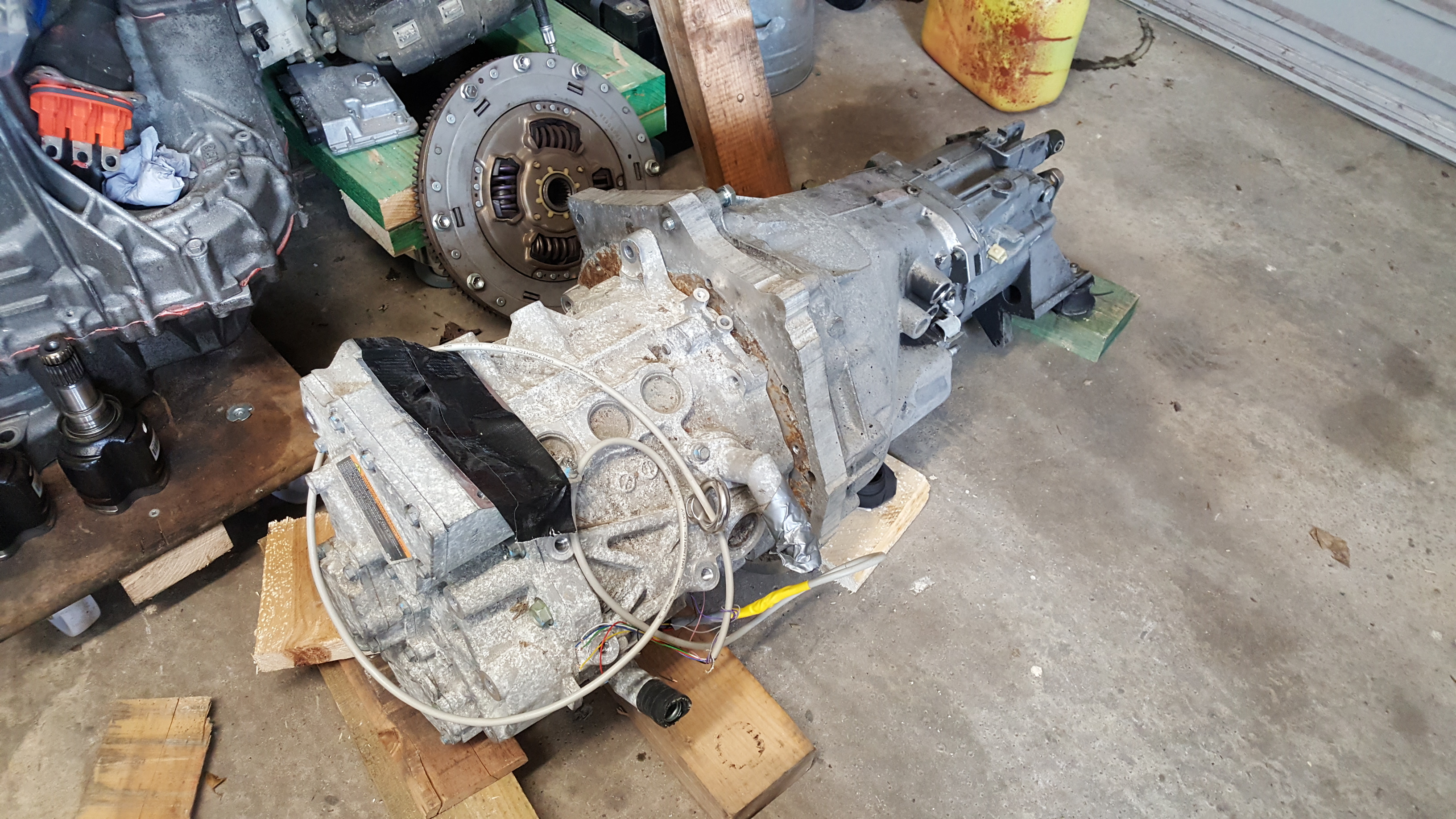

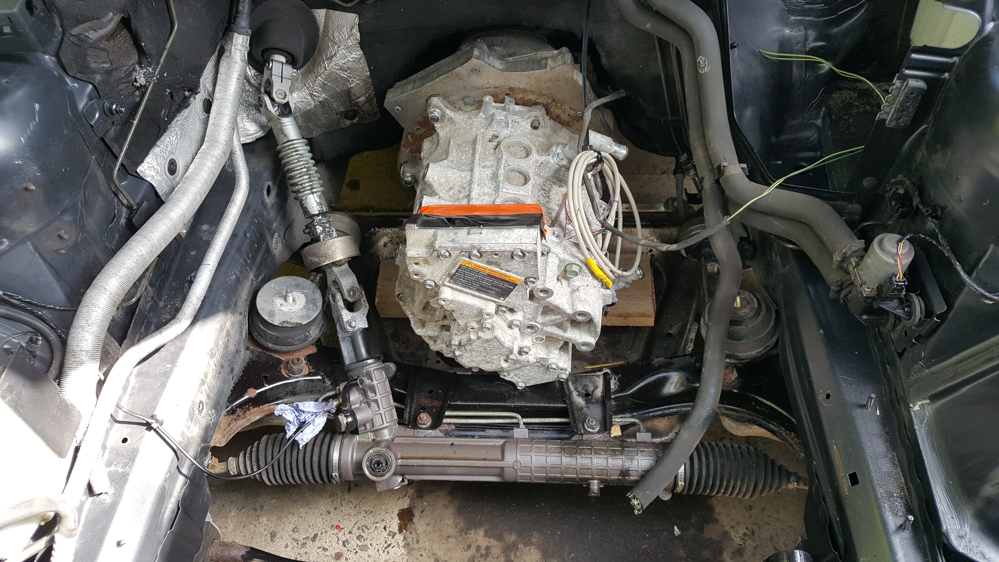

Motor and gearbox mated up and tested. Time to get it back in the car.

Thanks for the video , very helpful , was adapter plate tapped for the bolts ?
That's a nice simple solution to just put some weld on the shaft to stop the coupler moving

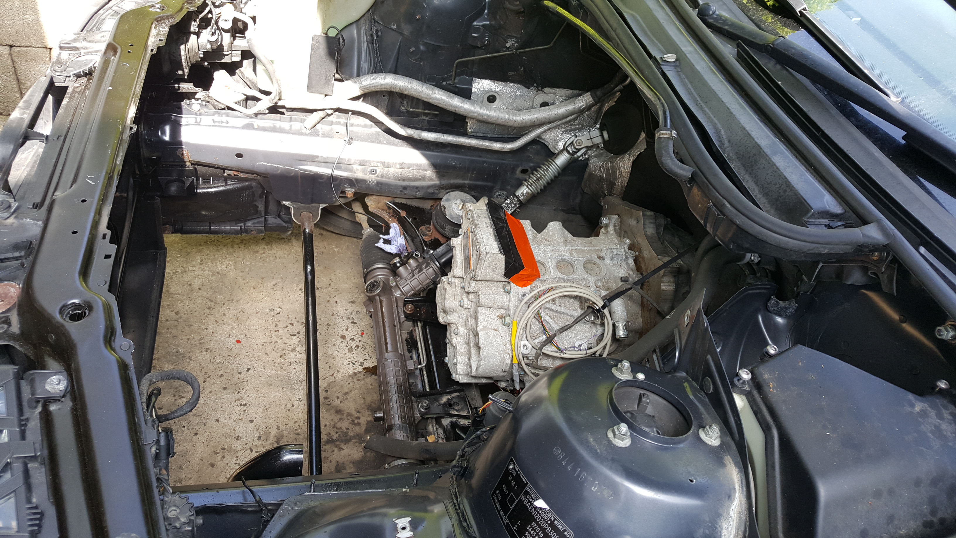

Back in the car and driveshaft hooked up.

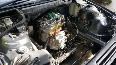

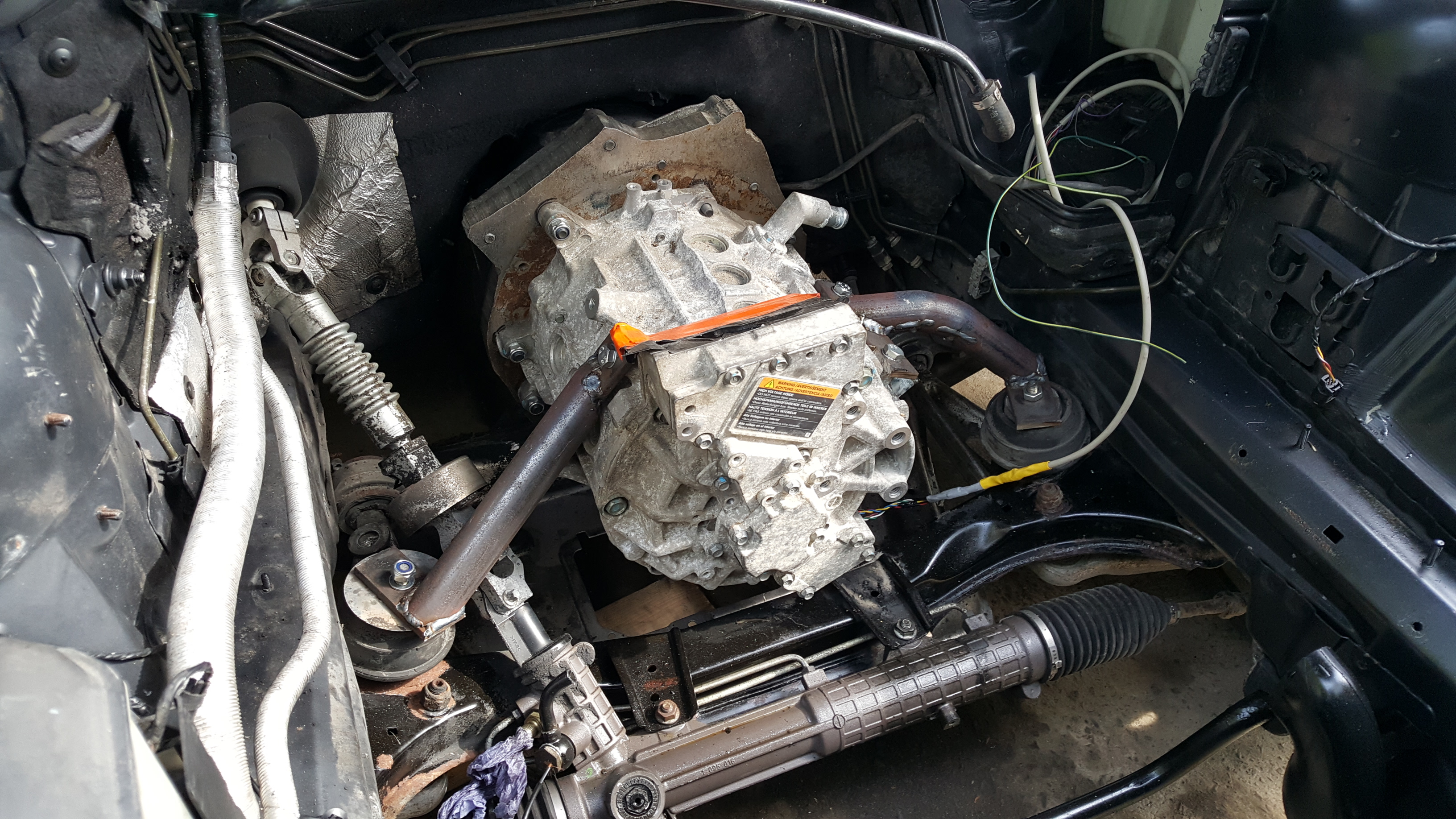

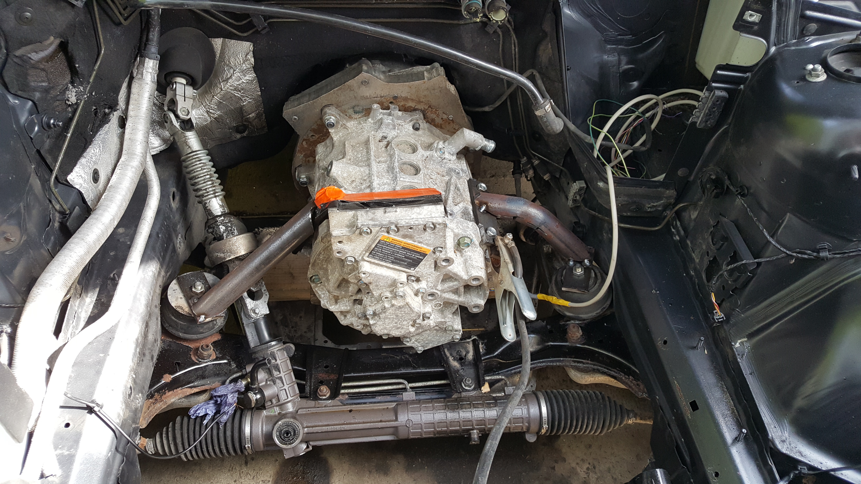

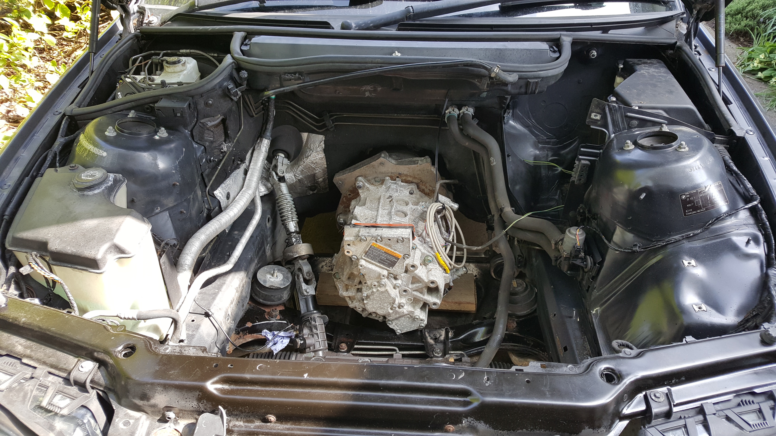

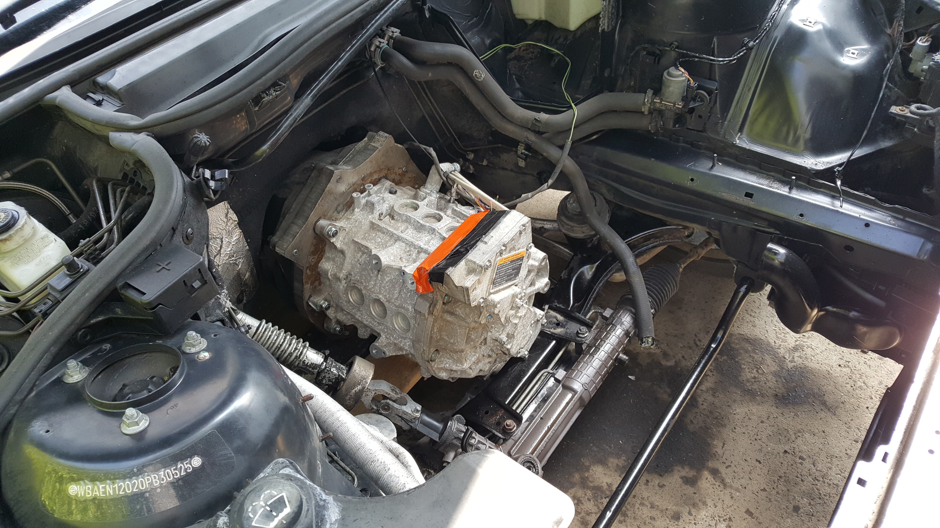

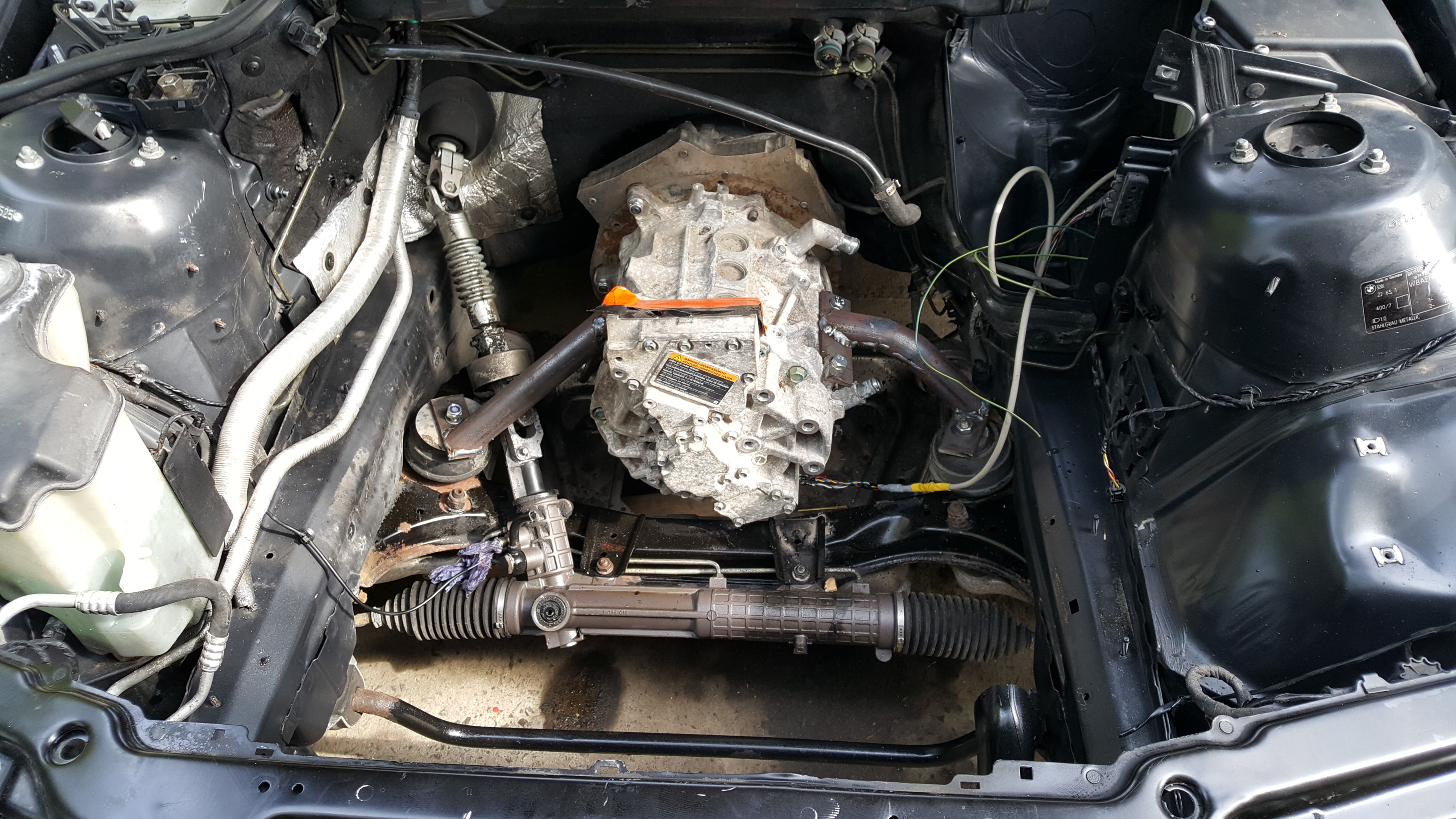

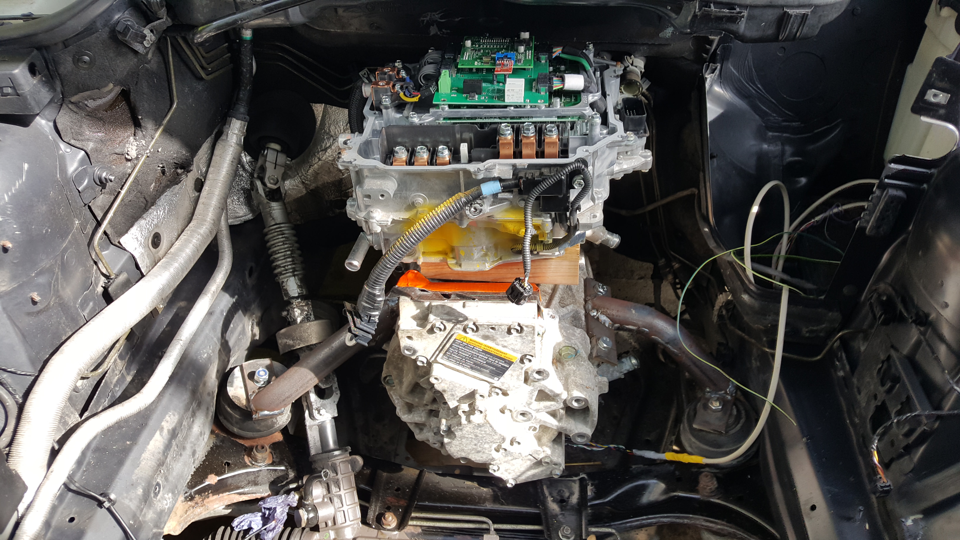

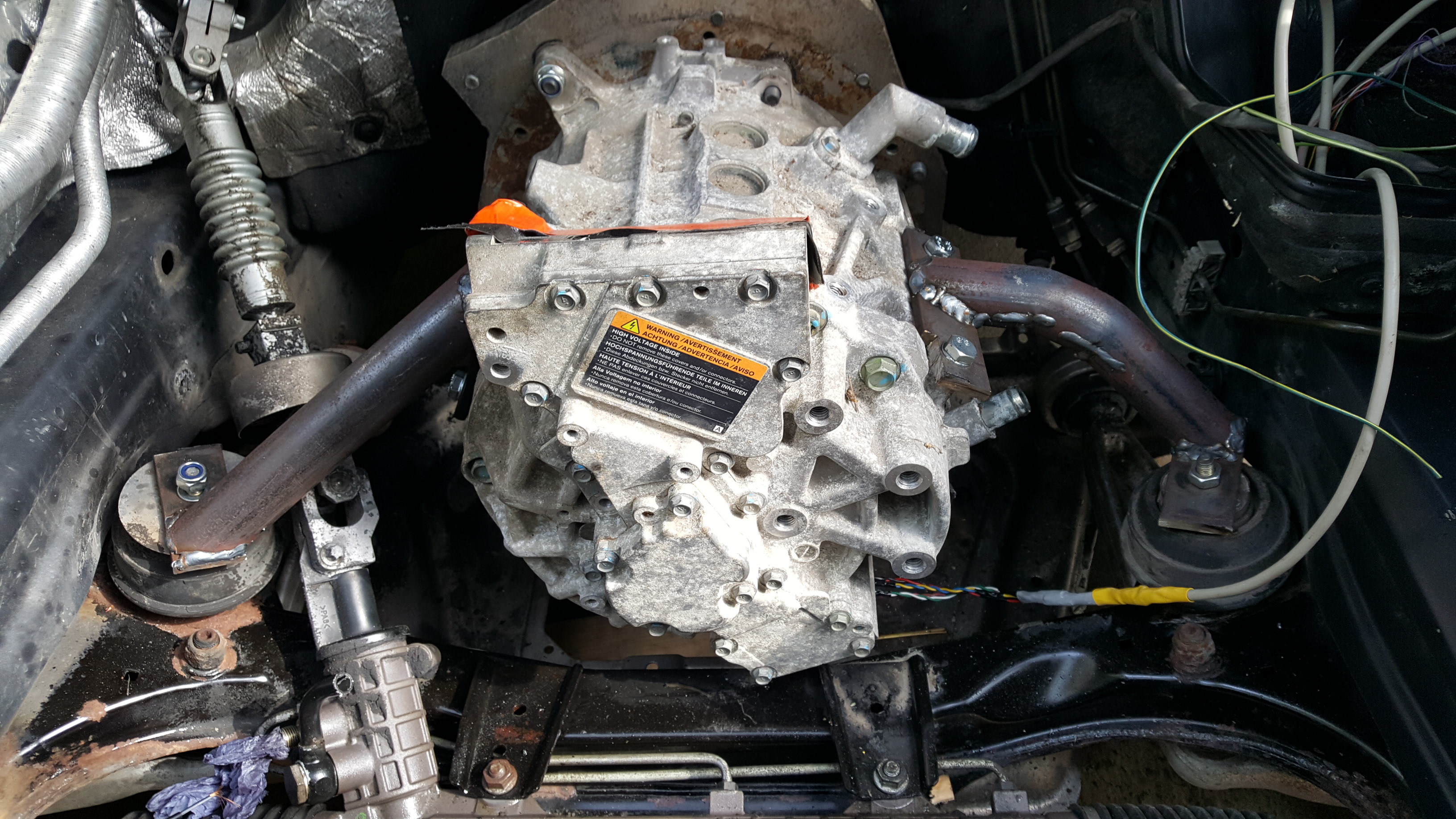

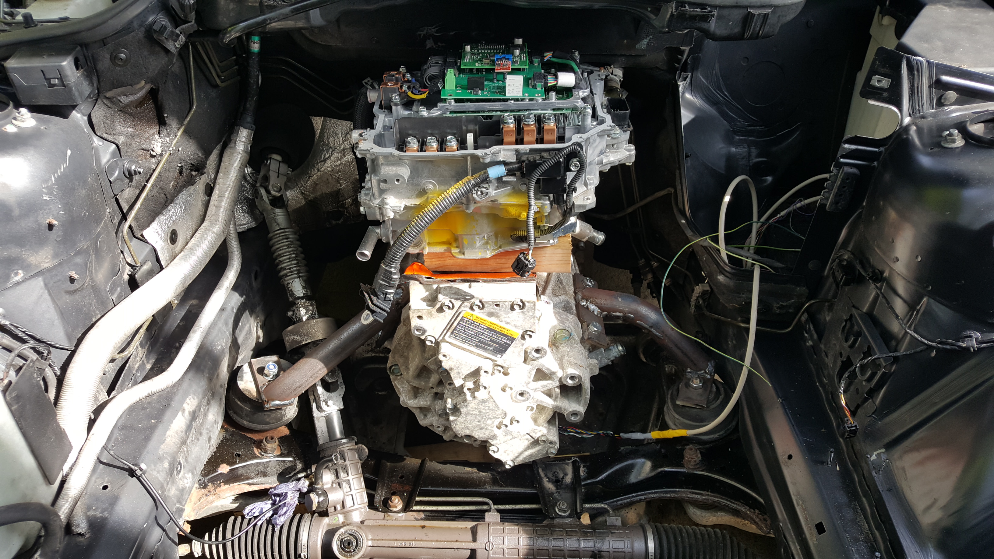

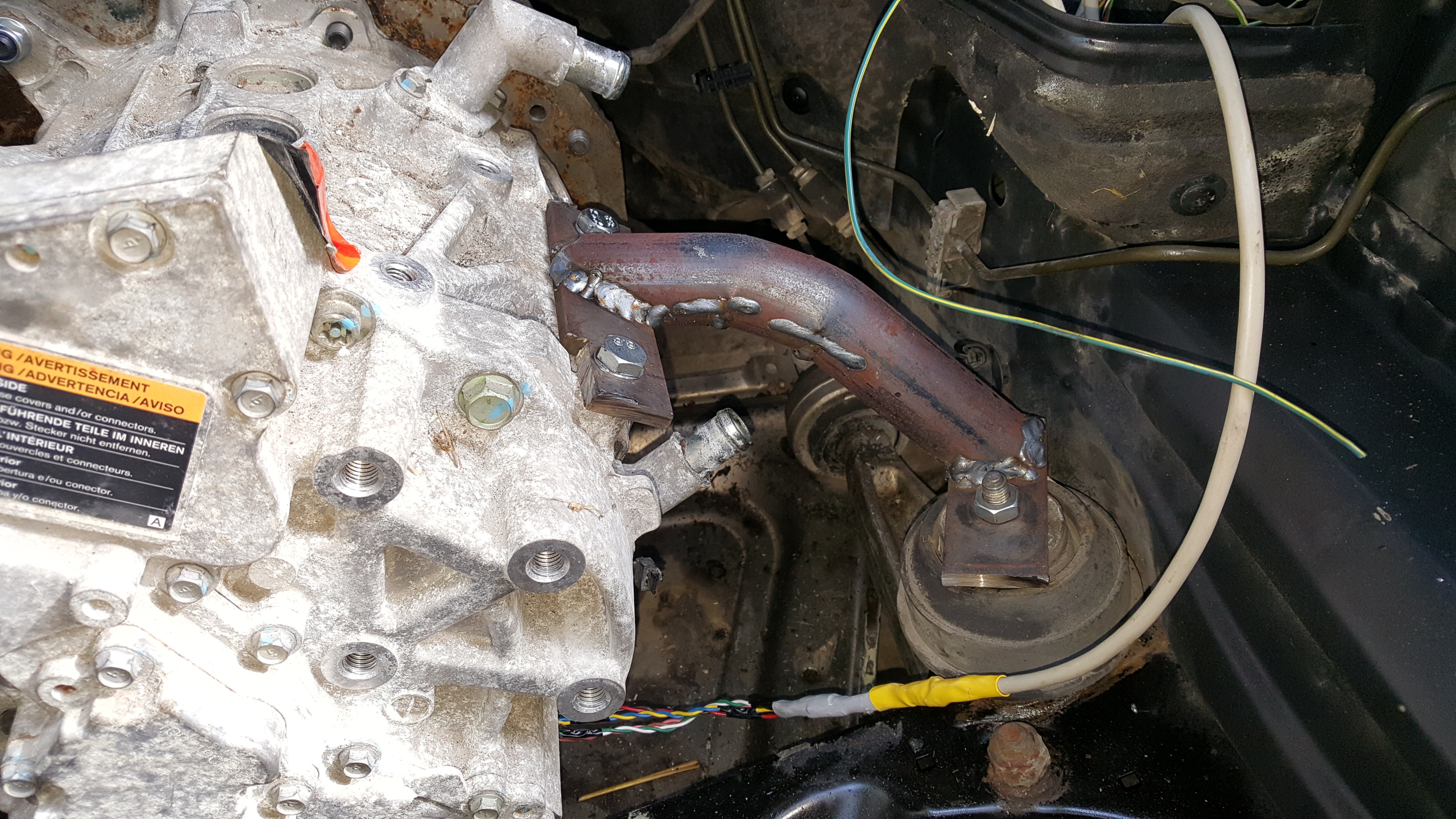

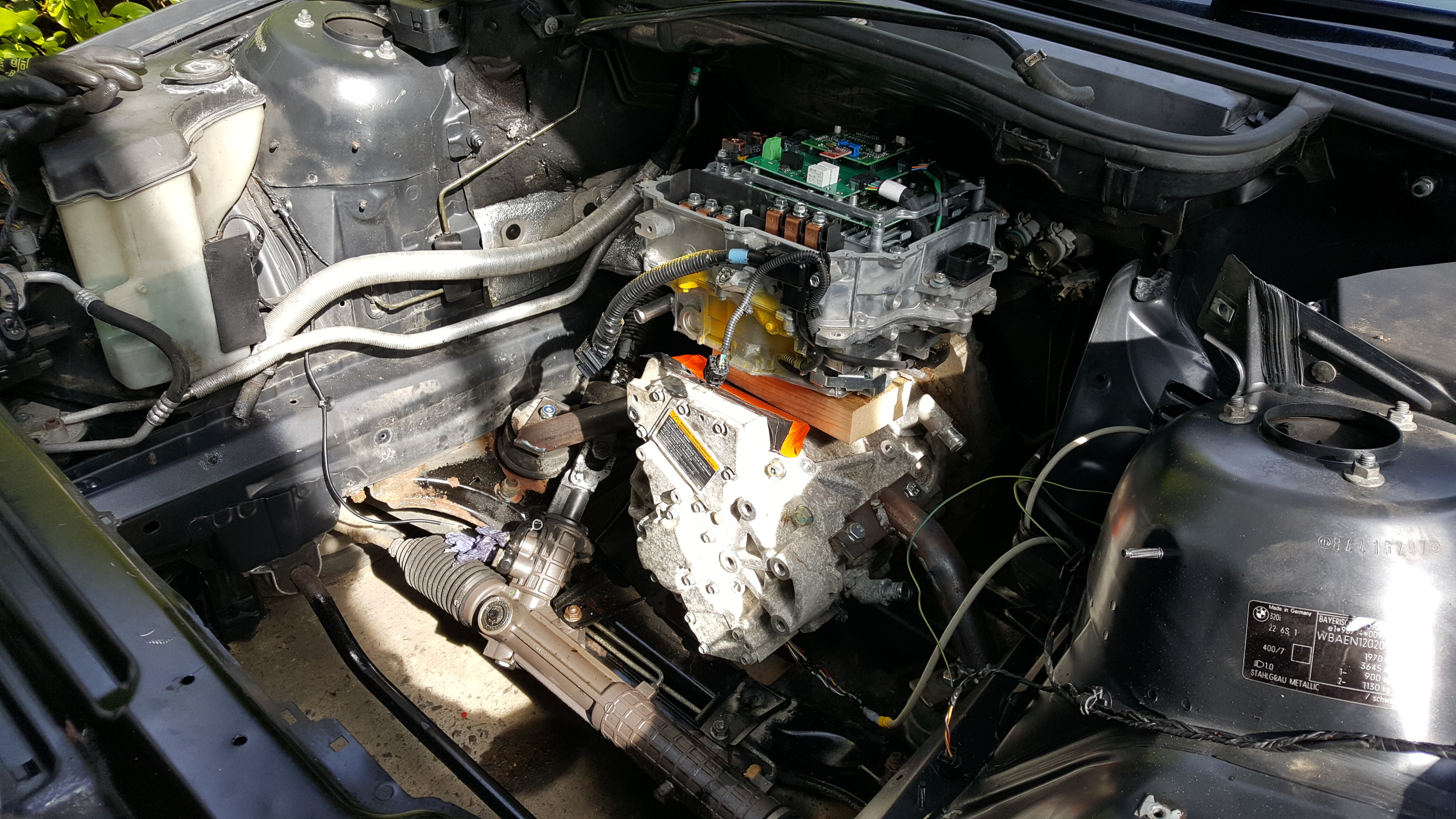

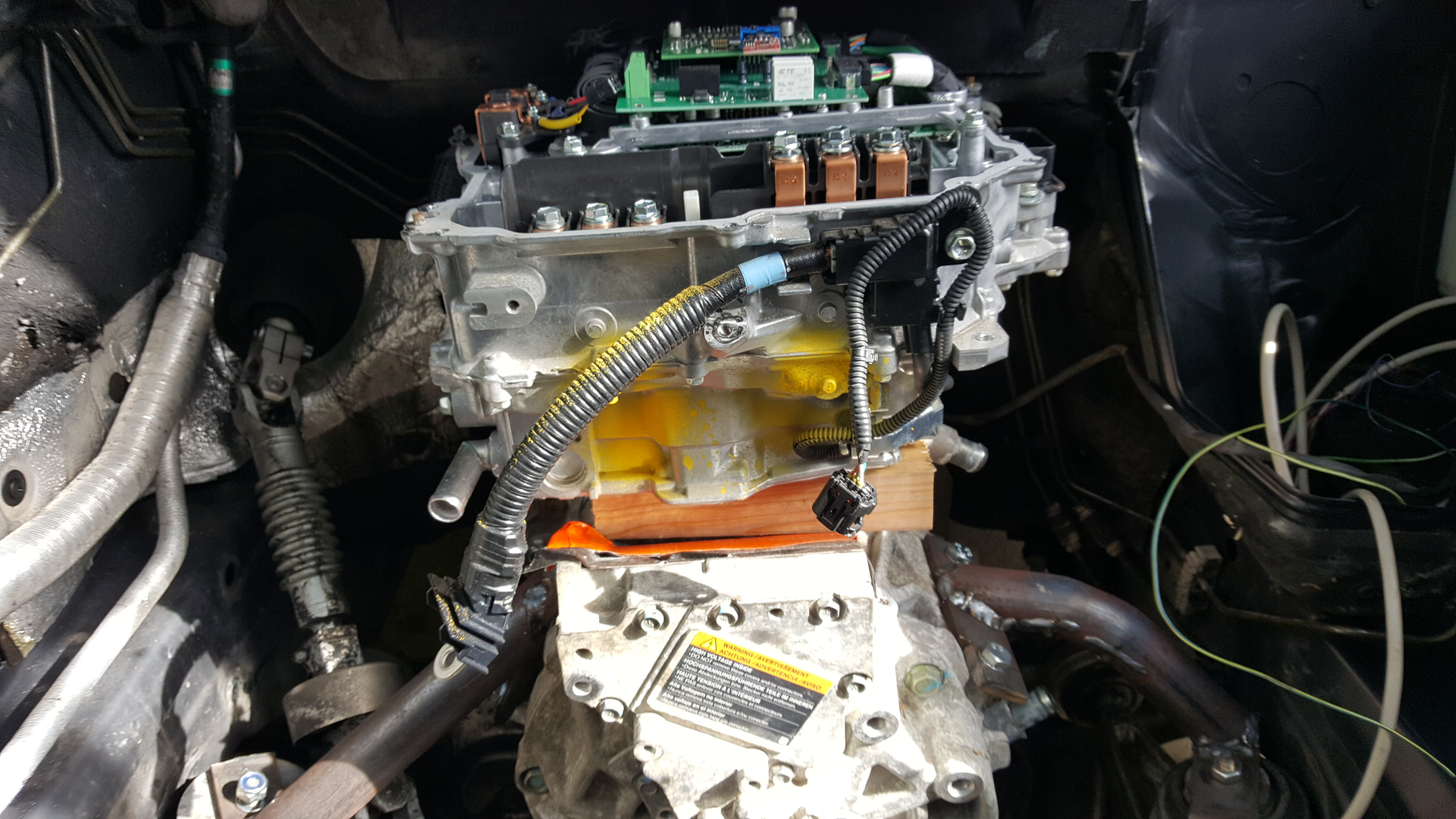

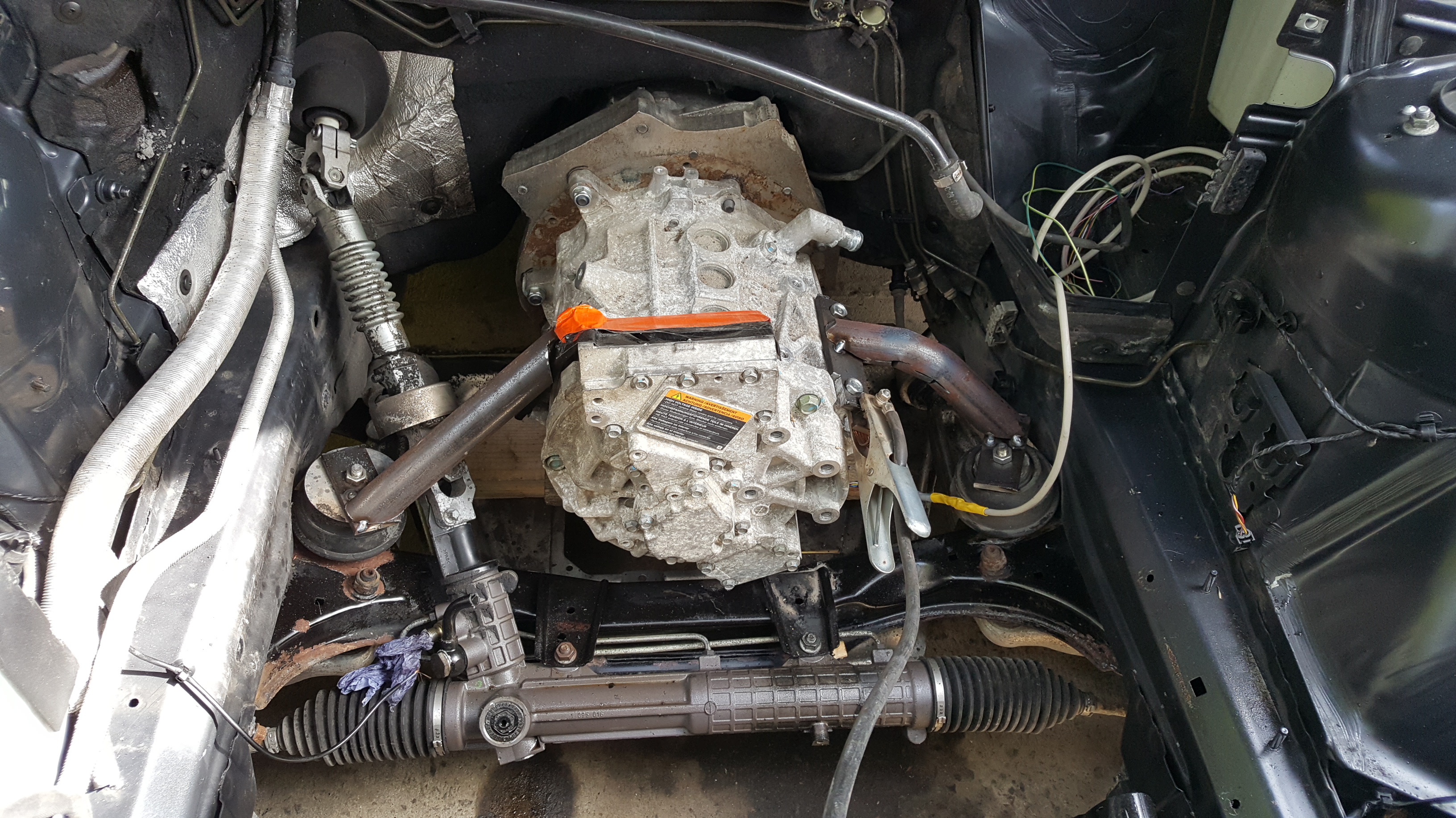

Some more progress. Motor now mounted and have started mocking up the positioning of the Lexus inverter.
Very nice diy motor mounts.
what are you going to fill the empty space with?
dima
Posts: 157
Post by dima »
Styrofoam :D
