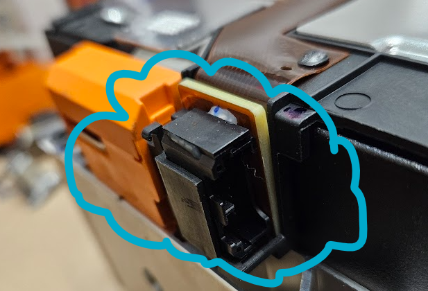

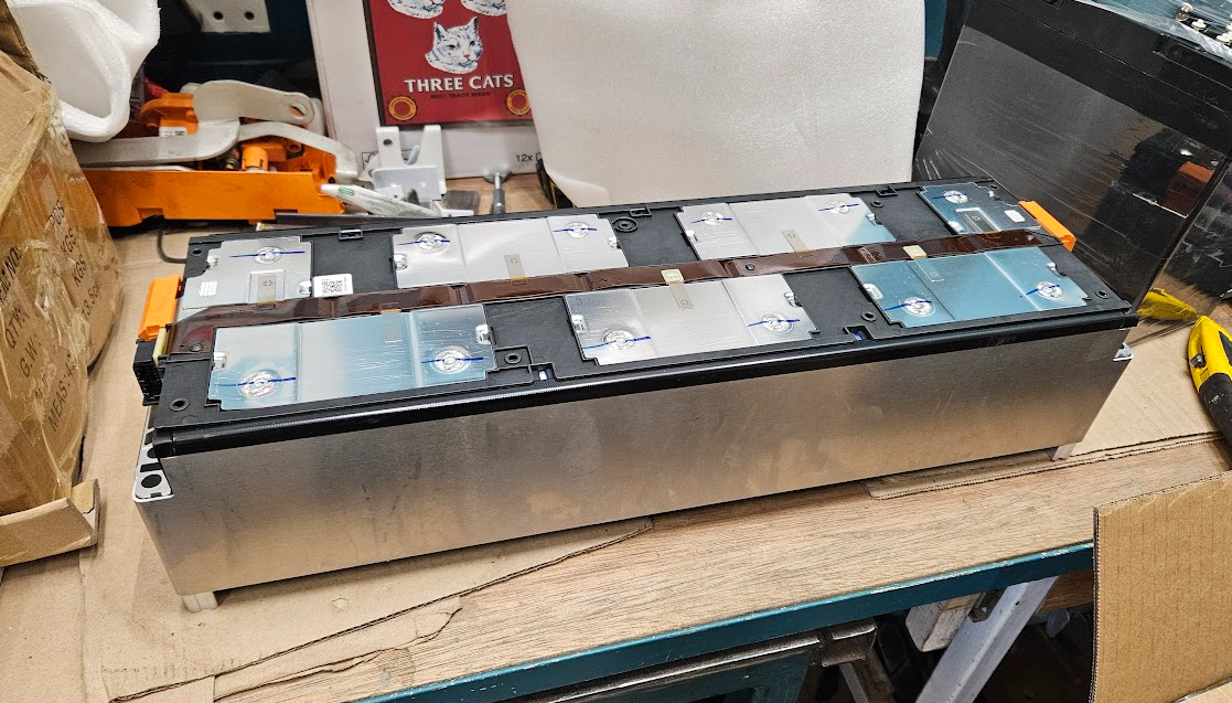

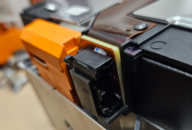

Hi All,
So as part of my project, I finally got my 16 x CATL 6s1p 180Ah modules from China via Alibaba.com last week and they have this BMS connector here to pull out the celltaps and I think maybe temp sensors:
So here is my question: does ANYONE know what the plugs are for these modules? I have been hunting, asked the folks in China etc and no luck so far :
Also if anyone has used these and made cooling plates and or busbar arrangements it would be great to hear how they linked the modules together etc :D
My project is here for reference: viewtopic.php?p=52050#p52050

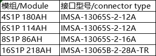

I’m using the same modules—mine are 24 units (1P4S configuration). As far as I know, they don’t require active cooling.
I've attached an image showing the connectors—try checking that.

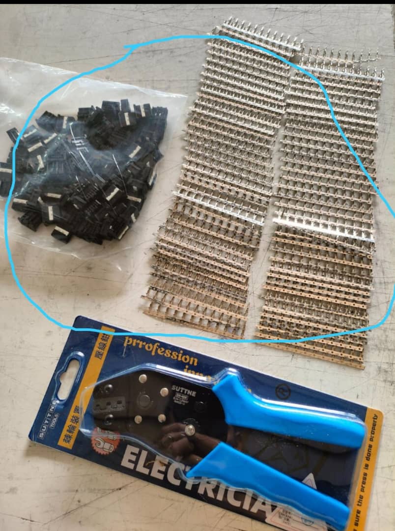

Hi, I managed to get a bunch of connectors but they don't come with pins - just the white tab that you can push down in the middle. Did yours come like this or were they pre-terminated with cable leads? If you had to terminate all the cables, do you have any tips on the length of the bare wire, wire size etc? I have hunted online and basically no info unless I'm just not looking properly! :)
I tried asking the supplier but I just got a bunch of kind of google translate messages back which didn't help or make much sense....
maiks
Posts: 96
Joined: Thu May 11, 2023 9:20 am
Has thanked: 7 times
Re: CATL 6s1p 180Ah Module - BMS Plugs Anyone?!
Post by maiks »
elShankos wrote: Sat Oct 04, 2025 4:45 pm Hi, I managed to get a bunch of connectors but they don't come with pins - just the white tab that you can push down in the middle. Did yours come like this or were they pre-terminated with cable leads? If you had to terminate all the cables, do you have any tips on the length of the bare wire, wire size etc? I have hunted online and basically no info unless I'm just not looking properly! :)
No, the connectors were not terminated. I received the connectors and pins together in one package, but they came unassembled as shown in the attached image. I used 22 AWG wire, with each cable measuring approximately 25–30 cm in length. Please note that terminating these connectors manually is quite time-consuming, so if possible, it’s better to purchase pre-terminated connectors. After crimping and testing all connections to ensure each wire was secure and free of short circuits, I extended the wires from each connector to the desired length.
