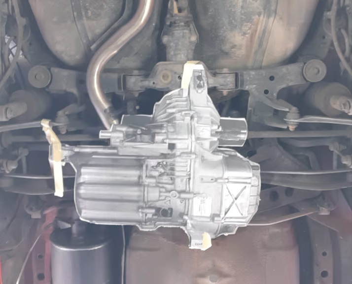

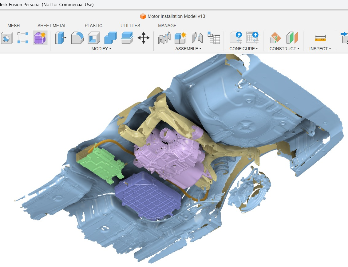

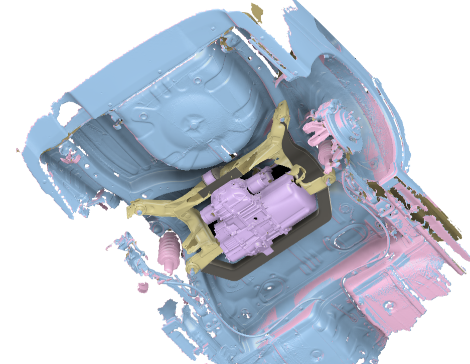

Hi All,
So.. I started out on the DIY Electric Car forum but it occurred to me that it would actually be better to put my build here as it's based around the OI conversion route. I had a bit of a thread here: https://www.diyelectriccar.com/threads/ ... on.208076/
But anyway, here goes! I have been planning / dreaming of this EV conversion for quite a few years and have now finally started here in Cape Town, sunny South Africa:

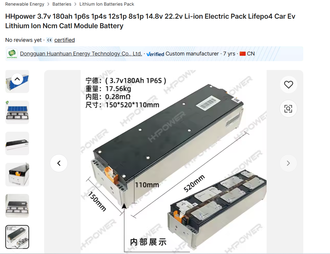

- Donor : 3rd Gen Subaru Legacy GT Wagon - AWD > will become rear wheel drive... - Motor: Tesla rear Small Drive Unit (SDU) + Damien Maguire OpenInverter Control board I recon this should fit OK in the back as I printed out a 1:1 cardboard version and stuck it under the car at my local tyre shop recently (they thought I was nuts): - Battery: 16 X 6s1p CATL units (400V pack) out of China - still need to buy these but they are pretty much the only thing I can import into South Africa:
https://www.alibaba.com/product-detail/ ... 08616.html
- BMS: EVS BMS (previous idea was SimpBMS but this isn't really available anymore) + 16 x Tesla Rev B boards - my idea is to hook up each of the boards to the 6 cells in the above CATL batteries

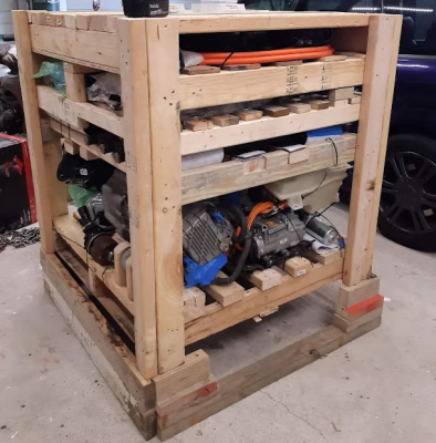

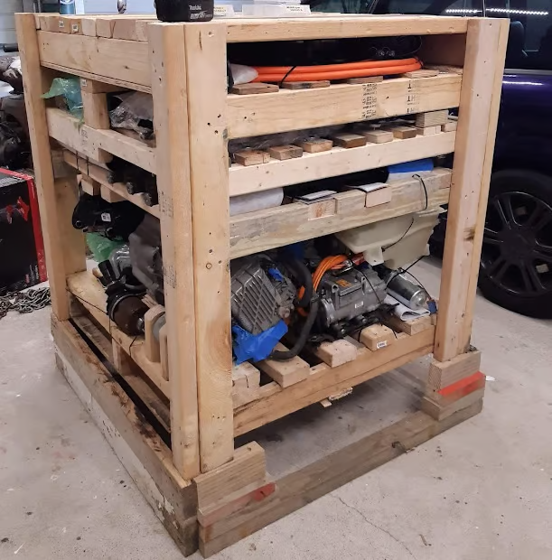

So far I have managed to get pretty much everything above into a crate (except batteries) in Minneapolis, USA, then shipped all the way to Cape Town (quite a nightmare) and now its in my garage so I'm slowly getting started finally: Would be great to get some feedback, suggestions, ideas etc from the community! I'll stick in my updates below too.

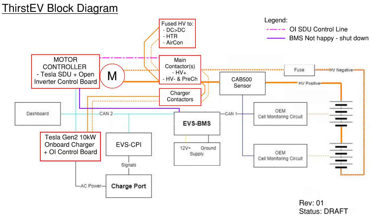

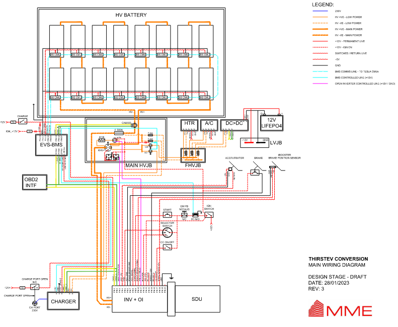

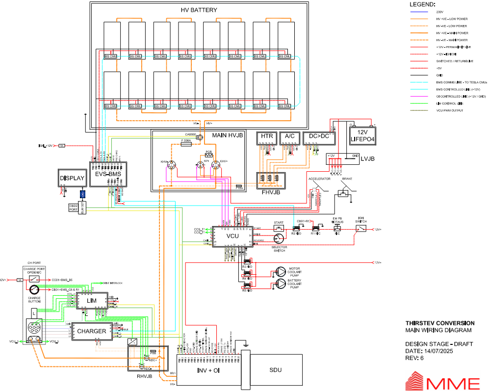

Wiring Diagrams:
So I started with a concept diagram that looks like this to get my head around things: And then over the past few weeks while swopping out the inverter control board (what a pain those SDU current sensors are!) I have been working on a main wiring diagram which at present looks like this (I attached the larger PDF if you want to have a look): I still have a bunch of work to do on this so it's still in DRAFT stage but its getting there - lots of people on this forum have really helped me a lot so far to figure things out - and also hrs and hrs of trawling
The answers are all here! You just have to find them
THEV_Main Wiring Schematic - Rev3.pdf- (219.79 KiB) Downloaded 366 times
- Posts: 2962
- Has thanked: 328 times
- Been thanked: 847 times
Re: Subaru Legacy + Tesla SDU Conversion
Quick questions on your HV wiring.
-Why is there no contactors on the HV negative?
-You need precharge on the auxiliary components too

Hi, thanks for the queries. On the main -HV contactor Q, I'm kind of following aber333's advice as I can't really see the benefit of having a second contactor either - please see thread here: viewtopic.php?t=3101
It wouldn't be difficult to do with just using the same pre-charge signal from the OI but latching it on the -HV contactor. I've kind of gone back and forth on this.
I was actually going to make a post about this as there seems to be a real spread of opinions on this one - would be happy to hear your thoughts.
Mmm for the auxiliaries, I wasn't sure that pre-charge was necessary for these? I guess I could put a pre-charge resistor and relay across the contactor that feeds the aux's and switch it via the BMS when in charging state? Definitely one to investigate - thanks for the heads up.
I've changed this wiring around a bunch of different ways and I think there are quite a number of ways to do this.

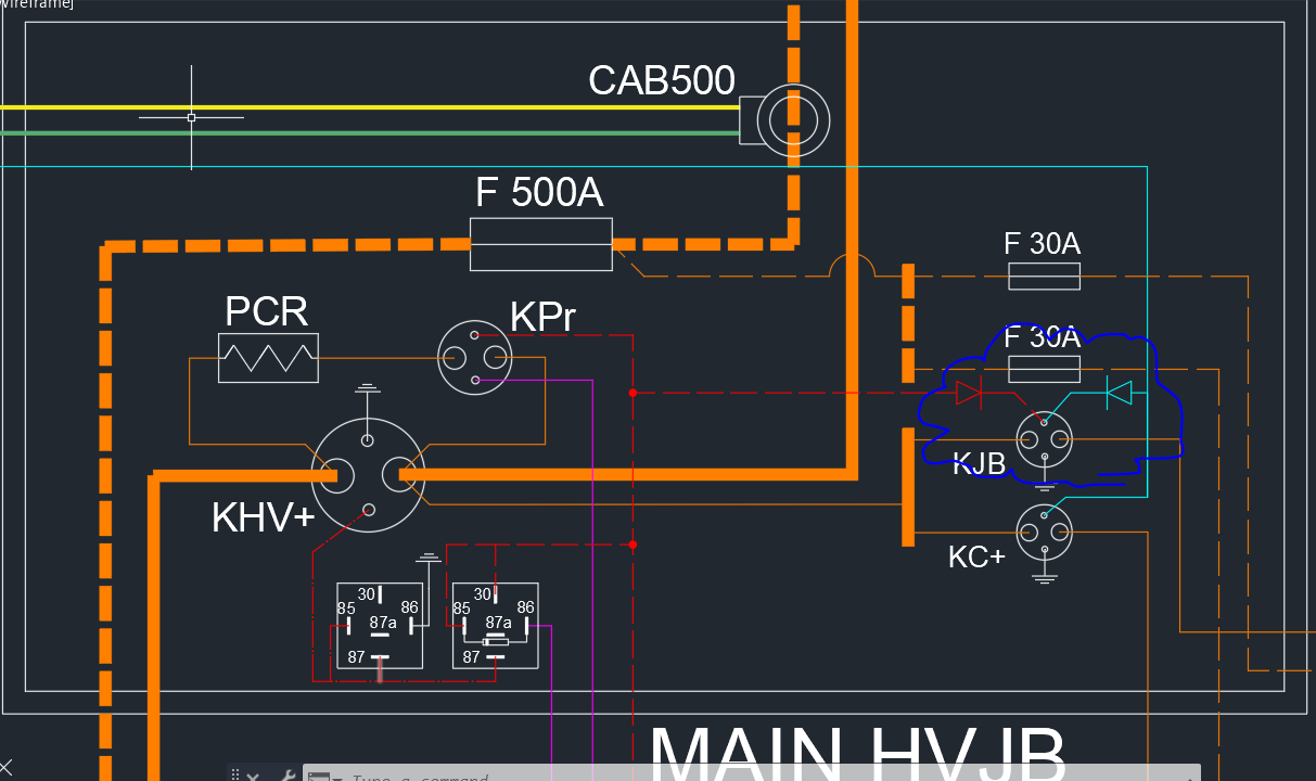

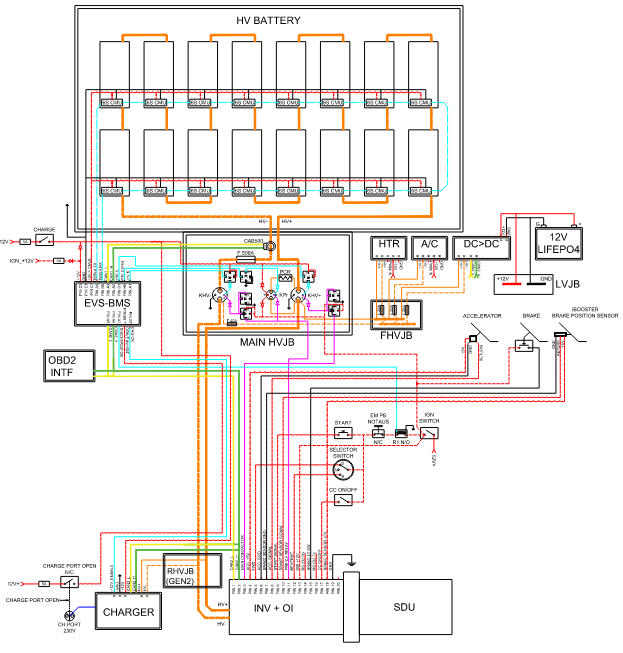

So I decided to make an alternative wiring diagram with the following 2 main differences to the Rev 3 above:
1) I've added a main -HV contactor (to be like an actual Tesla arrangement - must be a reason its there right?
) and also switching all the contactors in an OR arrangement - either from the BMS (non latched main contactors) or Inverter (latched main contactors)
2) Using a Tesla GEN2 rear junction box (got one for cheap in the US) to tie in the charger so now there is no extra line from the front of the car to the back.
So I think this will work (with lots of 12V relay wiring) and provide pre-charge to the auxiliaries as well in both driving and charging modes but my only concern is: what about in driving mode, switch on ignition and the pre-charge closes, then opens and then maybe the BMS takes a turn trying to close it... might have both the Inverter and BMS opening and closing the pre-charge contactor a bunch of times? Maybe not but I'm not sure about this one - bit hard to say.
Otherwise it seems like maybe a better solution - would be good to hear folks' thoughts
THEV_Main Wiring Schematic - Rev4.pdf- (219.41 KiB) Downloaded 423 times

Very interested in seeing how you get on with this. I have a 4th gen Legacy spec B which I've had for 16years now. Would love to convert it but the ridiculous UK rules on not changing the road tax following an EV conversion mean it doesn't make sense to.
Curious about your connection to the iBooster pedal position sensor, is this piggy backing off the same sensor that is normally wired to the iBooster ECU or is there a seperate one?
Edit - BTW your proposed HV wiring diagram now matches my plans (different hardware but functionally the same).

Nice one Pete - I always liked those 4th Gen Spec Bs. Mine is a 3rd Gen Legacy GT - E-Tune spec which I got in Japan and which I've had for 13 years now and I'm pretty attached toPete9008 wrote: ↑Sun Jan 29, 2023 7:44 pm Very interested in seeing how you get on with this. I have a 4th gen Legacy spec B which I've had for 16years now. Would love to convert it but the ridiculous UK rules on not changing the road tax following an EV conversion mean it doesn't make sense to.
For the iBooster signal, I haven't actually done it yet - I'm hoping for a reply in this thread here where it seems like the guy piggy backed off one of the iBooster pedal position sensors: viewtopic.php?f=10&p=24310#p24310
Or I'm just reading it wrong...

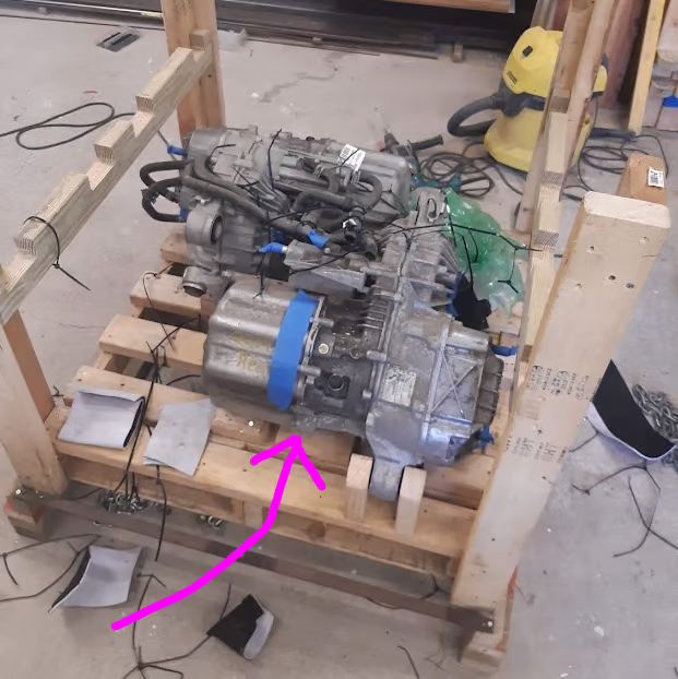

Just a mini update: so I got my bench test of the SDU done - I powered it off my Lifepo4 48V DC home battery system as a test and made this powerfully average Youtube video here:
Just a heads up: while "revving" the pedal its actually pretty easy to start pulling a lot of amps suddenly - so make sure you have a set up where this won't trip suddenly and possibly damage your inverter. Probably why the documentation says to put a kettle element in series - I didn't have one.

Great to see a open discussion on this as I've also been agonising over all the possible ways of architecting my own system. My current layout looks basically the same as yours, but I'm using M3 DU with an as yet undetermined VCU (a bit heretical to say it on OpenInverter even as a Damien patron, and being in awe of @johu but I'd really like to crack the pairing process as T2C and Ingenext have doneelShankos wrote: ↑Sun Jan 29, 2023 7:00 pm So I decided to make an alternative wiring diagram with the following 2 main differences to the Rev 3 above:
1) I've added a main -HV contactor (to be like an actual Tesla arrangement - must be a reason its there right?) and also switching all the contactors in an OR arrangement - either from the BMS (non latched main contactors) or Inverter (latched main contactors)
Otherwise it seems like maybe a better solution - would be good to hear folks' thoughts![]()
Anyway, my guiding principle is to leverage as much work as possible that has been done by Tesla, including architecture. So having unswitched HV outside the battery box is something I'd like to avoid. Also relays are a big source of reliability issues IMO and I'd want to eliminate those, especially in the contactor drive, and instead rely on CAN messages and MOSFETs.
My other aim is to keep the system as safe as possible, so having the BMS in control of the contactors seems worth the risk to the Inverter (rather lose the inverter than have a battery fire), and given that it is on the same CANbus as the DU, presumably it can shut down the drive before opening the contactors.
Also safety wise I'd like to see HV leakage detection, don't know if/when Tom is going to add SimpISO to his SimpBMS?
One interesting tidbit in the MS Theory of Operation is
When the vehicle is on and the contactors are closed, the DC-DC supplies the current necessary to operate the entire 12V electrical system. When the vehicle is off and the BMS is in standby mode (contactors open), if the 12V battery voltage drops below 12.3V, the gateway module requests the BMS to enter support mode. In this mode, the BMS closes contactors and supplies current to the DC-DC converter, which in turn maintains the 12V battery within its nominal SOC range.
So the BMS also would have to be looking for this notification from whichever entity is monitoring the 12V or be monitoring it directly (not sure if EVS-BMS does this autonomously?)
Final missing item for me is CCS support for which the LIM seems to provide most of the management, but that would need to be supported in the VCU.
BTW love your diagrams, what software did you use to make them?

Looks great!elShankos wrote: ↑Sun Jan 29, 2023 7:00 pm So I decided to make an alternative wiring diagram with the following 2 main differences to the Rev 3 above:
Small note. A/C and PTC heater (if you're gonna add one) are fused with 40A in the FHVJB.
https://www.diyelectriccar.com/threads/ ... ox.193729/
Any chance you found a reasonably priced pre-made harness for the SDU LV wiring?
I see people here mention that there's an OEM one from some other vehicle which works for LDU.
Hi, yeah there are 100s of ways to do this and I've spent quite a while on this with my main drivers being:jetpax wrote: ↑Fri Mar 24, 2023 5:58 am Great to see a open discussion on this as I've also been agonising over all the possible ways of architecting my own system. My current layout looks basically the same as yours, but I'm using M3 DU with an as yet undetermined VCU (a bit heretical to say it on OpenInverter even as a Damien patron, and being in awe of @johu but I'd really like to crack the pairing process as T2C and Ingenext have done).
- as simple and analog as possible (in terms of contactor control)
- Not adding any more micro processors / CAN control / programming to my list of things to do and also to try and keep it simple (for me!)
CCS is definitely something I have been thinking about so am aiming to use that Tesla GEN2 Rear HV JB with the contactors in it but for now just charge at 230V and figure out the rest down the road. CCS stations are around in SA but not many - they will pick up in the next few years.
On the EVS-BMS I really need some batteries (not here yet) to get that system fired up so I can start figuring out what it can and can't do properly.
Seems like everyone on here with an SDU / LDU is keen on never opening contactors while driving no matter what so I have that signal to cut the drive 12V in case the battery isn't happy, then pull over, ignition off - get the hell out of the car?! That's my planned sequence of operations in an emergency while driving.
While charging, 12V to the SDU will be off and the BMS will control the contactors so if its not happy it can open them.
I make my diagrams in plain old AutoCAD - thanks for the compliment, I'll take it! I'll move onto a "construction" version at some point soon where I will draw out the actual positions of the relays in the main box and things like that.

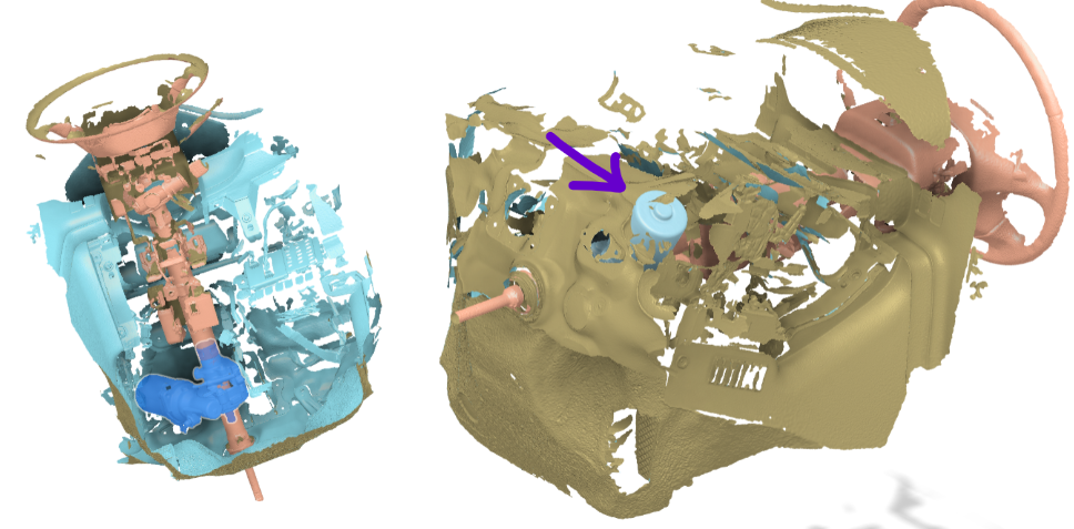

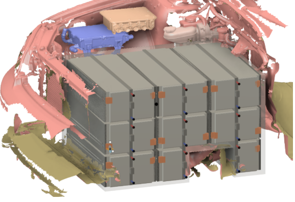

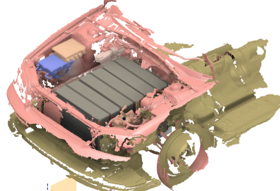

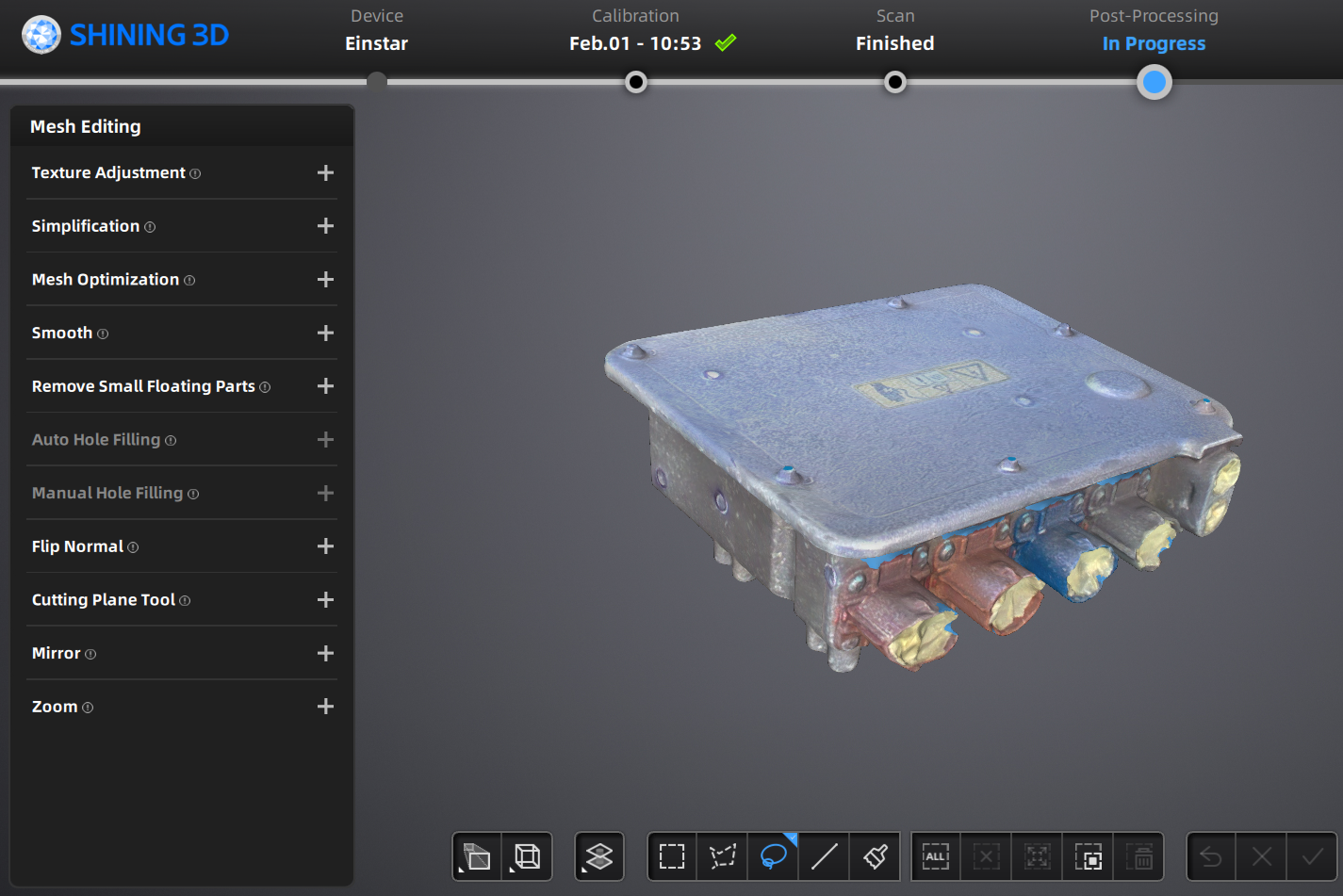

4) Decided to take SuperFastMatt's advice and get a 3D scanner in the garage -
- so now I'm slowly learning how to use the thing - here's a gen 1 Tesla front HV JB scanned with an Einstar Shining 3D scanner:
My plan is to pull the engine in April once it stops regularly being 35 degrees + in the garage!
Then I'll be able to scan the available engine bay space to plan the battery pack properly - so I'll do another update after that.

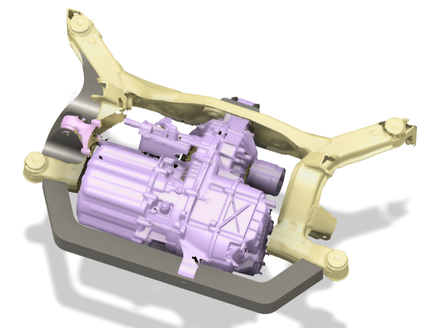

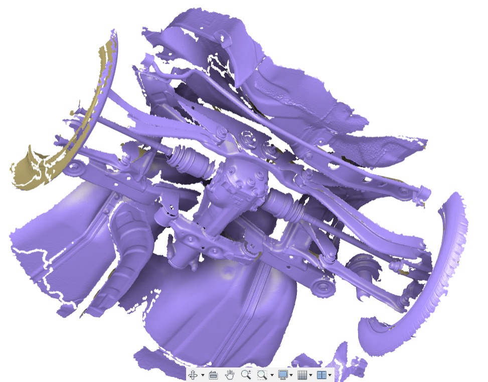

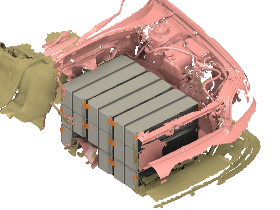

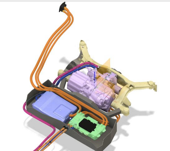

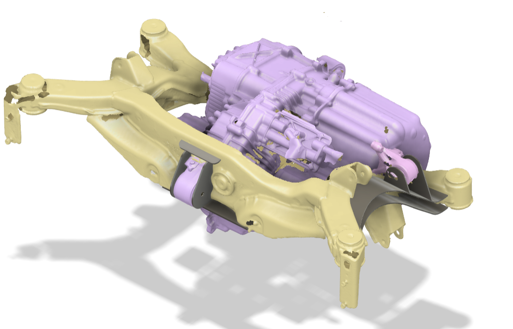

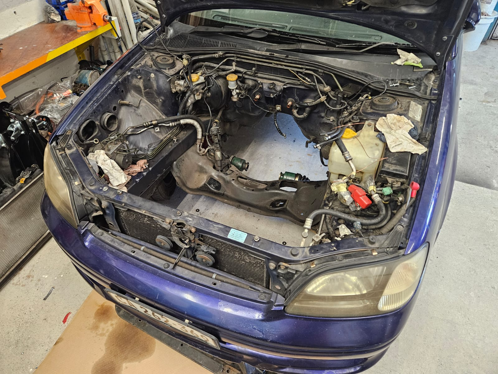

Hi All, been a while since I did an update so here goes:
I got the engine, transmission, propshaft and rear diff + fuel tank out: And then I spent a LOT of time scanning all sorts of things - I'm getting a lot better at scanning after overcoming the initial learning curve!
So now have scans of the whole car, the engine bay and also the whole rear underside section where the motor needs to go: I've mostly settled on 1 fat battery back in the front of the car - will be about 350kgs: I bought the batteries finally on Alibabi.com - shipped to South Africa DDP - what could go wrong... right?!

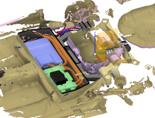

In the back I messed around for a long time trying to fit the Tesla rear SDU in and once I removed the fuel tank and made a further scan, I figured out that if I run the SDU in reverse, I can actually fit it quite nicely without having to alter much of the suspension (which I thought I would have to do):
This shows the motor, and the onboard GEN 2 Tesla charger and rear junction box which fit in the space of where the fuel tank used to be: Am I a grandmaster at 3D scanning - NO! Am I super good at Fusion 360 - NO! Am I learning all sorts of new stuff - YES!
Hi All,
OK time for an update then
Mostly in CAD / ordering things, drawing etc.
1) Batteries + CCS2 inlet are finally on their way from China - took a LOONG time to get it moving - customs, Alibaba etc. I'm fully expecting all sorts of nonsense when it gets to the port in South Africa.
2) I've been working on my wiring diagram a lot as the further I got into this the more I realised that I needed something overall like the ZombieVerter to control all sorts of things and also interface to something to manage the charging so.. I have updated the wiring diagram and shared it in here in case anyone has some useful comments - I got loads of useful input previously :D
Main changes are:
- Moved to using VCU to control contactors - but now they aren't latched anymore... I guess lots of people use this arrangement with a Tesla drive unit and don't have blown control boards! Would really welcome folks' comments on this one
- Got an i3 LIM in the US for $80
- Will order a Muehlpower current sensor board shortly
- Not so sure about using the CAB sensor + EVSBMS output instead of the standard Shunt that seems to be the standard? Wonder if this will work or if I should just get a standard Isabellenhuette shunt? 3) Been drawing in all the details of the cables and coolant hoses at the rear of the vehicle - lots of things to coordinate and get right here!

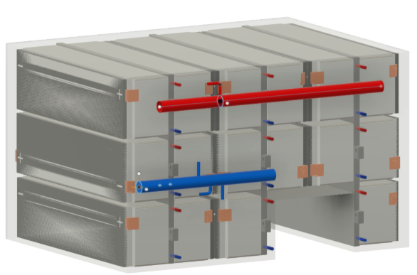

4) Paused working on the front battery box until I get the actual modules - then I should be able to finalise a bunch of things like the cooling plates, cooling headers, how to get the thing into the engine bay!
5) Spent AGES trying to get the damn Nissan Versa EPAS unit to fit in somewhere but no dice unfortunately - so now I'm hunting what looks a bit smaller: the KIA Soul EPAS units - hopefully that will fit in under the dash with some modification of the steering column: Ticking along slowly - I guess this was always going to be a long project!
Main changes are:
THEV_Main Wiring Schematic - Rev6.pdf- (366.51 KiB) Downloaded 29 times
