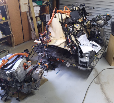

Now for some pictures for those interested.
a new look "Battery Kona"
No HV connections yet, don't want to let the magic smoke out too soon.
A most surprising result from first power up.
I was quite surprised by how much came straight up.
Running my scan tools didn't show very much and I wondered why I wasn't getting anything from the BMS or motor.
I had started by putting in one fuse at a time while checking the current draw. When I got to the IG3 fuses that's when everything came to life, with a load warning buzzer.
Then I realized I populated all the main fuses but hadn't got to the fuses in the PCB block.
Added them and current draw increase but still nothing. While looking for an easy place to T into the P-CAN bus I discovered that it doesn't go directly between the main and front loom. It goes right around the car via the floor loom.
After all the rabbit hole mentioned previously I'm now getting lots of good data.

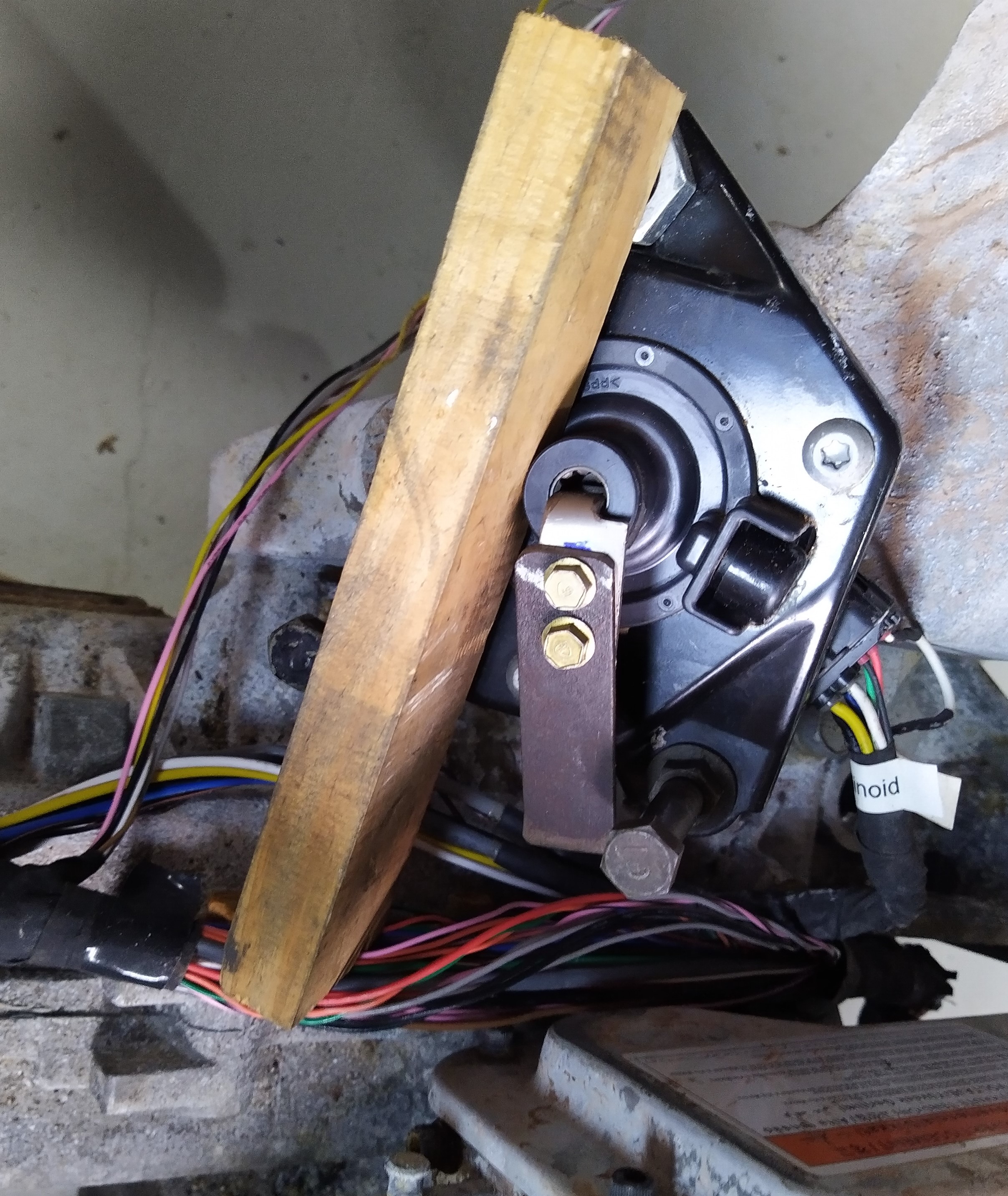

I've been playing some more and now have the transmission park fooled into thinking it is locking and unlocking the transmission while it remains locked. Not long to HV power up
Crude but effective

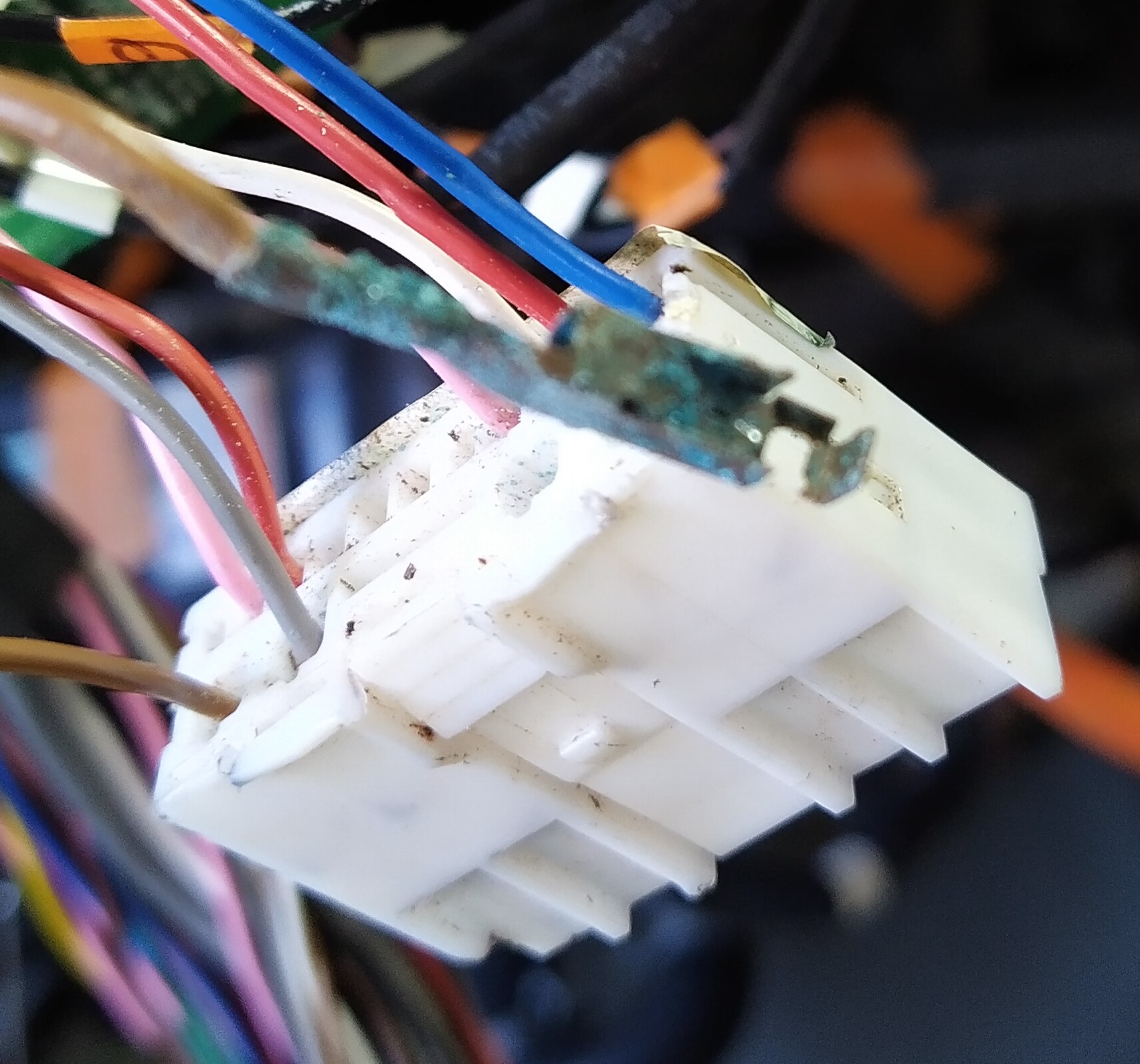

Replacement charge port has arrived so now I need to repair the lunched connector on the LVDC. I could only find an 11Kw one with 5 wires where my Kona was a 7.2Kw changer with only 3 wires. So a bit of grafting is going to be required.
