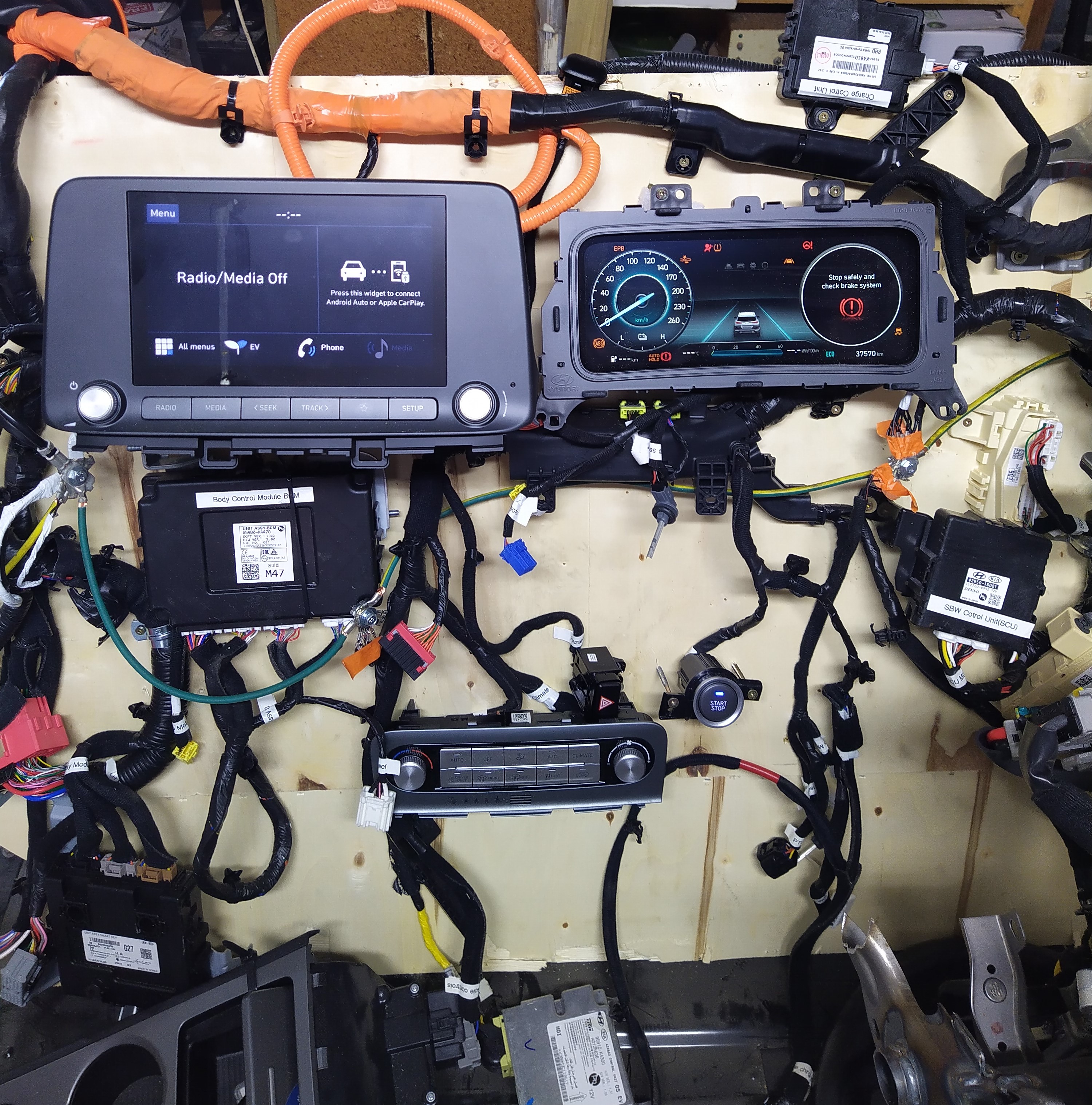

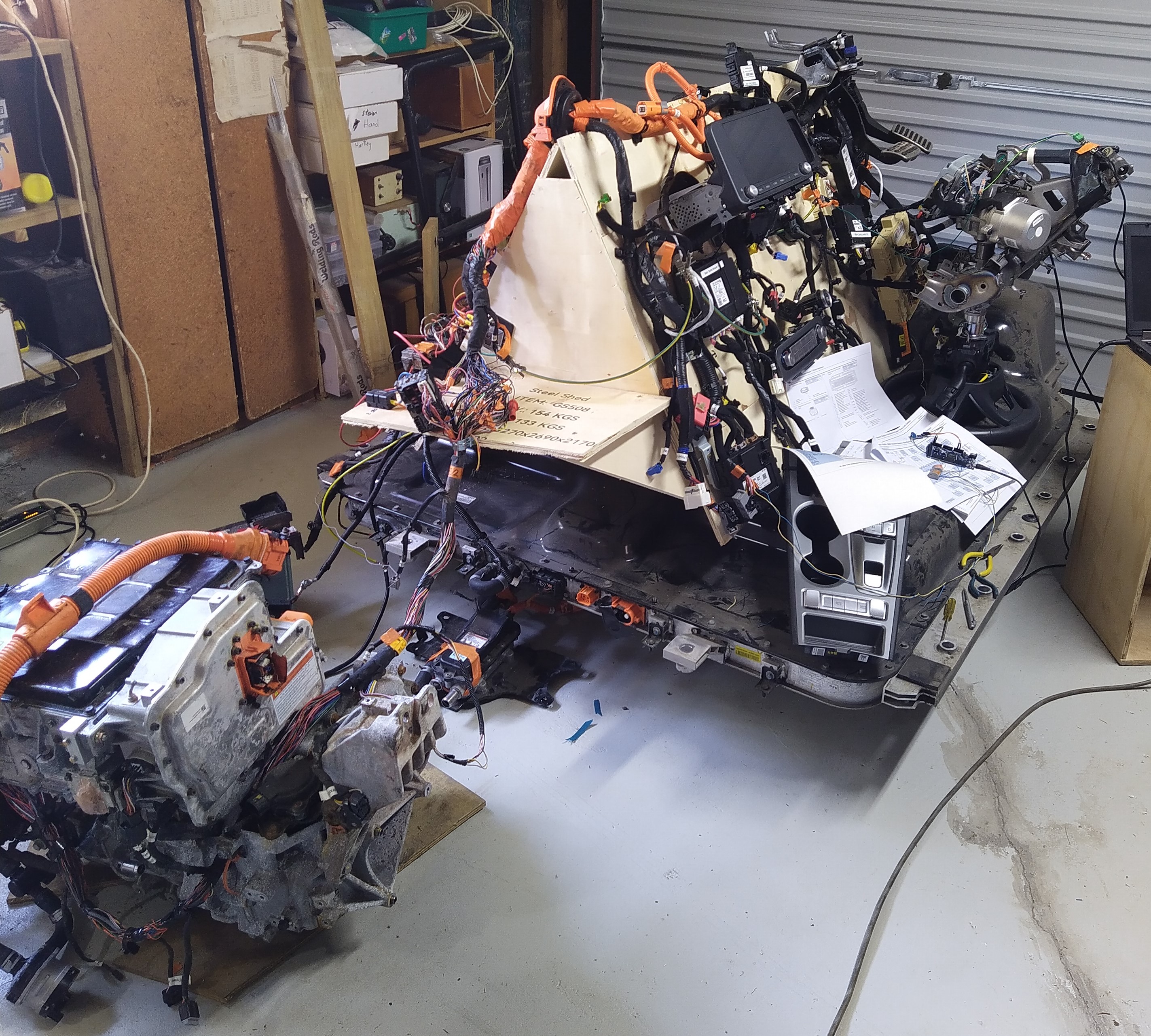

Now for some pictures for those interested.
a new look "Battery Kona"
No HV connections yet, don't want to let the magic smoke out too soon.
A most surprising result from first power up.
I was quite surprised by how much came straight up.
Running my scan tools didn't show very much and I wondered why I wasn't getting anything from the BMS or motor.
I had started by putting in one fuse at a time while checking the current draw. When I got to the IG3 fuses that's when everything came to life, with a load warning buzzer.
Then I realized I populated all the main fuses but hadn't got to the fuses in the PCB block.
Added them and current draw increase but still nothing. While looking for an easy place to T into the P-CAN bus I discovered that it doesn't go directly between the main and front loom. It goes right around the car via the floor loom.
After all the rabbit hole mentioned previously I'm now getting lots of good data.

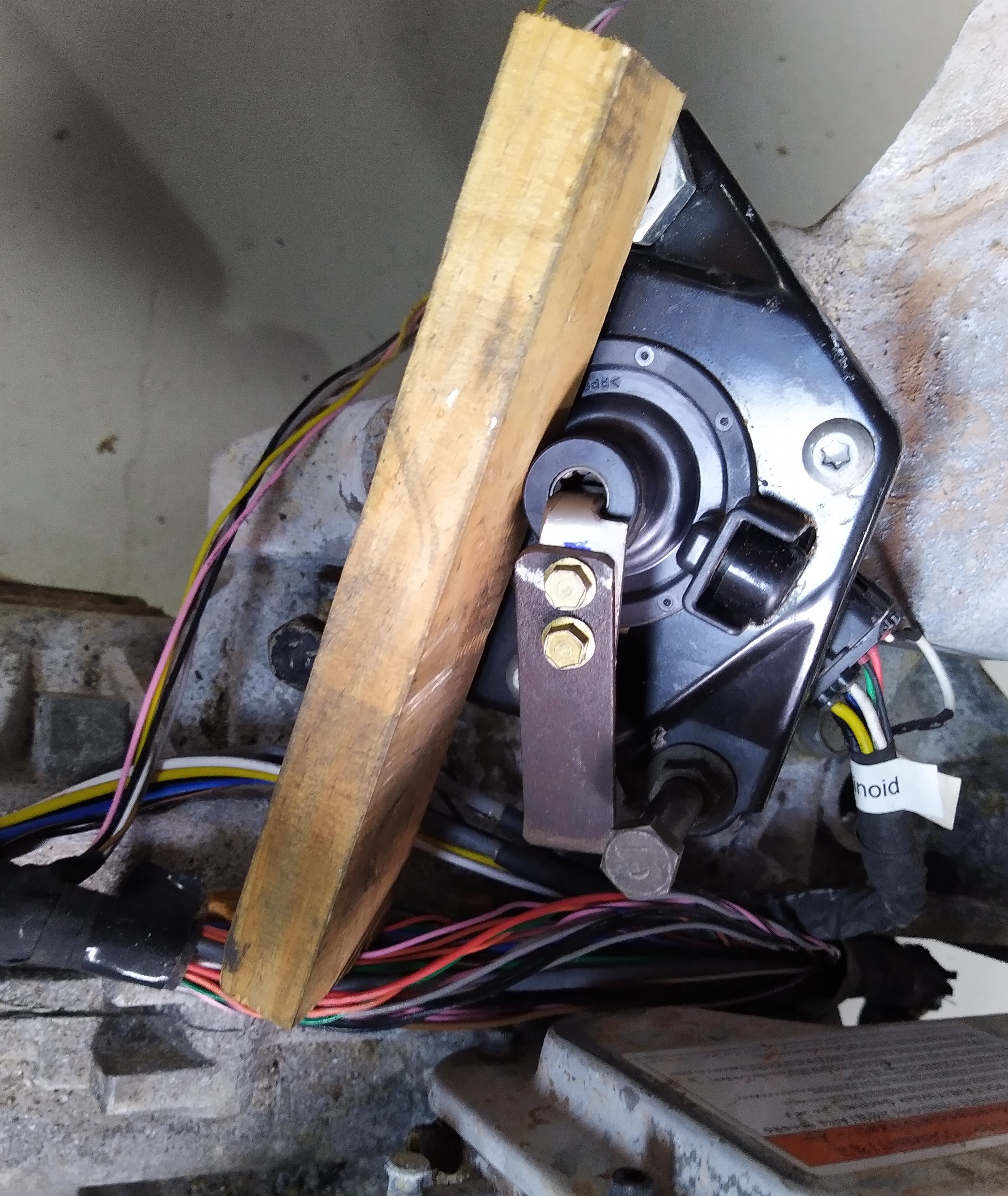

I've been playing some more and now have the transmission park fooled into thinking it is locking and unlocking the transmission while it remains locked. Not long to HV power up
Crude but effective

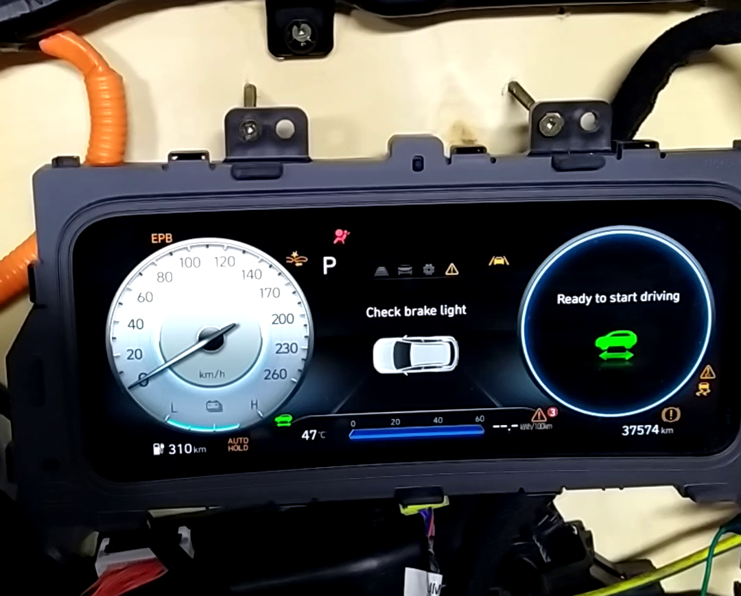

During the numerous power cycles I suddenly got the little green car and it went into run mode. It required all ABS sensors (or resistors) to be in place, but I still had the EPB errors.
Success woo hoo.
Power down and try again AND no success. I can occasionally get it to go into run but not consistently.
There's something else it's not completely happy about and I seem to be catching it off guard occasionally and get it to go into run.
Still a major step forward.

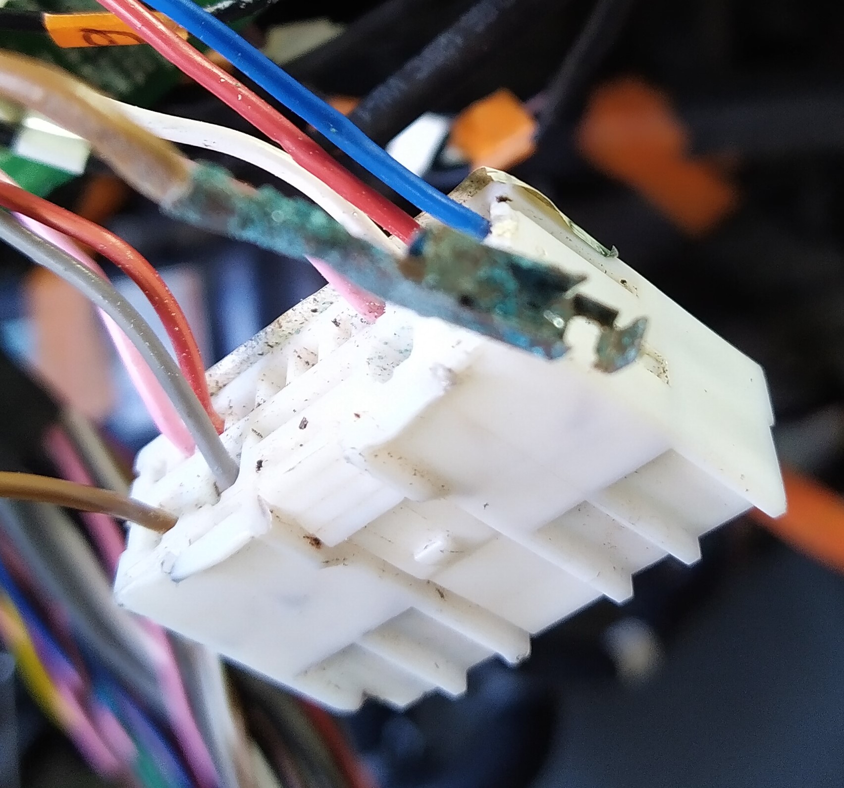

I had just pushed the male & female pins together with a bit of heatshrink. It had all been bathed in battery acid and I'd given it a bit of a clean but nothing fancy so thought the connections might be bad.
Looks like we have some work to do.

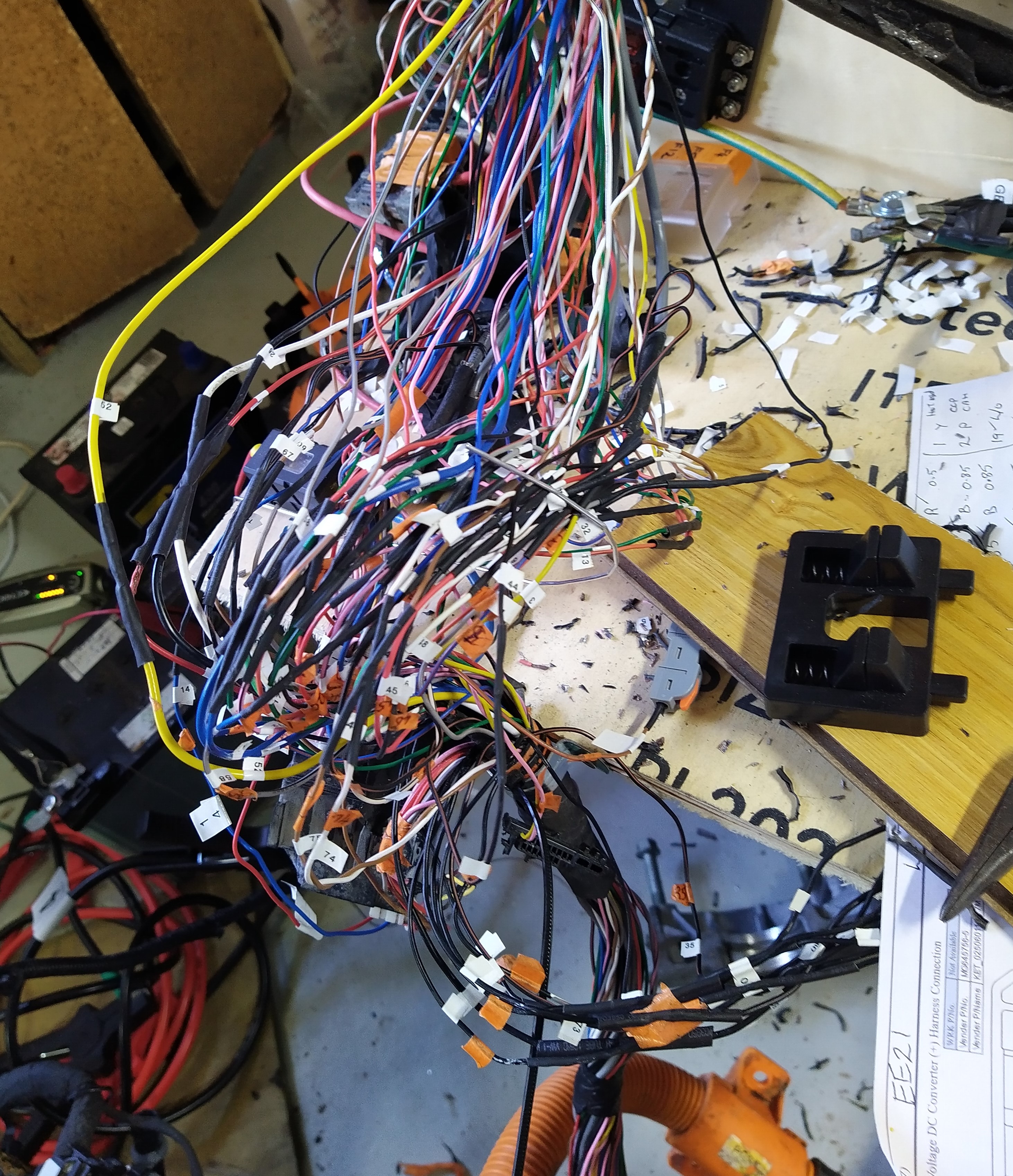

So I reterminated all the EE21 wires and E/R-A PCB block connector.
After 3 days I'd reterminated all the wires. Cut each one back to clean wire and solder the joint.
Still no success.

I've phantomed the IMMO and the "Crash" signal from the airbag module to the BMS. Things still turn on/off as expected.
I can completely remove the airbag controller and it will still power up and go into drive.
Have just unplugged the IEB and it will still power up and go into gear. Lots of alarms on the dash but still appears to go into drive correctly.
Looks like the 2021 Kona is a bit less fussy that Projectgus' 2019 with regard to needed signals on the CAN.
As a side note the 18in1 CAN filter modules on Aliexpress are a very cheap way of getting an STM32 with dual CAN drivers and 12V PSU all built in. Very limited I/O accessible but great for phantoming CAN devices or building bridges.
