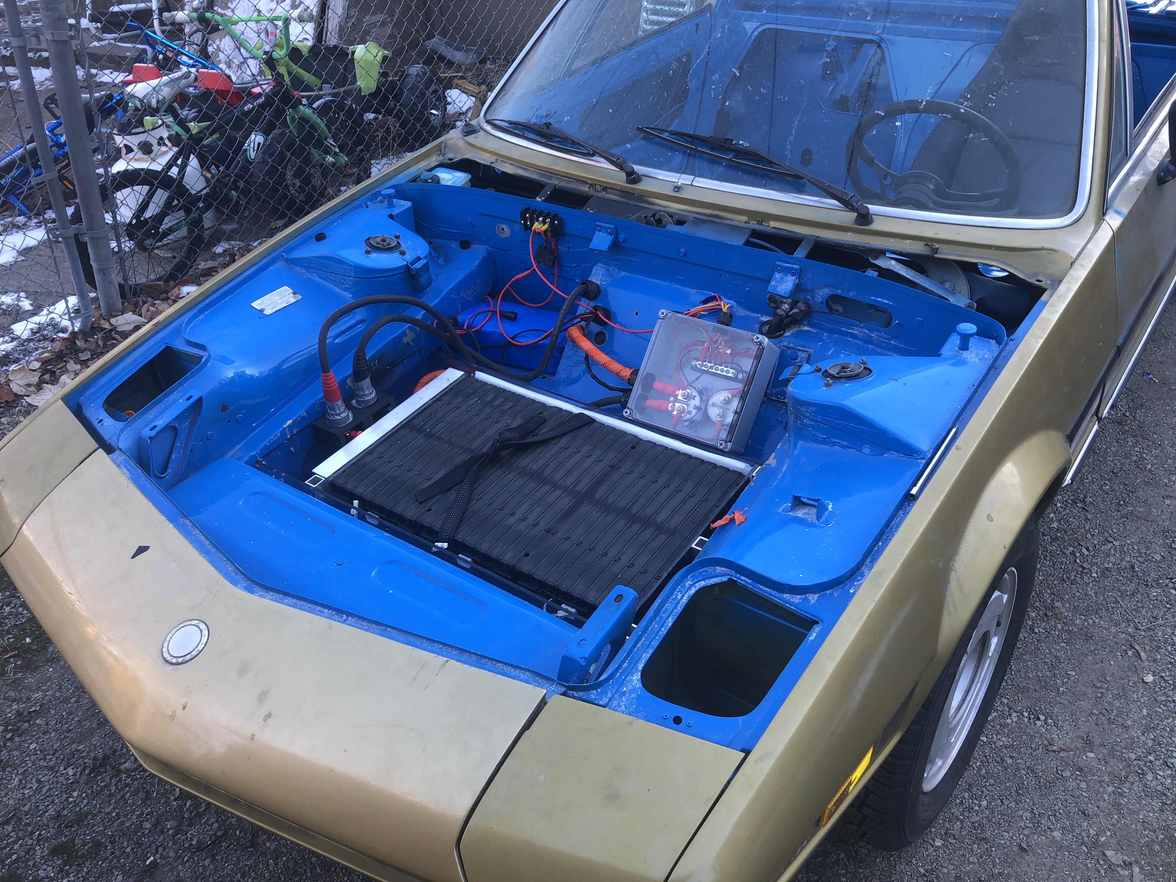

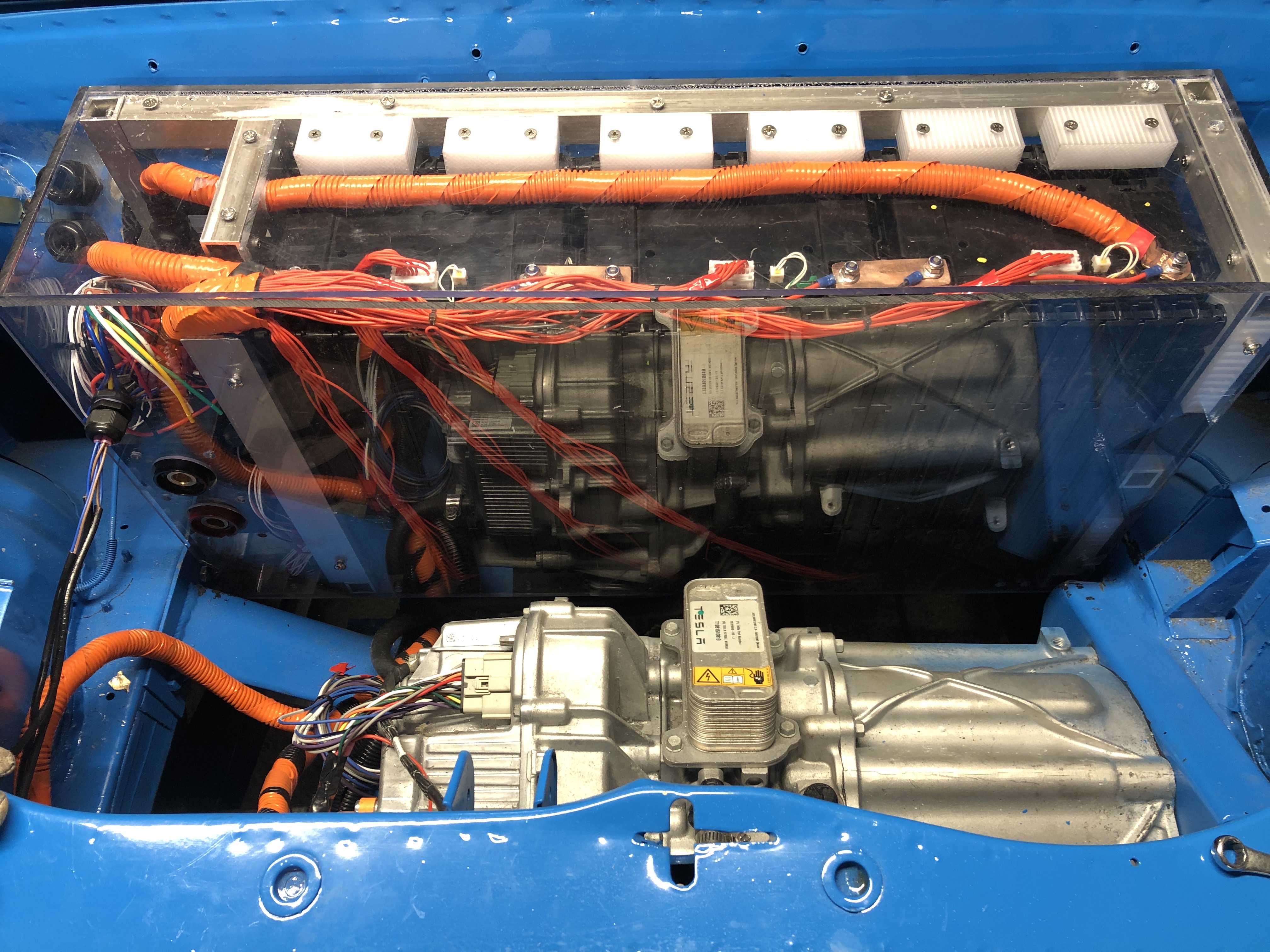

Got it fired up today on 200v:

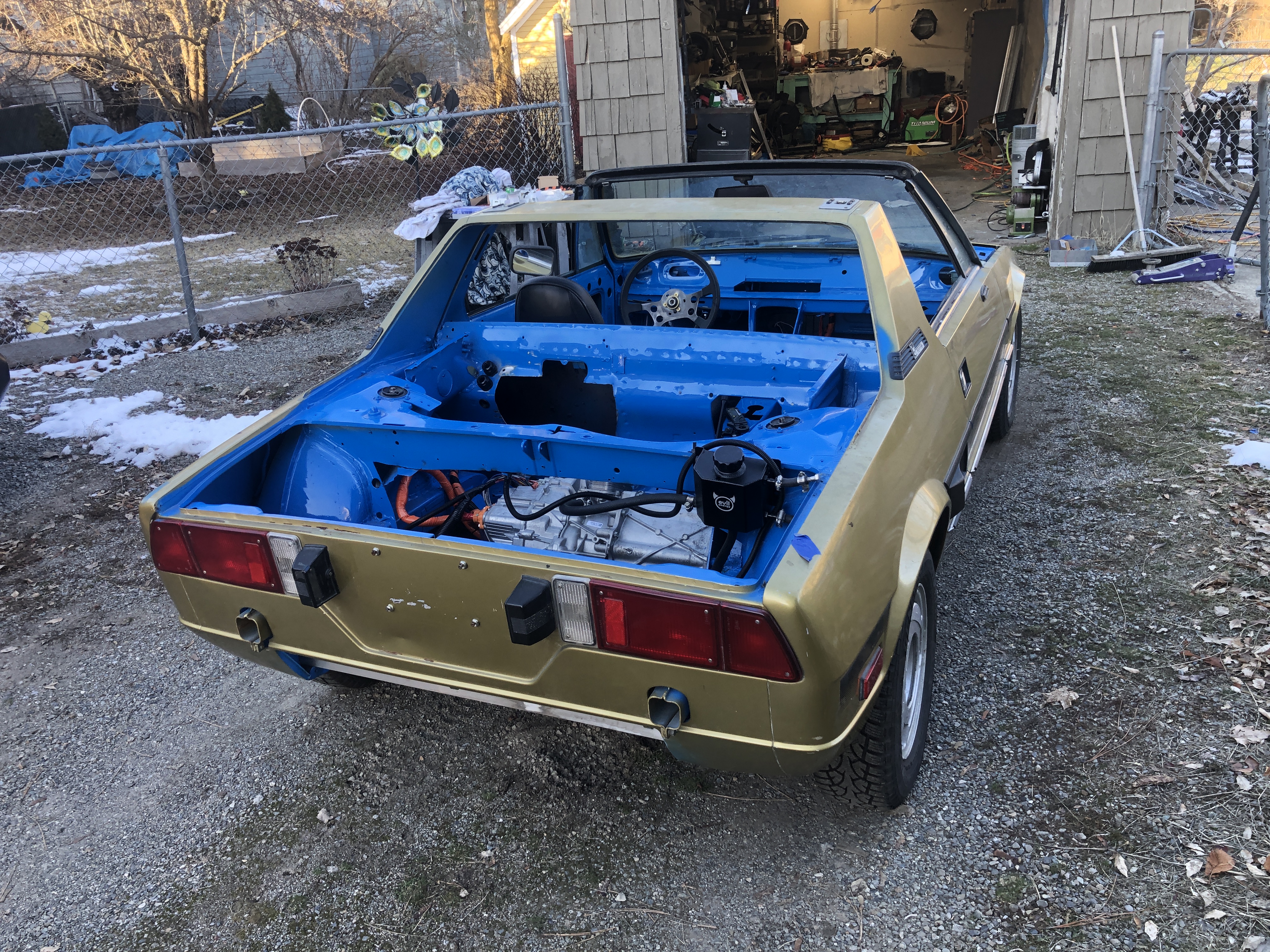

modellfan
Posts: 177
Has thanked: 20 times
Been thanked: 61 times
Re: Tesla SDU in Fiat X19
Post by modellfan »
Weird motor orientation. You sure that this doesn't impact oil circulation?
Post by phillipschip »
It puts the pickup at the very bottom so should be ok.

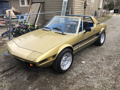

Re: Tesla SDU in Fiat X19 (Test Drive a Success)
Took a spin out front of my house today for the first time. Only one battery box(170v), no proper mounting yet, etc. A lot of work ahead of me but nice to get it moving!

Working on getting the second 200v installed.

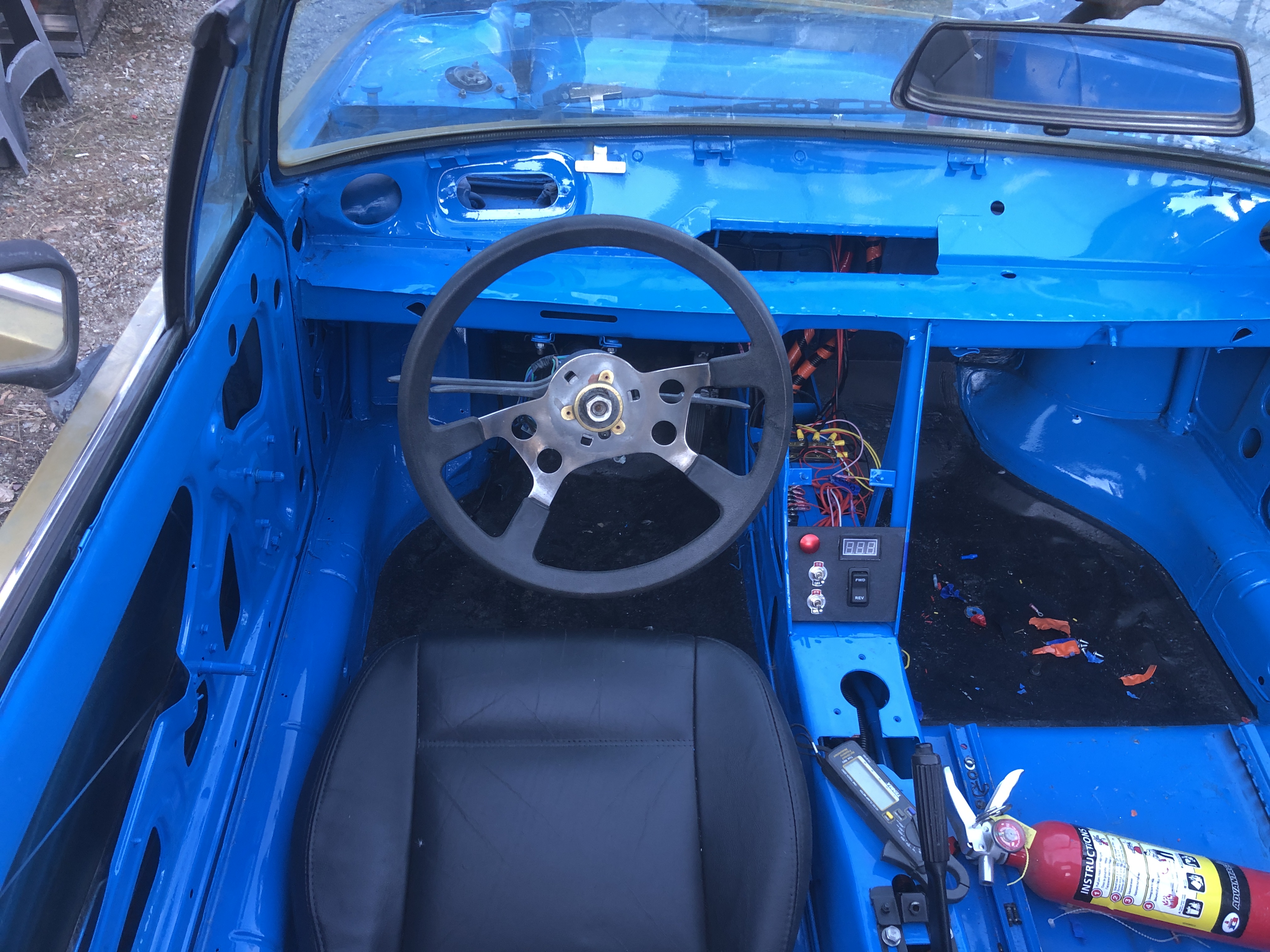

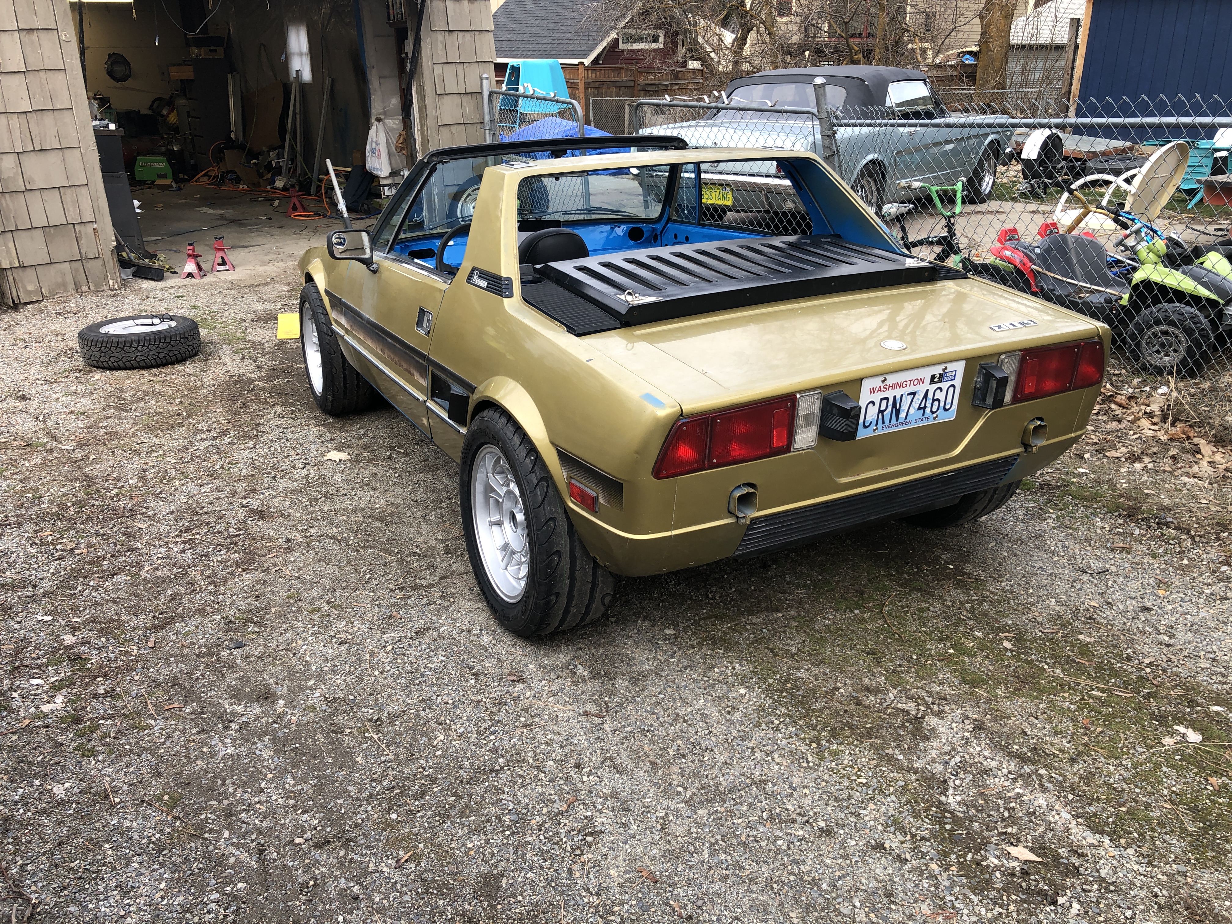

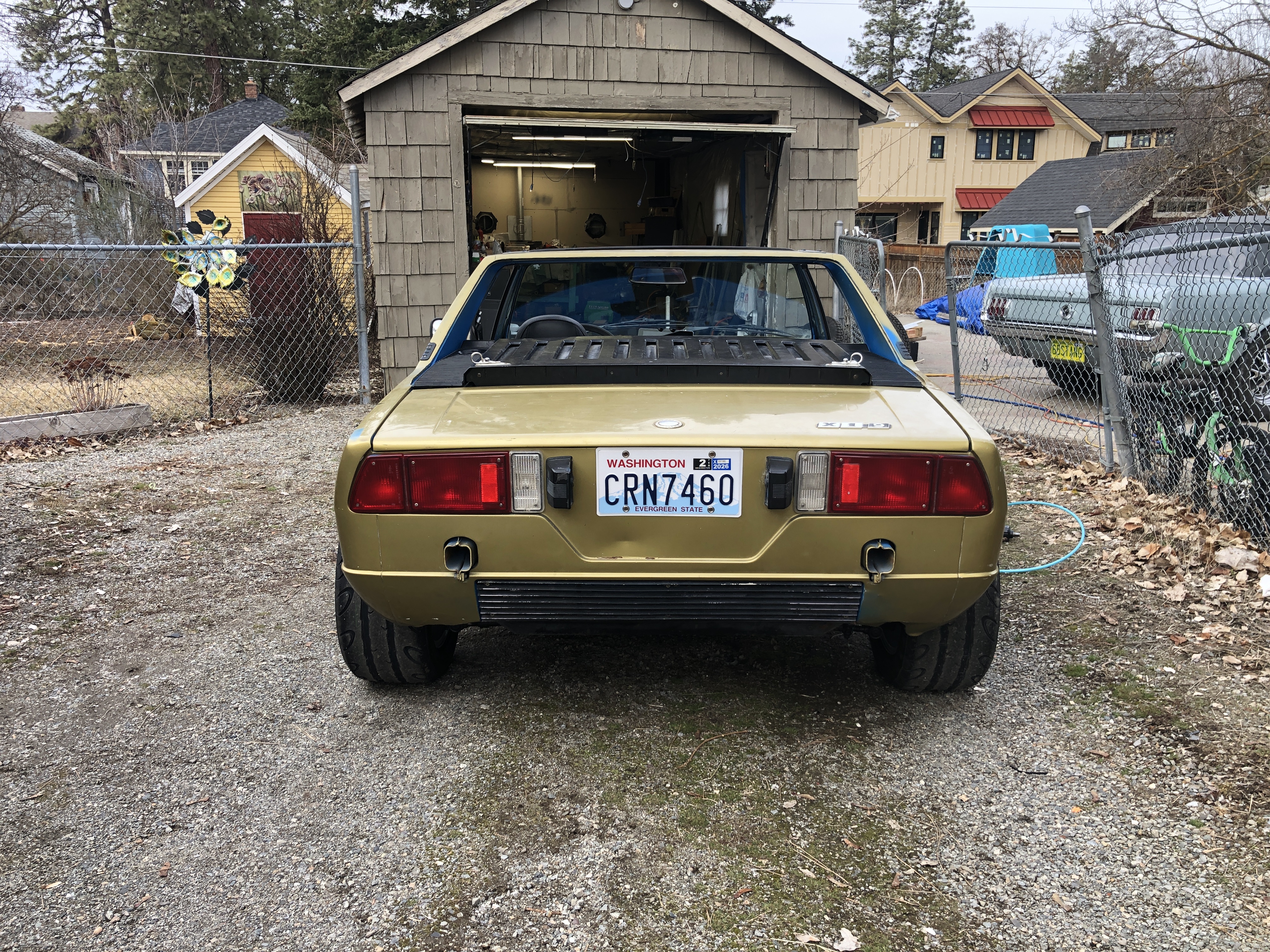

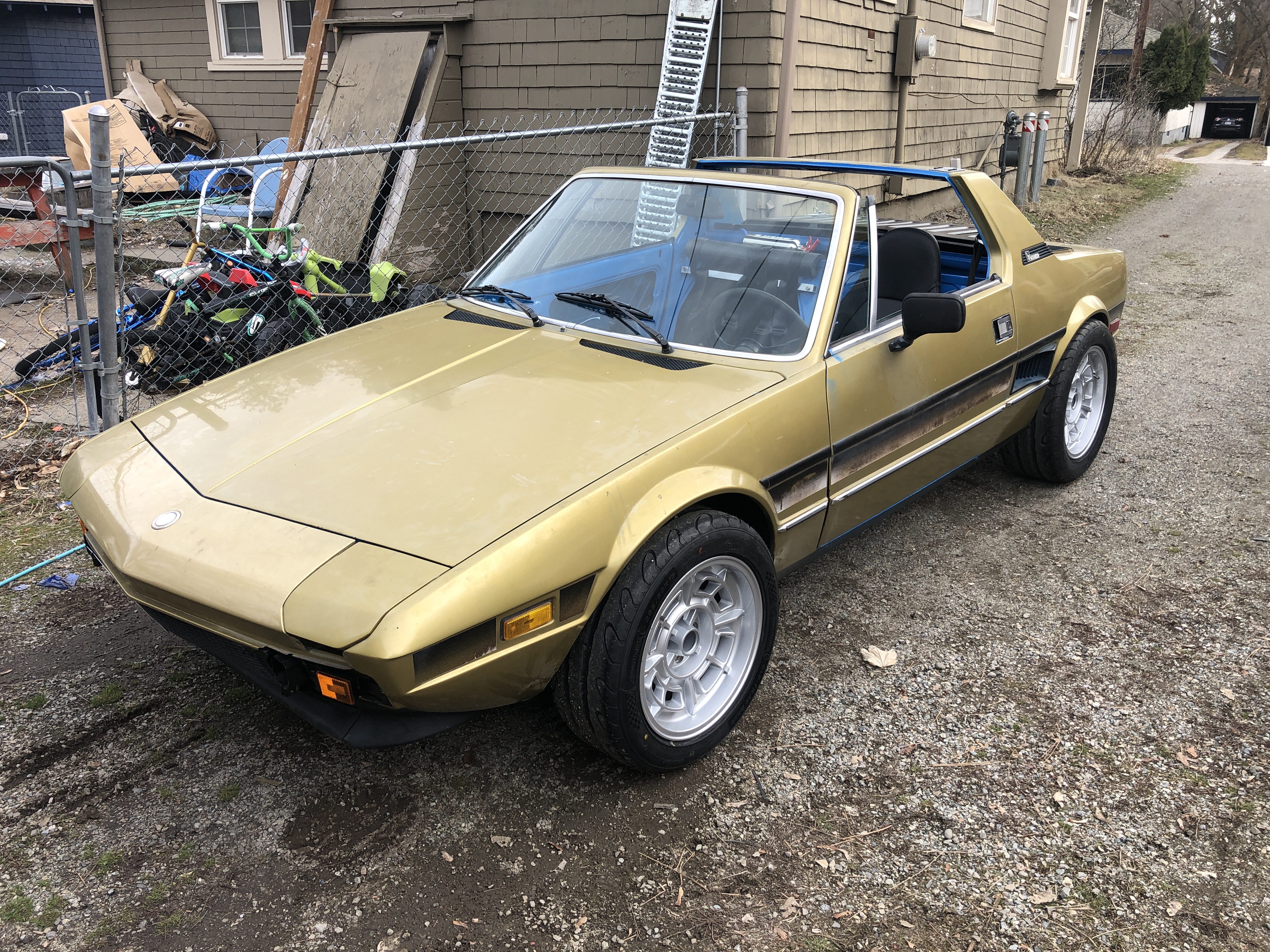

The car is now licensed, insured, and street legal. I've been driving around town for a few days. What a kick! Never driven anything quite like it. The first drive I had on the stock size tires and wheels-a bit scary when mashing the pedal. Today I did some trimming to fit the larger rubber. Front still needs to go down a little. I have fiberglass fender flares to go on, then paint etc. Still need headlights and some other stuff.

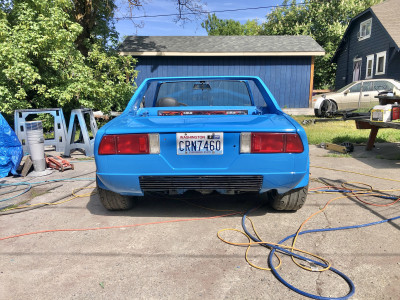

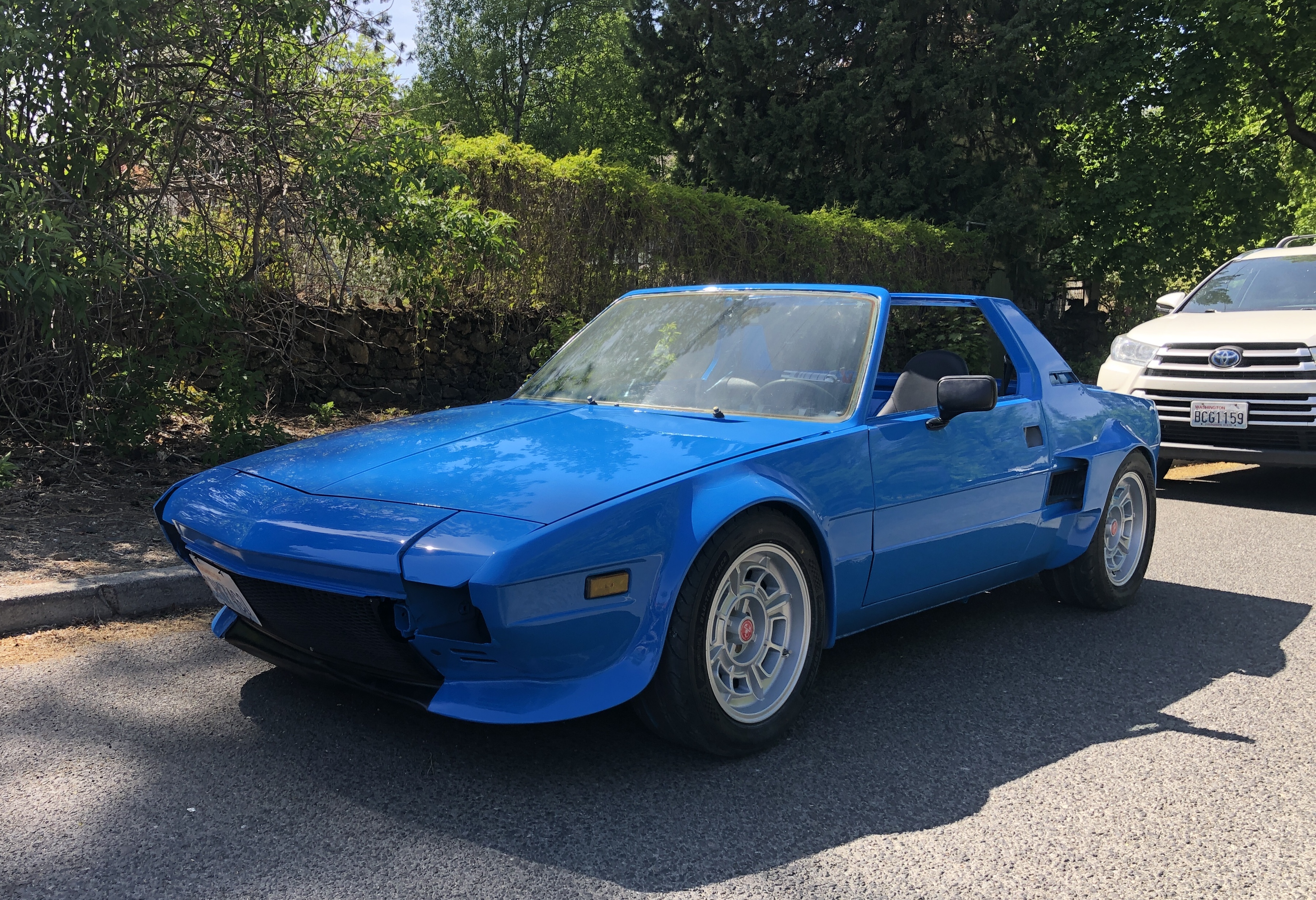

Re: (Driving) Tesla SDU in Fiat X19

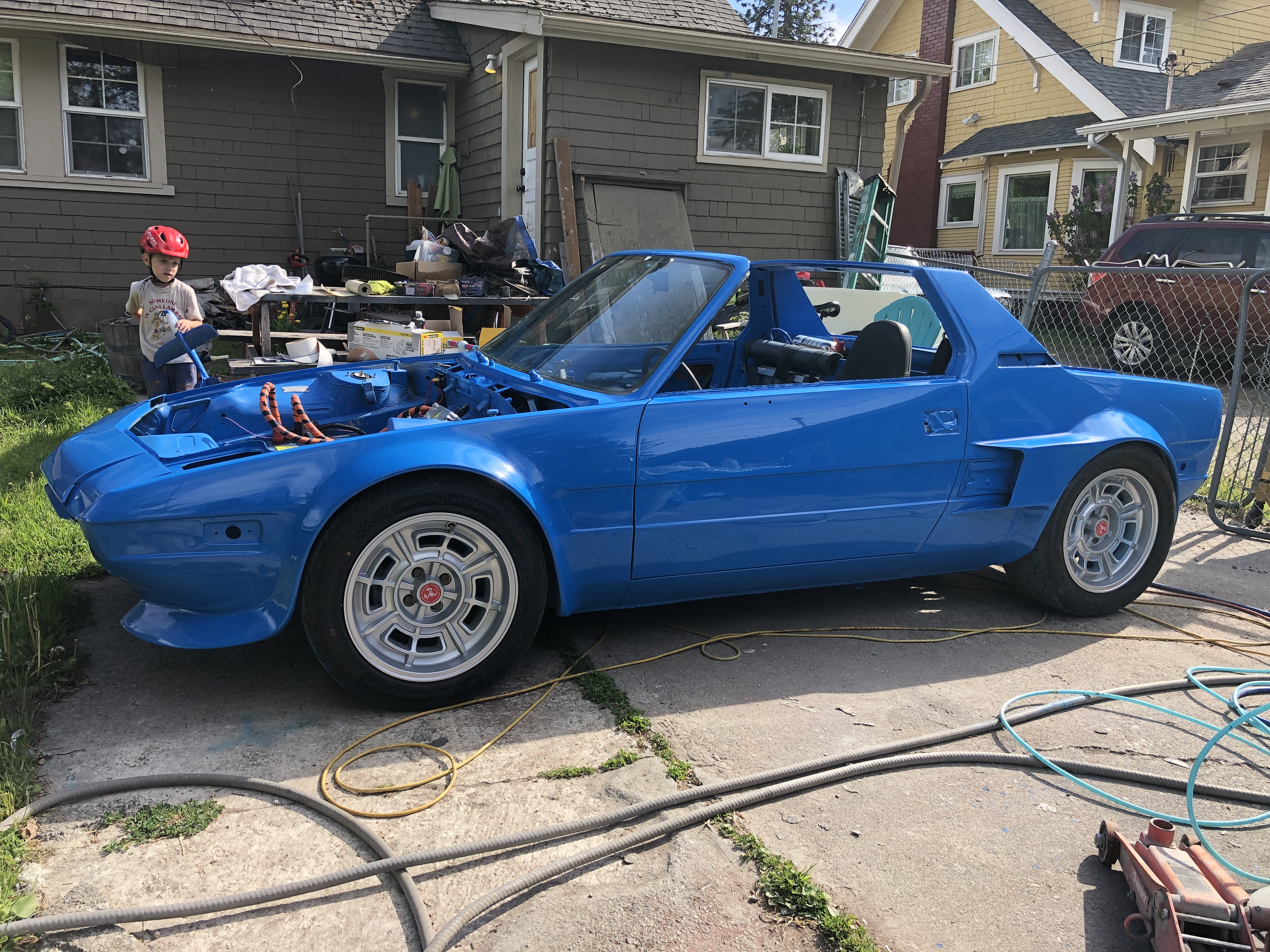

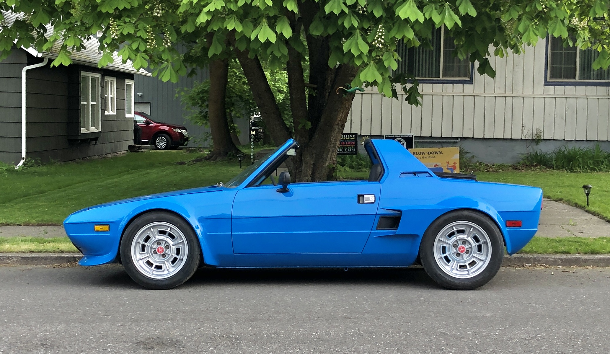

I finished painting the X earlier this week after working extensively on installing and blending the fiberglass fender flares into the body. I am slowly putting it back together while driving around town. Thought I'd share some pics. I still can't seem to connect to the wifi with my pone or iPad on the dash while driving. They need to be out of the cabin near the motor to connect.
