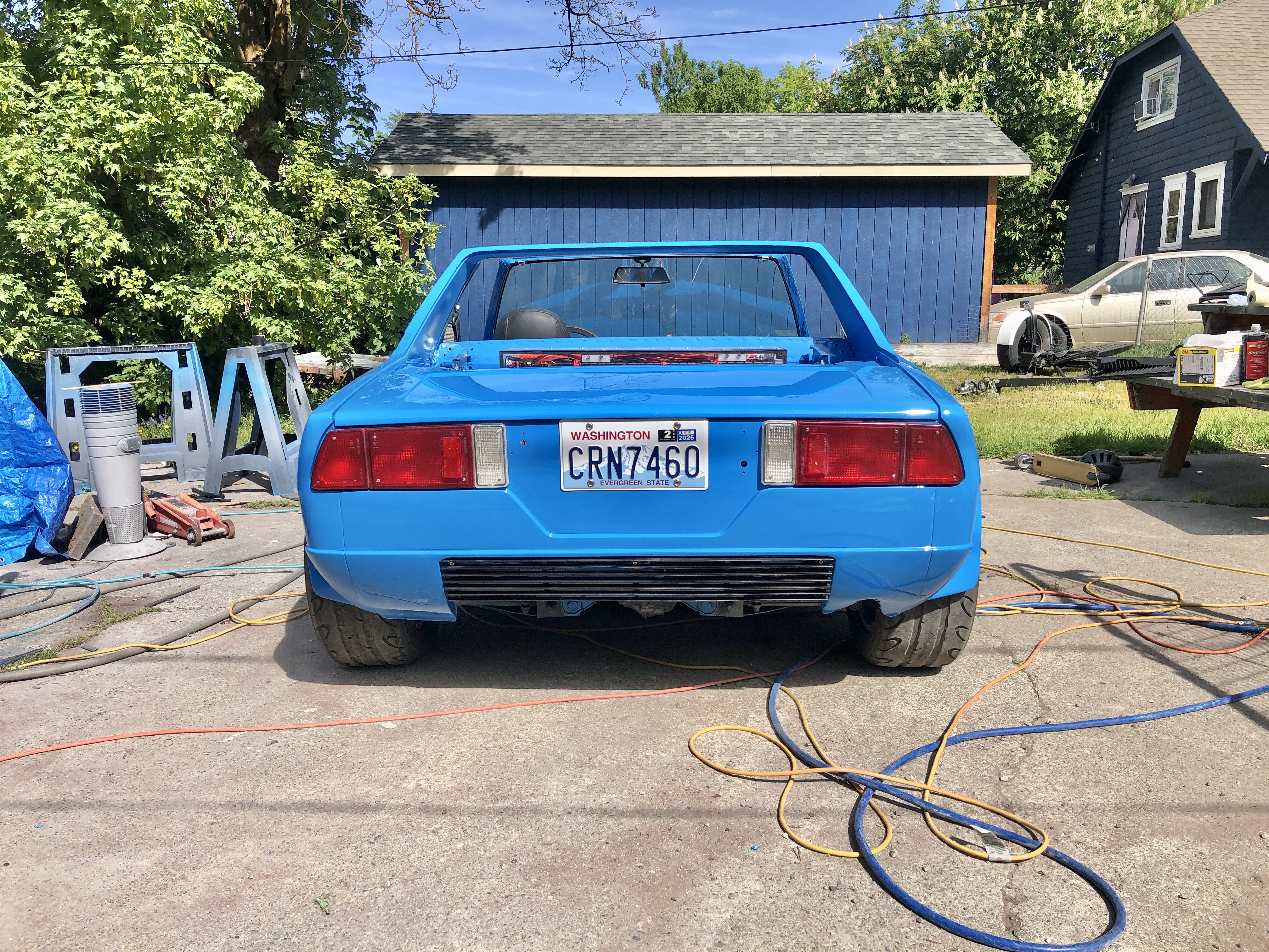

Re: (Driving) Tesla SDU in Fiat X19
I finished painting the X earlier this week after working extensively on installing and blending the fiberglass fender flares into the body. I am slowly putting it back together while driving around town. Thought I'd share some pics. I still can't seem to connect to the wifi with my pone or iPad on the dash while driving. They need to be out of the cabin near the motor to connect.
