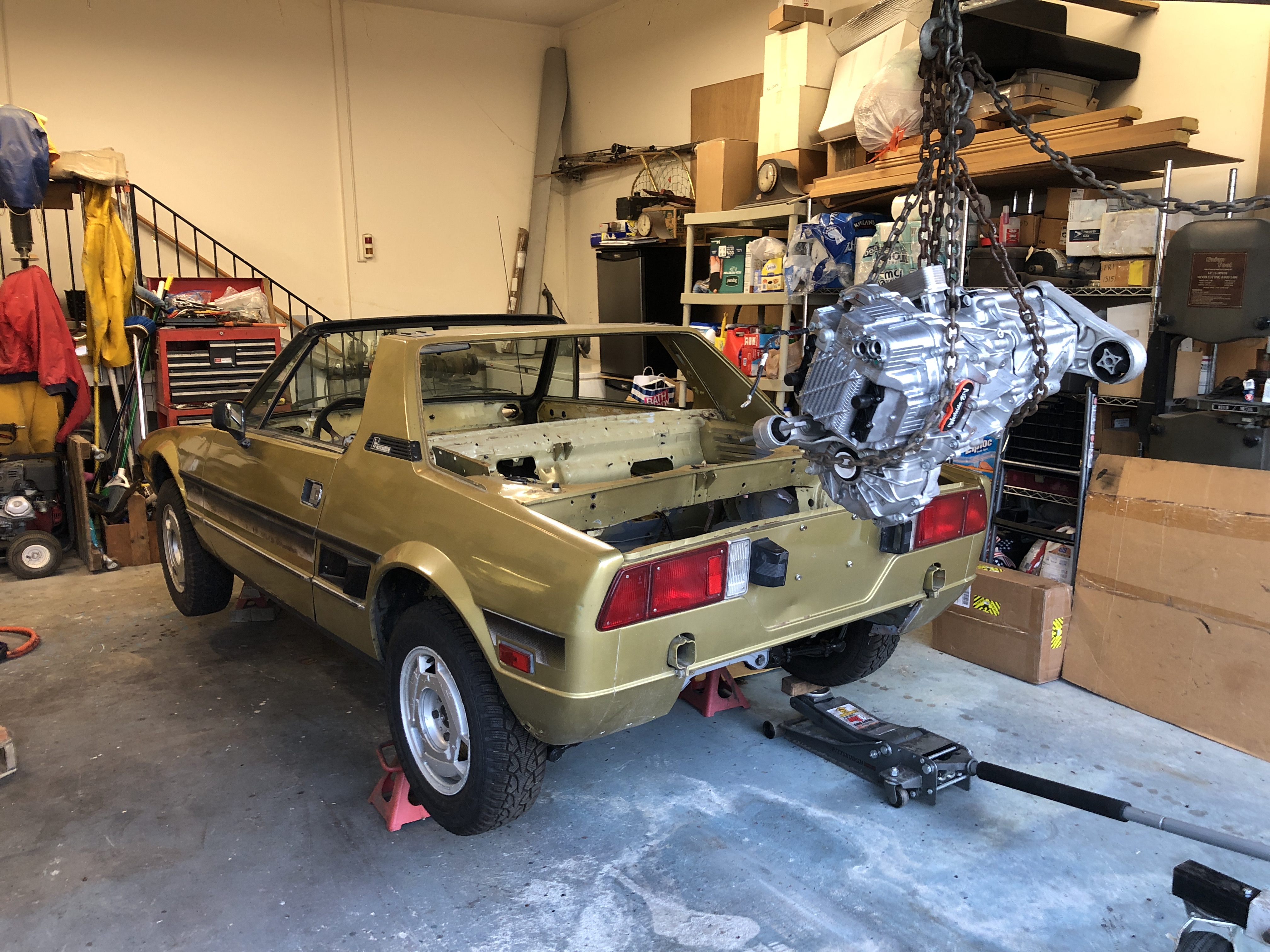

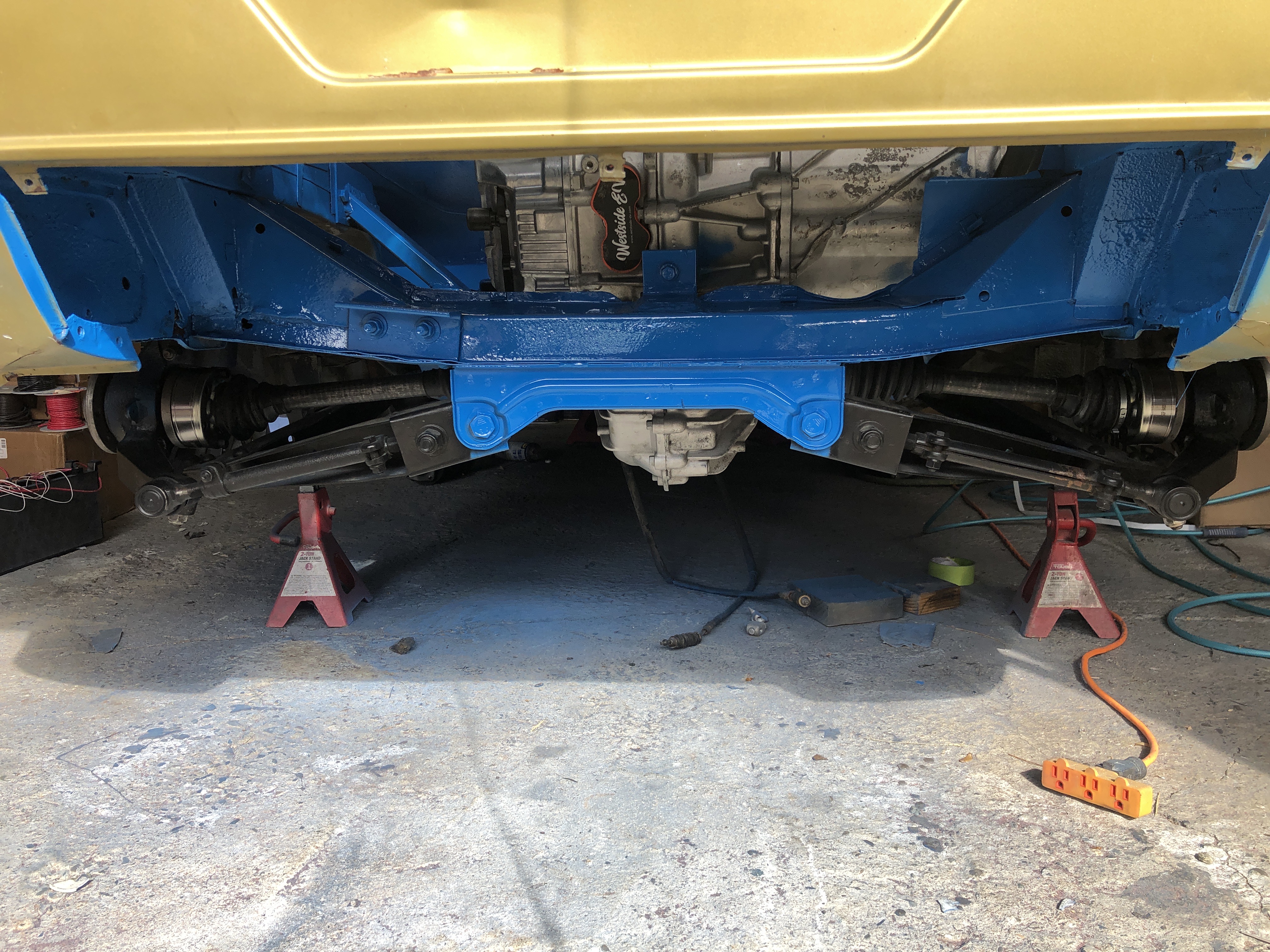

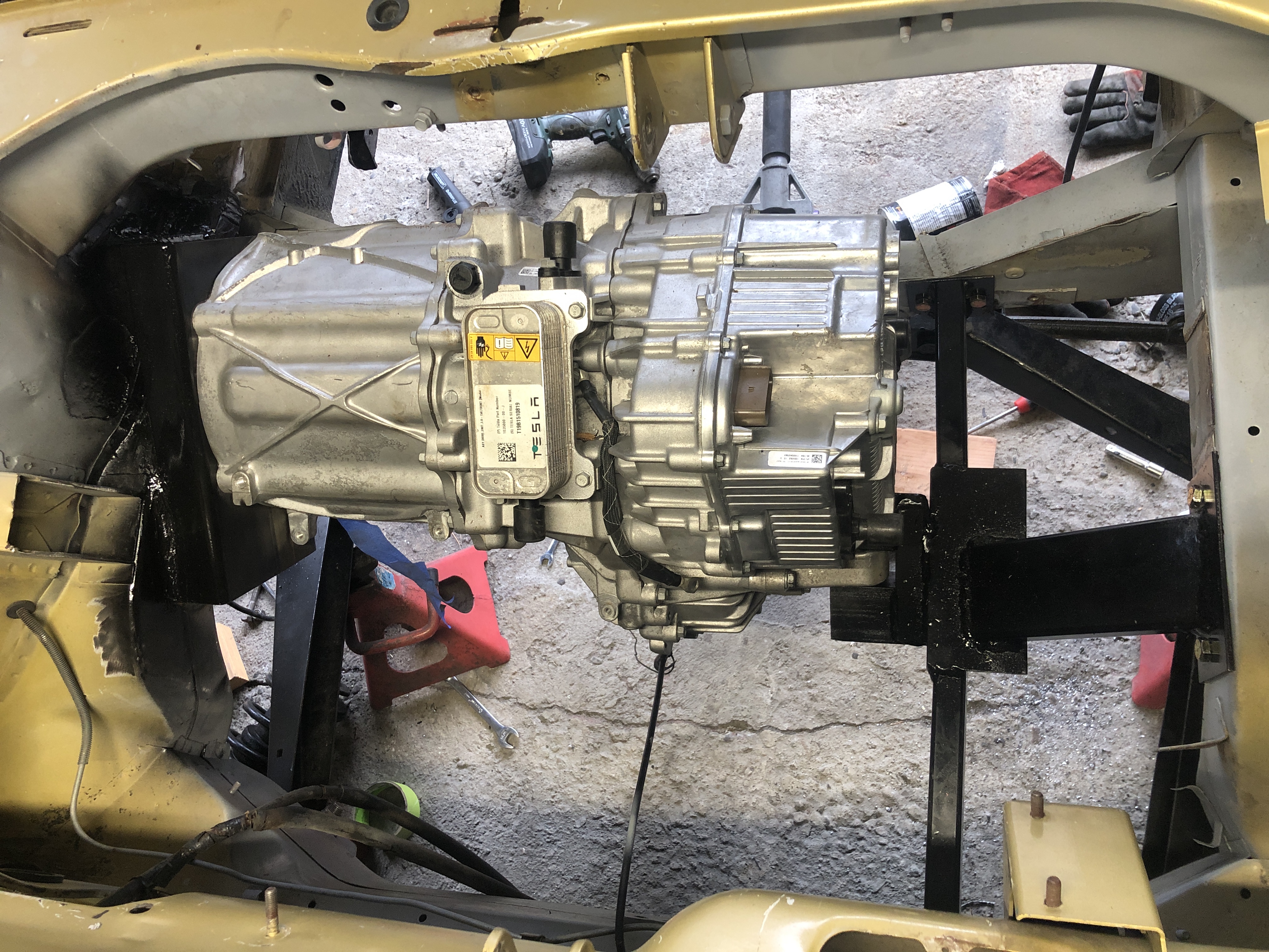

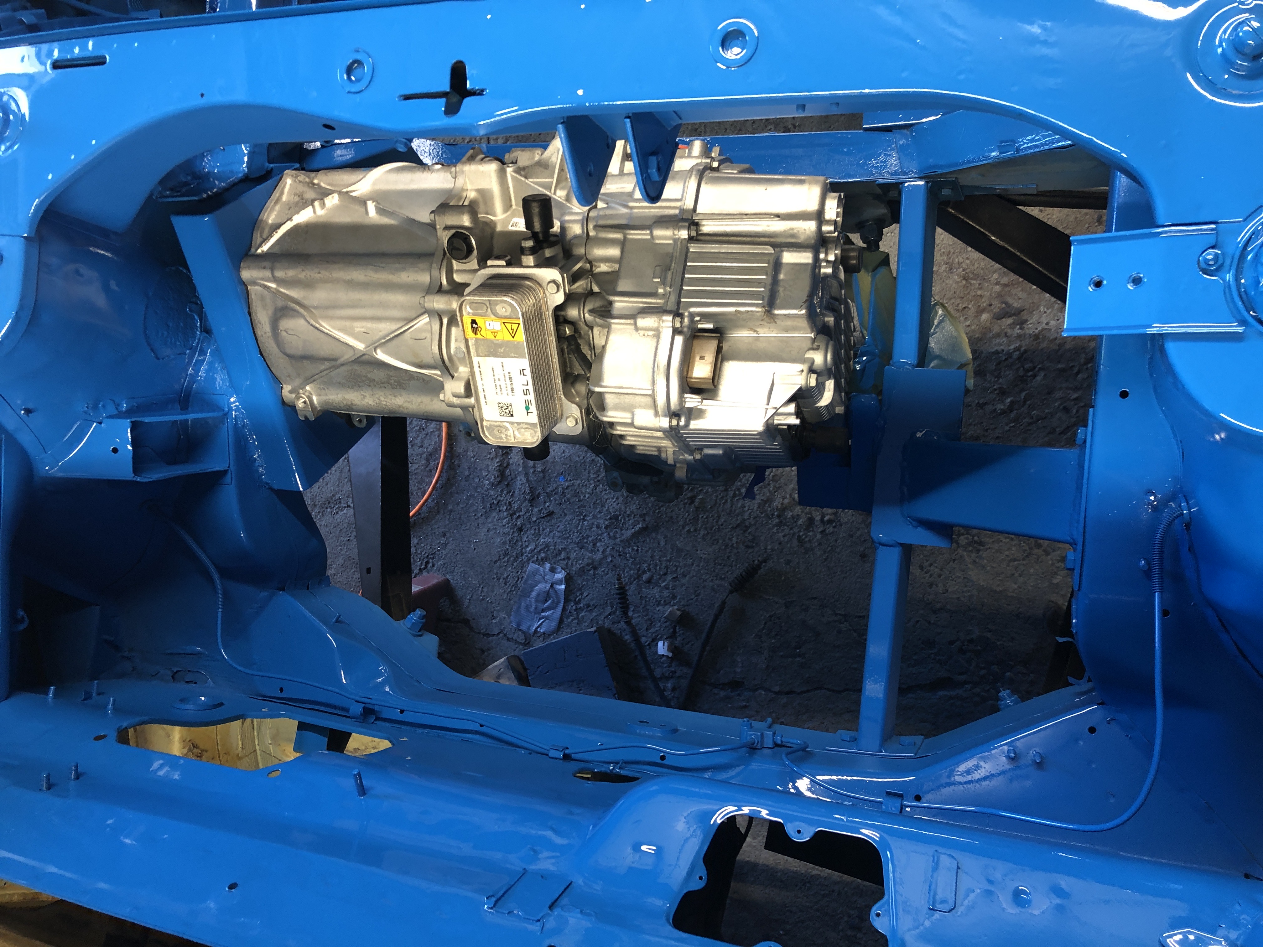

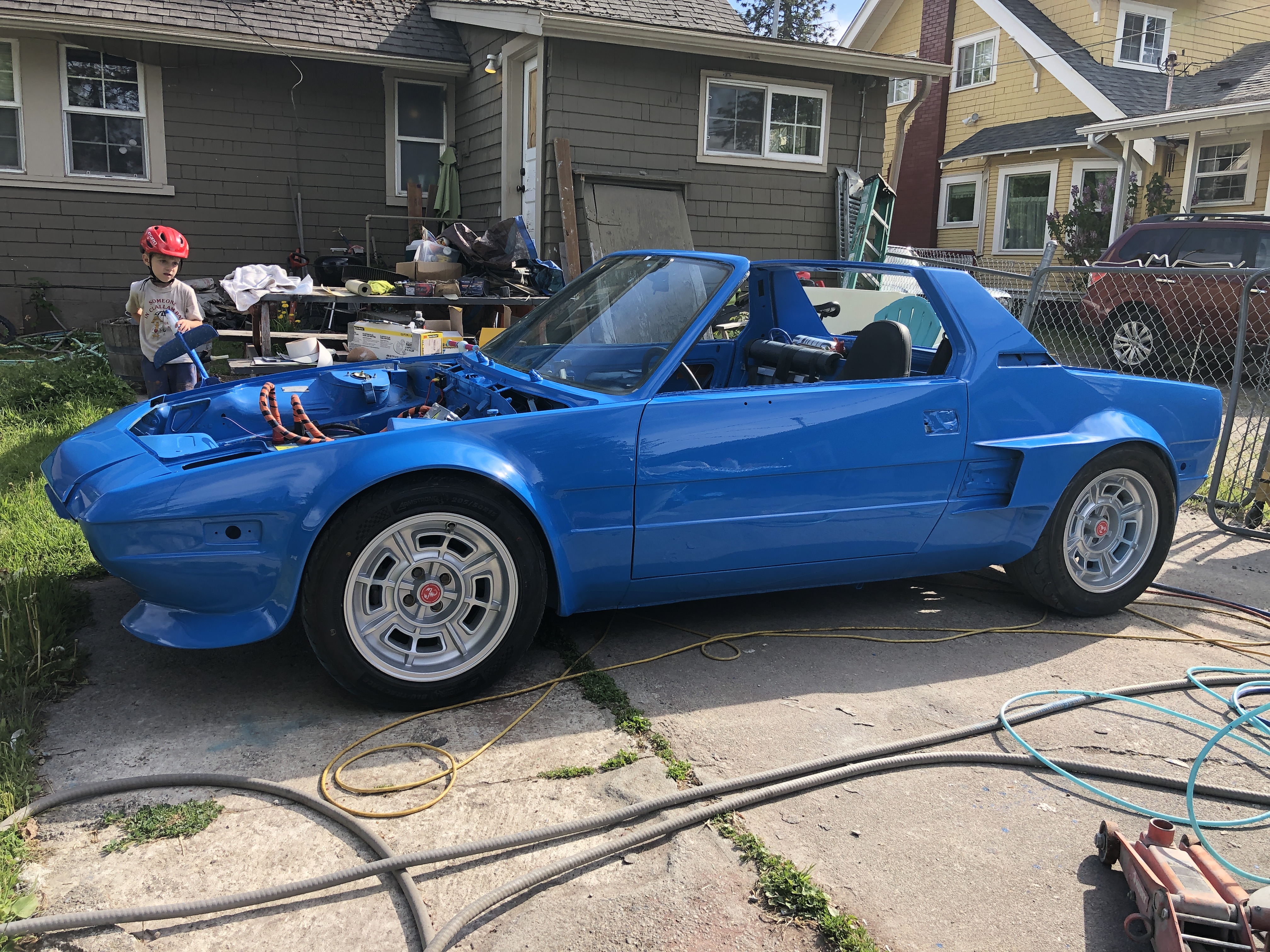

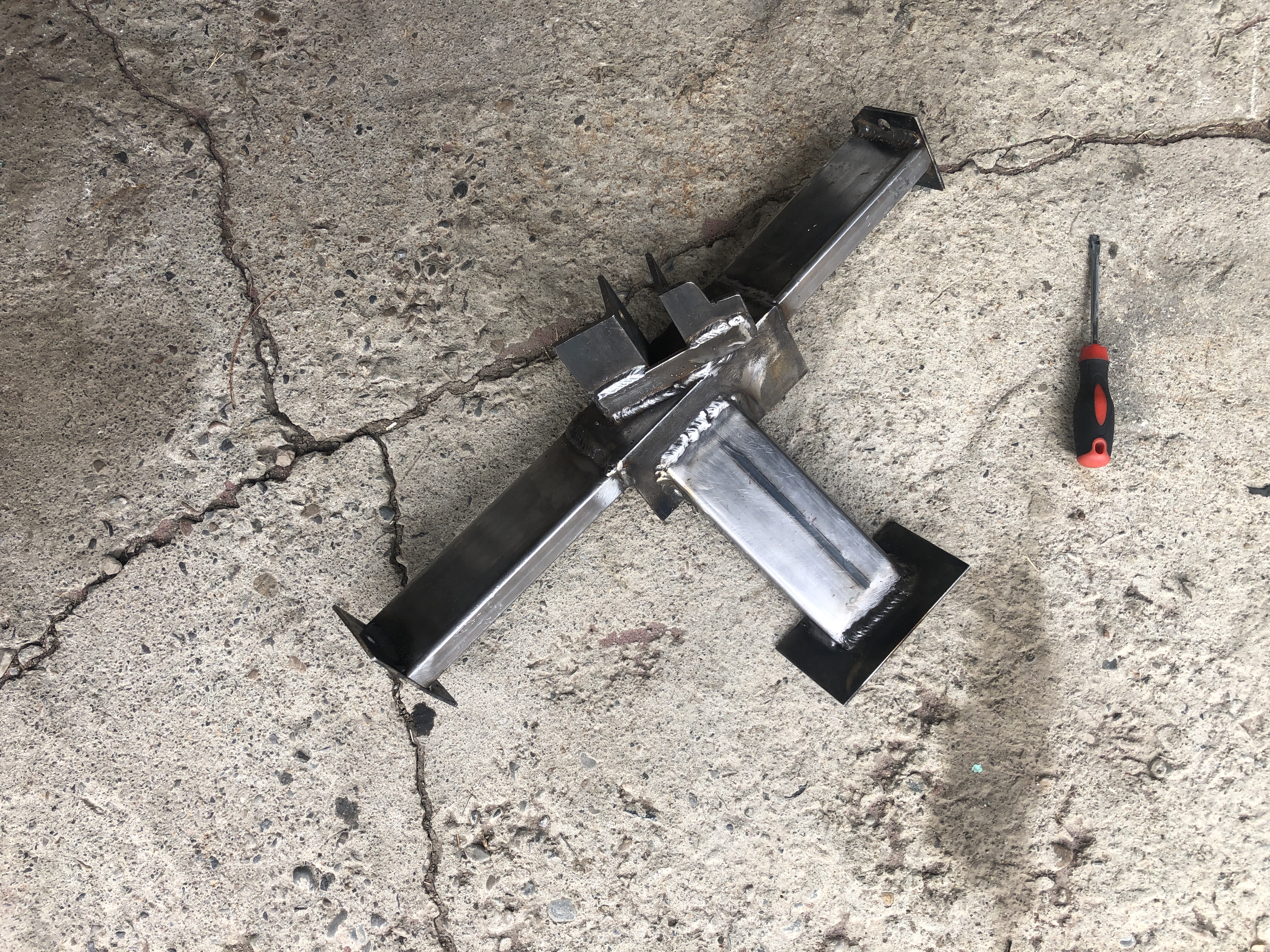

I thought I'd share what I have done so far with my project. I have the motor mounted and am now moving on to the axles.
I am planning on having the Tesla Axles that I have, cut and splined for the Fiat CV outers. The Fiat uses two of the same CV setups for both the inner and outer, so when mounted, the axle has lateral movement (in and out). Seems different from the typical setup with the outer fixed and the inner to allow that type of movement. I guess I just need to measure carefully in the longest position so it isn't too short causing the risk of pulling out the diff end :0

Re: Tesla SDU in Fiat X19
being rwd, they are doj, double offset joints. a cv on the outer end is not needed as the rear wheels dont do steering.
youll want to measure with the wheel and the driveunit lined up perfectly, full compression of the inner cv races.

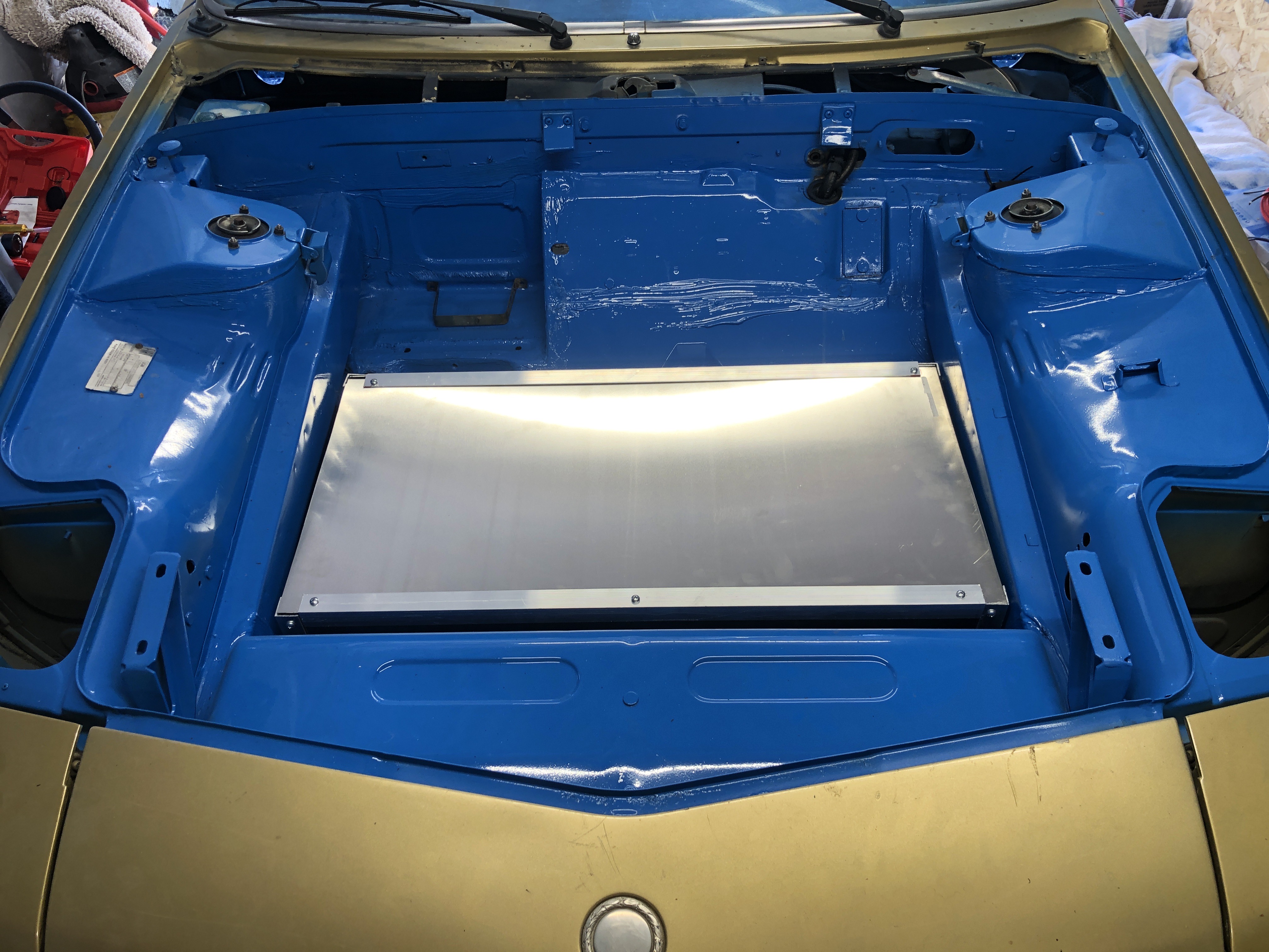

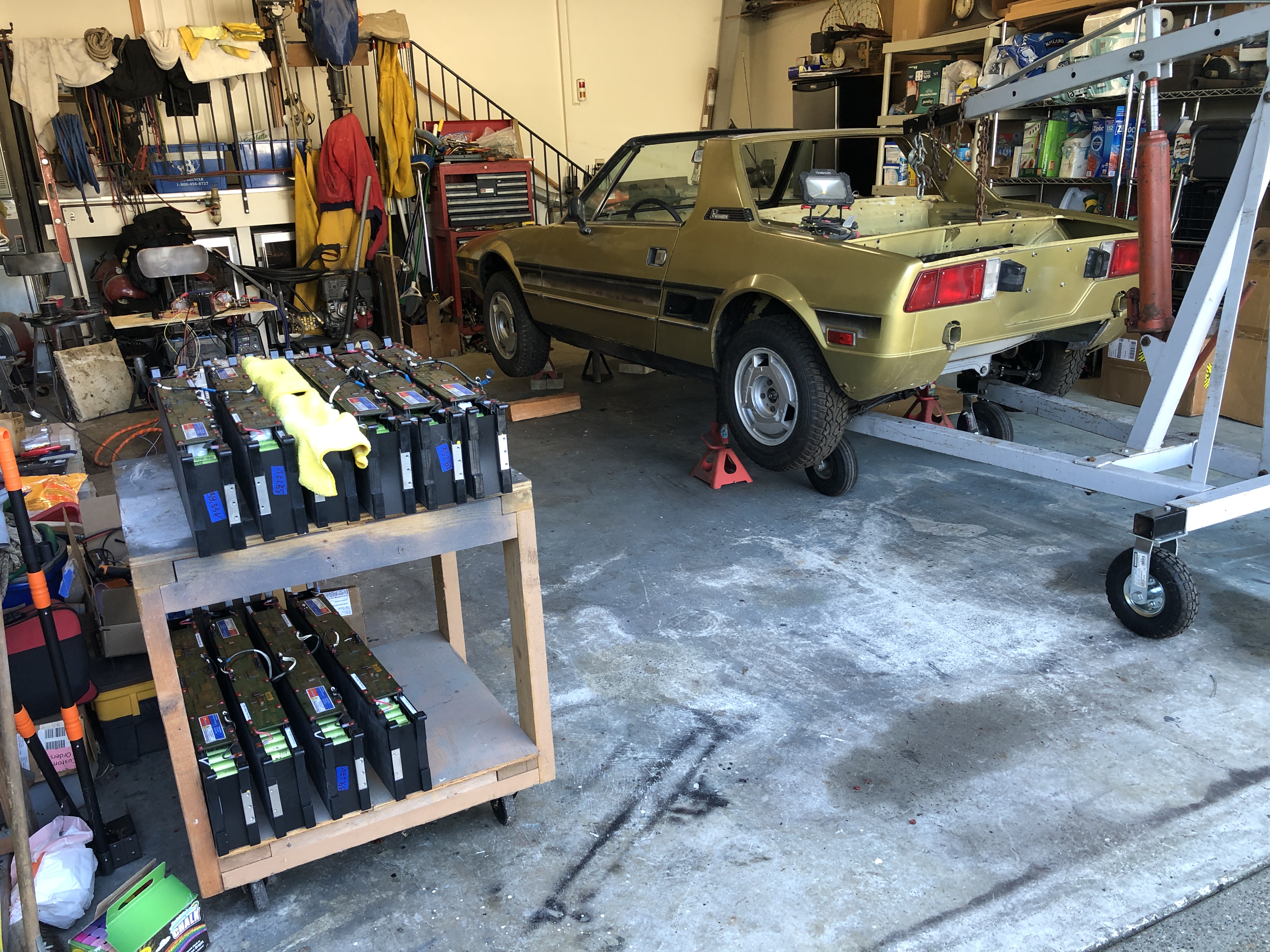

Driveshafts arrive today! I got the engine bay painted, now on to the 10 battery modules. Only 9 more to go!

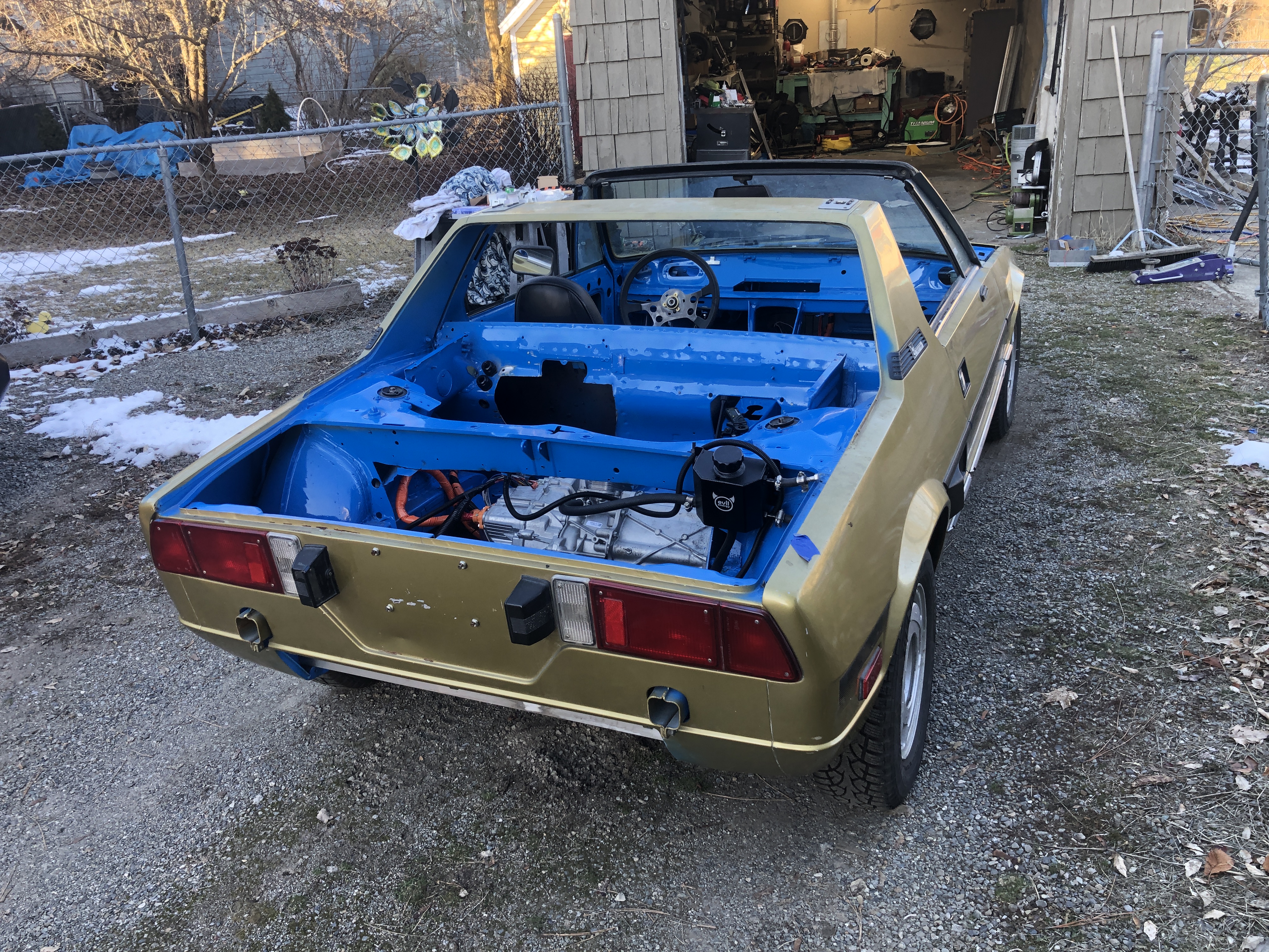

Axles are in.

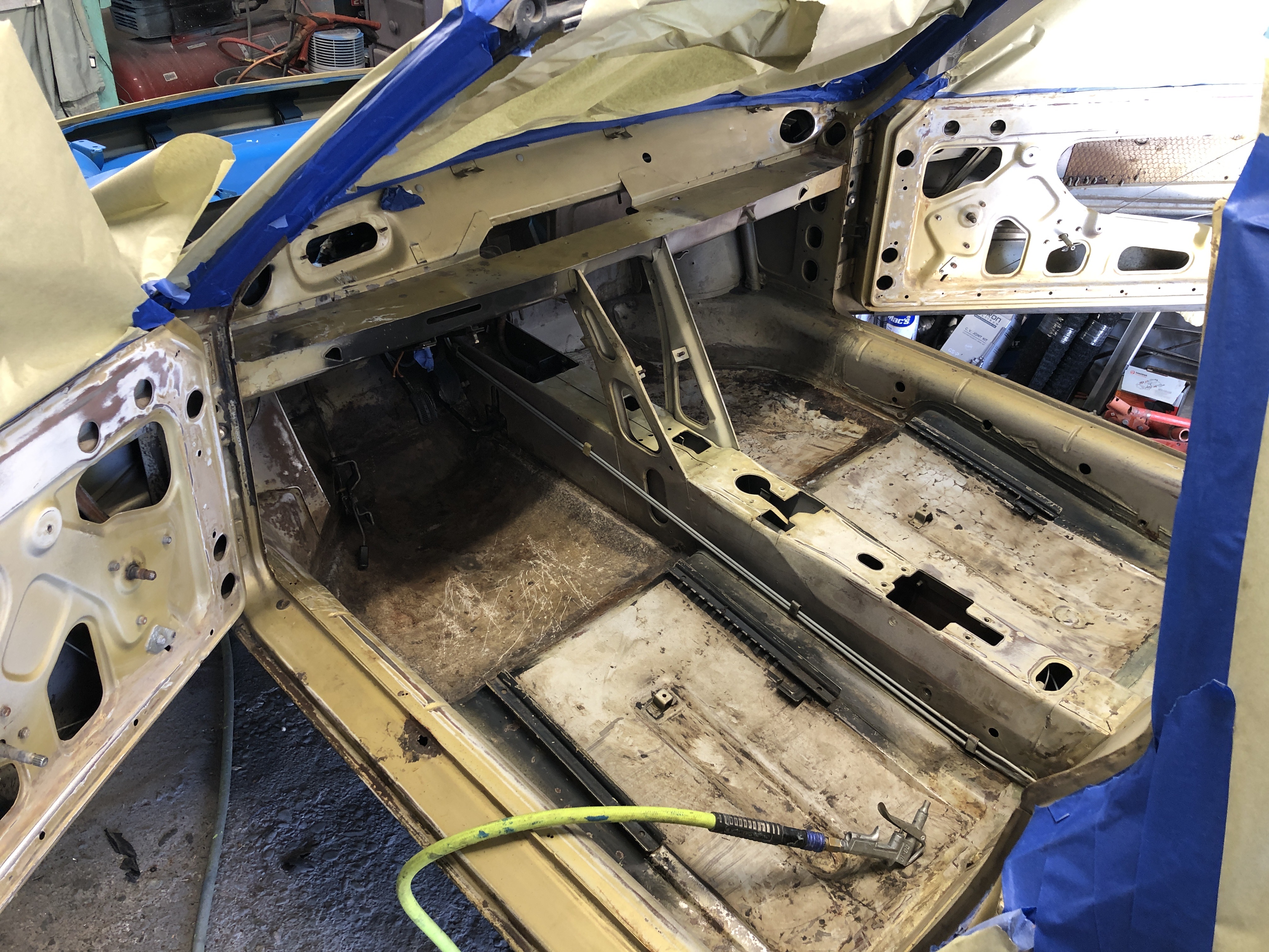

Post by phillipschip »

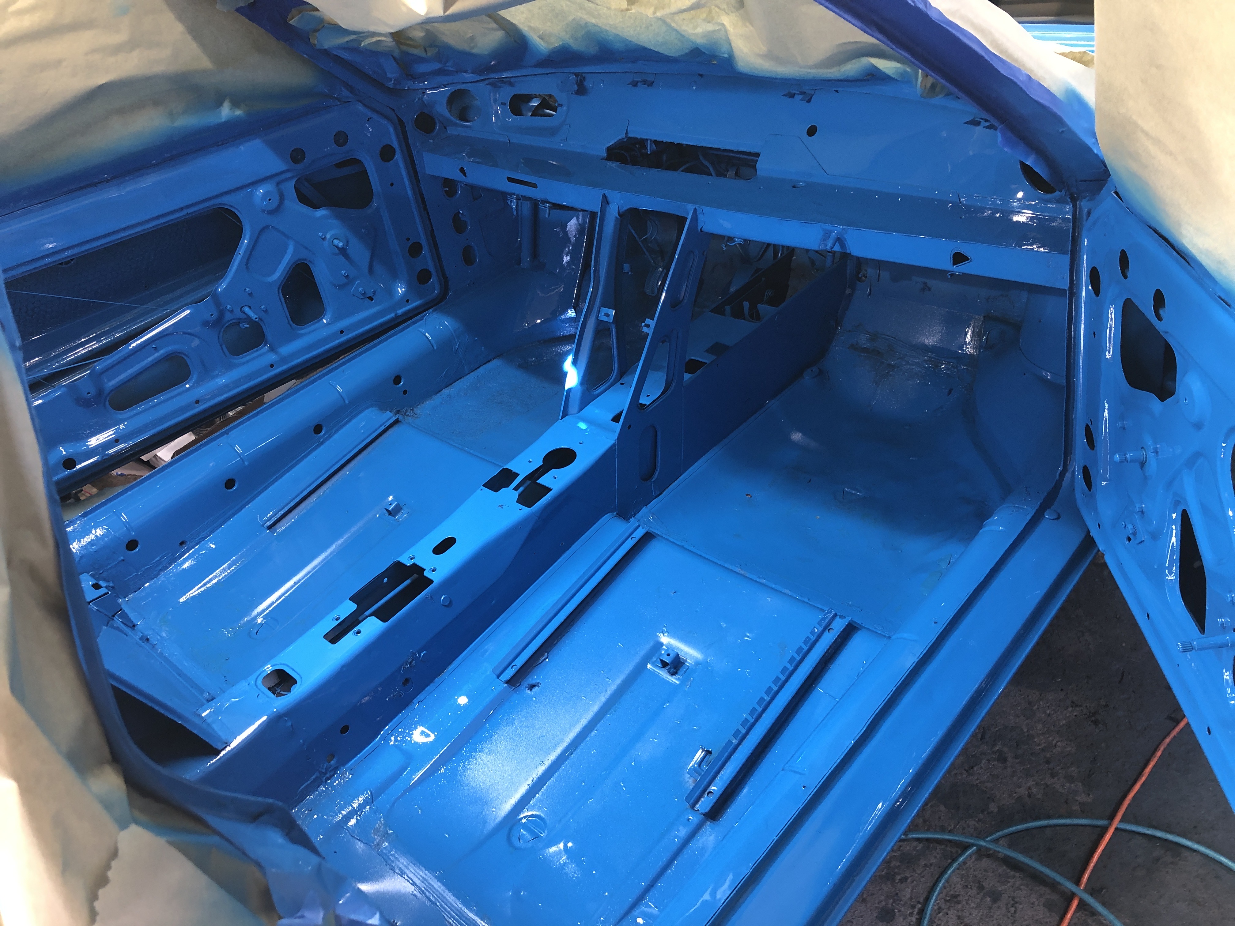

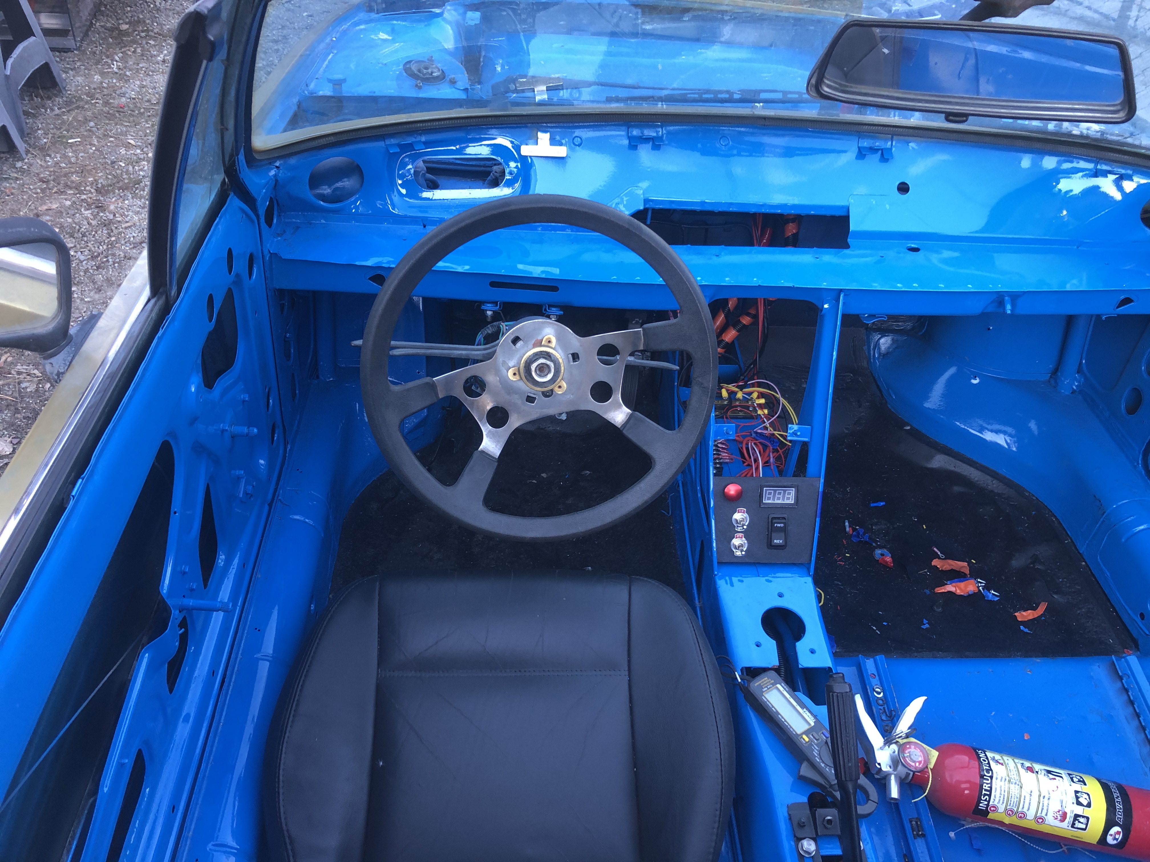

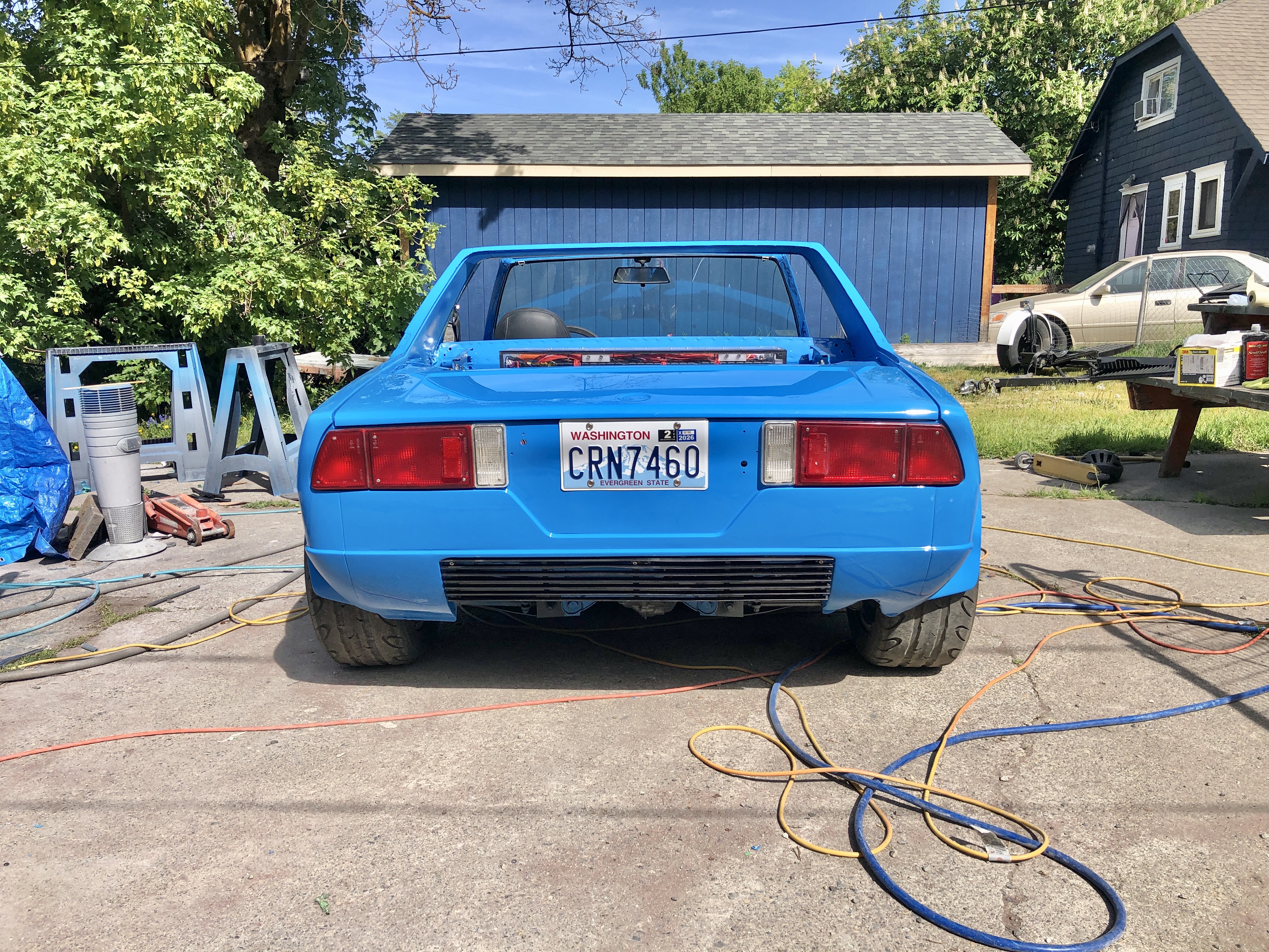

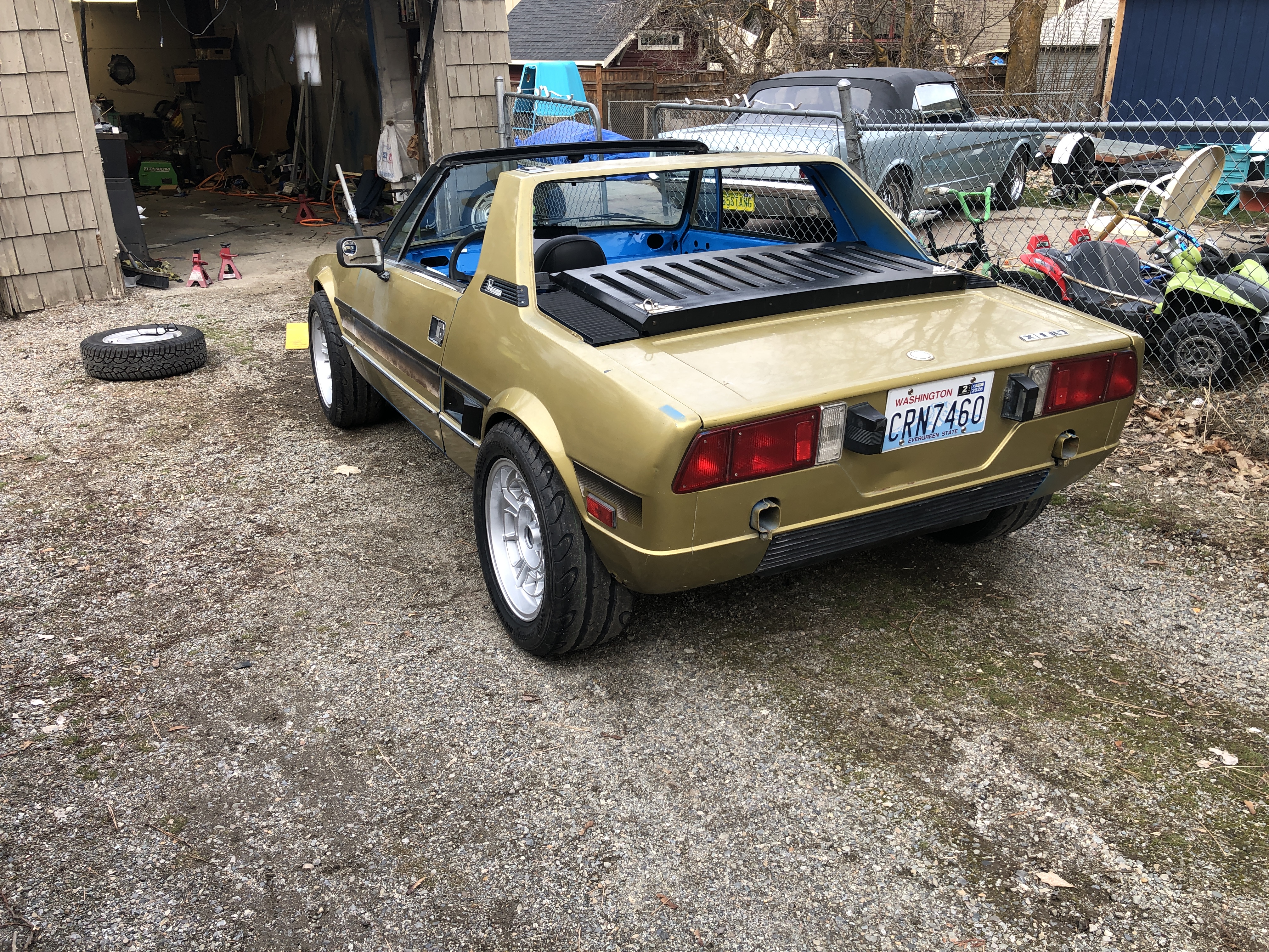

Interior painted and ready for some wires.
All new brakes and master cylinder done too.
Bleeding brakes in a completely dry brake system was very challenging with this car!
Posts: 2392
Location: Bristol
Has thanked: 206 times
Been thanked: 563 times

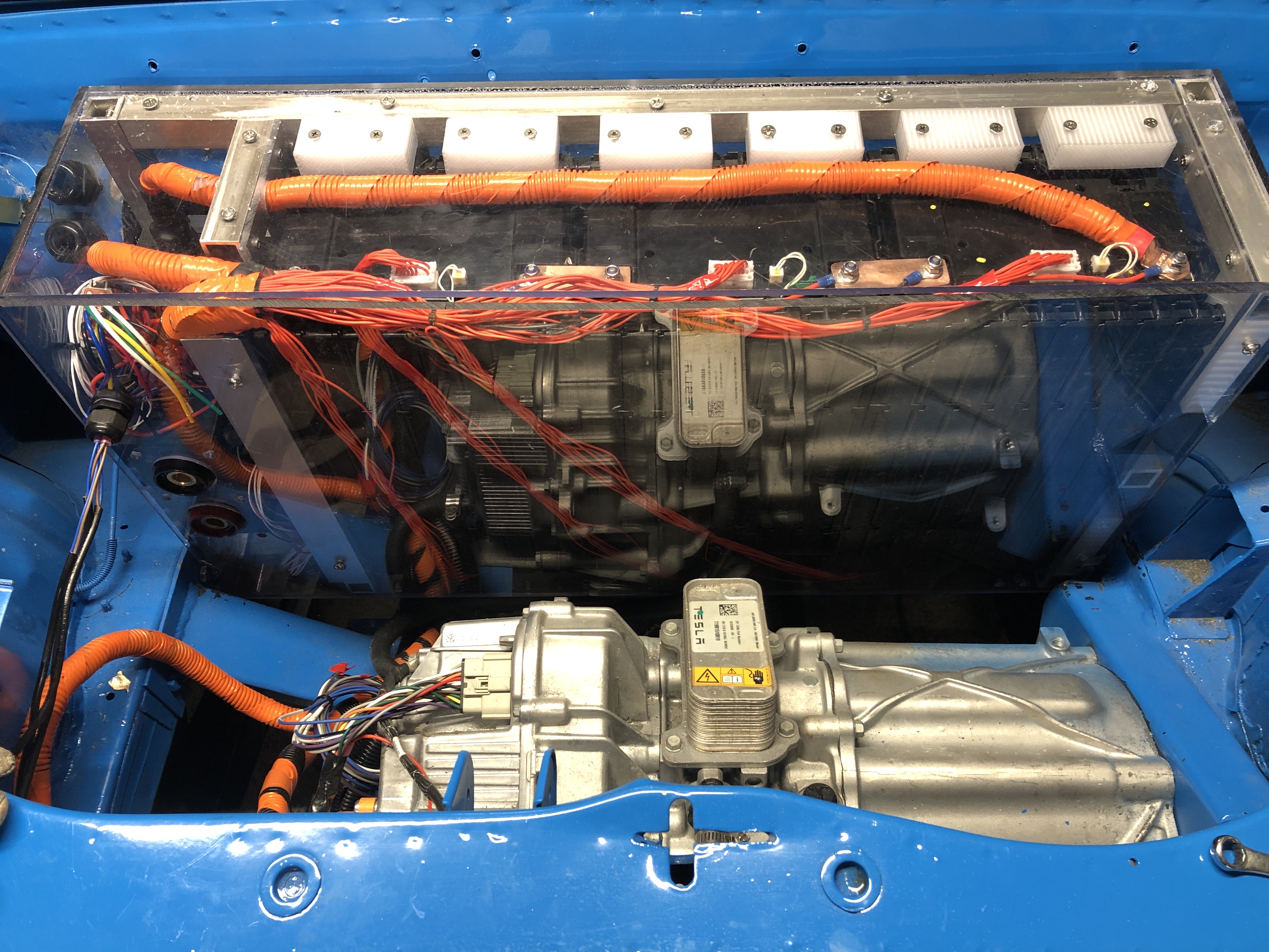

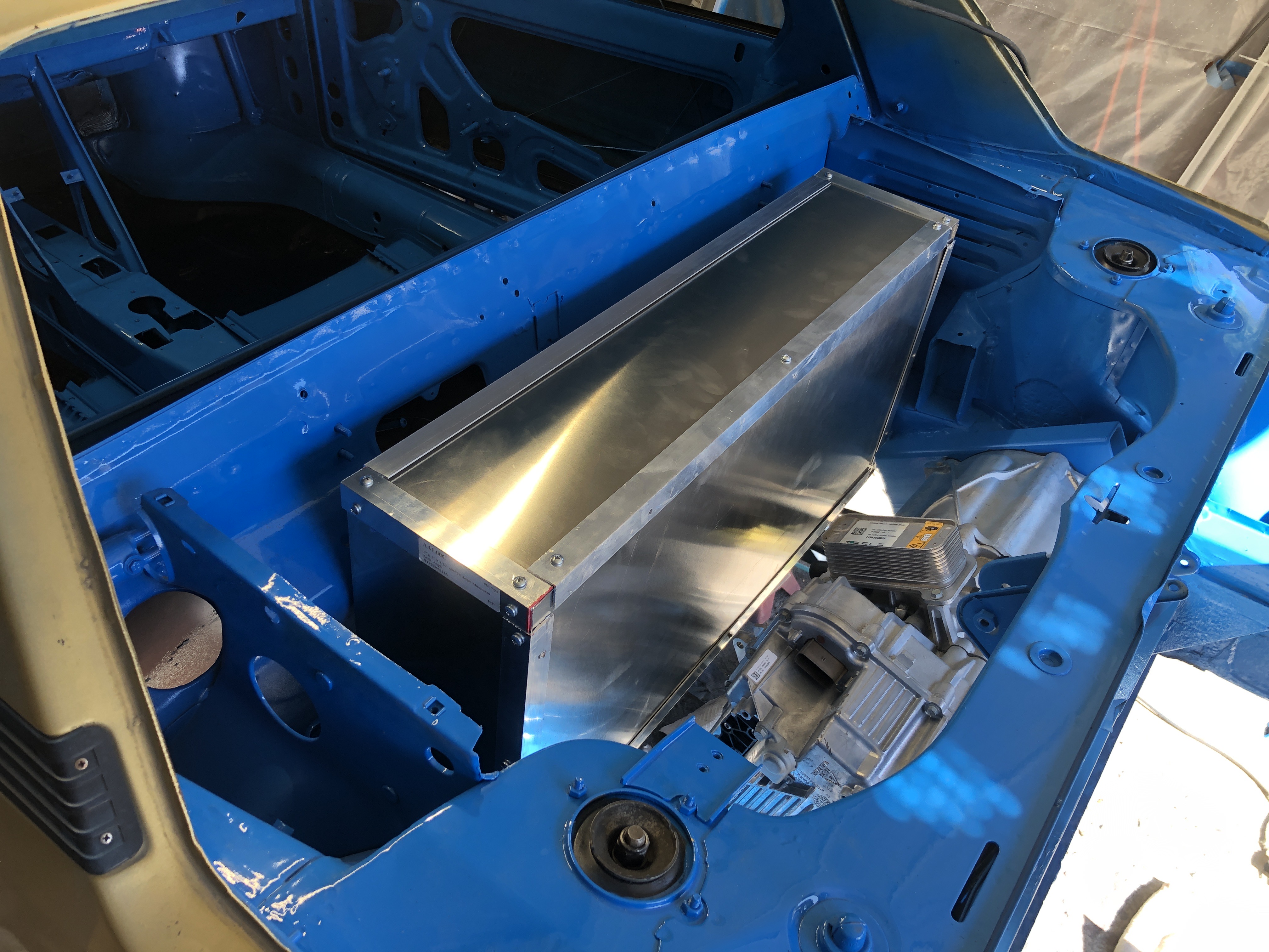

What angle is the gearbox heat exchanger? The pictures make the angle look quite serveer.
It is slightly tilted forward, but the oil pickup inside the diff is still at the bottom. I might just not be able to drain all old fluid without a pump.
I came to the conclusion that it would be fine: viewtopic.php?p=73331#p73331

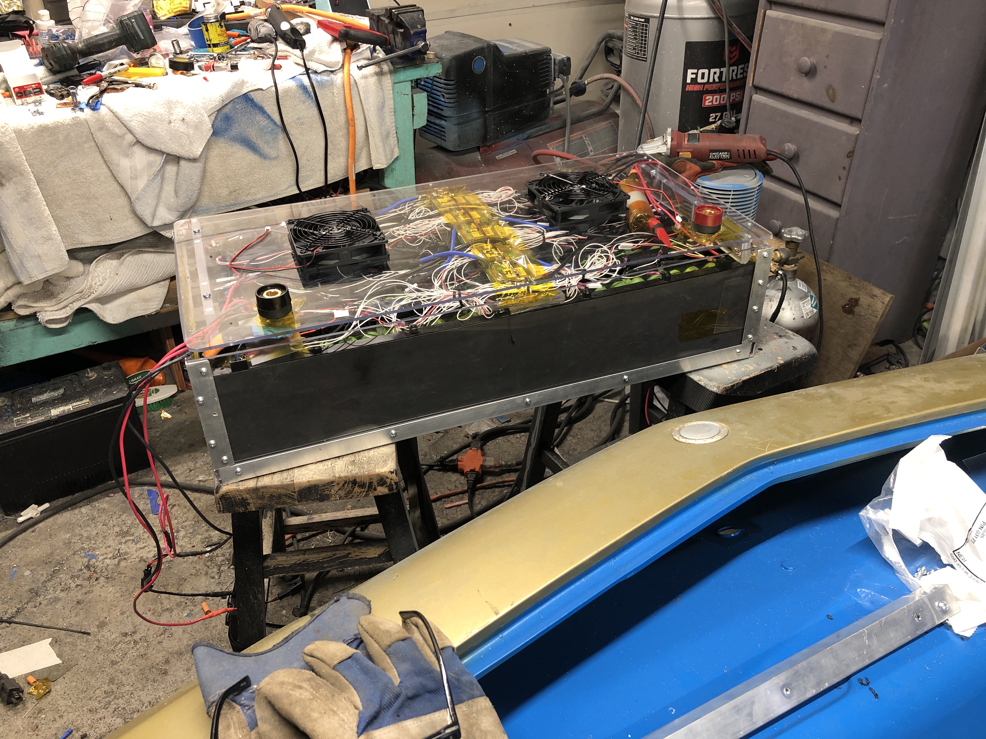

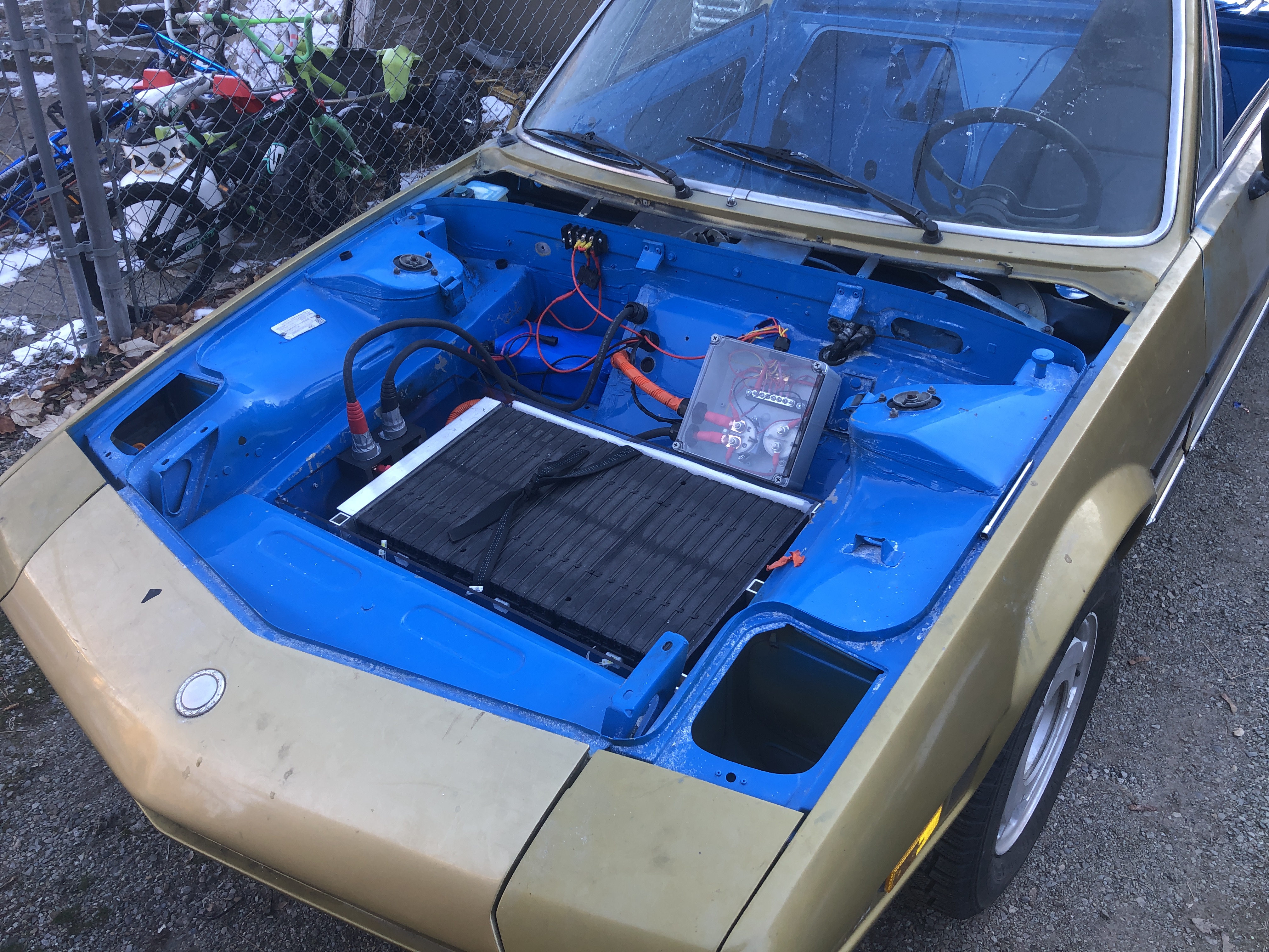

Working on the battery boxes. One in the rear somewhere and one in the “frunk”

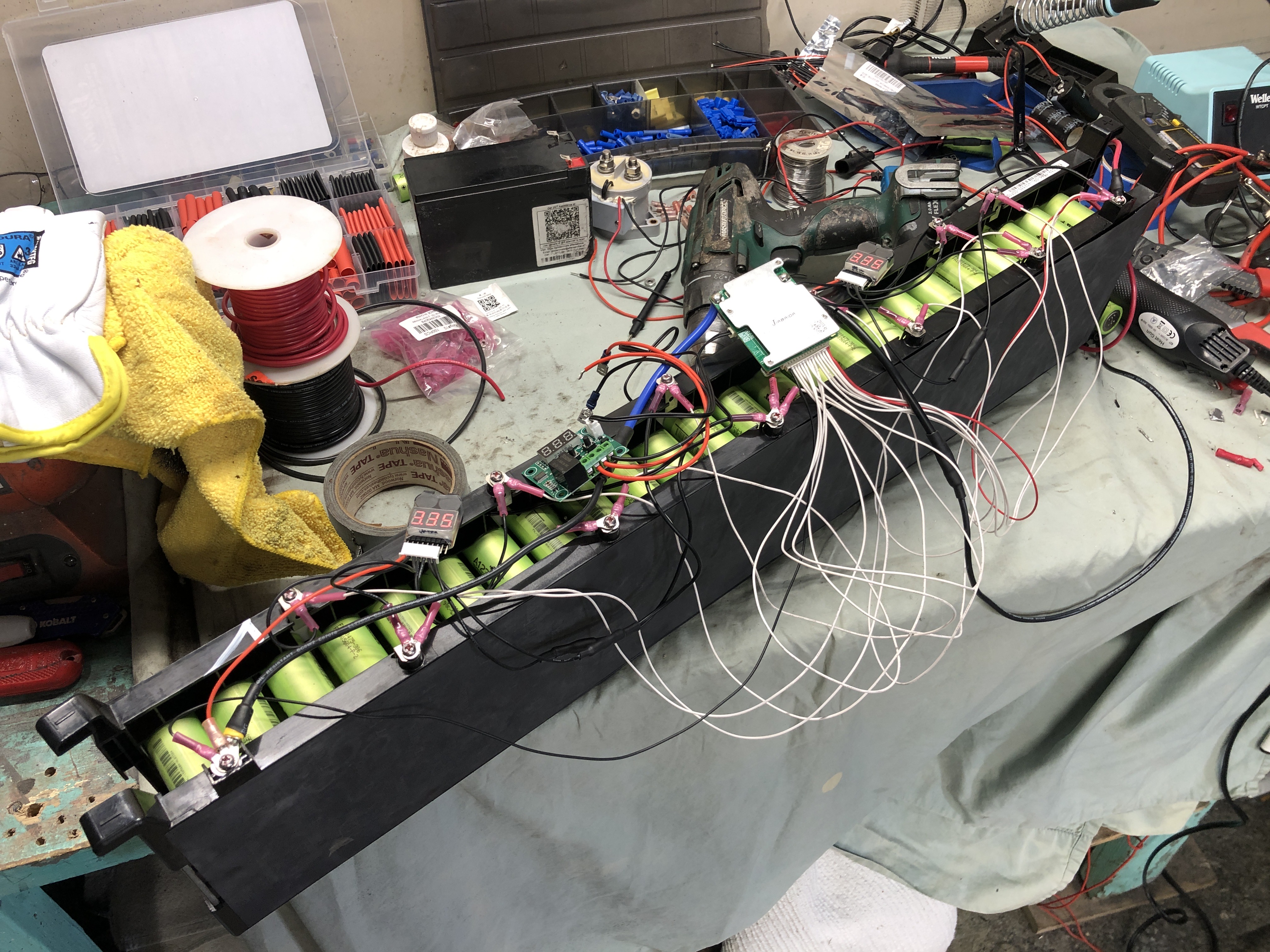

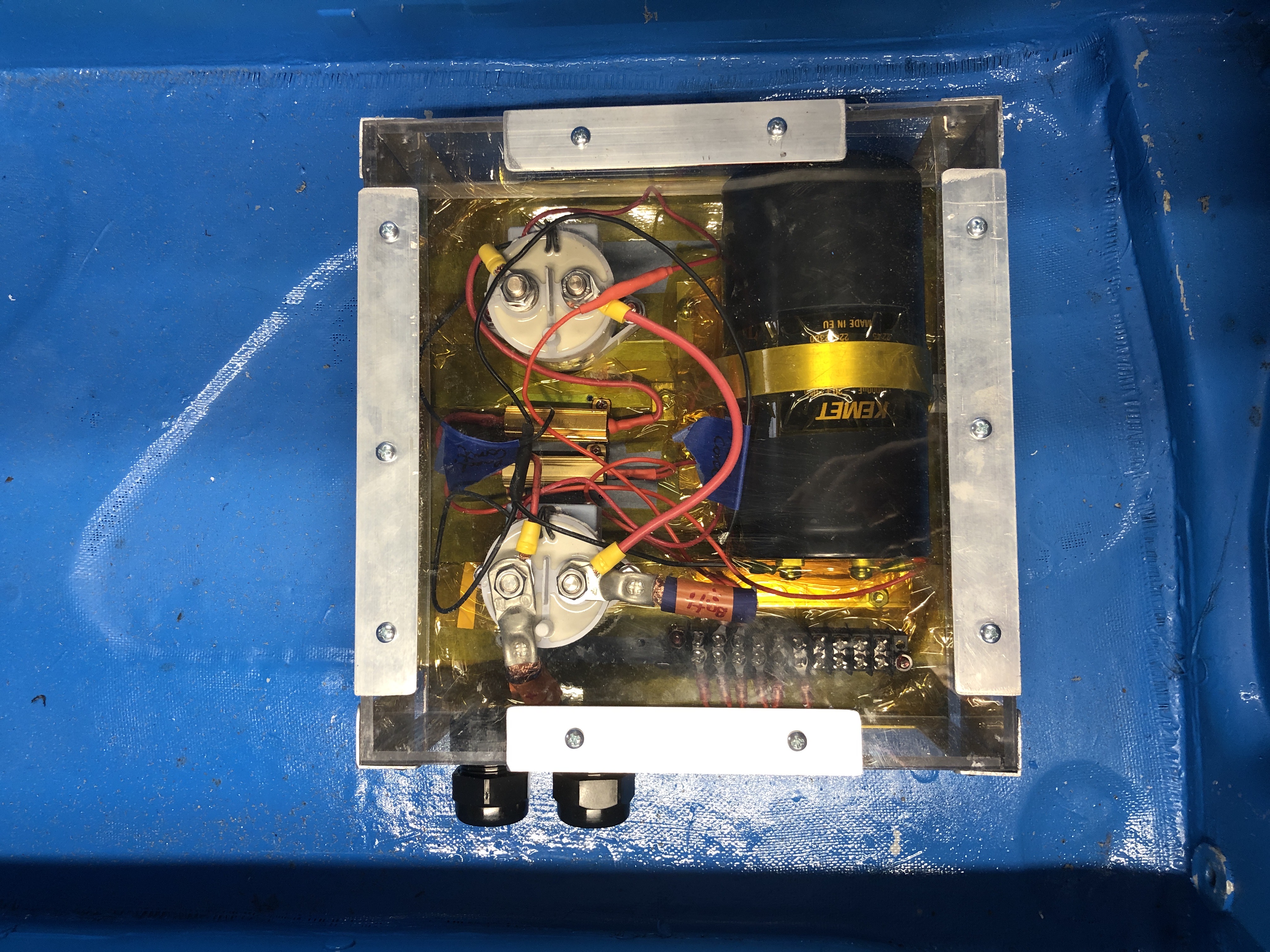

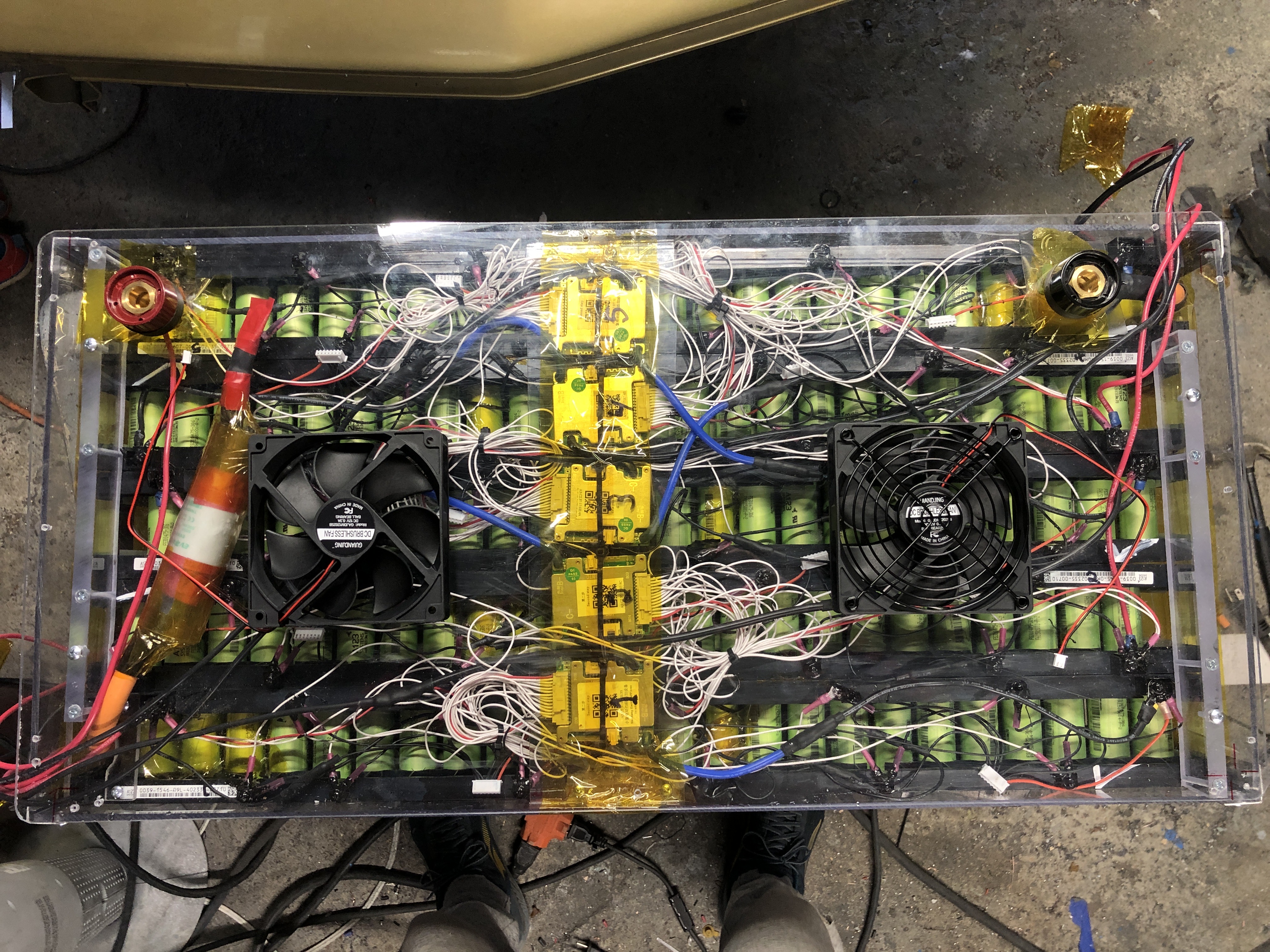

Got some work done. Decided to redo and go with polycarbonate boxes instead of the aluminum-the metal scared me :0
Almost done with both boxes and contractor box is complete. Each 39/40v module (10 total) will have charging/balancing through its own bms, temperature sensor relays (hooked to fans) and low voltage alarms for individual cell groups.

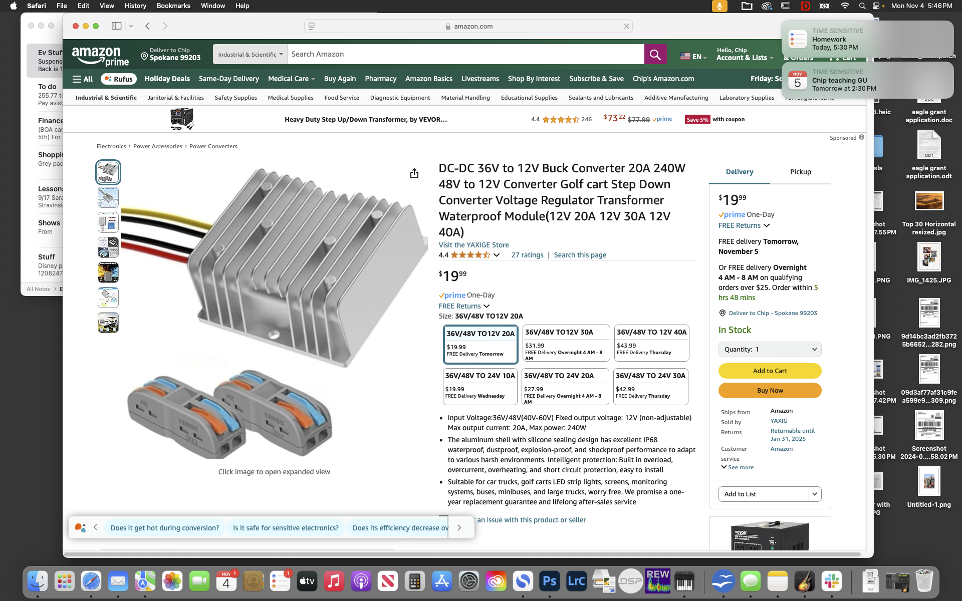

Question about dc-dc converter. I have + and - wires off of each of my 10 36v modules for charging. I was thinking about just wiring off of these in parallel and using a 36v-12v dc-dc converter for my accessories. Total amp draw with everything on would be less than 10a. Is that a silly idea?

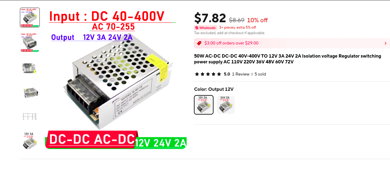

Post by Proton »
If you just want to test you can get something cheap like this one. It an only put out 55W at max.
https://www.aliexpress.us/item/32568050 ... pt=glo2usa
or this one: 750W
https://www.aliexpress.us/item/32568047 ... pt=glo2usa <-------------------
not sure how efficient they are.
I was looking at getting one of these, or one for each battery box-$19 and 240watts on Amazon:
Can't get the link to display
They look like this.
My build is kind of a hotrod grocery getter, drag racing as an option deal. I wouldn't be driving more than 20- 30min on a charge (about a 30 mile range) so would be plugged in most of the time. I figured I could use one of these 36-12v dc-dc converters tapped into 3 out of 5 of my modules.
